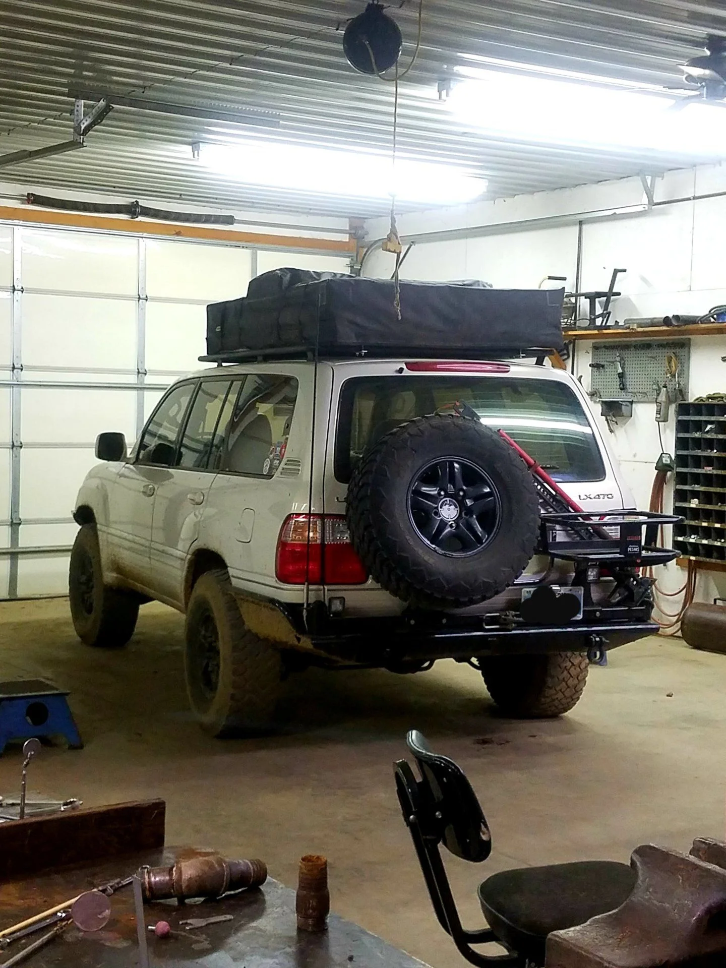

866's with 295 muds, rear w dual swingouts, rack, tent, Just Differentials 2.5" kit. At full load I bottom out the rear on serious trails. Unloaded it rides great.

Currently run a rear BIOR + swingout, empty LRA 26gal tank and single near empty drawer. I was having lots of bouncing while around town and it gets really bad on concrete highways.
Loaded up in the summer with RTT, awning, all the gas and full drawer + fridge the 864s are fine. Just can't handle them now.
I did add 30mm spacers to the 863s and sit nearly 24" hub to fender in the rear. I will load the drawer back with tools and put the roof rack back on after I do some rust remediation. I hope it settles to 23"

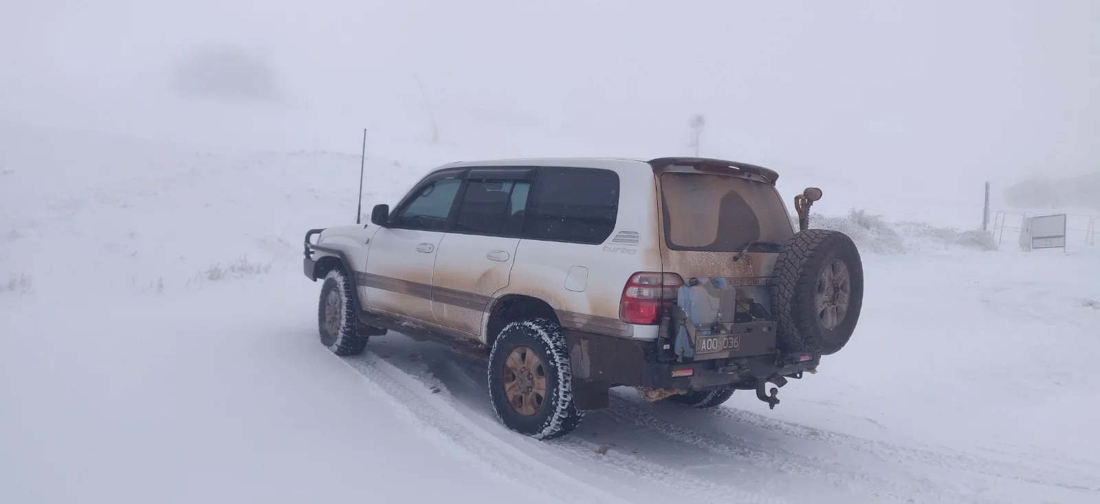

What shocks are you guys running with your 863's ? I had 863's and moved to 863J's recently with OME Nitro Sports, I went the soft valving option and am happy with the ride, tyres set at 35psi and has draws/fridge in the back.
New OEM (not OME) shocks, they ride great. Tires are around 45 though.
@Hulsty that Psi seems low for your weighted setup. I could be wrong though.
I thought so to till I did the calcs, happy to be corrected. OE Tyres @32psi (max on tyre placard) carry 1090kg. I have Yokohama X-AT, according to their chart @35psi they carry 1245kg. Checked after 1hr on the highway, no pressure rise in the tyres, I was expecting to need 42psi, but doesnt seem so.
