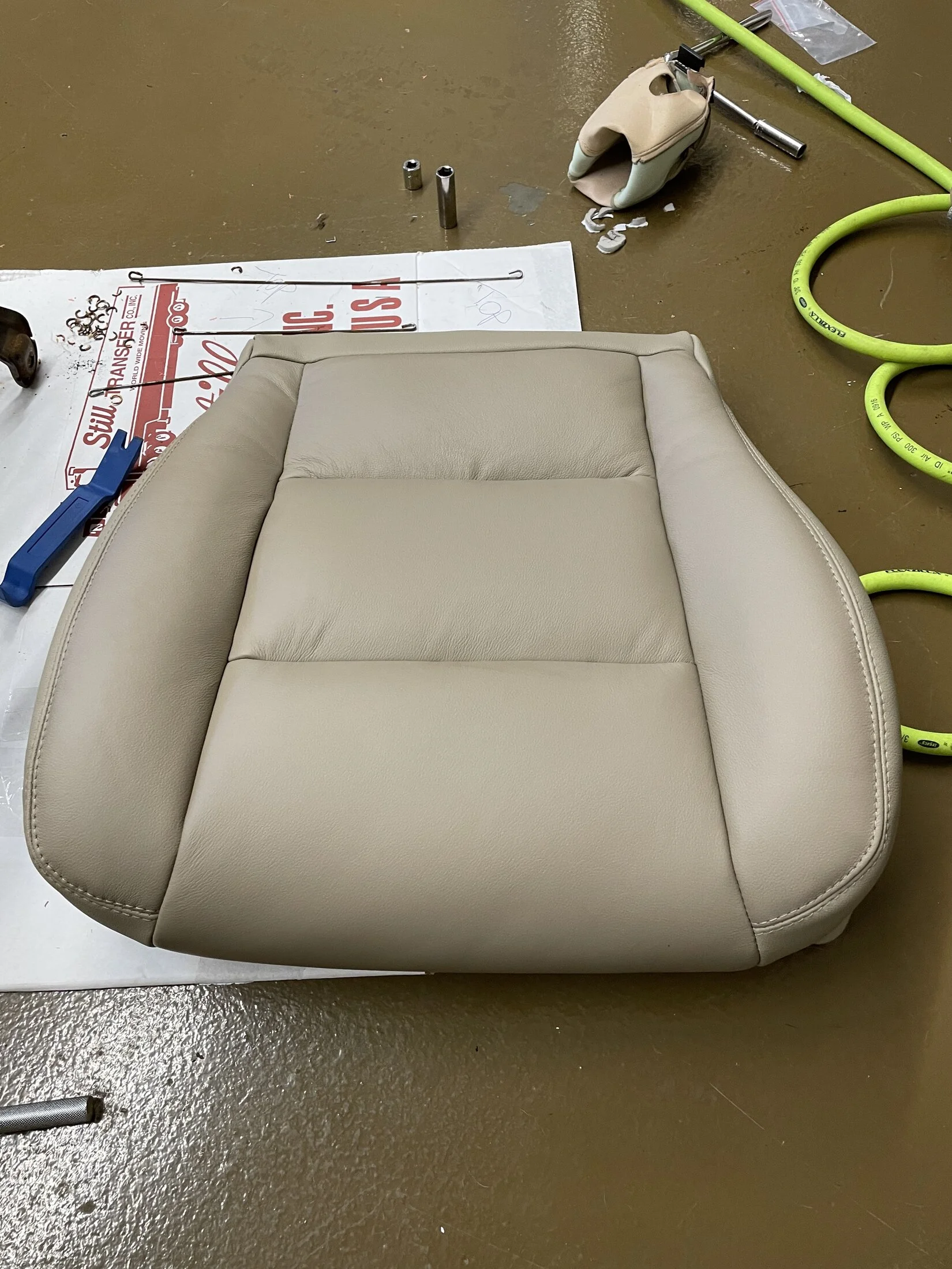

Wrapped up the seat bottoms with the new covers. Good fit and finish. I steamed the old foam. Passenger seat had some foam already added on the bolsters. Driver seat foam bottom puffed right back and softened nicely with several passes of the steamer.
Color seems a bit lighter than OEM but I need to give the uppers a good cleaning which should help things.
That looks great, how as the installation? Any issues or suggestions? I bet with a good cleaning of the uppers that will be a great color match.
Installation was pretty easy. I marked the wire clamp locations on the seat bottom with a paint marker and took a picture so re-assembly was a breeze. The new covers came with a layer of 1/4" foam sewn-in so between that and the foam steaming it came out fitting pretty tight. The passenger seat had extra 1/4" of foam added by previous owner on the bolsters which definitely required extra effort to get the new cover stretched on. I had my wife stand on the seat pan to compress the foam while I got the front plastic u strip snapped on along the front seat bottom. The extra foam on the PS seat definitely anchors you in the seat more. Gonna roll with it for a while but I may end up adding some foam to the driver seat bottom bolsters. I'll see how they are after a break in period.
My main advice is get a quality set of hog ring pliers. Having used a cheap hog plier in the past, the extra cost for angled, longer pliers is totally worth it. Oh and wear some leather gloves. That stamped seat pan will not hesitate to slice you up. You're looking at maybe 2 hours a seat between removal from the truck and actual cover install. I HATED doing the seats in my old mustang with cheap hog ring pliers and was not looking forward to doing these. But good tools make the difference and I actually enjoyed doing these covers.

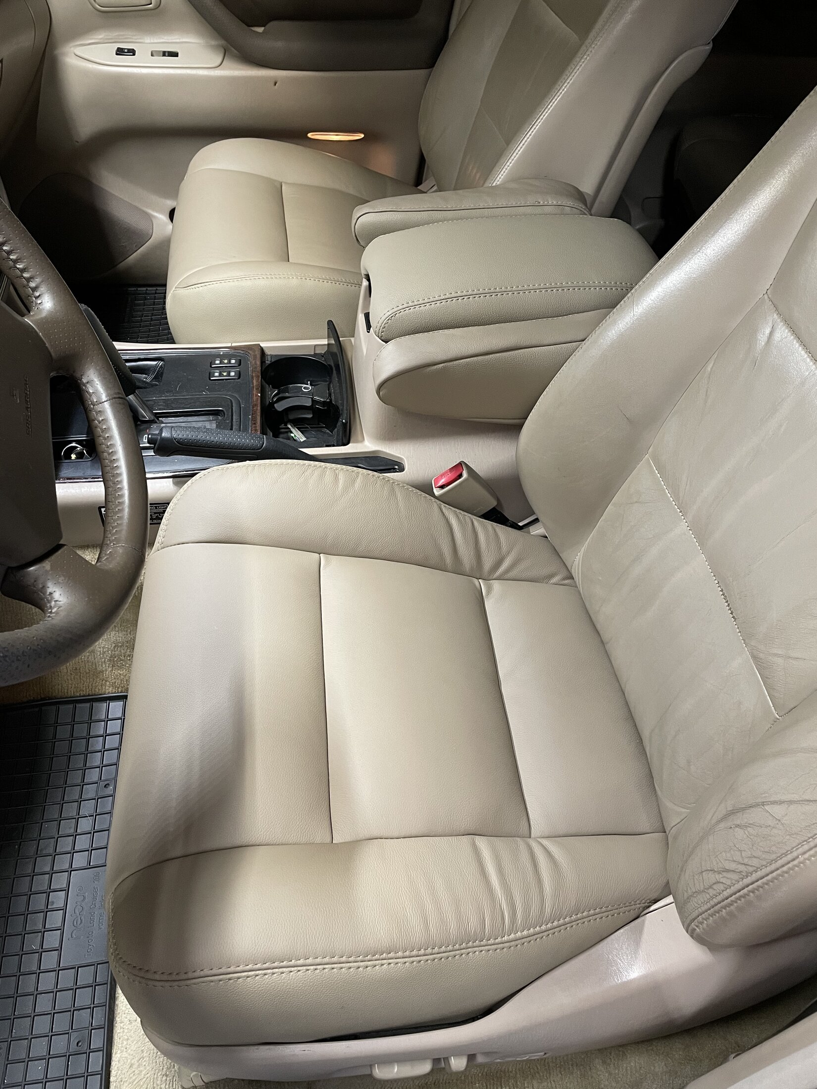

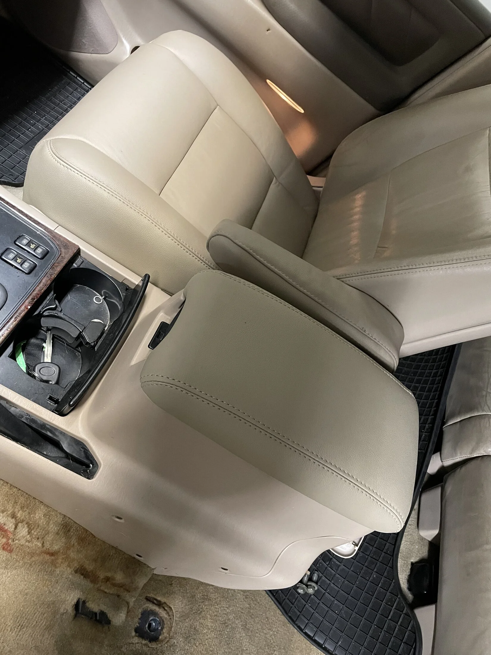

I used Ed at hotrod upholstery and would definitely recommend him. His online store front is not an accurate representation of what he can do. I got front seat bottoms, arm rests, and center console cover. Just send him an email with what you are looking for. You will be surprised at what he can do and typically will throw in small extras at no cost. Super good guy.

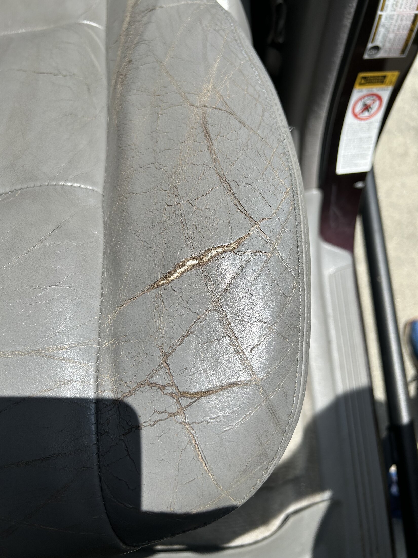

Here's the budget friendly option I deployed on my new GX470 with cracking seats......Kind of makes you wonder why anyone would ever spend more to have a nice piece of leather under there ass
I even went with color matching
Couldn't agree more. I may need to get the rest of the bits to do the arms and back in a year or two. I'm waiting to hear back from him on if he could do fabric seat covers since he has all the patterns.
Got any pics of the end results?

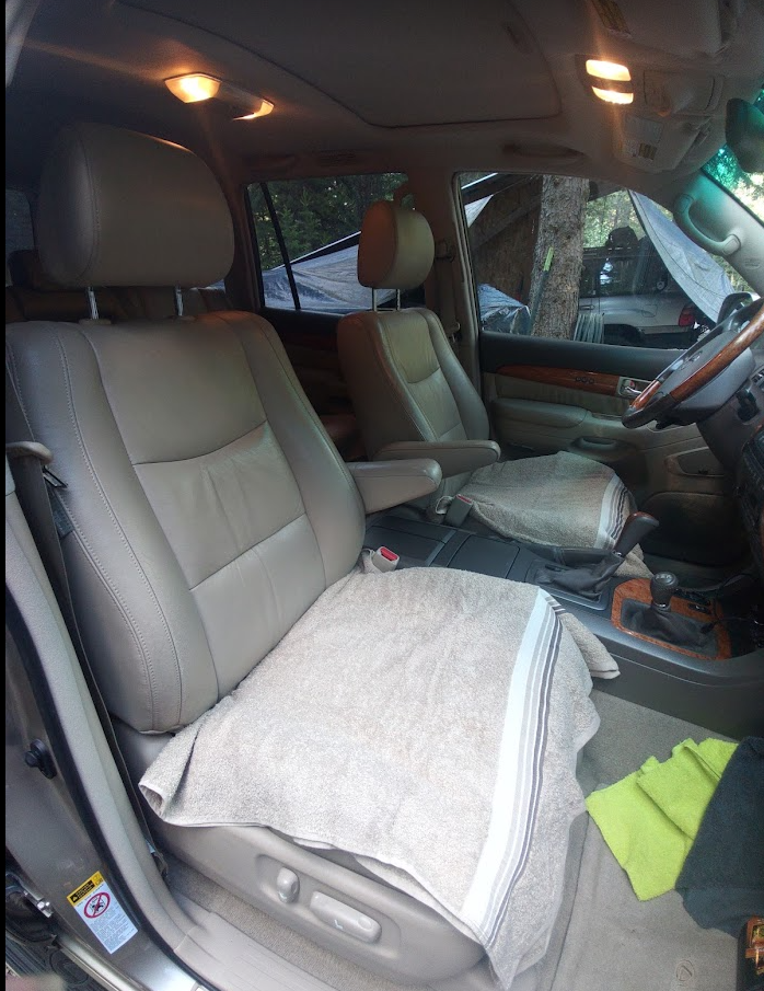

Do any folks offer a fabric replacement options? I can't help but notice all of my 10+ year old leather seats have cracked but my 30 year old corolla with fabric seats are comfy and new feeling still.
For now, throwing a towel over the seat is my best fix lol
