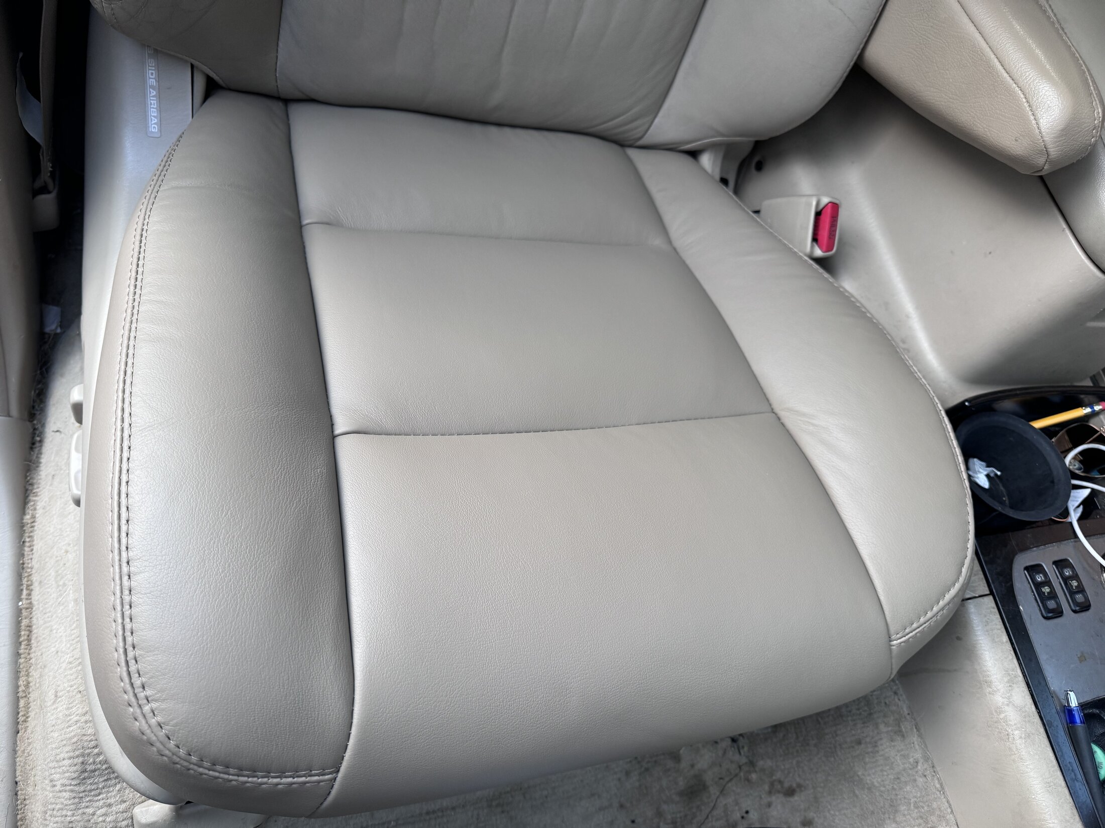

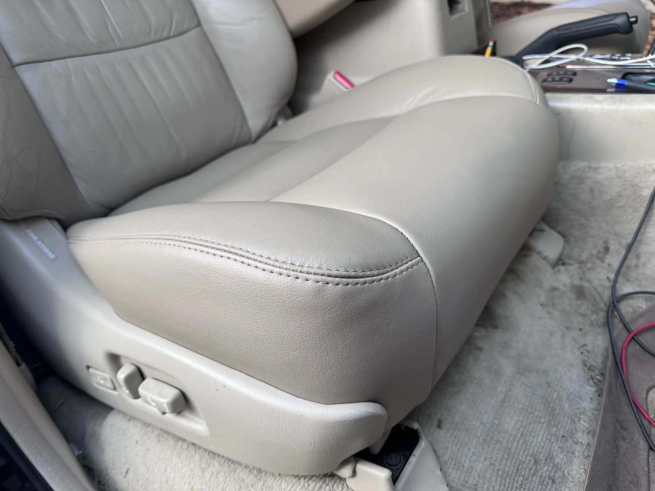

Just had the new Wolfman/Hot Rod leather bottoms installed along with new Toyota foam. Looks excellent, and the installer was pretty nervous about where the leather came from but was impressed after the install and said it was a very good fit and well-made.
Looks great, hard to tell from the photos but how closely does it match the factory OEM ivory leather?
It's not exact but it's a lot better than the torn up seats. This is a temporary solution for me - I'll eventually have all of the leather replaced - so wasn't too worried about it. The installer said they could make it a more exact match but I told them not to bother. Next week it's getting detailed and the older leather will be cleaned up a little - after that I'll take some more photos and update you on the color.
