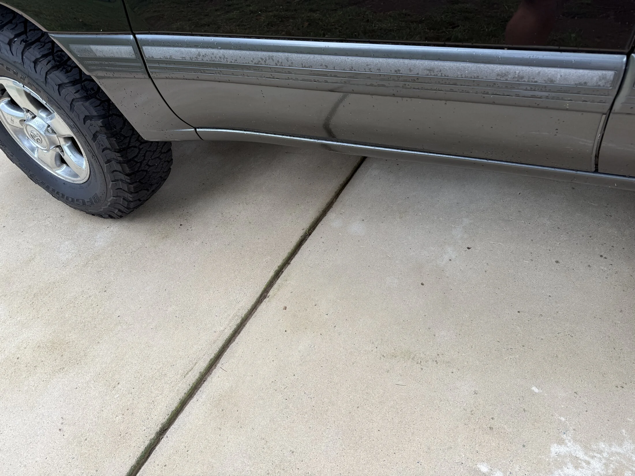

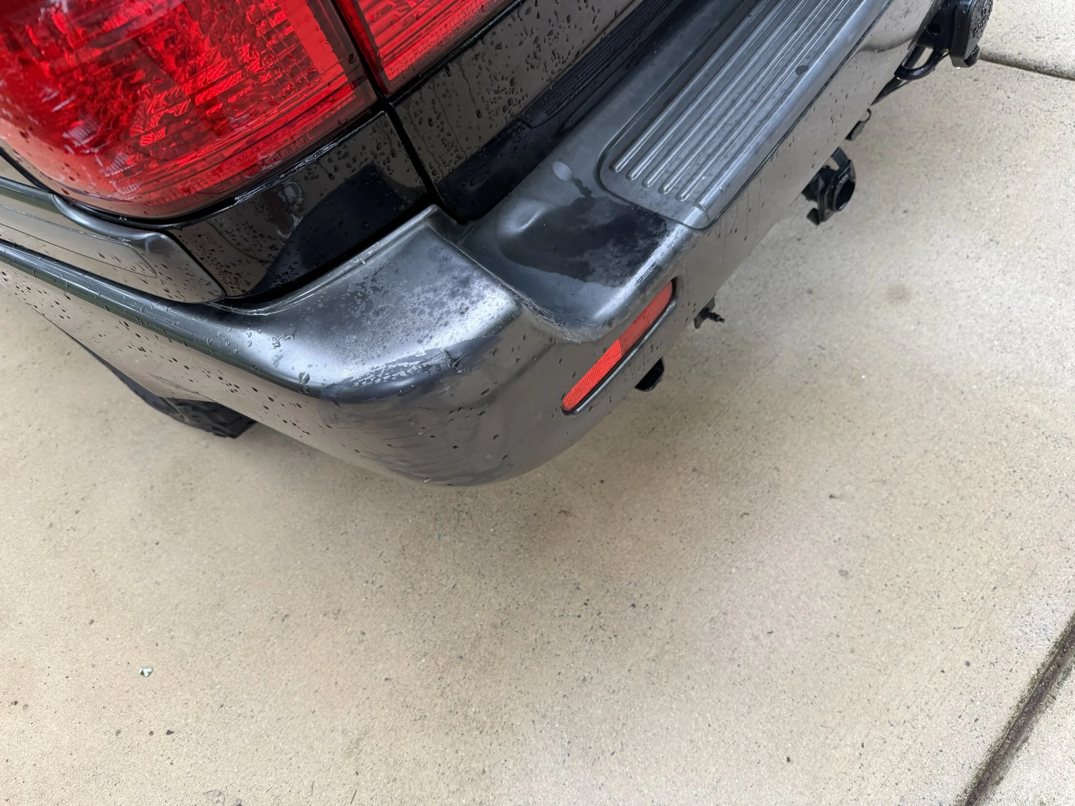

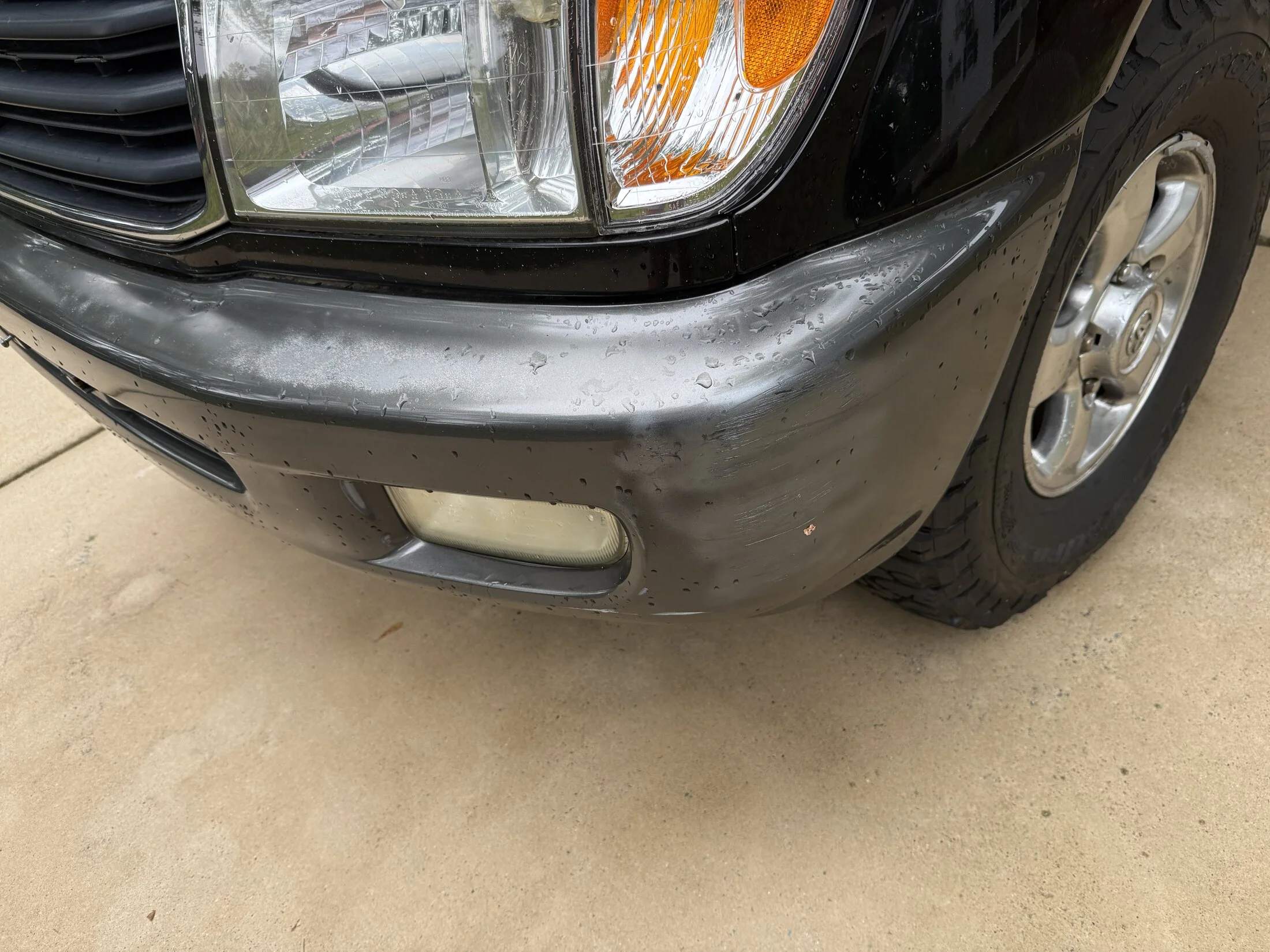

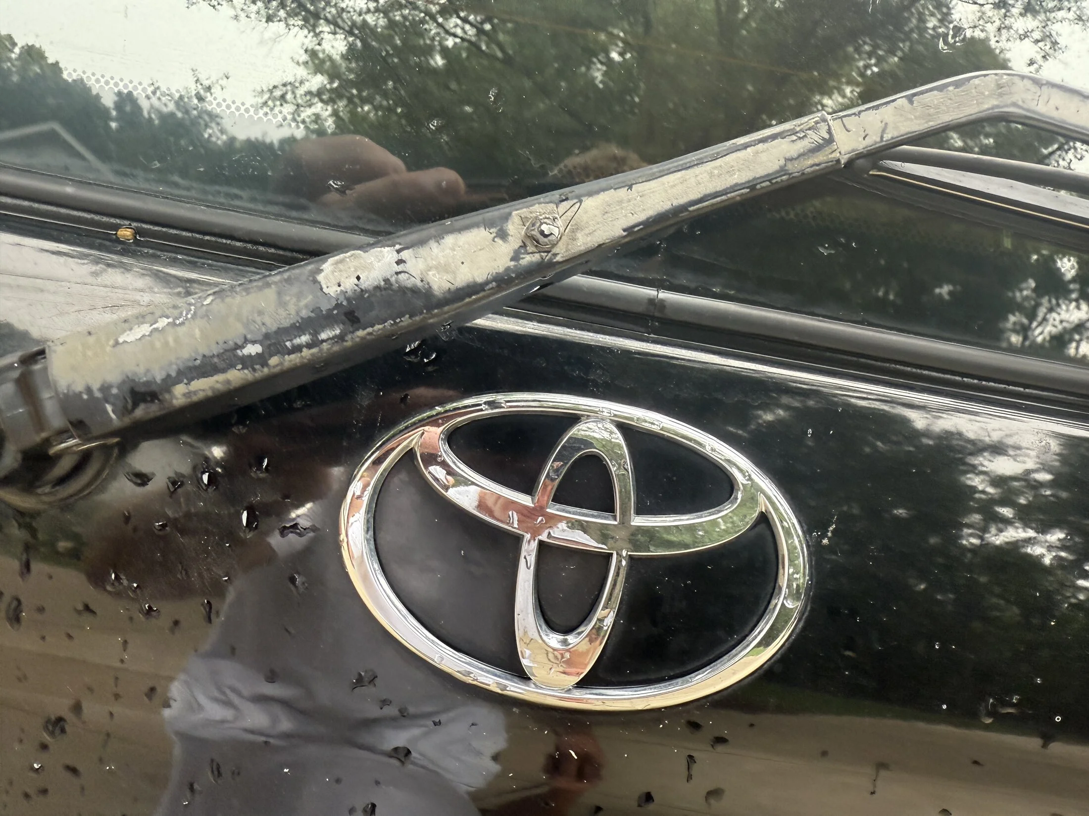

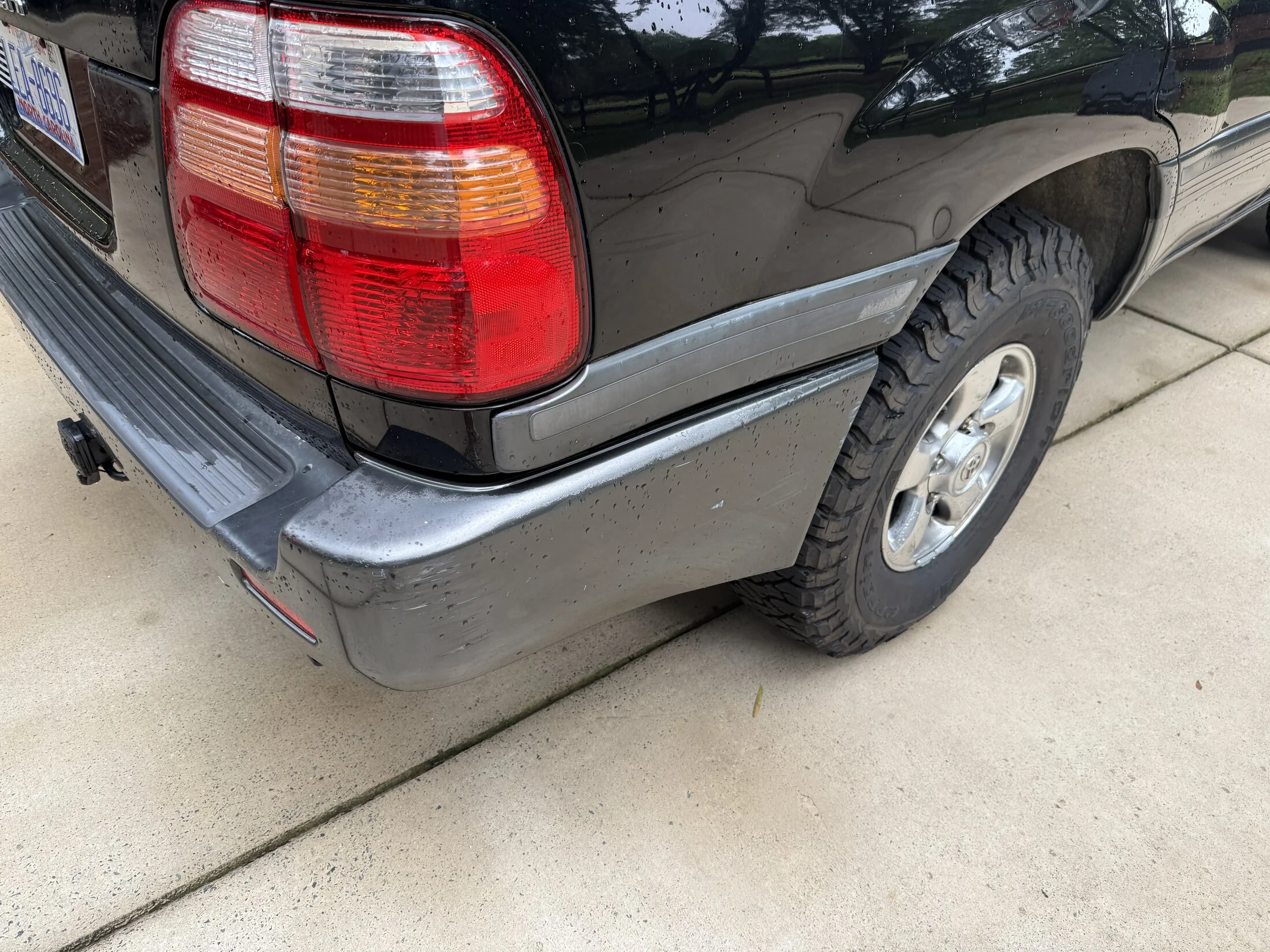

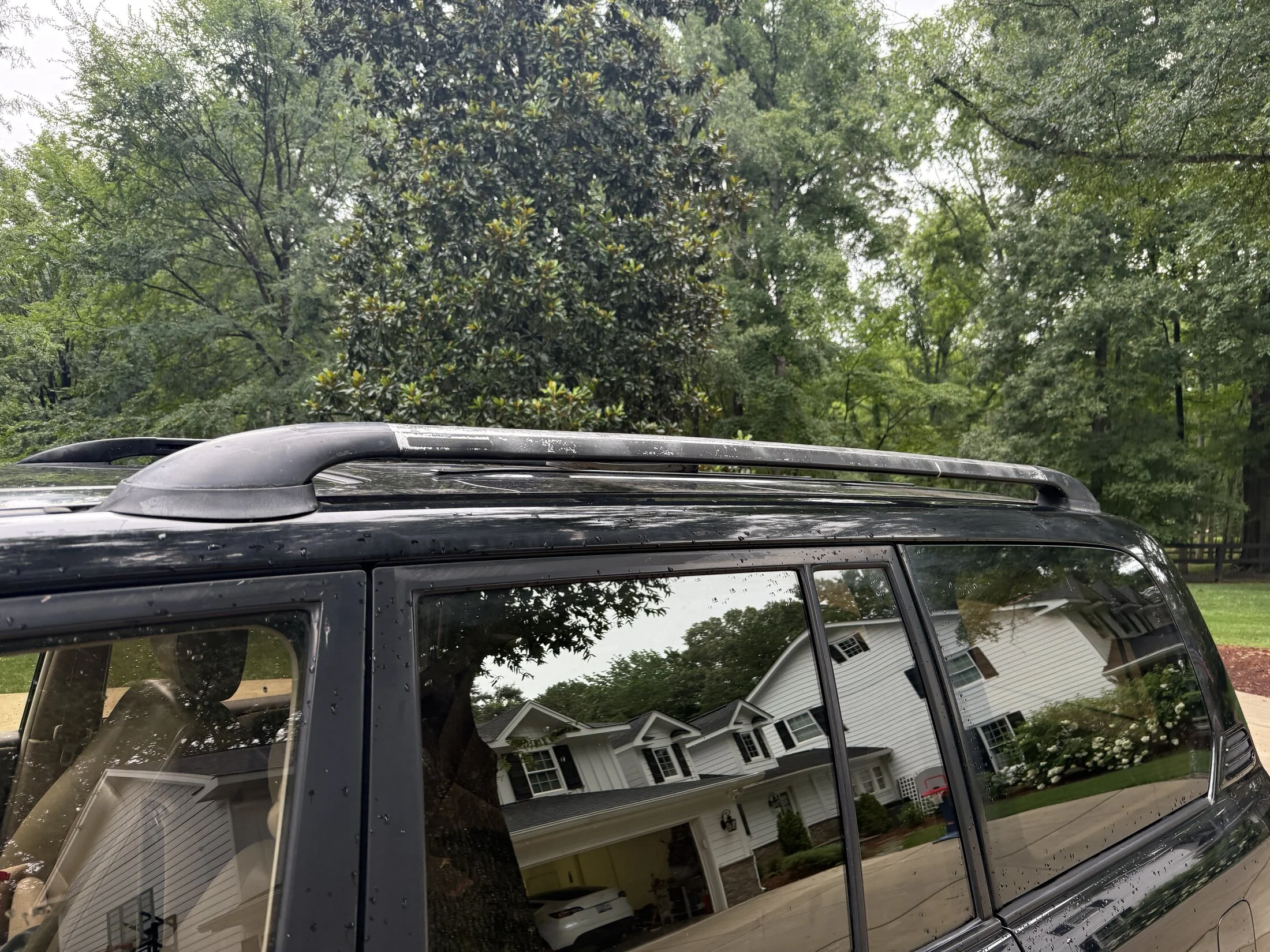

Trying to glow up my cruiser. I considered painting the whole thing- that’s $11k.
While that’s the only way to truly make it perfect, that’s probably also overkill.
I really only have a few obvious issues- bumpers and rack being the main ones (pics below).
One idea is to pull wipers, rack off - repaint those myself. Not sure what to do with bumpers.
What would do if the goal is to glow this thing up?

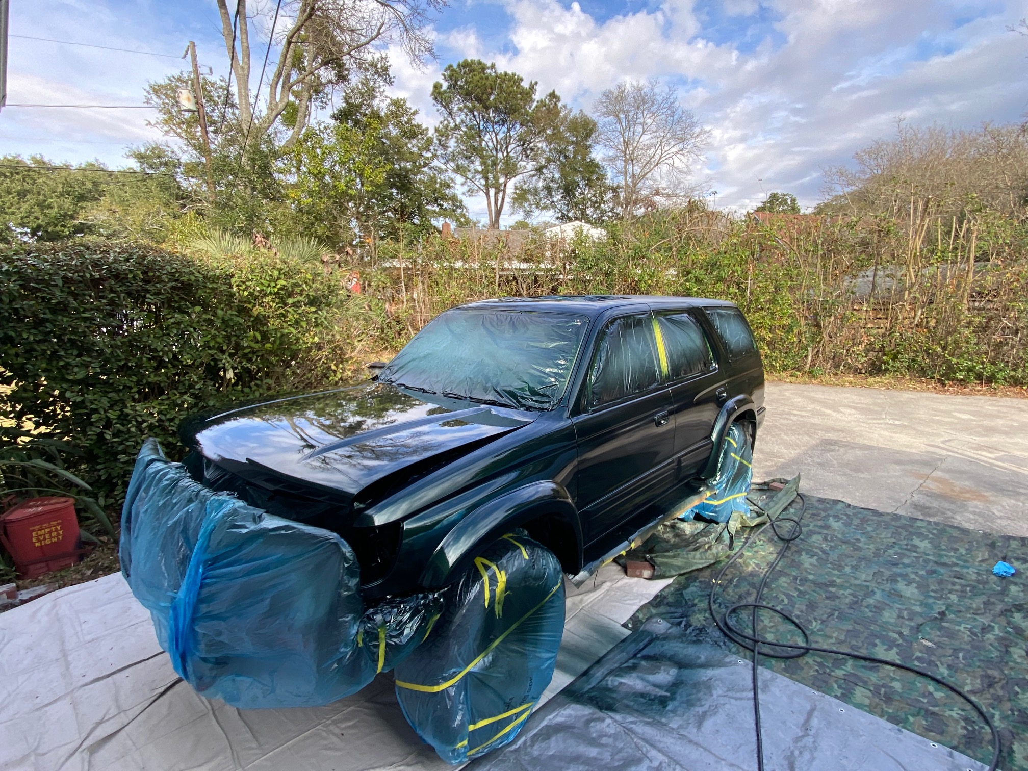

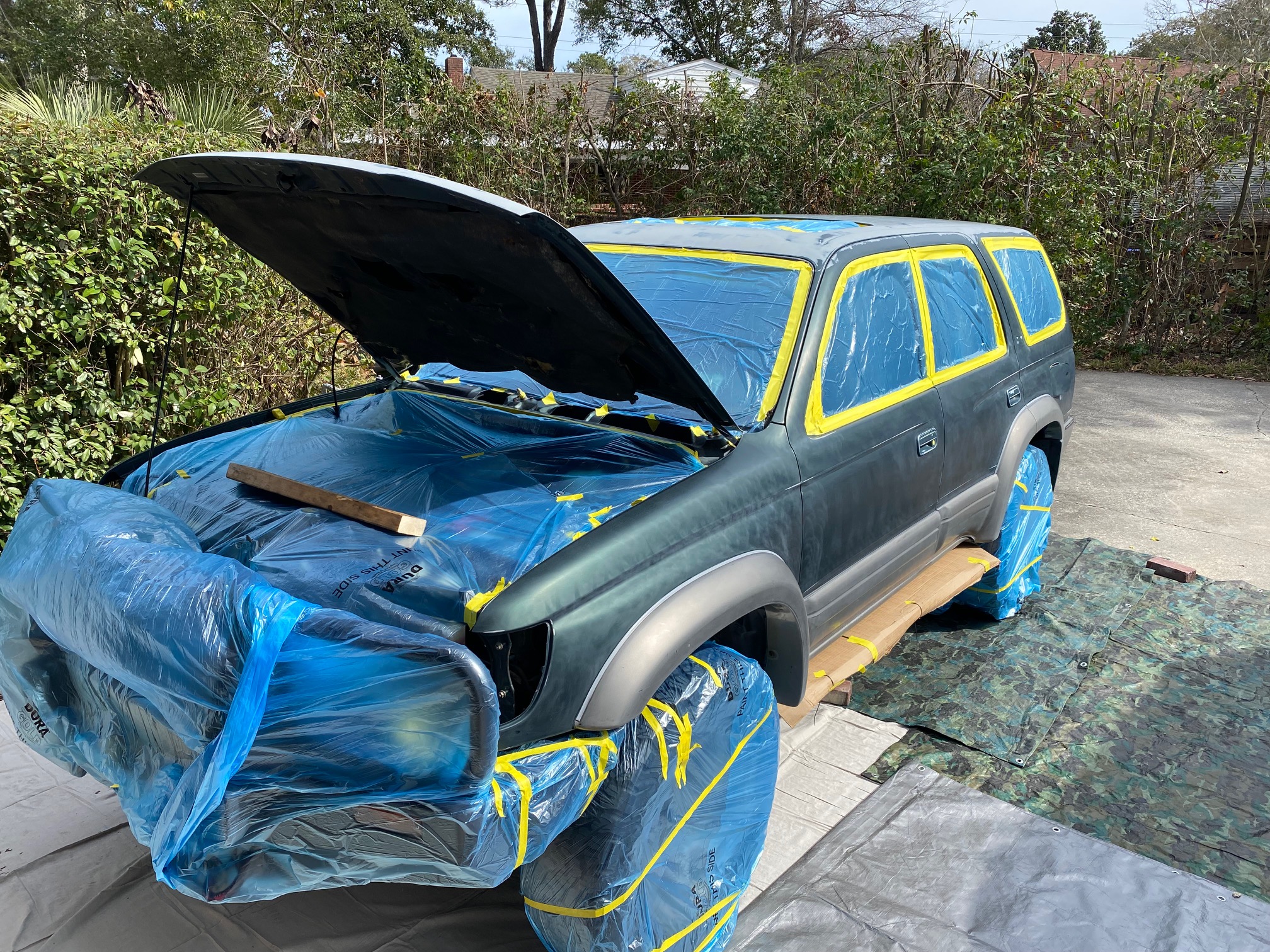

You really can paint it yourself. I did my own paint job on my 4Runner a few months ago. I literally have never painted anything before in my life other than spray paint cans before this. For my first ever paint job and it came out pretty good. It was actually pretty fun to do as well.
I bought one of the better Harbor Freight paint guns, some tarps for the ground, and a decent base/clear OEM-match paint (Toyota Imperial Jade mica) from Tamco paints. The base and clear materials cost just short of $1k. The paint gun, primer, sandpaper, masking materials, etc was about another $400-$500ish. Lots and lots of prep work in sanding, masking, wiping, and more sanding. I watched a lot of YouTube videos, especially "paint society". All in the whole respray took me about 30-40 hours, and cost less than $1500. If I can do it, anyone can !

Not sure I’d commit to an all-over job with it, but SprayMax 2K eliminates a couple of these variables if you want to try with just your bumpers. It’s an 2-part urethane that ships in a unique rattle can, in any color you want. Their system has compatible cleaner, primer, adhesion promoter, clear coat, etc. No spray equipment required. I have a $40 paint tent (aka poor man’s spray booth) and just refinished my roof rack in satin black.
Not sure whether or not it's just me, but I'm missing pics of the whole car to serious give my opinion. On top I'm still not sure whether the OP wants to freshly clear coat or fully paint...
Seeing the last pictures:
- the black body seems ok to me, proper 3-step 3M Perfect It polish ($150-170) and a Harbor Freight Random Orbit Polisher (forced! ~$80) and the body looks ok to me... but perhaps I don't have the full picture
- plastic parts like bumper and trim: those can be taped off and painted/ treated separately
- metal parts like rack/ wipers: spray can yourself, I personally used bedliner spray for these things on multiple cars for friends. also bedlined my wiper arms.

Yes, sorry... I took pics and then dropped it at the shop. Will post pics of the whole thing later.
