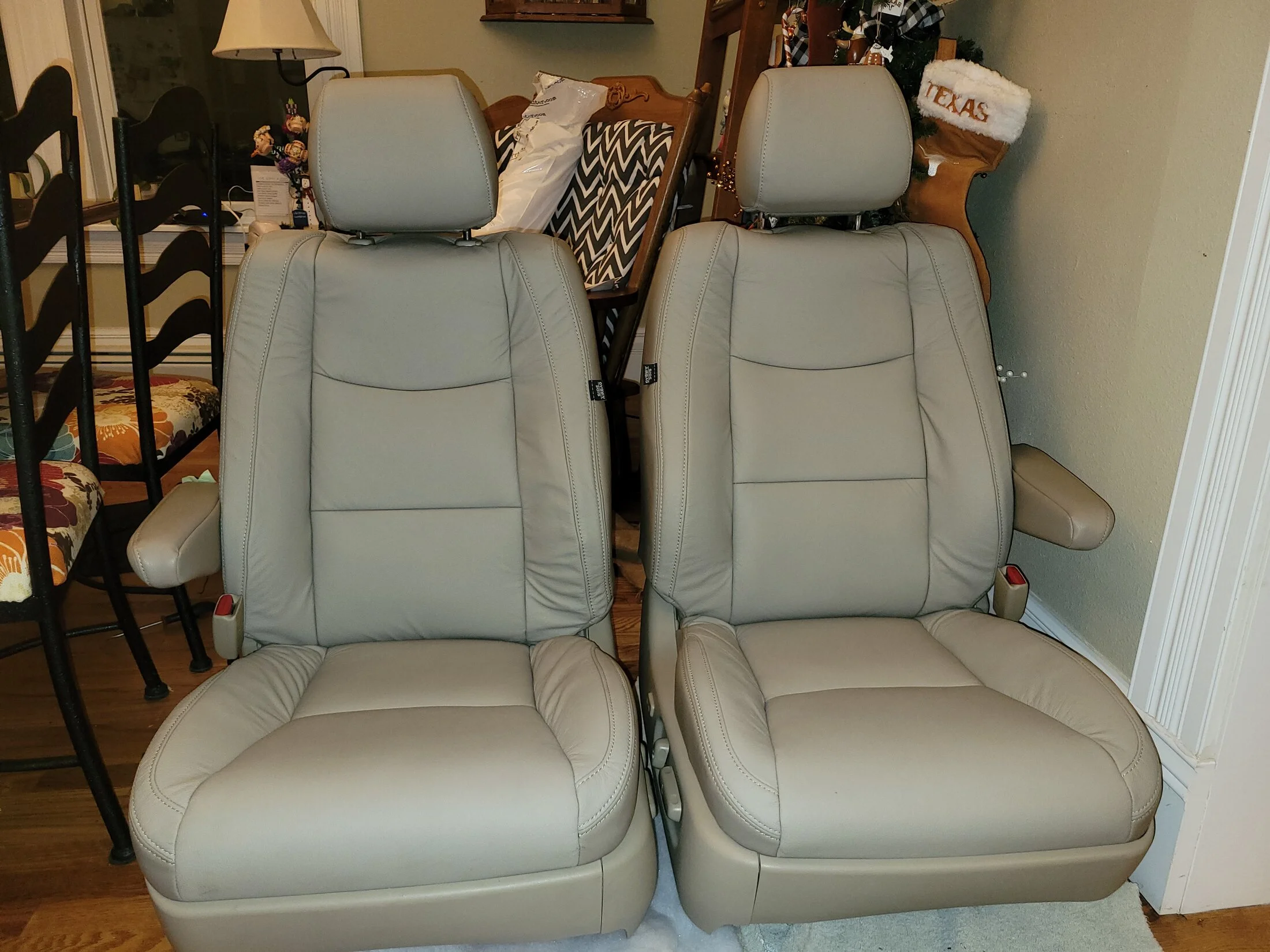

I like that armrest! Are those the 80 series ones? If so, did it fit without too much fuss?
Another vote for Leatherseats.com. Just have 5 months on mine, but they've been holding up really well and are very supple/comfortable. USA-sewn is a plus, and the DIY install was not too bad. The horror stories on LSeat and on Ridies customer service led me to them.
Wow looks even better than stock!
Those are the 200 series version. Almost an exact fit, I was very pleasantly surprised as this was a total "roll of the dice" experiment for me. Caveat: they come in black only.
Folks, for those of you considering replacing the leather in your stock seats, I will STRONGLY recommend replacing the factory foam -especially the bottom seat of the driver side- at the same time, it was the single biggest improvement I've made to the driver experience. It is NOT cheap, but if you're going to replace leather, now's the time to do it and get another 15-20 years out of it.
I did the DS seat bottom foam (aftermarket). None of the other foam was available new at a reasonable price, at least for a GX. I did steam all of the foam, which made it puffier.
In hindsight, I would have added ~1/2" of new foam over the side bolsters on the DS seat and possibly the PS seat too. You can see on mine that it was a bit compressed due to 16 years of use so the seat cover is just a bit saggy. The new foam would have made it a bit more plush and filled out the seat covers (which were, as far as I could tell, exactly the same dimensions as the OEM covers).

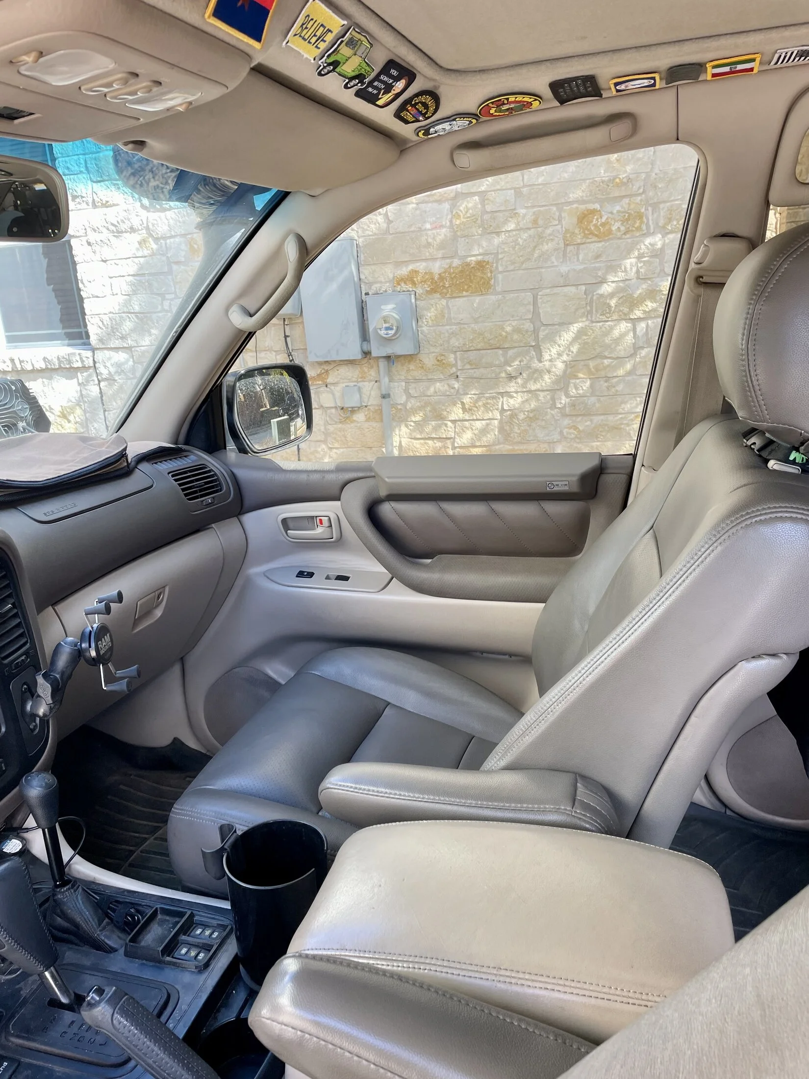

Wrapped up the seat bottoms with the new covers. Good fit and finish. I steamed the old foam. Passenger seat had some foam already added on the bolsters. Driver seat foam bottom puffed right back and softened nicely with several passes of the steamer.
Color seems a bit lighter than OEM but I need to give the uppers a good cleaning which should help things.
