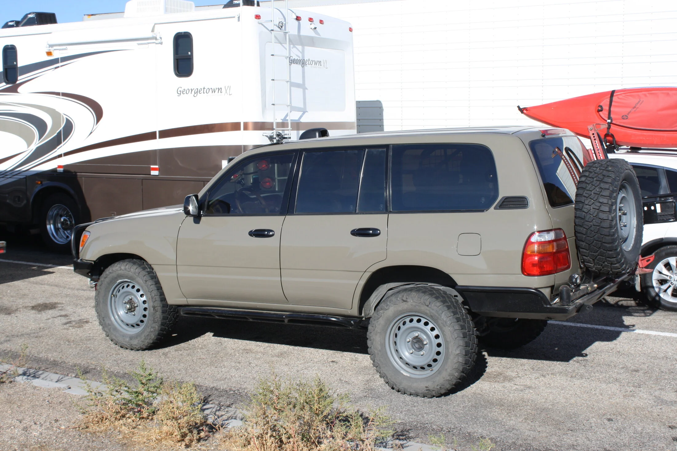

I went through this dilemma back in 2019 when I couldn't look at my buggered clearcoat anymore. I had one more condition: it needed to be a good paint job, but not such high quality that I'd be sweating it every time I hit the trails or (worse) started avoiding trails. I searched high and low in Austin and bigger Texas cities and couldn't find anything local under $10K (caveat: I wanted to change the color). Then a friend of mine in Idaho said he had a connection with a local shop to him, that could do the kind of paint job I wanted for the right price. I drove the truck from Austin to Idaho, left it there for three months, and then flew back out to pick it up. It's a great but not perfect paint job. They welded up the holes so I could delete the trim, painted door jambs (but not inside the engine compartment). This was six years ago and the paint job is holding up beautifully, despite the truck seeing regular trail use.
Unfortunately, this connection dried up before I could drop off my other 100 (which has very oxidized paint after a lifetime of Colorado and Texas sun) for the same treatment. I also understand that the price of painting supplies has increased significantly over the last ten years so maybe the $10K target is more reasonable now? I paid $6K back in 2019.
Personally, I would look for shops that regularly paint classic/project cars.
Bottom line, if you want quality without paying too much, be prepared to wait, do your research, leverage the broader Cruiserhead and MUD communities, and consider going longer distances (which you already are).

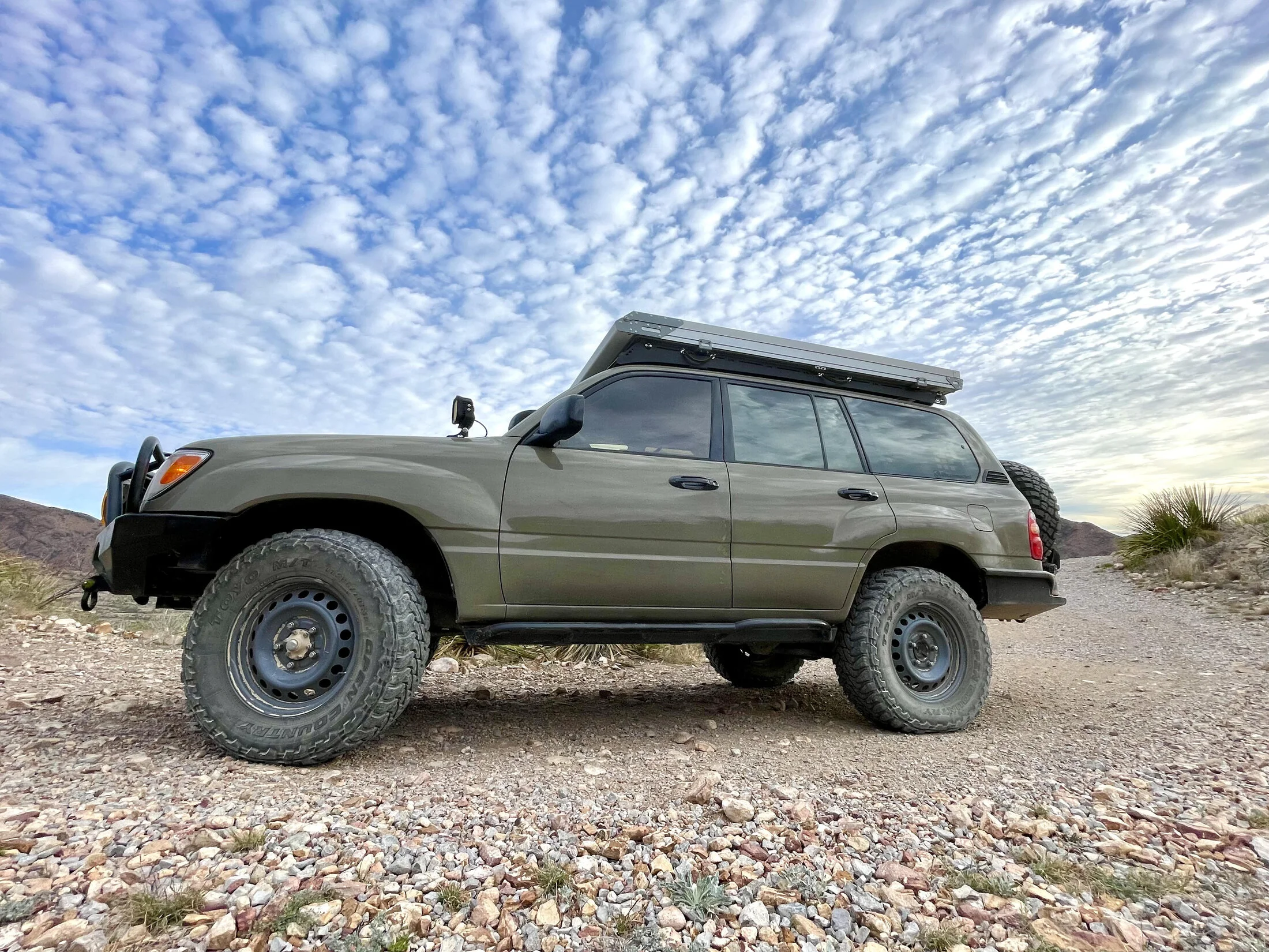

This is the week I picked it up:
And this is now:

Thank you! Looks awesome!
I want to keep mine the same color (black) so that helps. The OEM bumpers are the worst part of mine. I've debated just replacing as you did vs repainting the lower gray trim section. I like the deleted trim look w/ the bumpers... very clean. Which bumpers do you have?
So now debating repaint as is vs add bumpers and repaint vs add bumpers, delete trim and repaint. Decisions!
My front bumper is from Vorfab, a now-defunct fabrication shop that built it to my design, the rear one is from 4x4Labs.

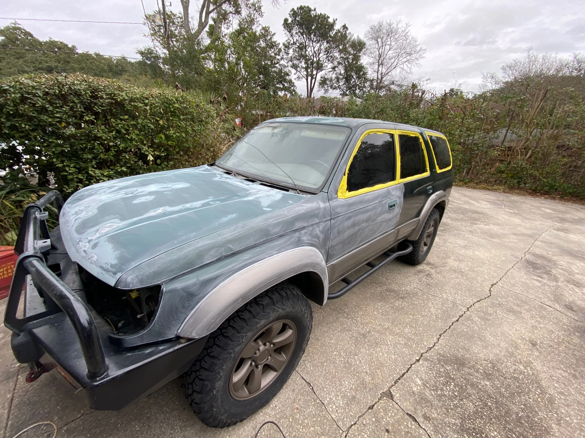

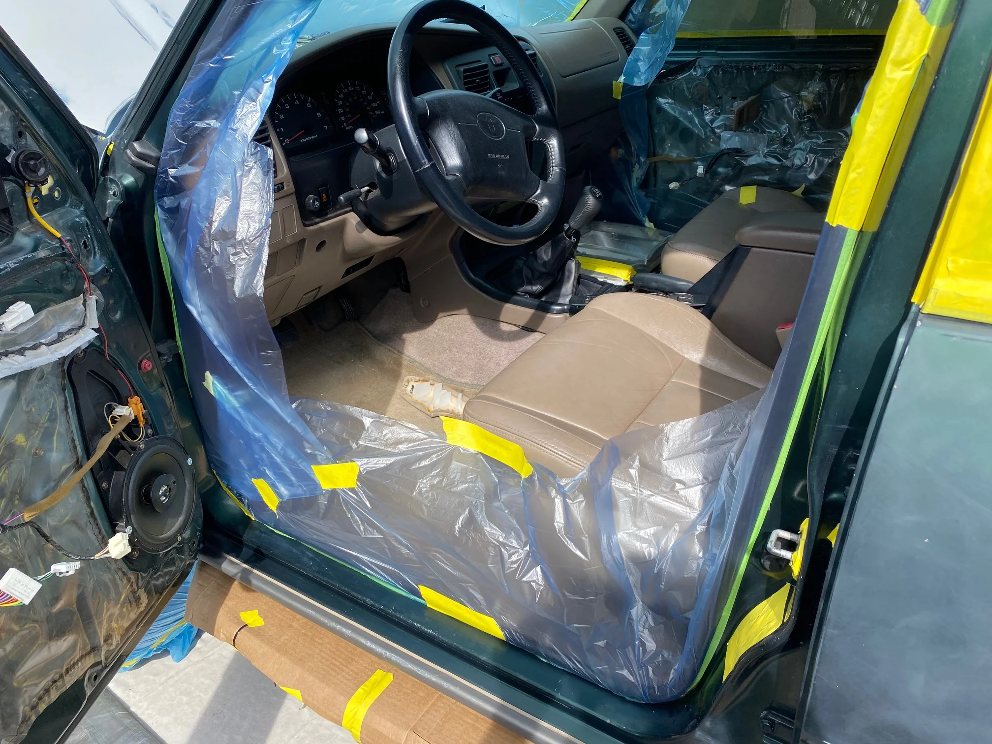

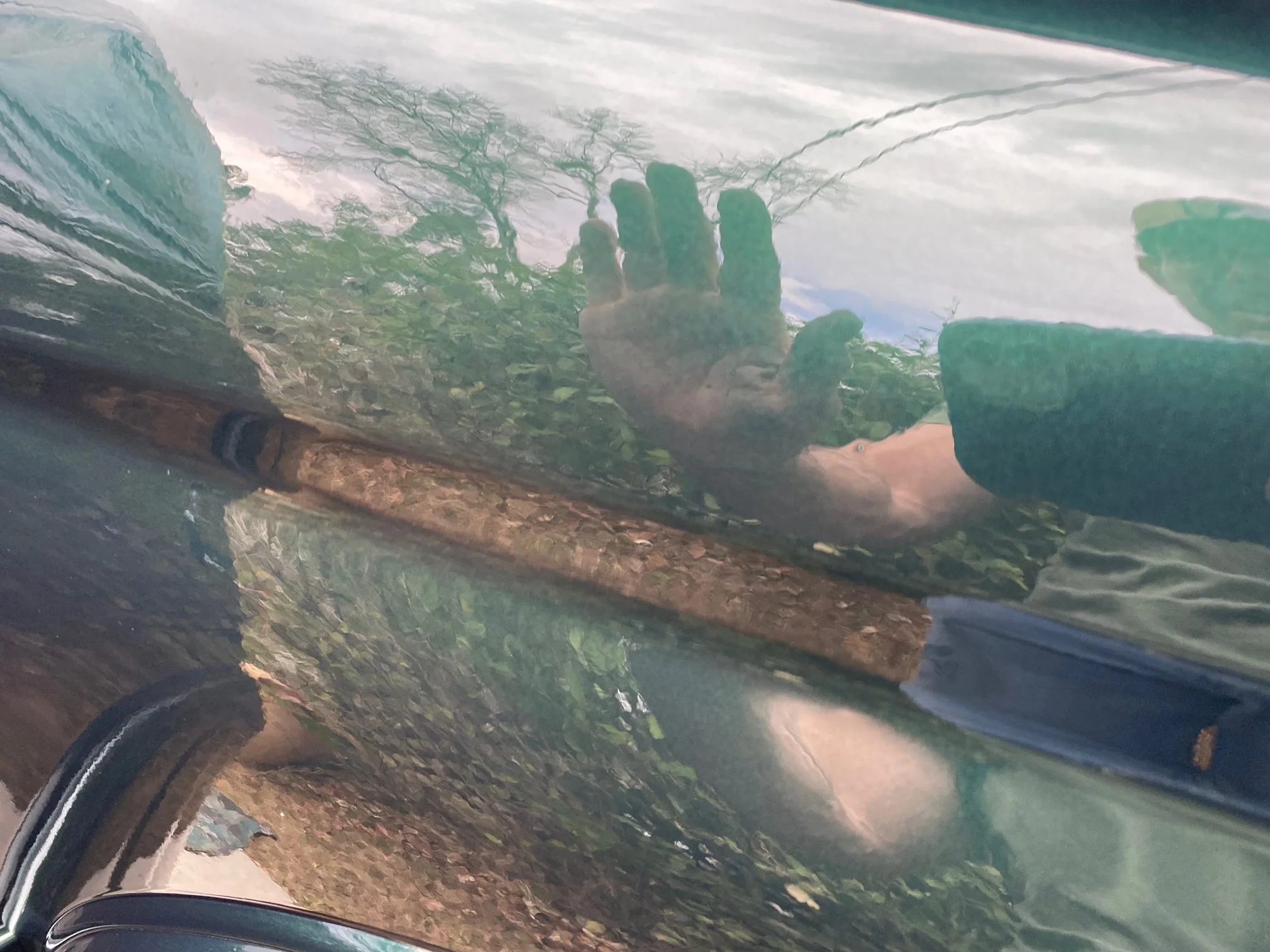

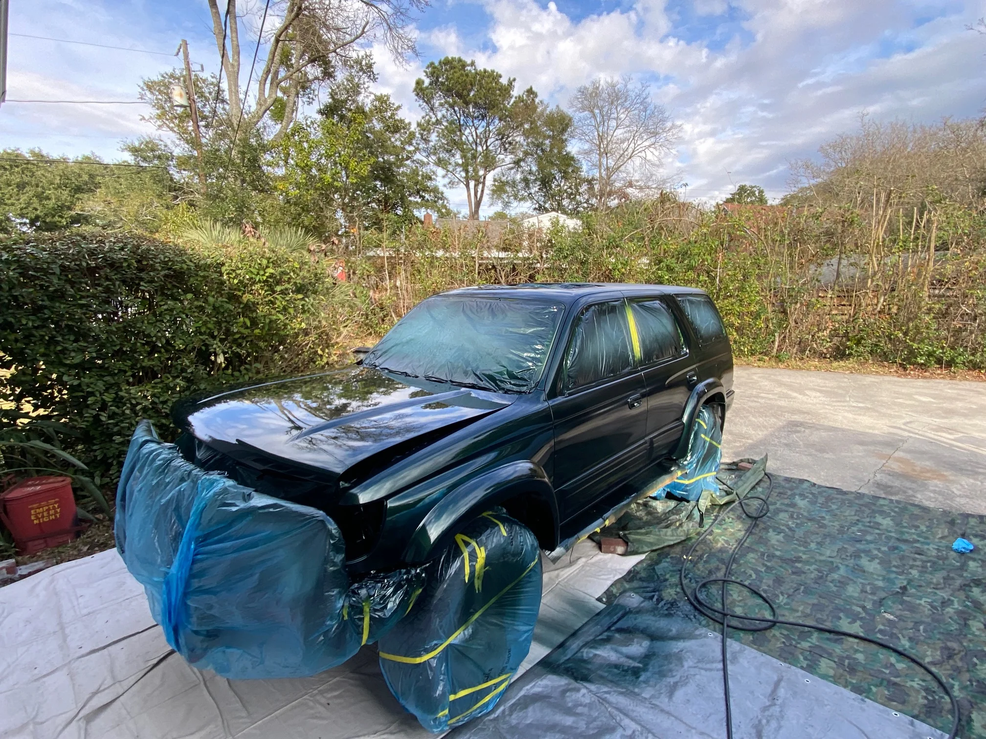

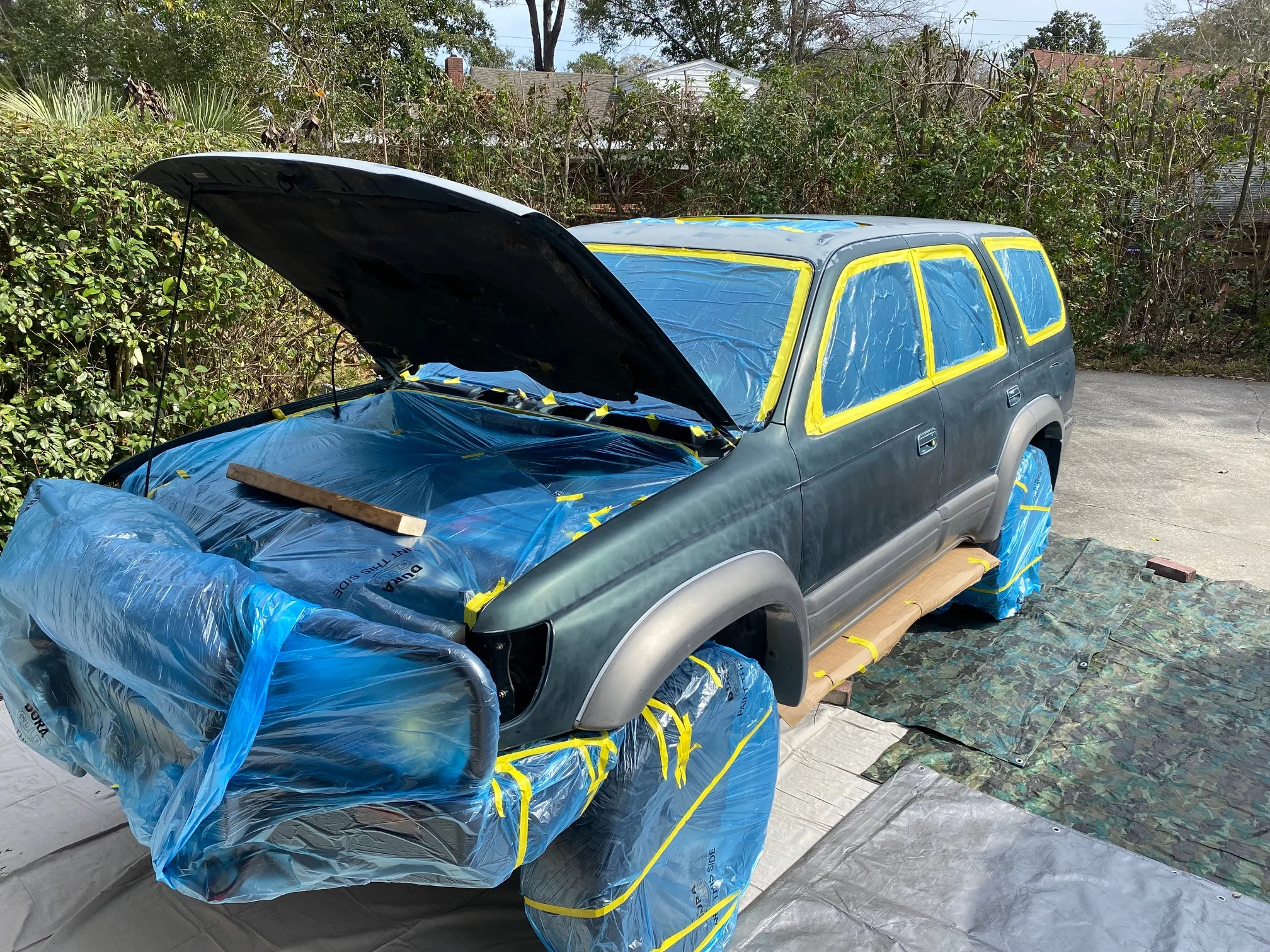

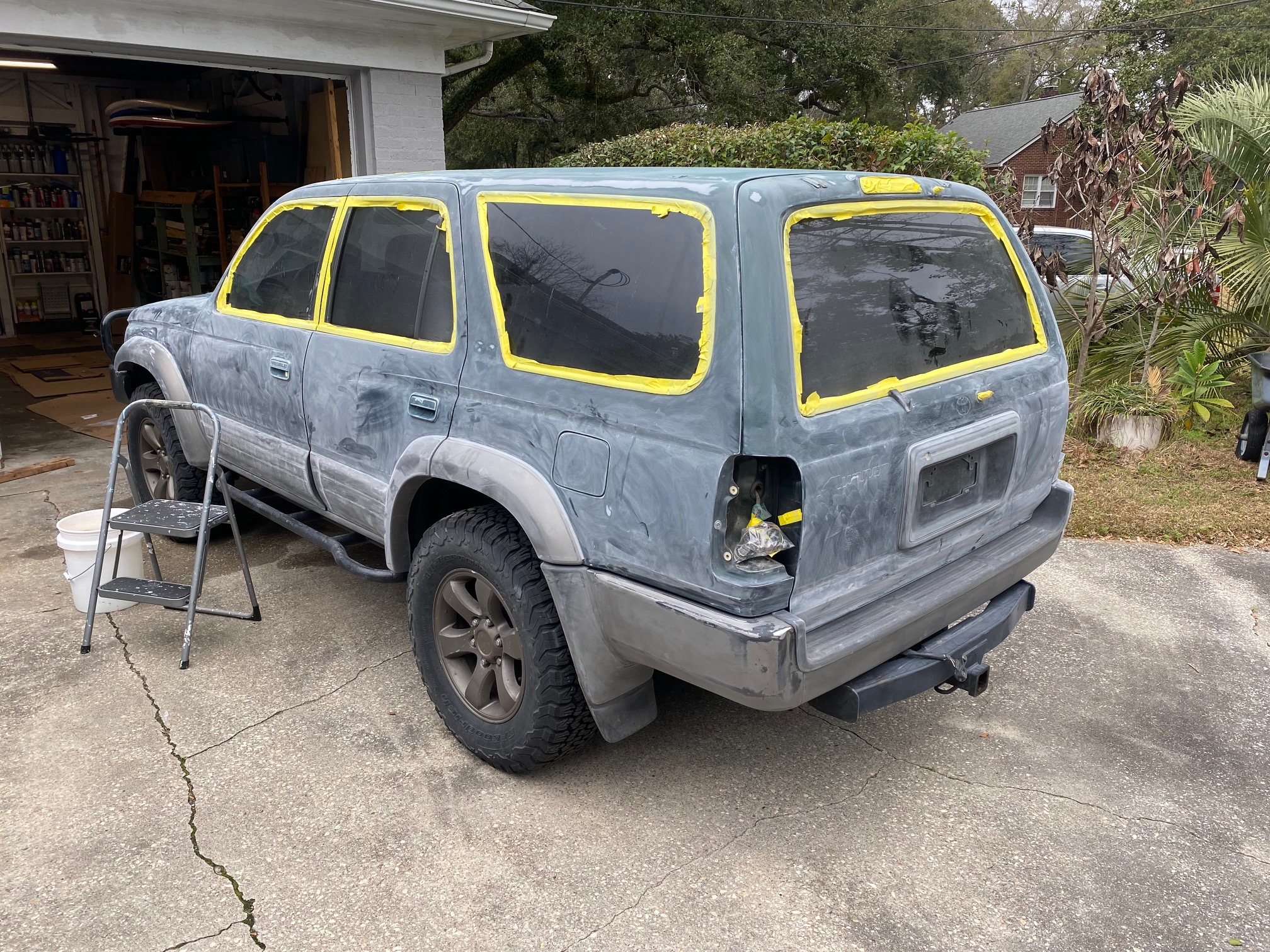

You really can paint it yourself. I did my own paint job on my 4Runner a few months ago. I literally have never painted anything before in my life other than spray paint cans before this. For my first ever paint job and it came out pretty good. It was actually pretty fun to do as well.
I bought one of the better Harbor Freight paint guns, some tarps for the ground, and a decent base/clear OEM-match paint (Toyota Imperial Jade mica) from Tamco paints. The base and clear materials cost just short of $1k. The paint gun, primer, sandpaper, masking materials, etc was about another $400-$500ish. Lots and lots of prep work in sanding, masking, wiping, and more sanding. I watched a lot of YouTube videos, especially "paint society". All in the whole respray took me about 30-40 hours, and cost less than $1500. If I can do it, anyone can !
Did you have any trouble with paint contamination? Dust/bugs etc? That’s my biggest fear doing it in my driveway.
yes, i did get a few. I did this in February, so there were not a ton of bugs, pollen, etc. I waited until the perfect day with very low humidity , and I did get a few little things in the paint, but nothing major. I havent done so yet, but i do plan to wet send and buff it someday. its pretty shiny already
