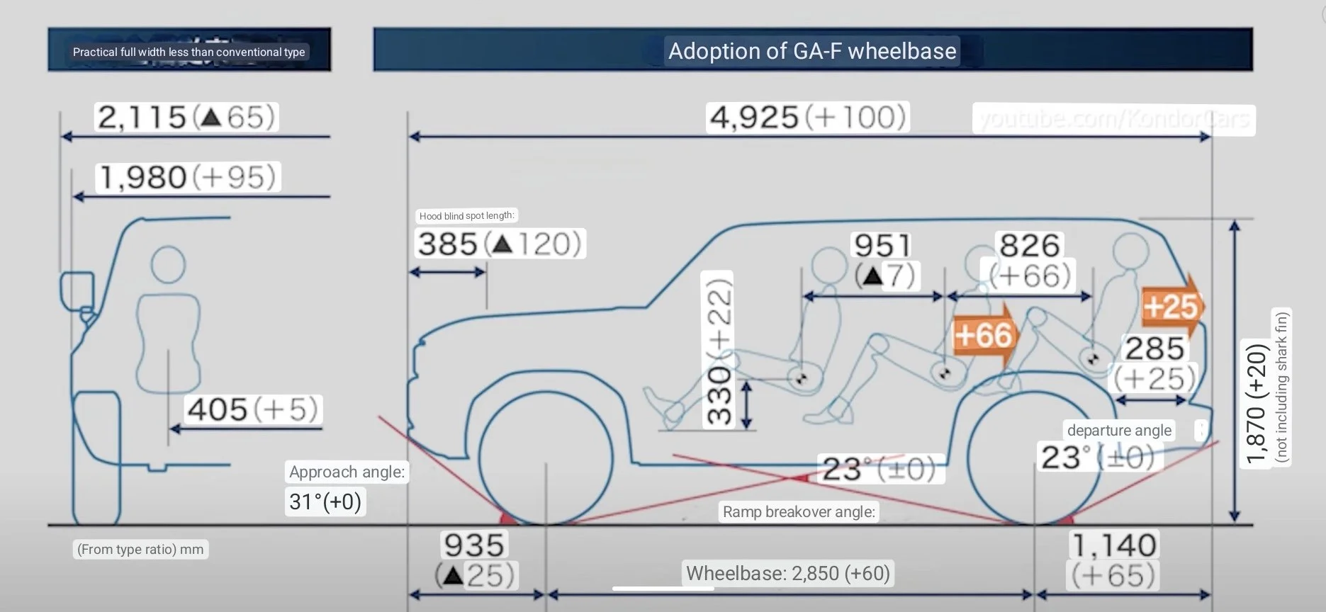

Very interesting video to watch with Google Lens on the other hand to translate everything x)
Thank you for the tip, here is the translated drawing.

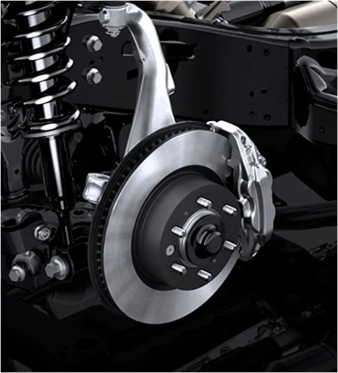

Anyone have any thoughts if 17" wheels will fit over the rotors/calipers on the GX? I was just looking at some videos and the rotors look HUGE compared to my 4Runner. I'm sure some of you have seen the GX in person.
That was my first thought, go straight to 17" wheels for taller sidewalls with better tire compliance. But like we saw on the GX and now confirmed by the LC press release, "all models feature 17-inch disc brakes front and rear". Stock wheel/tire size is 265/70R-18, 33-inch tires.
So it looks like we may be stuck with 18" wheels as the minimum, unless they fudged on the dimensions and perhaps 17" steel wheels would fit?
