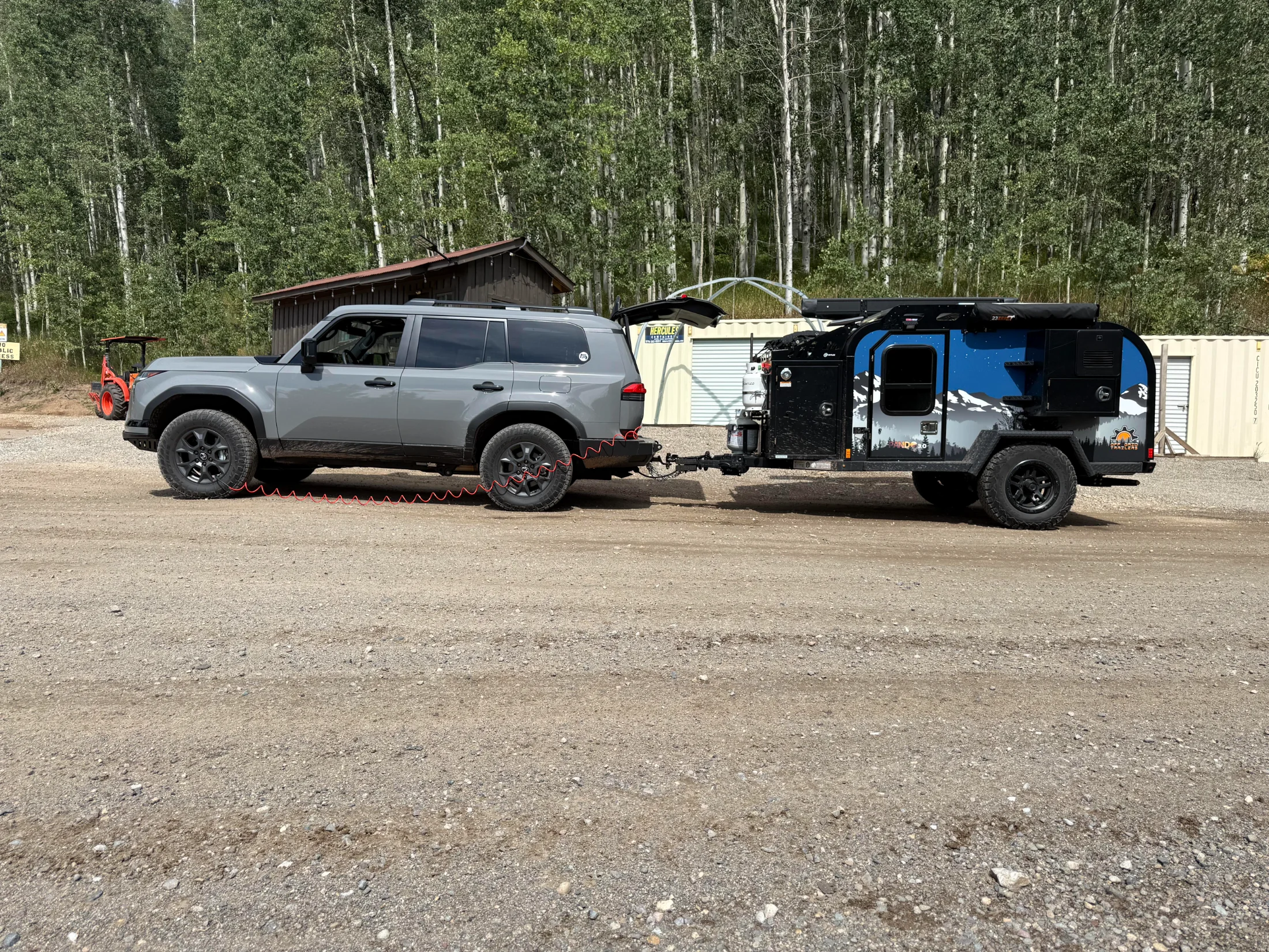

I've done premature suspension replacements on 2 trucks and regretted my choices so I wanted to keep my 2025 OT+ relatively stock for a while before ripping stuff out. I couldn't stand the stock rake so I did the Peak Suspension 1.25 inch front leveling kit. It's exactly what I wanted. No discernable change in ride, inexpensive, and gives the vehicle the more level stance I was looking for.

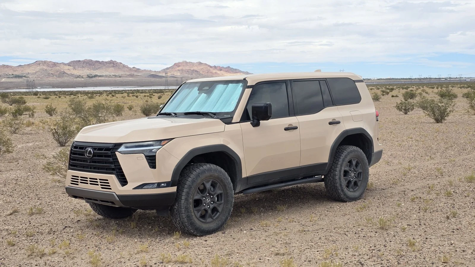

Appreciate the replies. Same here on the premature suspension changes. The Peak Suspension kit seems like a great option. Great looking rig BTW! Are those 275's?
I have 275-10r18 Toyos on mine.
285/75 17s (so essentially 34s). +25 offset wheels. No trimming, no rub.
Is that Earth or is it wrapped a tan color?
It was earth with the black roof, which I didn't like, so wrapped the whole vehicle in ppf. Color is claimed to be sandstorm.
