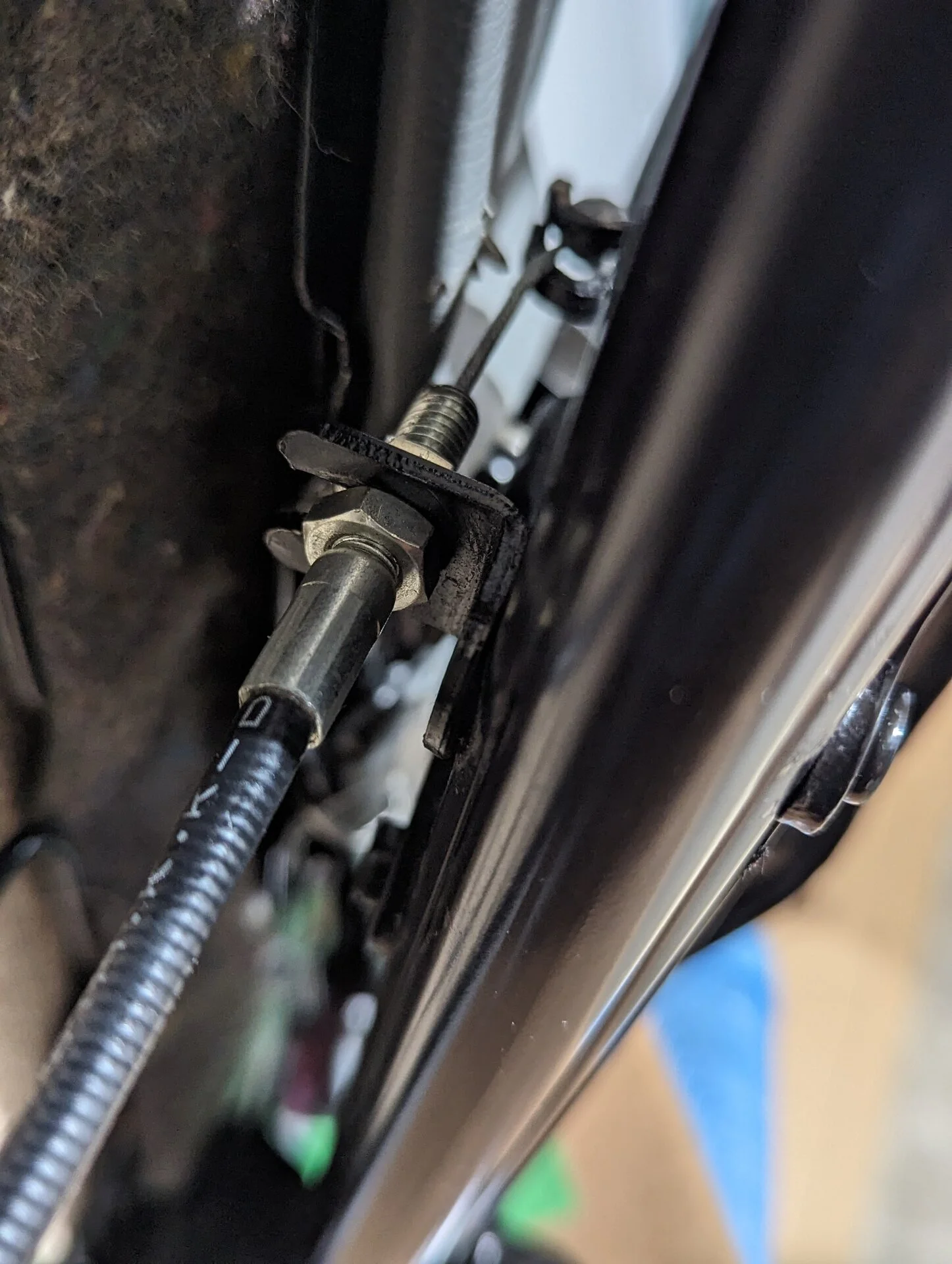

Pop Quiz: Identify the problem in the following image.
Yep! And we like to go to the Black Hills as well...
I'll hit you up when I head that way. 👍
Meanwhile...no takers on my Pop Quiz? No matter: here's the answer...
See that little cable and bracket on top of the seat slider? Yeah... that's on top of the seat slider; that flatly stalled out my plans to just weld up the proper length on the Corbeau and get it installed. Instead, I'm either going to have to drill out the spot weld, save this bracket and move it to the top of the Corbeau - because the cable actuator is actually kind of, like, important and stuff - or just remake this bracket entirely and still move it to the top of the Corbeau unit.

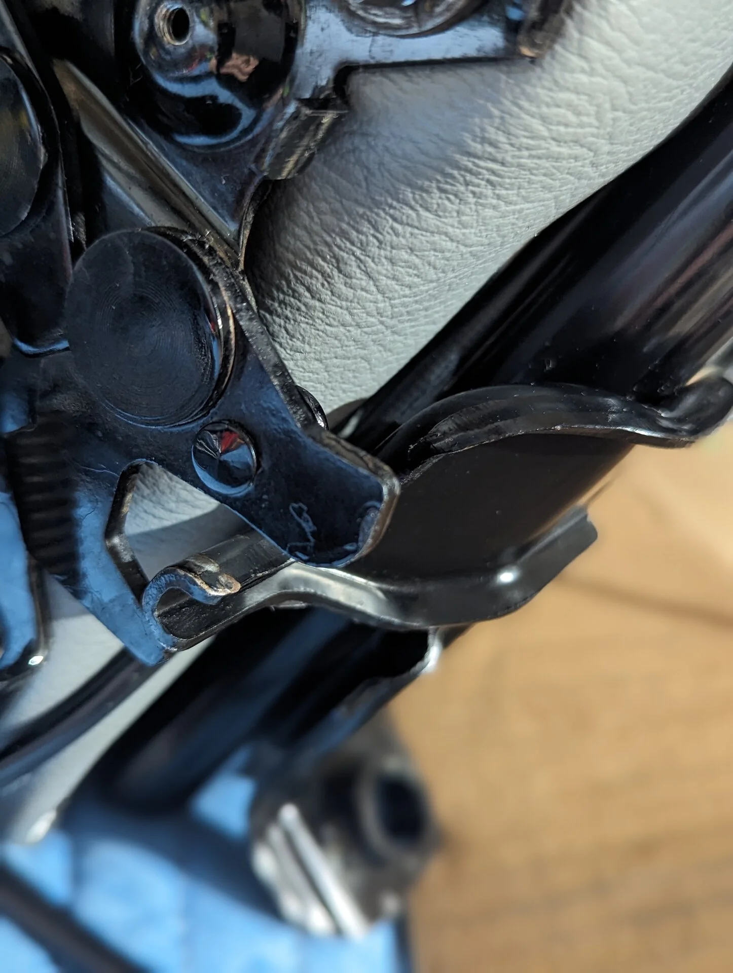

That's gonna take a bit of time...but wait! There's less:
Pictured: It would be easier if I paid attention, even just once.
Trip lever on the hinge release: move it downward an inch and it won't engage, which means the seaty no worky. I actually knew about this piece, but this is actually a simpler fix; I can either weld a small flag in place, or I can make something that slips over the lever and snugs into place. I kind of like the latter solution because it's not permanent, but it's a lot more work...but I need an excuse to learn how to run a mill or a 3D printer or something like that, right?

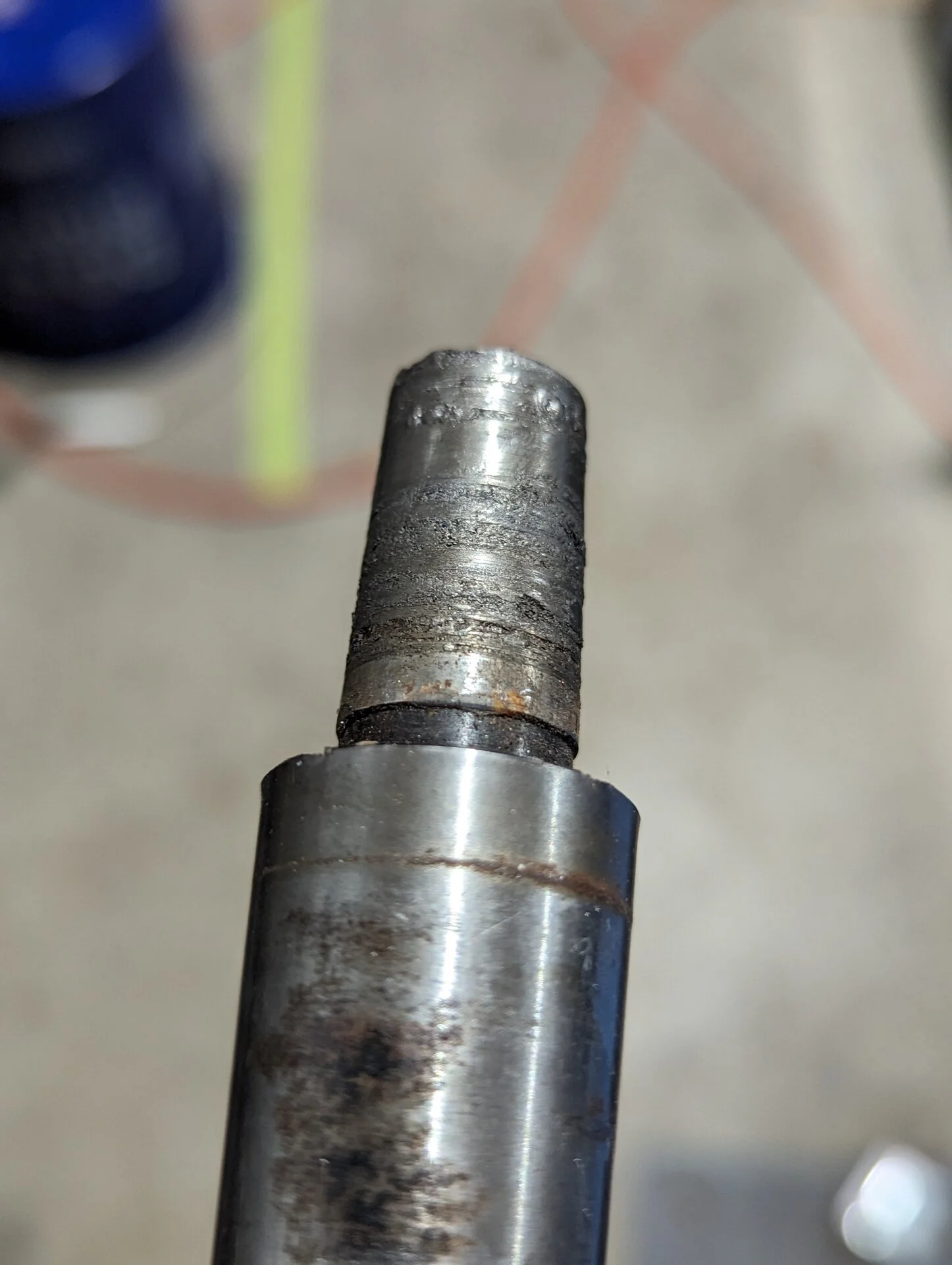

I wondered if it was just a bit of off-axis machining, so I threw a bit into it and looked again...and the tip of the bit was oscillating by somewhere around .05" to .06", which is approximately way too f****** much in any country with any sort of metrology. Conclusion: bent chuck arbor.
So... I popped the chuck off the arbor, which is a phrase that here means "I took an hour and ruined a set of wedges and a pair of pliers (don't ask) getting the arbor extracted. The chuck taper is a #3 Jacobs, and even if you have no idea what that means, the important part is this: once a tapered connection starts to give, it pops lose... because that's the entire point of a taper. So, you can imagine my confusion when the arbor started to move, but wouldn't come loose.
I'll spare everyone the details; here's what I found when the arbor finally came free:
Pictured: Correction: I've angered several gods.
I honestly don't know how one can gall a piece of hardened tool steel this way. Actually, no... I take that back. I do know: you can do this by being a complete moron and chimping your way to success. Specifically, you 1) fail to seat the chuck on the arbor correctly, B) throw a massive bit into the chuck, and 3) just keep on gettin' it when the bit stalls. Naturally, the inside of the chuck is basically trashed.
Pictured: Scrap metal.
I can't fix that; I don't think there's enough metal in there to ream it to a larger taper...so, I think I'm just going to have to replace it, and maybe pull this one apart for spares. So... I had to order an interim chuck that'll do until I can find a replacement Jacobs at a palatable price, or until I save enough pennies for an Albrecht.

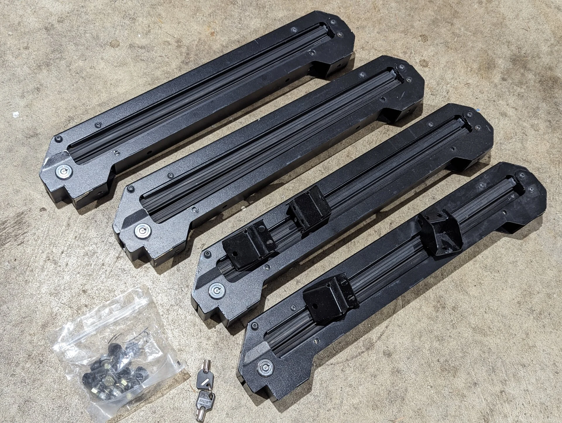

Speaking of deals: I just snagged these from forum member @HitTheDirt. $200 shipped and they're in good shape; can't beat that price. Now I have options for carrying...well, pretty much anything that's mostly flat and several things that aren't, now that I think about it.
Pictured: Pending that I ever get around to mounting the rack itself, of course.

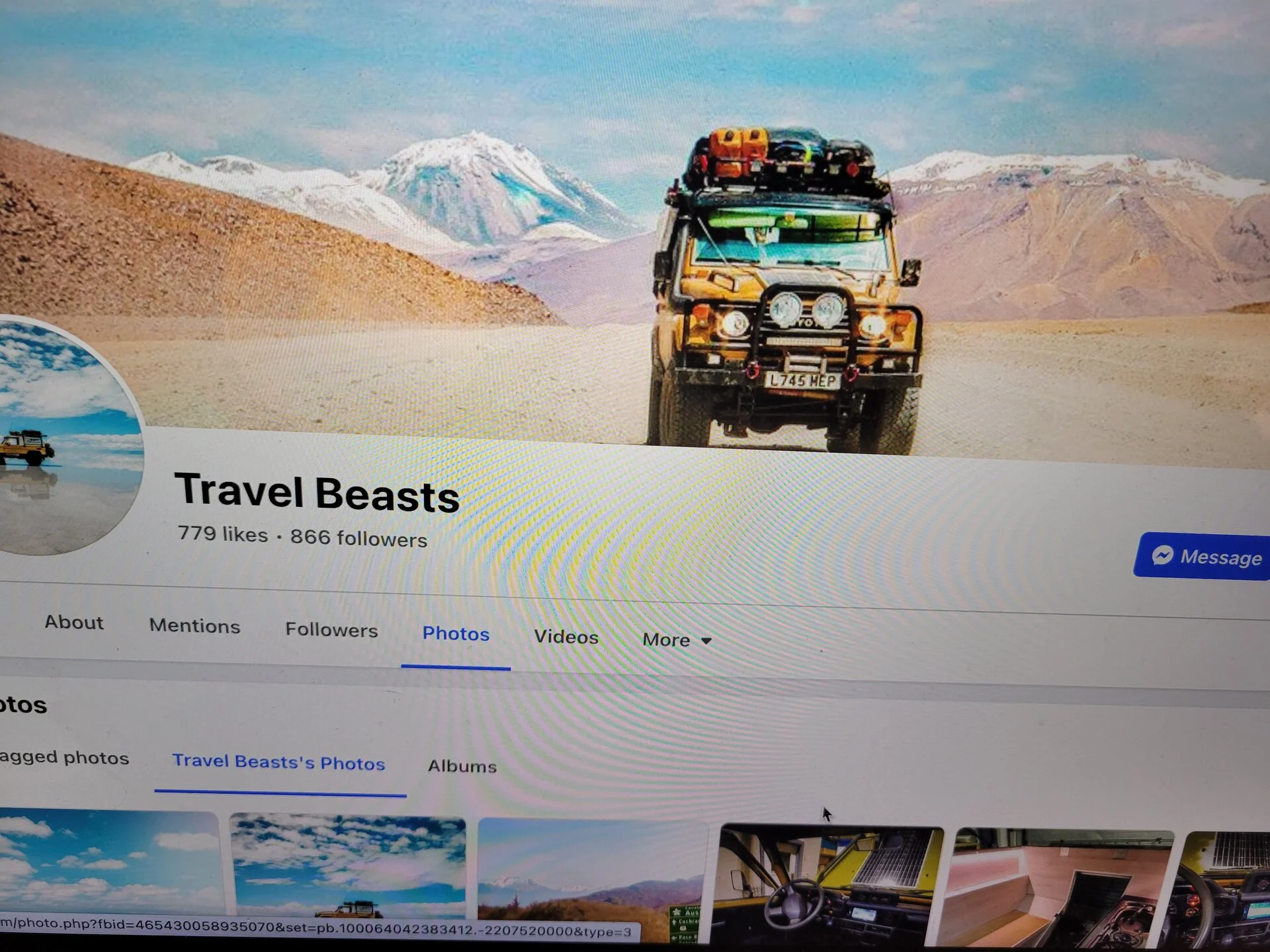

I know you were looking for a hzj73 rack idea. Came across this on Facebook. Pretty epic photography of a 73 traveling the world and a strong looking rack idea with a rooftop tent.

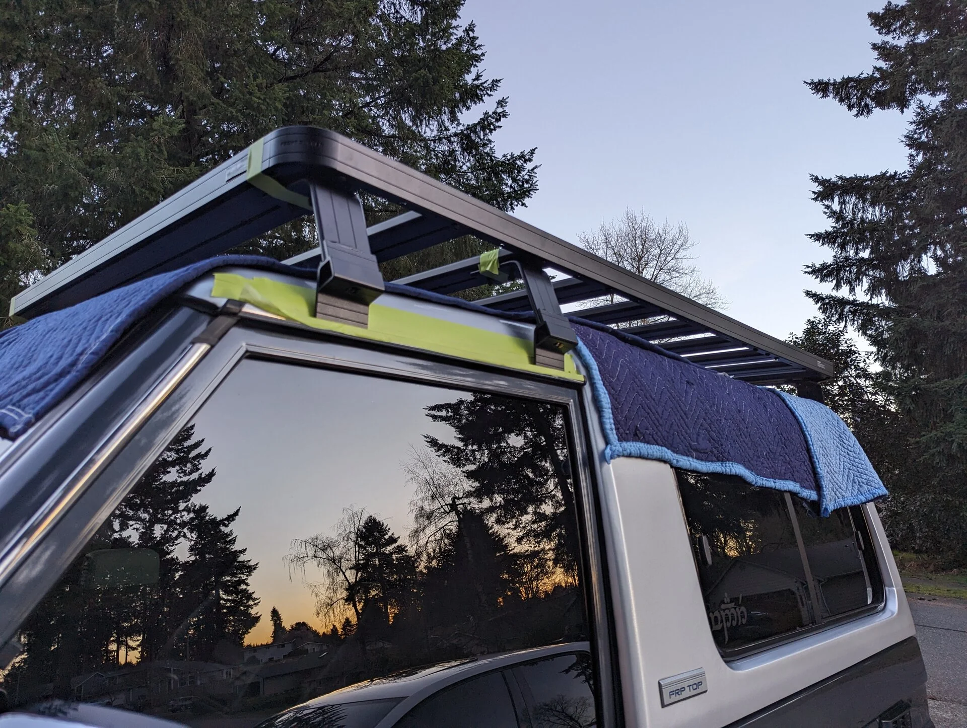

So, three important things to know:
First, I am alive and kicking; I'm mostly kicking myself, but that's a rather small point of contention in the big scheme of things.
Second - amongst some other things - this happened...
Pictured: Progress!
...and third, this happened.
Pictured: Depression.

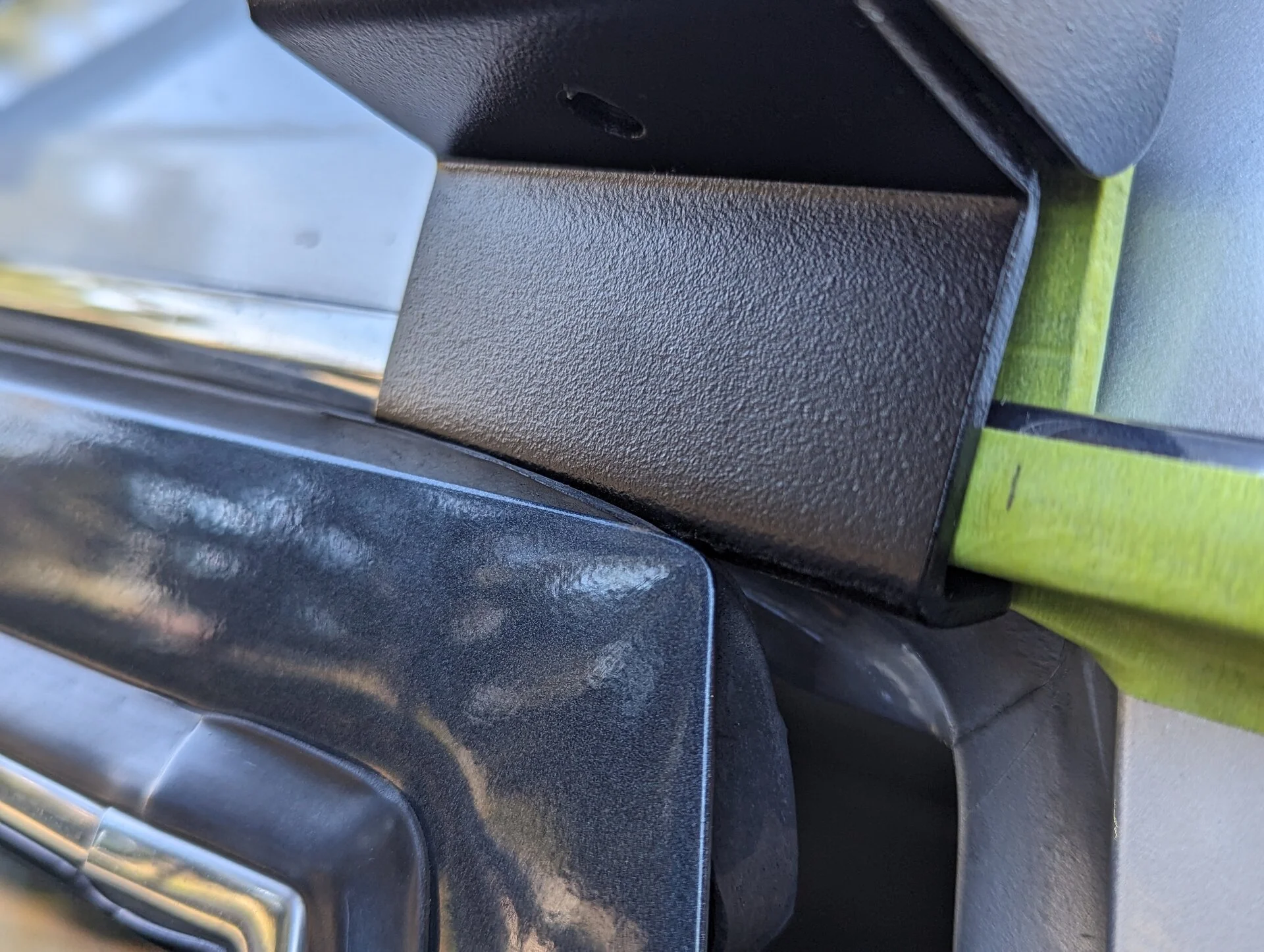

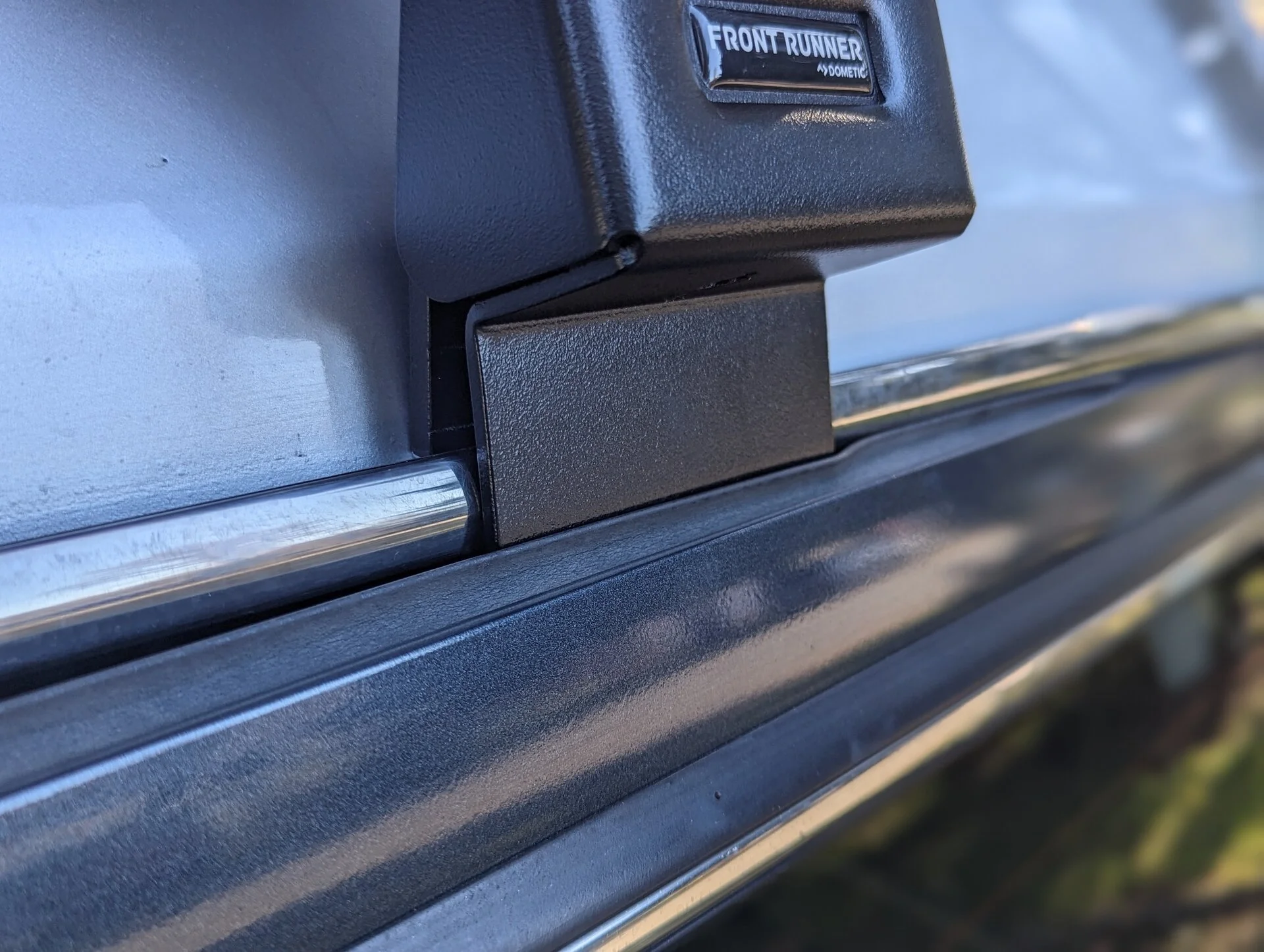

The rack went together...well, mostly-fine; I'm going to have to fix a slight problem that's being caused by it being used on a completely different vehicle than that which was intended, but that's a small matter. The bigger issue is that I can't use the gutter clamps at all; due to the ZX-package chrome trim on the gutters and tight tolerances at the rear doors, seven out of eight of the legs simply cannot be used. They fit into place and I even got them roughly shaped and adjusted so as to level the rack on the non-level and curved gutters, but the clamps are a complete no-go. To use them, I'd need to modify and refinish all of them, and find some way to adjust and move the rear doors in order to generate clearance...and that's not a winning plan when applied to a mounting solution that was supposed to be temporary in the first place.
So, solution: get started bending tube to make the permanent mounting solution...
...which would be easy, if I had a tube bender. But, I don't; anyone got one laying around that they aren't using?

You see that travel beasts roof rack? Why don't you do that. Guy drove it probably way overloaded to the tip of south America on mostly dirt roads and looks like the roof rack was holding up fine.

I'm glad, because this is a First Order Nightmare. When I'm saying that it's not even close to working, I'm not kidding; to get the front-door clamps properly installed I'm going to have to reduce the leg height on two of the legs to accommodate the rake of the gutter, modify their tops to allow them to seat properly against the upper portion of the legs, and probably re-bend the lower section. I see no way around the rear door issue without shimming and rehanging both doors to generate clearance...and even then I might be into a gasket or fitment issue. The gutter mounts were supposed to be a temporary solution in the first place, so I don't see the point in pursuing work on them; I'll leave them bolted on to help with placement later on, but that's gonna be awhile. Unless I can find a bender that I can borrow, I'm likely going to have to buy one...so I need to parse through some tools to get rid of in order to make room for that. Right now there's a small punch press and an Aamco shaper on that list; I really like them, but I don't have room for another large tool...so they need to go.

I sure did; I looked it up (as best I could with neither Facebook nor Instagram) right after you posted it...and I'm sorry for not responding to you earlier or acknowledging that post before now. That's a dope rig, even now with the camper conversion.
Two reasons:
  1. At least sixteen holes drilled straight through the body tub.
  2. A set of mounts that I likely can't replicate with my home shop tooling...at least not without doing some more snooping to see how they've made them.
It's a slick mount, no doubt; clamping the tub between those rack mounts and a backer plate would be a very strong solution. Maybe not gorilla-tier, but definitely chimp-level...but poking holes in the tub is a last resort for me. Been there and done that with too many Jeep tubs to want to do it to a nice Toyota...but if I can't figure a way to hold up the front, I'll need to rethink my position on this.
Right now, my plan is to look to the front hinge area and see what might work, there; failing a solution, I do like the idea that was proposed about sandwiching a mount between the top and tub. That's not a bad notion at all.

I wonder if they changed the designs of the legs. There’s a few of us running that exact setup without the gutter issues.
One of the issues is just my rig's top being a bit out of spec, I think; the doors fit well, but the clearance is just on the tight side. It affects nothing... except this kind of thing.
Two versions of the legs are listed in Front Runner's install instructions, but they don't seem to be very different in terms of geometry. Take a look at them if you get a minute; I'd like to hear what you think.
