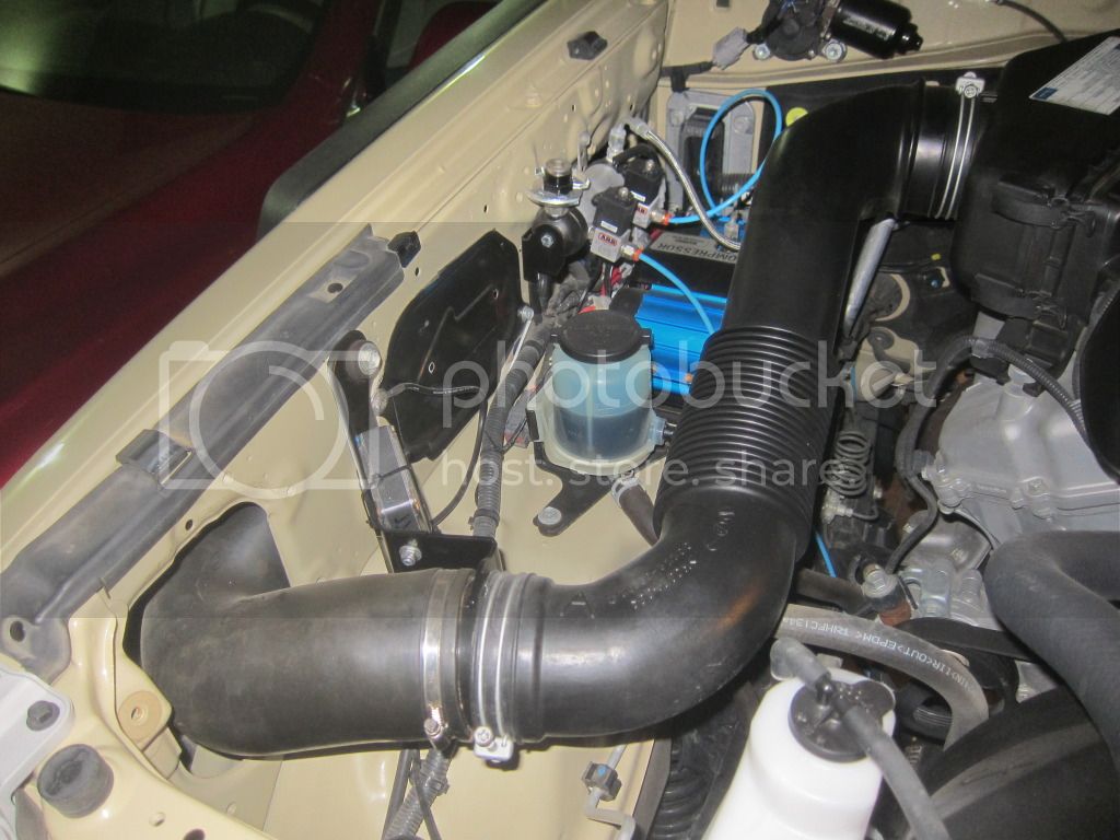

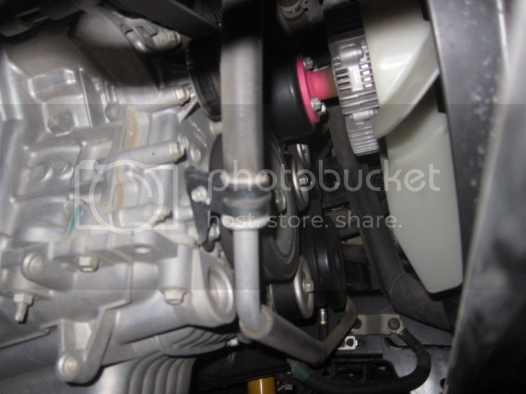

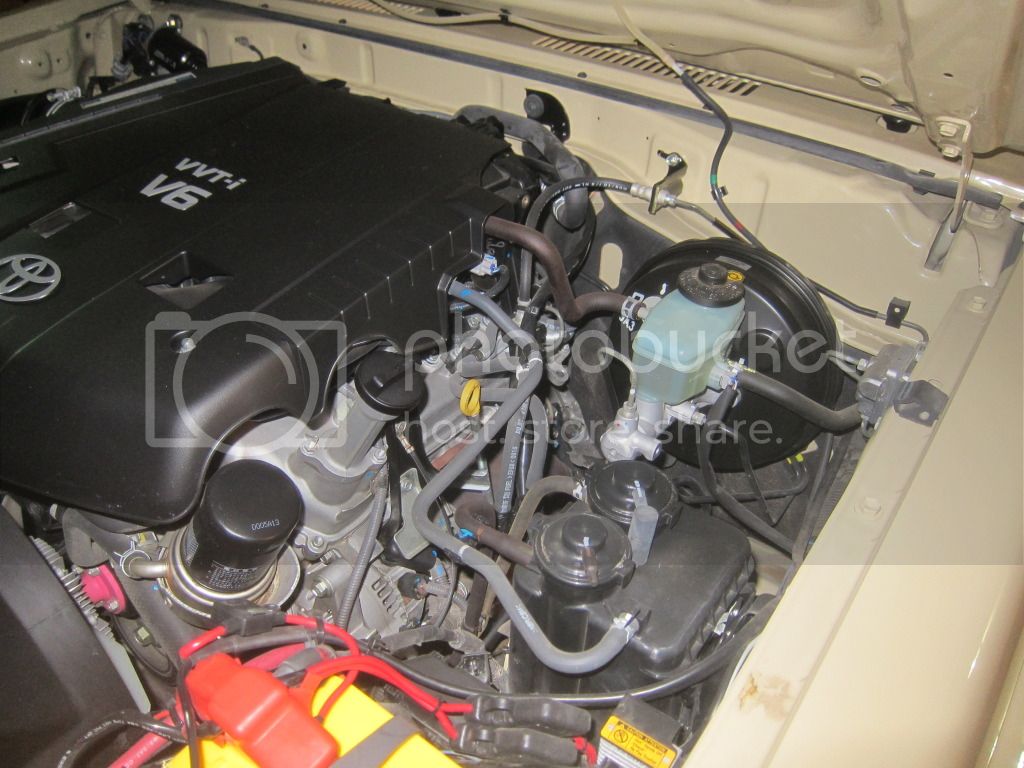

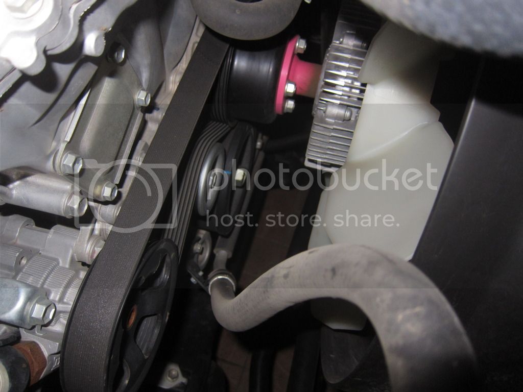

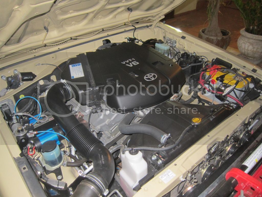

Post up some better pictures of the engine....did you say it was a V-6? I would like to see drive belt area and the sides as well. Is there only one gas engine selection for that vehicle? I assume so..
Here you go...
Drive belt area
thanks for posting up the additional pictures of the engine.... its amazing how they keep many things the same over time and then incorporate new engines/trans..etc

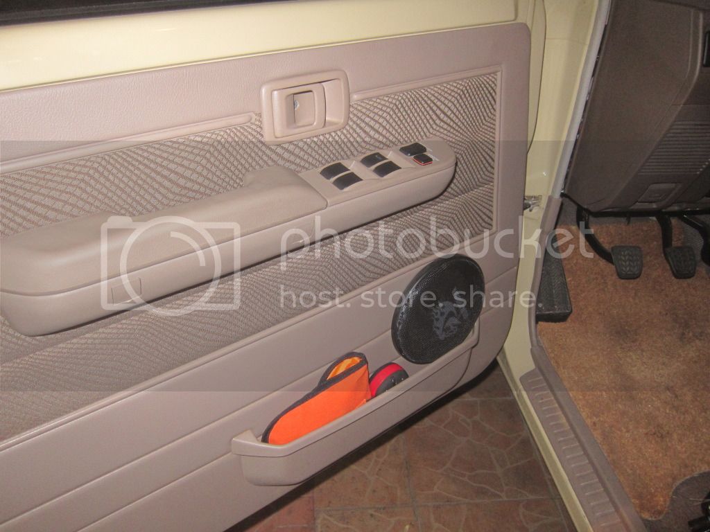

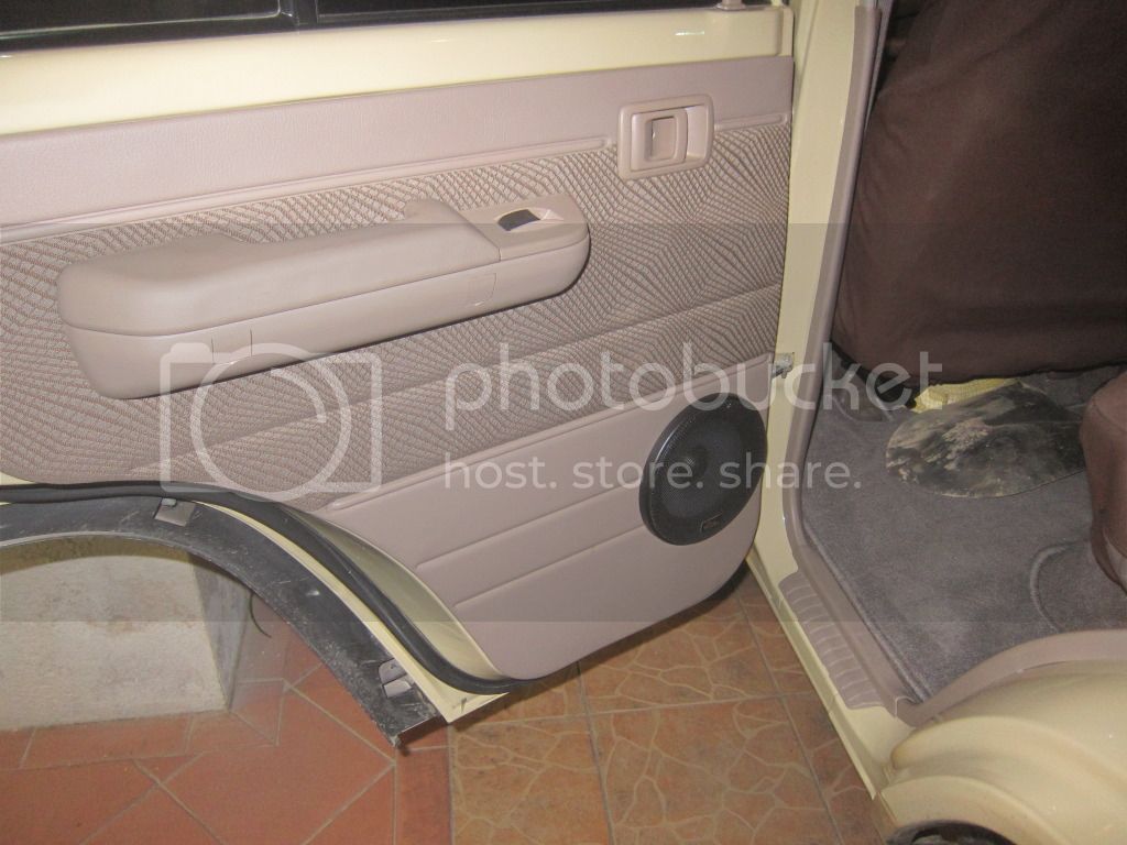

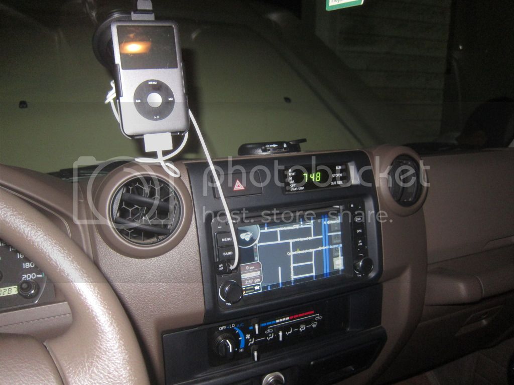

I believe its a Koolertron unit, used on the VW's. The installer told me they're available on the Corollas, but I cant seem to verify that, nor trust his input:hhmm:
It does have the wiring capabilities for installing a rear camera, and the ipod dock is also plugged in through the glove box, but I prefer running the ipod through the Aux socket as navigating my song list on the ipod is easier than on the head unit touch screen.
It is certainly a major upgrade from the factory unit, which only accepted cassette tapes:hillbilly:

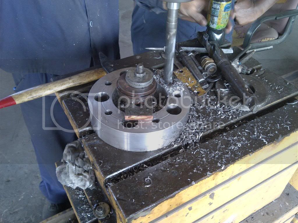

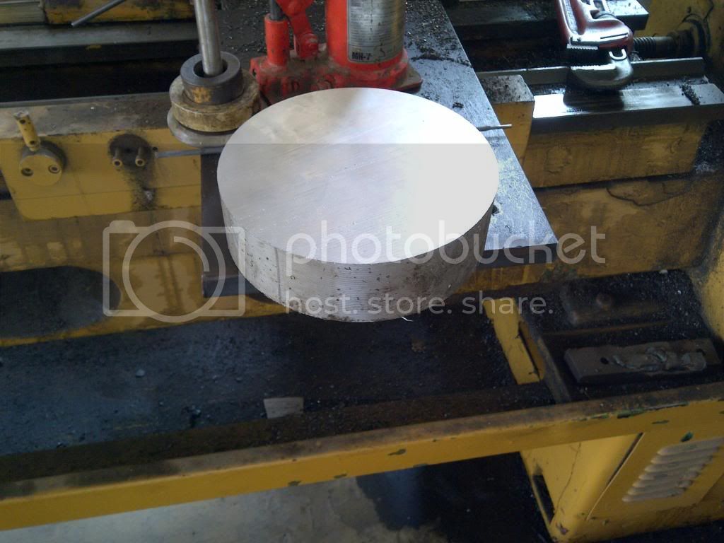

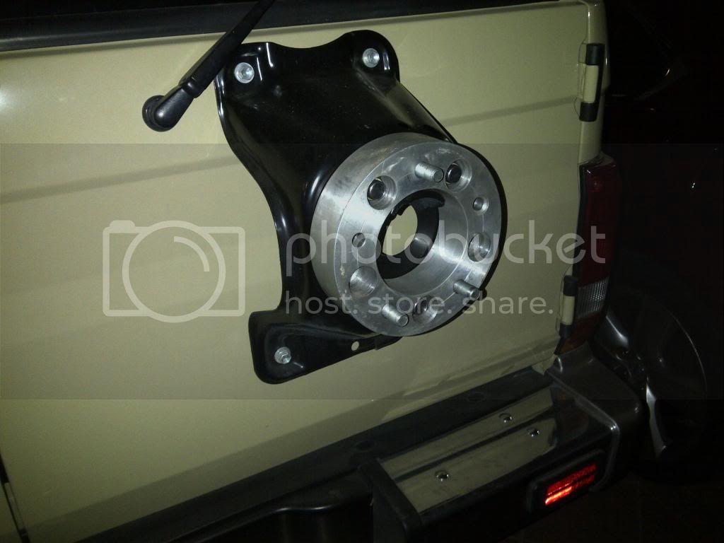

I had decided to upgrade to 315/75/16 BFG AT's, up from the current 285's I had. With the lift I have the 315's cleared no problem. The only issue was with the spare tire fitting in its existing location, as it hits the rear bumper and thus is not able to be mounted on the spare tire bracket.
Two options to rectify this were to move the tire bracket 2" up and about 1.5" to the right (so that the left barn door can swing open without hitting the tire). The other option is to go with a spacer. I didnt fancy drilling new holes into the body work, so went with the spacer option. The downside to the spacer is the left side barn door might not clear.
Had the 2" aluminum spacer made locally.
