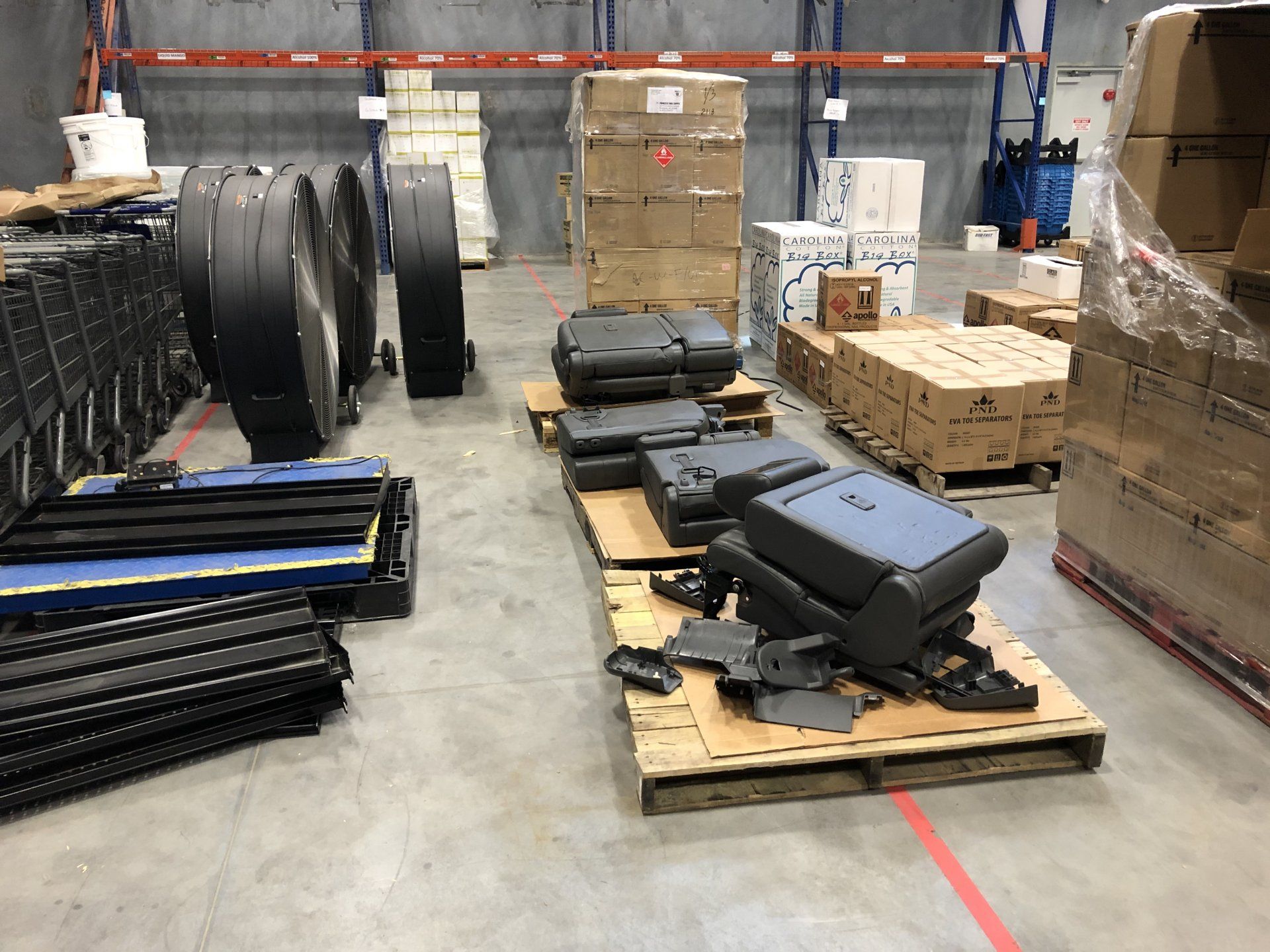

3rd row removal correct sequence:
Unlatch seat from wall, just enough to free seat
disconnect battery
Remove 4 bolts and electrical connection.
lay seat down gently
Reconnect battery
not the correct sequence:
disconnect battery
Undo bolts and electrical connection
Unlatch seat (no power rip)
Reconnect battery
Unlatch seat from outside while 4 bolts are out so that it crashes down violently.
Disconnect battery
Unplug electrical connection
Reconnect battery
I know @grinchy , I remembered what you said right after this happened, about the unlatching before battery disconnect. Thanks for trying lol.

I haven't ever disconnected the battery for third row, no airbags back there
well dang lol. I have a habit of disconnecting the battery before I unplug anything/mess with electricals. Good to know!

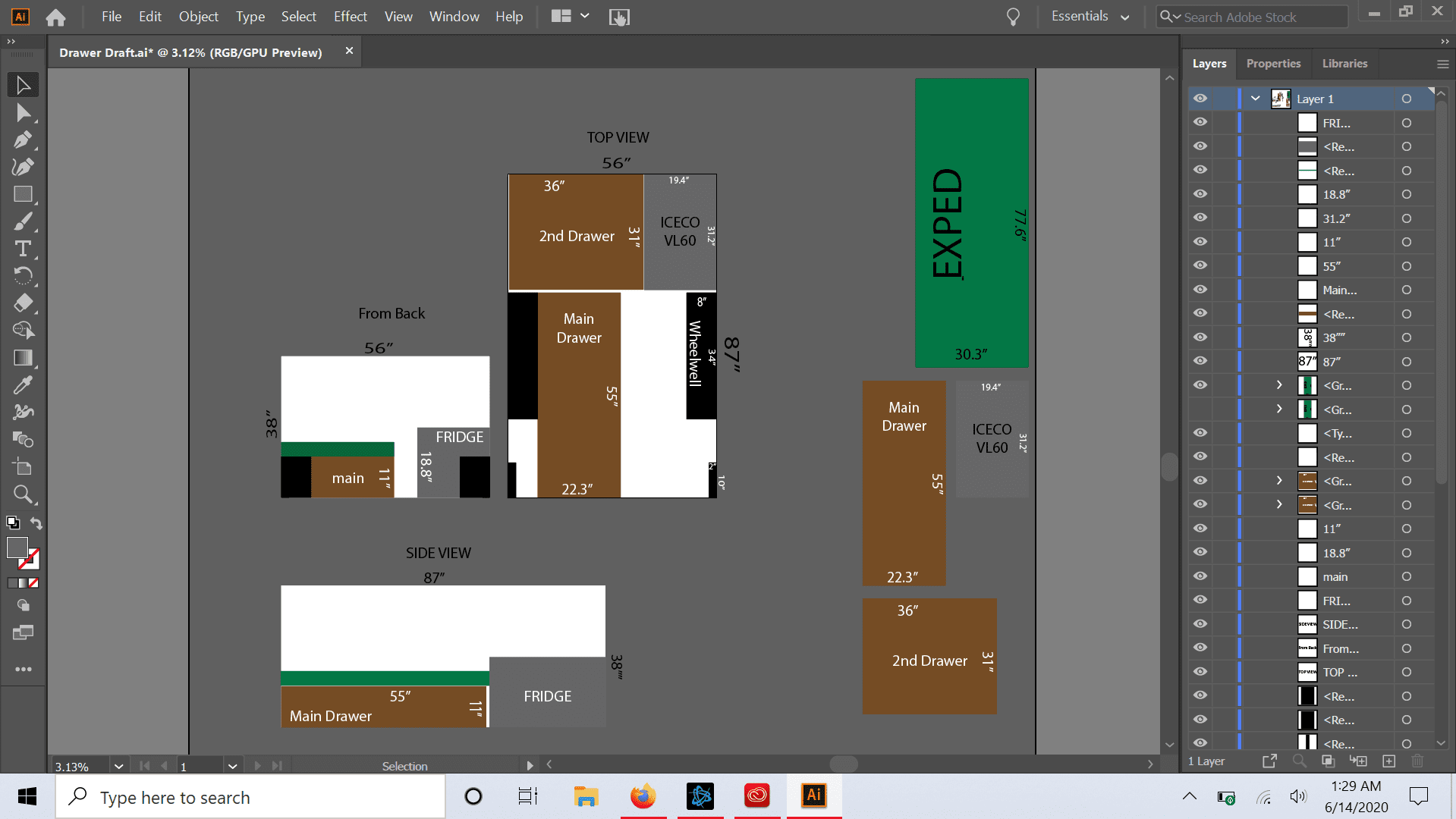

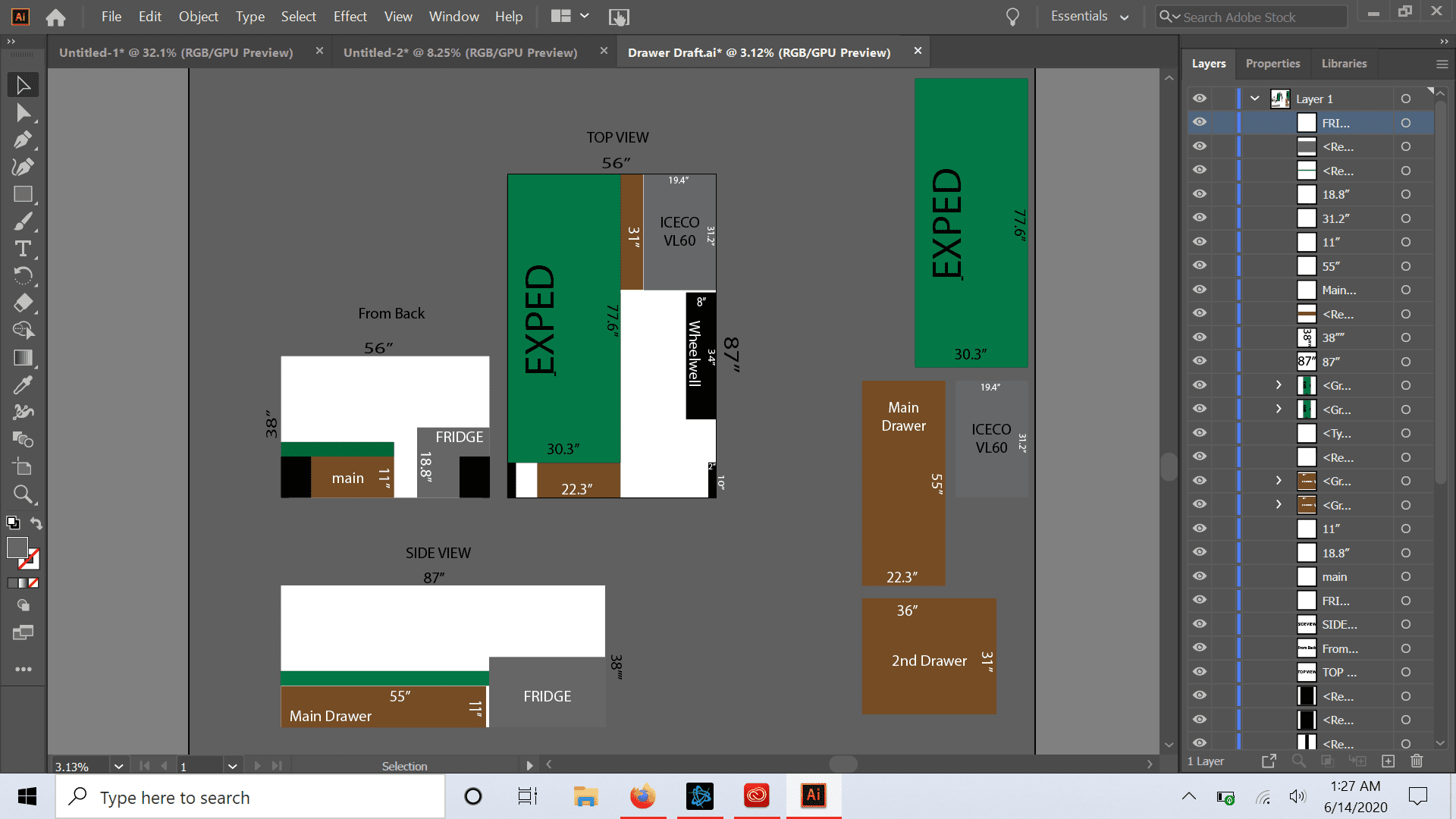

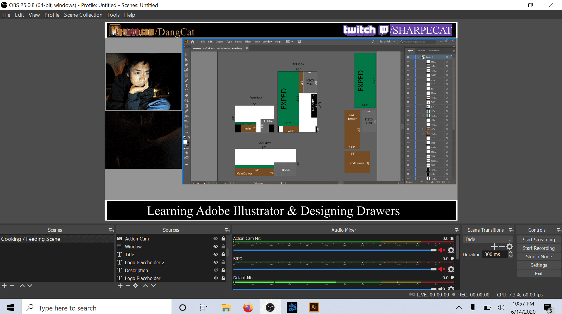

Made some progress towards designing the "270 series" drawer system today. Going to take a page out of the Troopy builds and taking out rest of 2nd row tomorrow.
2nd Screenshot is just me hiding the Exped so you can see whats underneath. This is far from finished but just wanted to share my progress in case you guys had some ideas to contribute. Thanks in advance!
Thanks Adobe for the Illustrator Trial! Very handy piece of software! I've been wanting to learn it for quite some time but never had a real need to, and now seems to be the perfect time to pick up a new skill!
@1world1love i decided to go with your drawer height of 11", because that is as high as i can go before my head hits the ceiling when im sitting on it. This is important when i plan on using part of the drawer to sit on and work during the day. I think what i'll do is fold half of the exped towards the front, then use remaining area to design my work area. I also plan on adding a way for tiger to get in and out.
Great progress. I like the way you are approaching it. So if I am understanding correctly, instead of having two drawers side by side with a full sized platform, you are planning a single, longer platform with two drawers end to end? And then you will have open space on the other side of the cab with the fridge mounted directly behind the passenger seat?
I think this makes a lot of sense and you can maximize the utility of the limited space.
It would be great to have the space that the troopy’s have, but it looks like you will have a pretty livable setup.
With the second drawer, are you planning a hinged lid? You could think about adding a hinged lid for the long drawer as well so that you could pull it out normally, or if weather is bad or you otherwise don’t want to open the tailgate, you can still access the drawer.

So today’s stream will be removal of 40 side of 2nd row, then I’m heading back into Illustrator to continue designing drawers. I also ordered a wireless earbud with mic, so I’m hoping the sound quality will improve in a couple days.
My whole approach is to recreate the things I plan on putting in the car as digital assets, that are properly scaled, and from there it is just a matter of resizing drawers and playing Tetris in Illustrator with my digital assets. The idea is to have the drawers be tall enough for my tallest item, which will likely be the Genesis Basecamp system, and wide enough for the widest item.
Basically, I’ll be measuring all my things that I plan on taking, and designing things around that. This is a perfect opportunity for me to reconsider what goes back in the car, after having taken everything out.
Thanks! Although you guys need to cut it out :rofl:, all these compliments has me all flustered. I’m trying to stay humble over here!
This is a very rough draft, as the area on the right is not finished. I was tired and called it a night before I got that far.
but yes, like usual you are correct! I was thinking a chest-style drawer behind the drivers seat, and a long drawer behind that.
Then on right side, fridge likely behind passenger seat then a cabinet system/table/surface to work on behind the fridge (from wheelwell to back). This is the trickiest part because I am building it taller, so might need to build a little wall on right side to anchor it to. Also building around the wheelwell, so have to plan well to get the most storage space.
I think doing a hinged top on the long drawer/sleeping platform is brilliant! Will do that for sure.
I was thinking, if I go cabinets on right side, that I would do a hinged long piece of wood on the right side of the bed drawer, that can fold up at night to fill the gap in between the 2 sides (space for my feet and Tiger to lay on during the day), so that the exped is fully supported. Hopefully these 2 photos will help you see what I mean with the hinged piece filling the gap.
Alternatively, and I really like this idea, I can take a page out of the van dwellers’ book, and do a table that lowers at night to even out the bed! I feel like it’s meant to be, because in the same picture are those hinged drawer tops you recommended.

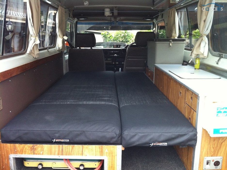

Really enjoy following you on this thread through your adventures. Harkens back to a time for me when life was simplier. So much of my effort these days is spent in managing unnecessary stuff.

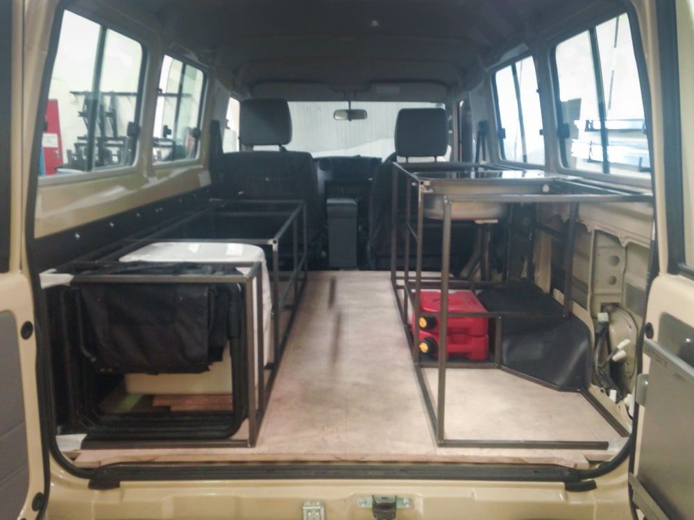

I've seen a few troopy carriers built like you've posted. Great layouts I'm pretty sure the 200-series interior is actually longer and wider. Personally, I think I'd leave at least a 40 rear section as an entry point, comfortable seating spot, and place to toss stuff.

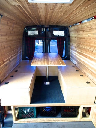

A few ideas for you.
For cabinet construction, consider using aluminum stock, rivets, and machine screws/lock nuts. You'd be able to reproduce much of what you have as examples in your pictures. Much lighter construction than what we typically see here with drawers which honestly is overkill, heavy, and takes up too much volume itself. 1/8" hardboard riveted or industrial double sidded taped in for divider panels. Hung on piano hinges for cabinets with latches to close. 1/4" hardboard for load surfaces., supported by aluminum stock as necessary for wider spans.
Aluminum is relatively soft and can be worked with most wood working tools and even hand tools. A vice, hack saw, file, drill, riveter would cover all that's needed to work it. Could cheat and use a jig saw or sawzall.
Forget fancy slides. Plastic bins, even cloth bins, fit to cubbies is what I'd do. Use basic strategies like bungees or rotating stops across the face of openings to retain bins.
I couldn't find much online, but this vid gives you an idea of how aluminum stock can be leveraged to build on.
You've probably seen 4xoverlands build. The guy is too long winded, but I like some of the stuff he's done over the years

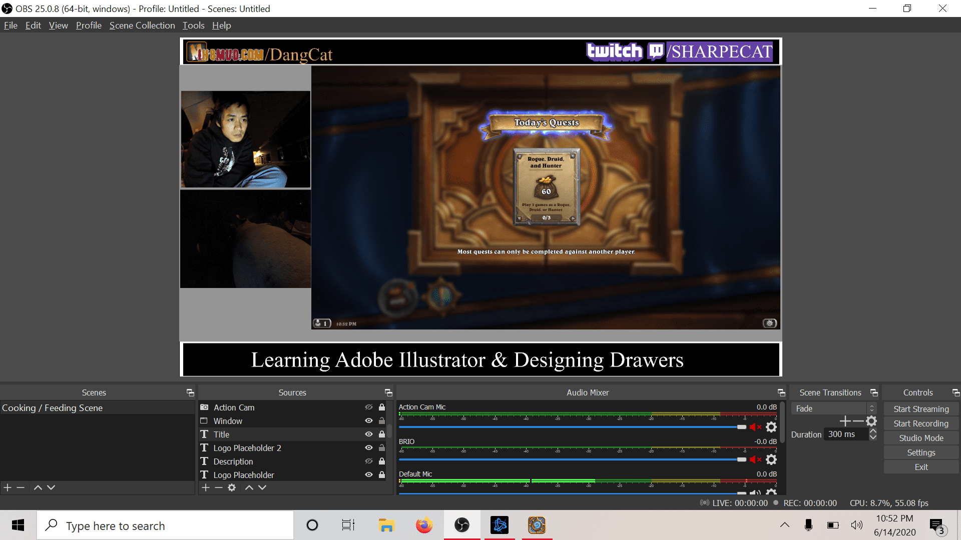

Well the plan for tonight was to work on progressing the drawer designs.
But what actually happened was i started messing with the stream layout, and then decided i actually want to play some Hearthstone.
I got all day tomorrow lol. I can work on it while i'm at Makerspace tomorrow. It will be nice to be surrounded by all the tools i need for the project as i am doing my research!

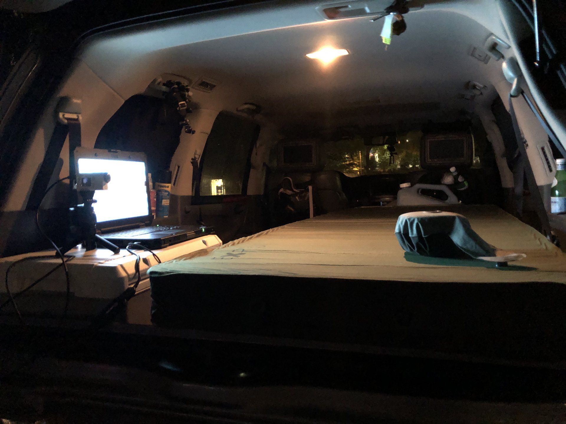

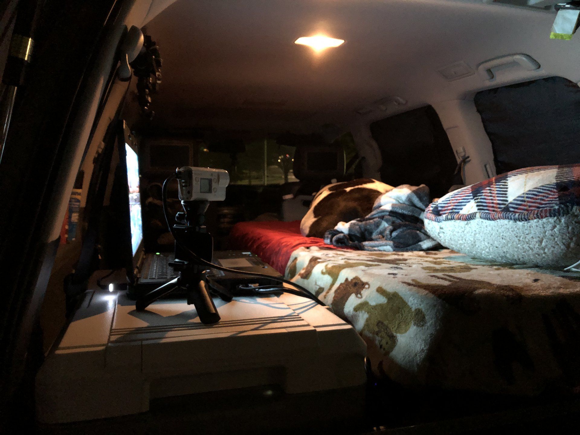

My Jackery Solar panel came in, just in time to test it in rainy conditions lol.
My dad also gave me his old electric cooler to use to fill the gap until I get something more permanent!

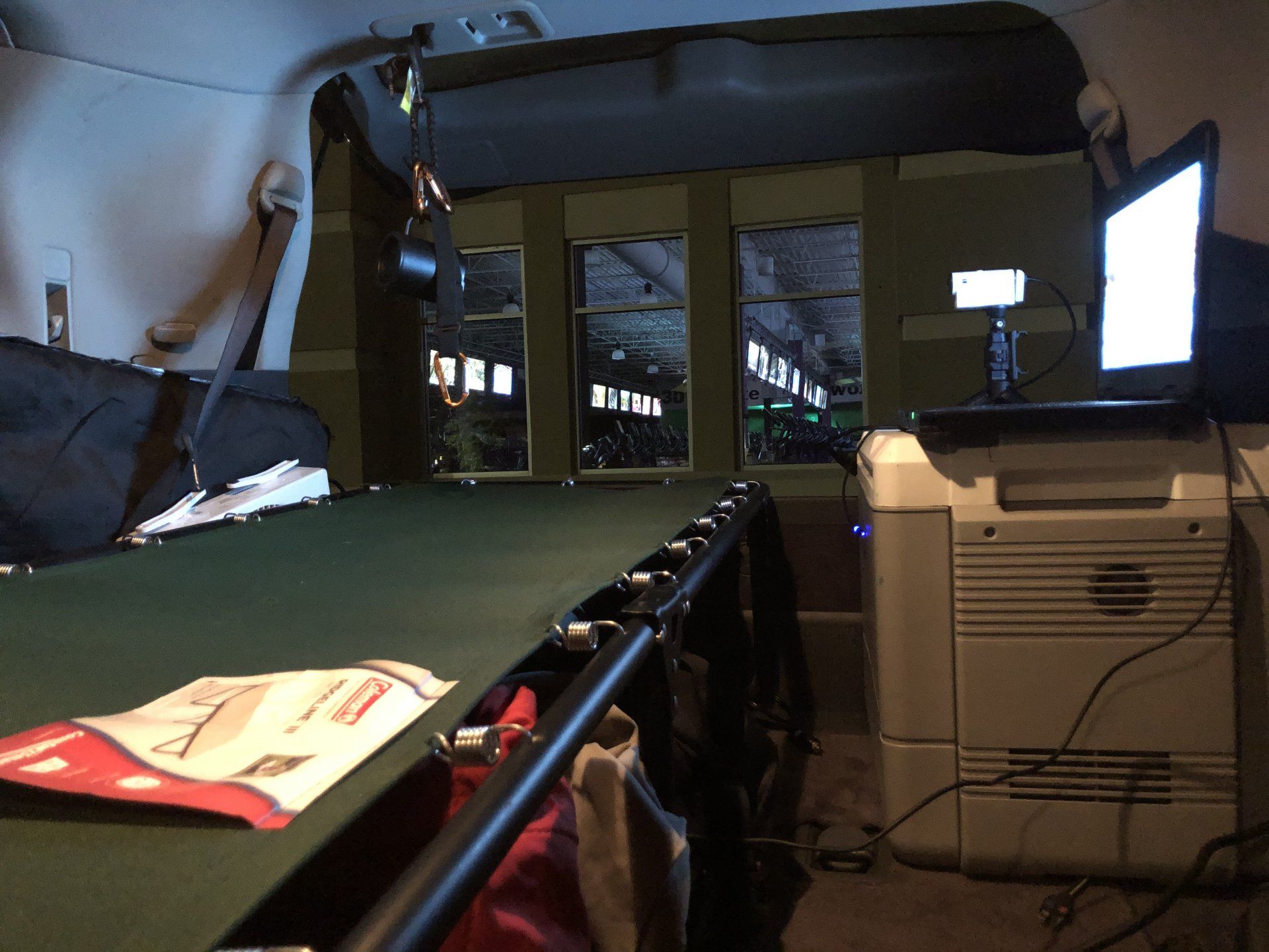

I also grabbed my uncles cot that he no longer uses, to get me by until drawers are done. The cot is 15 inches high and even then I can still sit on it and Still clear the ceiling, this means I can raise all the drawer heights to up to 15 if needed. Tiger can climb into it even at 15 plus exped, as long as he is in the car first (leave a clear entryway area).
That gap in between the cot and cooler is actually big enough for my feet, so I can sit on the cot and use the cooler as a desk for now. Drawer updates are coming soon, you can get a glimpse of them at the end of yesterday’s stream. I have been working out connection and sound issues so I apologize for some of it being laggy or if it sounds like it is picking up multiple mic frequencies (44 and 48hz at same time).
