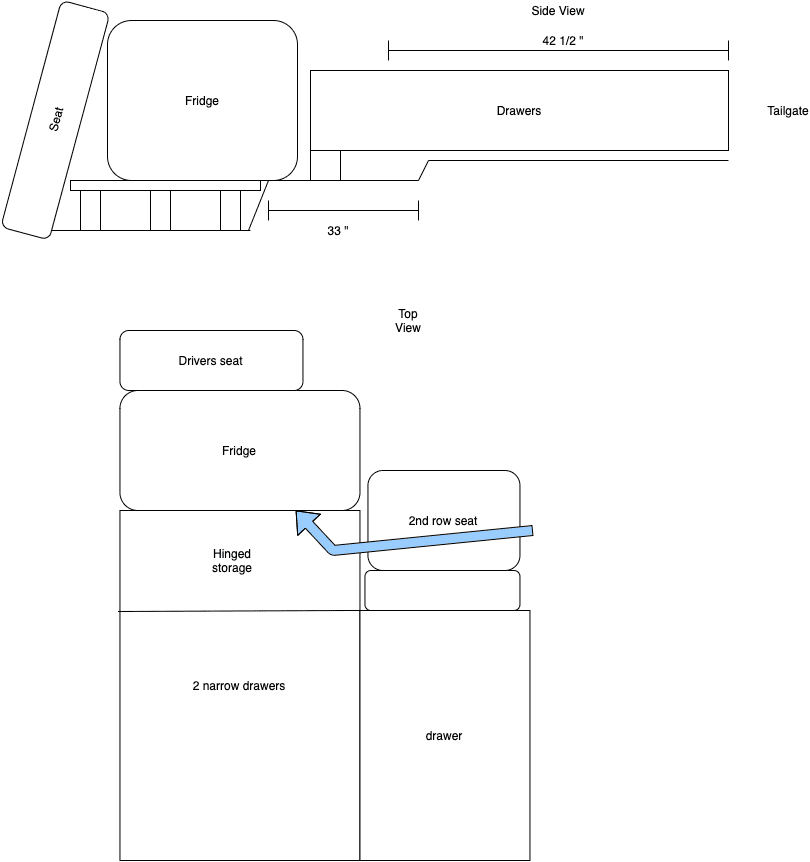

I went out and took some measurements just to try to understand a bit more. Let's take the fridge model above as our example. Again, you may move an inch or two one way or another, but all fridges in that size range are going to be about the same dimensions.
It looks like the 60 part of the second row would just be able to accommodate the fridge at 33". You might consider this - leave the 40 side in and build a platform on the 60 side that would extend the flat part where the seats are mounted so that you could mount the fridge as close to the back of the drivers seat as you can. That will depend on how far back you need the drivers seat to go.
For the drawers/platform, you go with 11" so that you can use the 40 side for your exped.
The fridge wouldn't be flush, but you would have a series of small "steps" required for the dog to get up there.
He can step into the cab on the 40 side like he does now. He can then step from the seat to the platform, and the platform to the fridge. None more than a few inches.
Something like this?
With the above, you would have a fair amount of room on the platform. Your exped would be tight over the 40 seat, but it will fit. But then you have tons of room on the platform otherwise. The dog can sleep there or climb up on the fridge.
Construction would be fairly simple, but you should consider building it as two separate carcasses. You would want to split the 60 side of the platform into two narrow drawers and a hinged cubby. You could do that all as one carcass though. The other carcass is a simple box with a single drawer.
The platform itself would otherwise be exactly the same as mine except your two sections would be different dimensions. You would also have a hinged extension on the 60 side.

you are amazing! Thank you for doing this as I imagine it takes some time to draw those up. looks good to me and this saves me a lot of time! I plan on printing this out once it’s finalized and taking it to Lowe’s to have them cut the wood for me. You also answered my question regarding the exped on 40 side, since I have been using it on the 60 and it fits just right (with third row in).

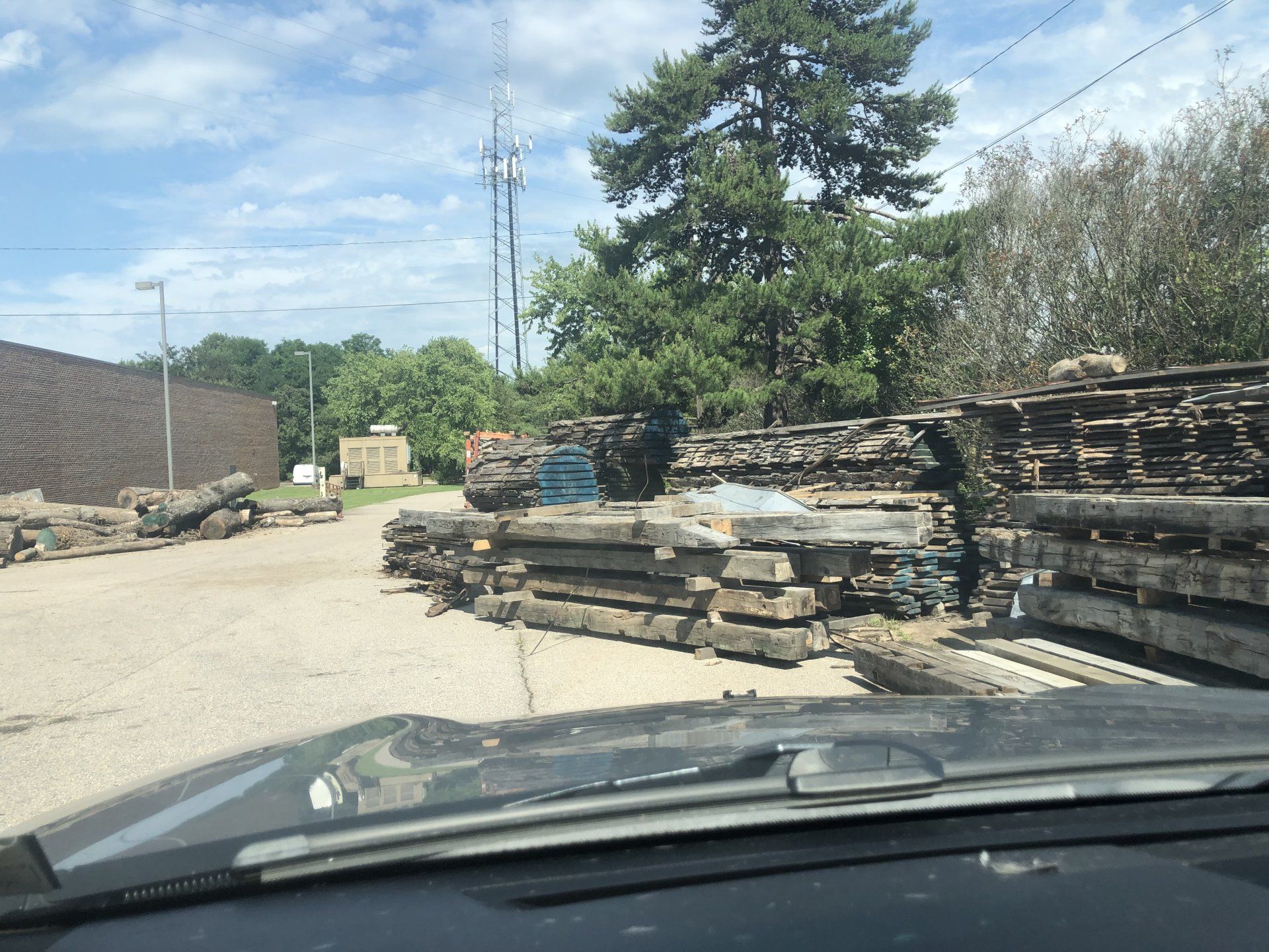

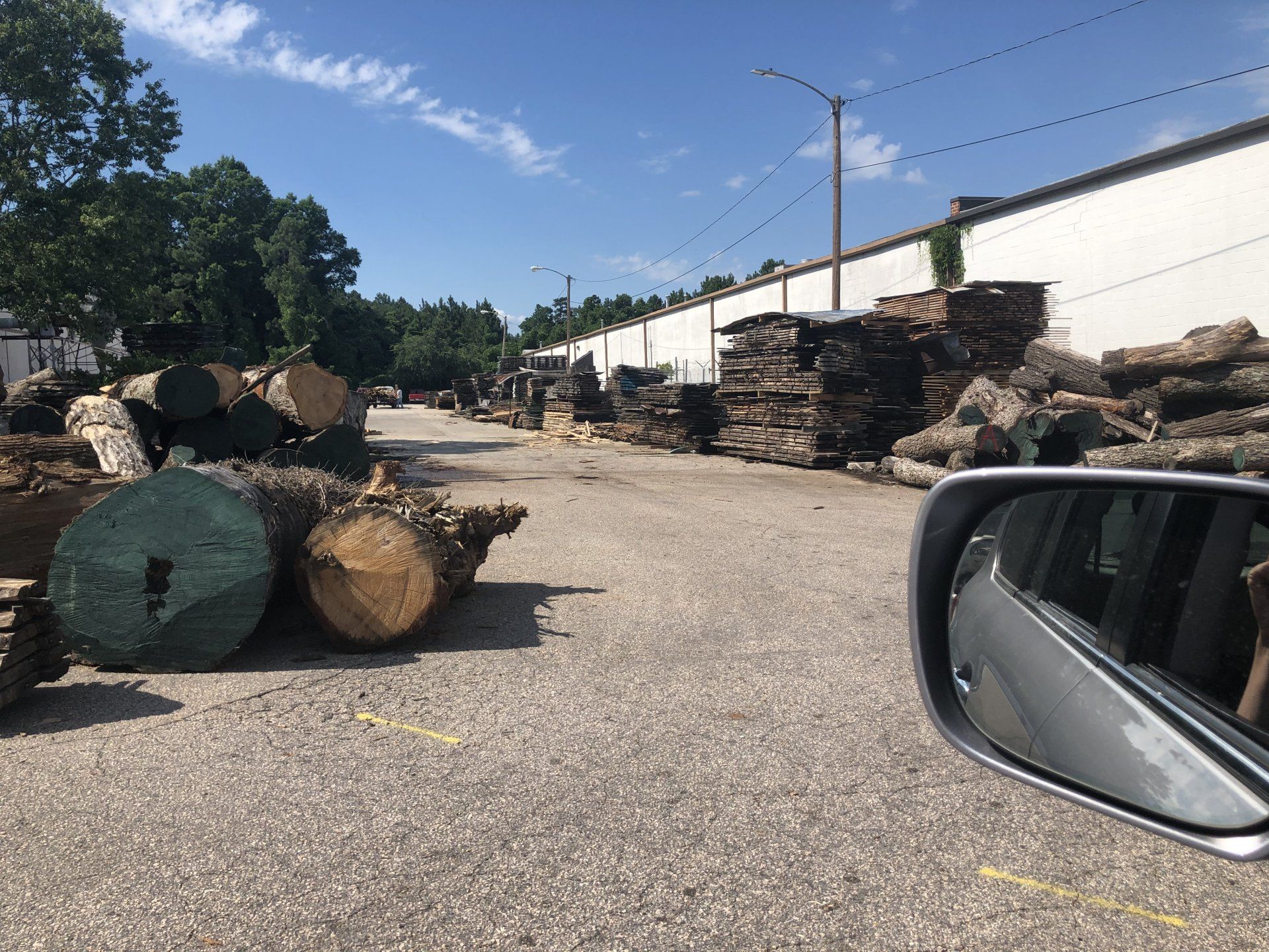

I know that you have a Lowes gift card, but if you are able, you may consider sourcing your lumber from a reputable shop and then using your gift card for your hardware, tools, paint, and other finishes.
This is what you want: Woodshop Services - Capitol City Lumber
Also consider that you are in the furniture making center of the US, so you may be able to call around and see if one of the many shops can help you. In addition, there are lots of cooperatives where you can "buy" shop time in an actual wood shop that is preequiped with everything you need.

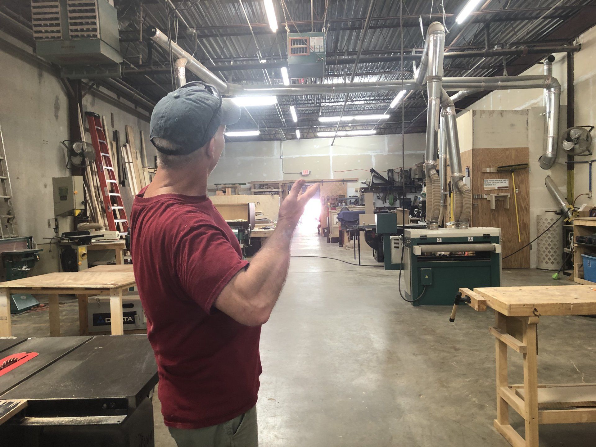

Spoke to the people at Makerspace in Raleigh and they are very friendly. To join myself I need 50 for a safety course and it’s 100 per month, if I wanted access to the shop and use the tools myself. I told him I only needed to build 1 set of drawers and do not have 150, so he offered to let me come in and hang out and look for someone to “employ”. On top of that I told him I’m trying to document the process for building these drawers, and he said I can bring my camera/stream from there!
Got a few things to do then I’m going to spend a little time at makerspace and hopefully figure a few things out. I’m excited as I have been curious about these for a few months now (first heard of them when I was looking for places to charge my electronics).

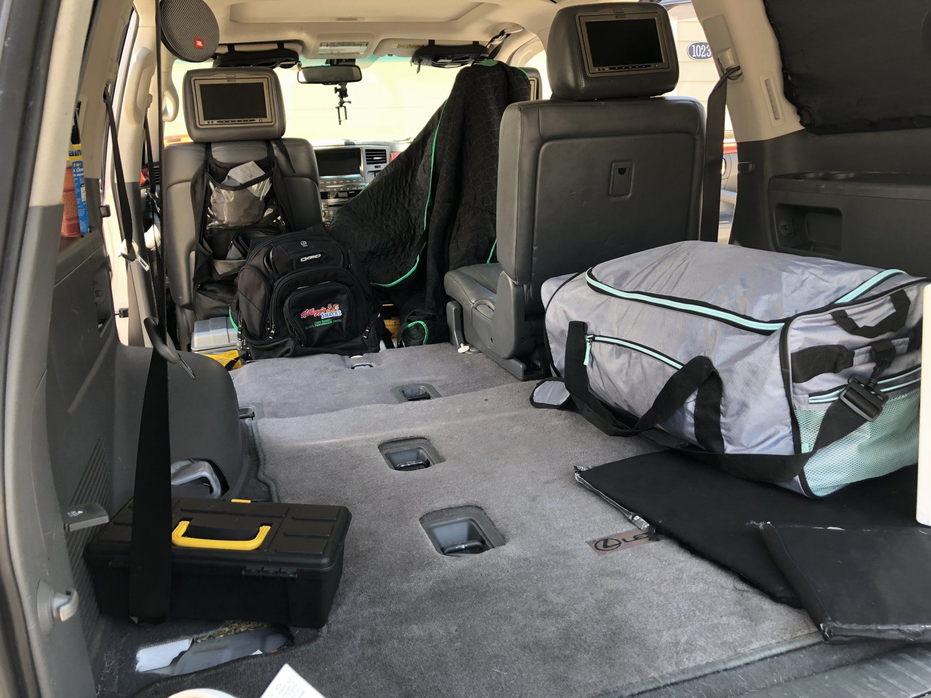

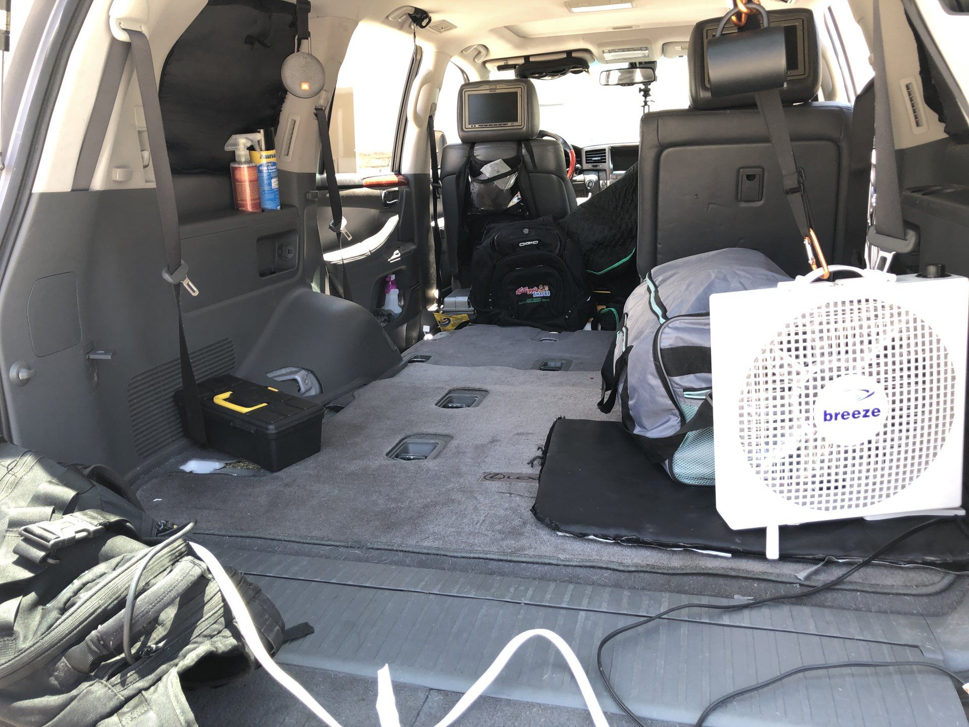

Leaving this here to use as my “Before” picture. Hopefully a week from now she will look much different!

Didn’t take the cam in today, but My visit to Makerspace went GREAT!! The guy who is helping me is a very modest and nice guy, who is full of knowledge when it comes to woodworking. I learned so much in my short time there.
He is going as far as sourcing cheap materials that are strong, to cutting and joining and even engraving it for me for a modest price. I plan on engraving the ih8mud logo onto it because these drawers and the ideas that go into it are gathered from here. I am making some minor modifications to help secure certain things like my genesis Basecamp system (a big cup/pot holder) and power stations.
next step is to document the entire build process! I will be spending a lot of time here at Makerspace working with James, And ultimately I hope to make it a little easier for others who are trying to do the same. Thanks to everyone who has paved the way, and I hope I can pay it forward with this project.
