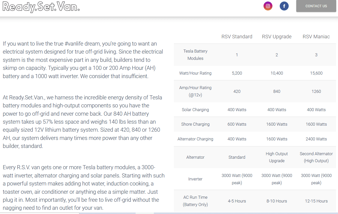

Research post for Tesla Modules, will edit as i dig around.
This company does it on a regular basis.
Update from previous video (1 year later).
I don't plan on doing something that nice, but will leave this here as a base for comparison in terms of cost.

Okay mud, That's about $4k total, can it be done for half of that with less capability?
Just let your requirements drive the solution. Really sit down. Write down. What do I need. What do I want. How do I go from now to the first useable state (Minimum viable product) to the end state. How much of what I have now can I or should I reuse. . . How fast? How much? What parts bring the most value now? Later?

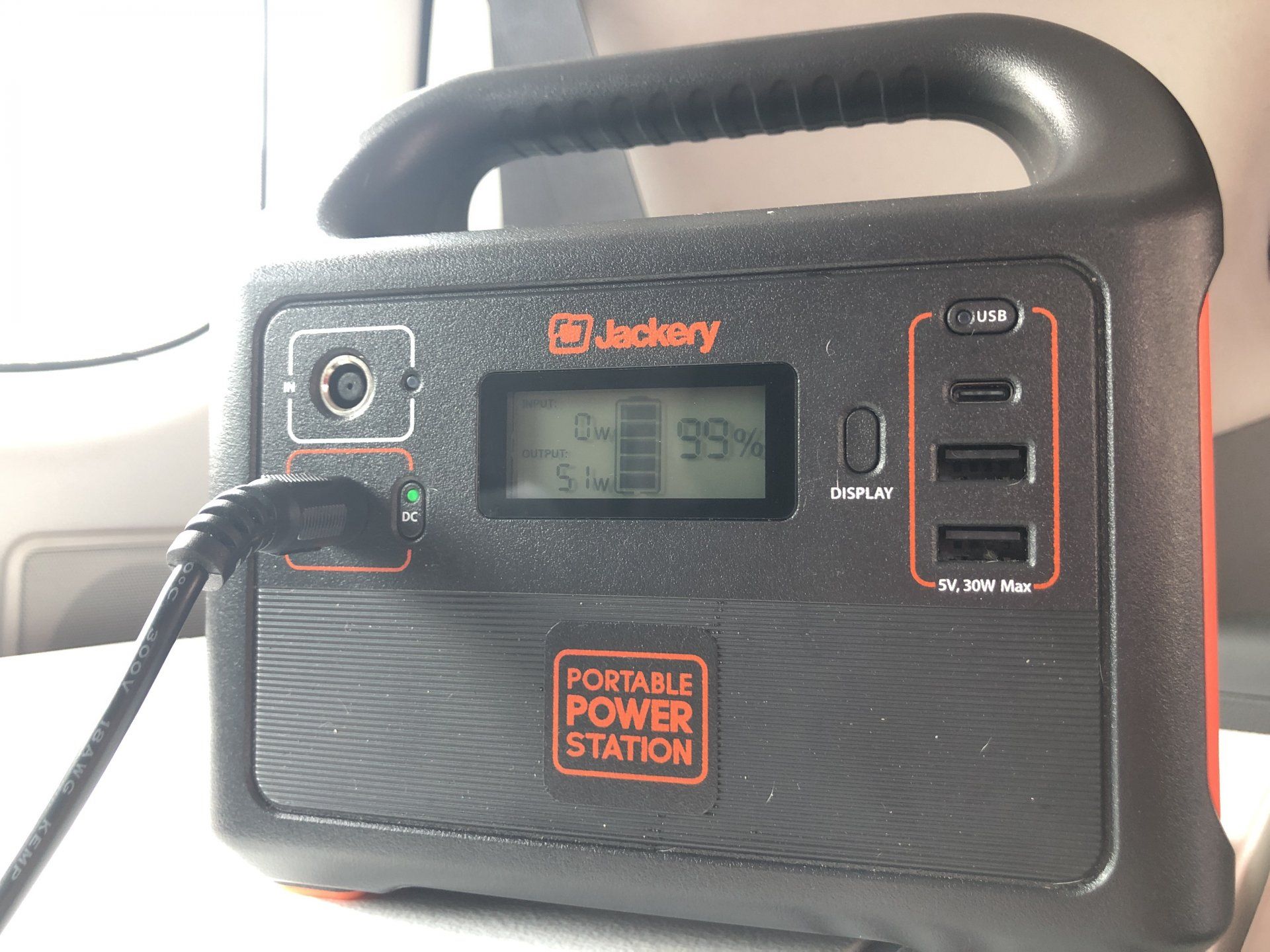

Thanks for the sanity check. I woke up from my nap and now I’m leaning toward that AC200. too much of a headache trying to safely fit the Tesla BMS and figuring out how to afford it. That and 45% off is too good to pass.
Going to go ahead and plan to be one of the first 200 to get the AC 200! Alarm is set for before midnight!
Now I’m left with just enough for the drawers and food and gas for next month, maybe 1 more solar panel, and I’m okay with that. I will have to earn my IceCo fridge by doing a good job organizing the group buy, and if not I’m more than happy with the electric cooler for a while. Thanks dad!

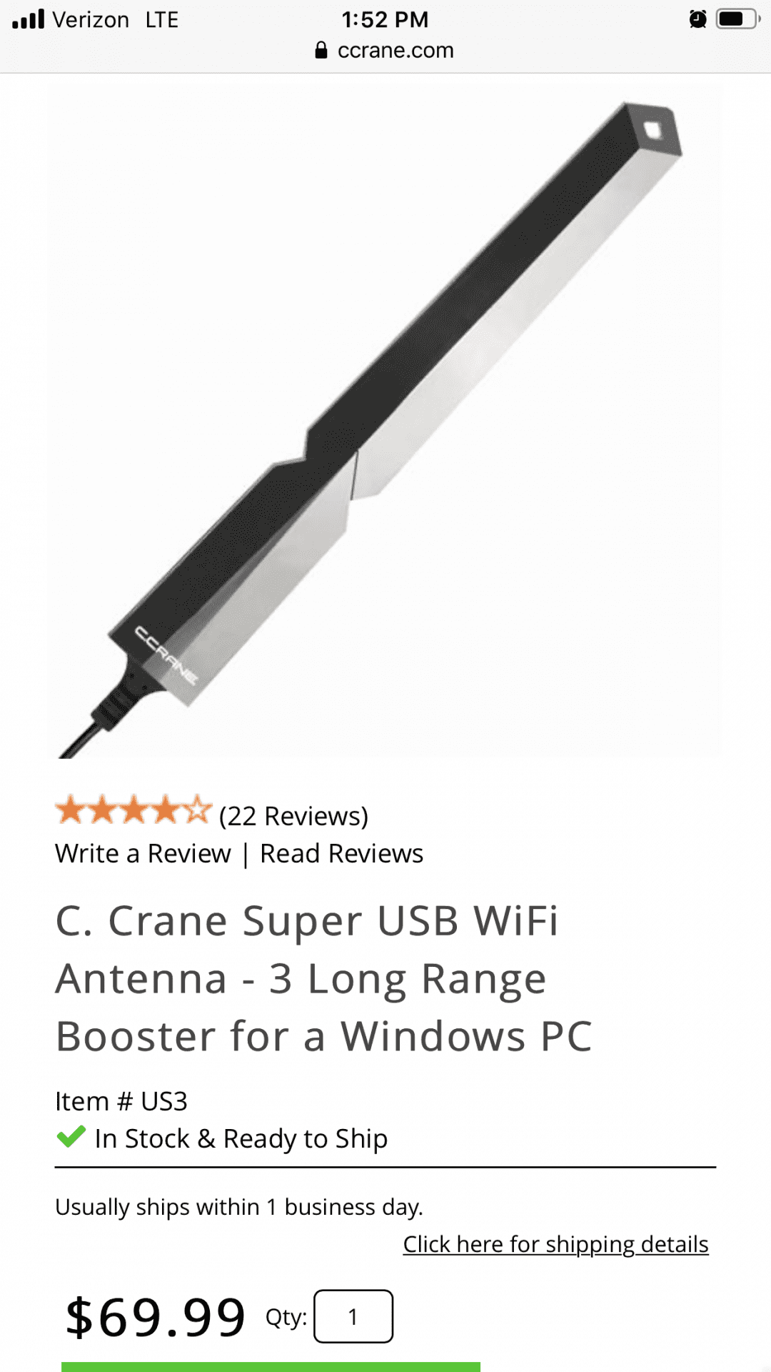

Might budget for this instead of a second solar panel this month, so I don’t have to park right next to the building when I’m using public Wi-fi. Even then the connection is iffy in most cases. This plus the Wireless transmitter/ receiver on the cameras (going to laptop) means I can run the stream for potentially a couple miles from a Wi-fi source (Assuming Line of Sight).
I could place the laptop and this antenna at the furthest point from source of Wi-fi, that still has adequate signal, and from there extend the range another 300-450 ft via the HDMI transmitter and receiver. This also helps me work around the fact that the Wi-fi signal is much weaker when the laptop is inside the car, versus outside. With this it would be hardwired (ethernet) and it won’t matter where the laptop is.
It’s nice to not have to take the laptop when I need to move to camera, to make this possible. If I had to move the laptop with the cam, I would not be able to run Ethernet for a more reliable connection, nor would I be able to extend the camera feed past the Wi-fi range via the wireless HDMI transmitters & receivers.
If that isn’t strong enough signal/I’m too far, then that’s where the bonder device will come in and combine the Wi-fi with cell signal(s) to form a strong enough connection. Ideally I prefer to rely on Wi-fi because it’s free, versus paying for multiple unlimited cell plans, but depending on location Wi-fi may not be within range. In most places cell signals, at least a weak one, will be present.
Might budget for this instead of a second solar panel this month, so I don’t have to park right next to the building when I’m using public Wi-fi. Even then the connection is iffy in most cases. This plus the Wireless transmitter/ receiver on the cameras (going to laptop) means I can run the stream from almost a quarter mile from a Wi-fi source (Assuming Line of Sight). I would place the laptop and this antenna at the furthest point from source of Wi-fi, that still has adequate signal, and from there extend the range another 300-450 ft via the HDMI transmitter and receiver. This also helps me work around the fact that the Wi-fi signal is much weaker when the laptop is inside the car, versus outside. With this it would be hardwired (ethernet) and it won’t matter where the laptop is. It’s nice to not have to take the laptop when I need to move to camera, to make this possible. If I had to move the laptop with the cam, I would not be able to run Ethernet for a more reliable connection!

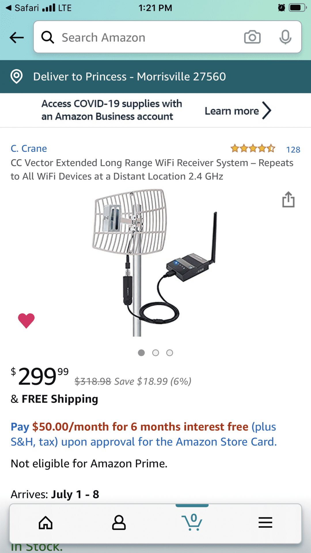

How is that antenna aimed?
I assume it rotates horizontally, and pivots vertically, but I will check.
oh and I underestimated its range, it is .5miles to 3 miles according to manufacturer. I Was thinking 500 ft because of reviews mentioning they tested it at 500 and it worked well.
What I'm getting at is that aiming these highly directional antennas isn't a casual task.
Right. And I was thinking it will be for cases where I have line of sight and know where the Wi-fi source is.

Oh wait a min I spoke too soon, there are thousands of omnidirectional antennas out there. What is the most important spec, how many decibels/strength of antenna?
and I assume claims of up to 7 miles are highly exaggerated for an omnidirectional? Otherwise that would violate FCC regulations if signal was that strong I think.
this might be another case of buy 3 and return 2 lol. Sorry Amazon, it’s for science!

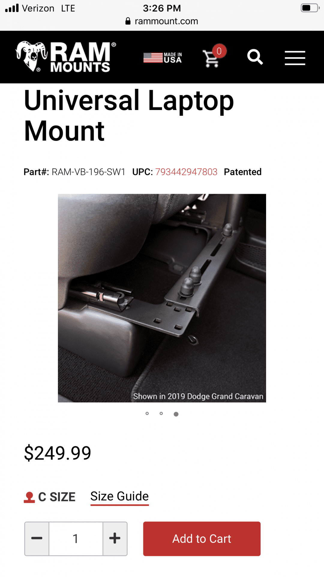

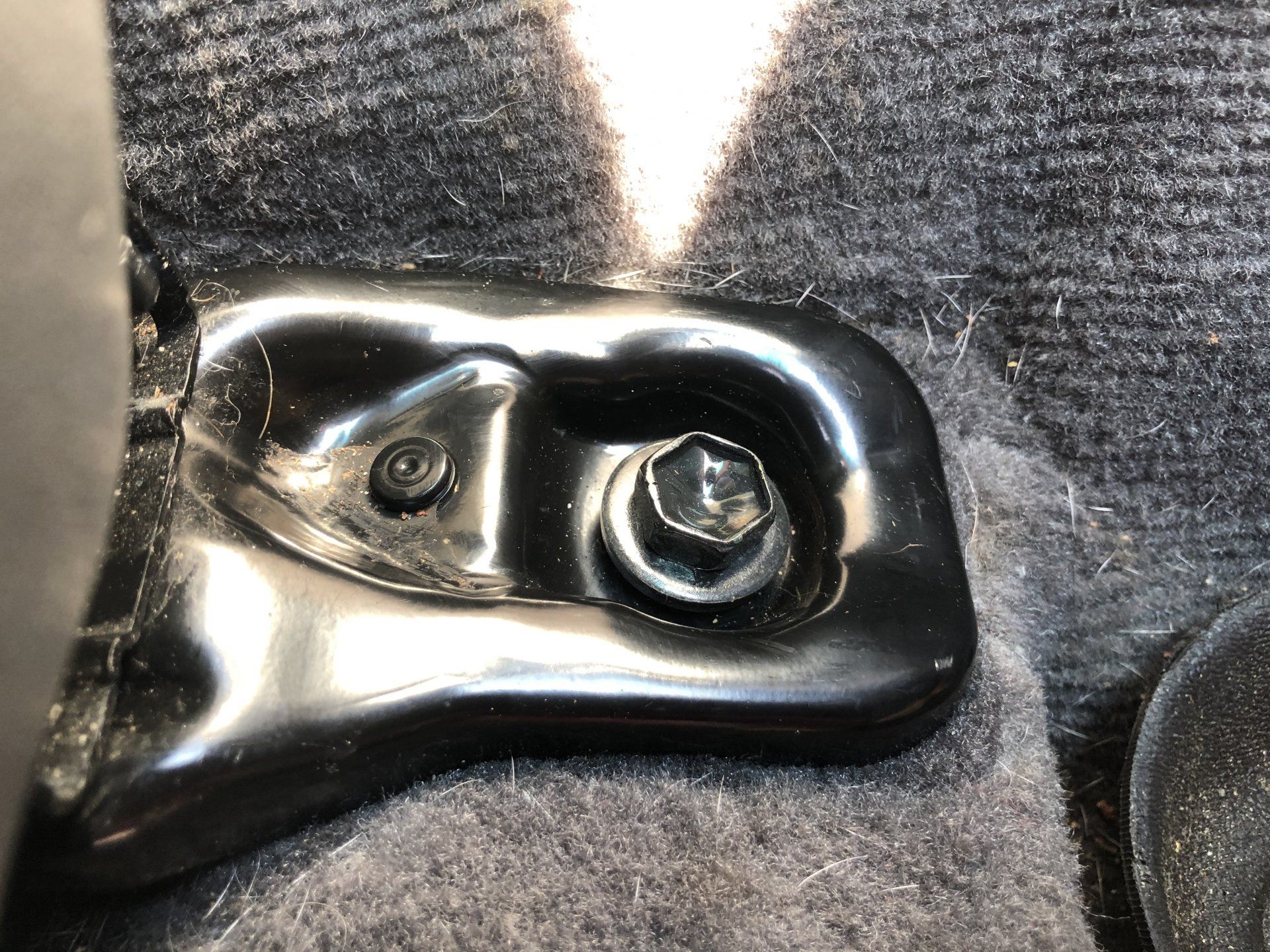

I have been searching for a heavy duty laptop mount that doesn’t require drilling, and it’s tough since the sliding seat frame isn’t flat where the anchor bolts are.
3rd picture is example of how the RAM no drill mounts anchor to seat. I love RAM mounts for their durability/strength. My laptop is probably one of the heaviest ones in the market, and then you add weight of docking station, so I am only looking for sturdy solutions.
Anyone been down this road? I would like to mount the laptop in front so that I can see the feed from the cameras (most of which will be hardwired, and 2 wireless) while I’m driving. There will be a camera pointed forward that acts as a dash cam, 1 pointed at the driver and passenger/front interior, 1 pointed at rear Interior so I can monitor Tiger/the living area while driving, and 1 more camera that will be roof mounted in rear that will act as an aerial view of rear/2nd backup camera. When I fall into some extra money I would love a 360 degree camera mounted amount 2 ft high on the roof. In addition there will be 2 wireless cameras that will capture the Point Of View of Tiger, and my point of view from either the head cam or the handheld tripod/grip. It’s a lot of stuff to hook up to the laptop, so I need to hardwire it into the docking station so that I don’t have to connect and disconnect all hardwired cameras every time I want to take the laptop with me.
In order to access those bolts the seats have to go back a bit, which reminds me that I also need to shorten my living area In my designs to squeeze in the laptop mount.
When I measured before I was measuring near the bottom, and the seat is tilted so bottom has more clearance than mid way up. I need to measure from middle of the seat and back, so I will lose some inches there.
I also did not make sure that the passenger will have a full range of seat adjustability/motion, so I will lose inches there. This will double in function by allowing the front seat to go back far enough, so that there is enough room for Tiger to lay down in the front passenger. That’s actually very important. I included a picture to help you see the problem.

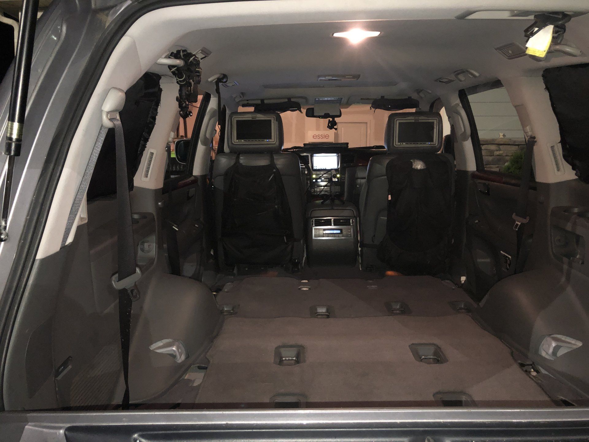

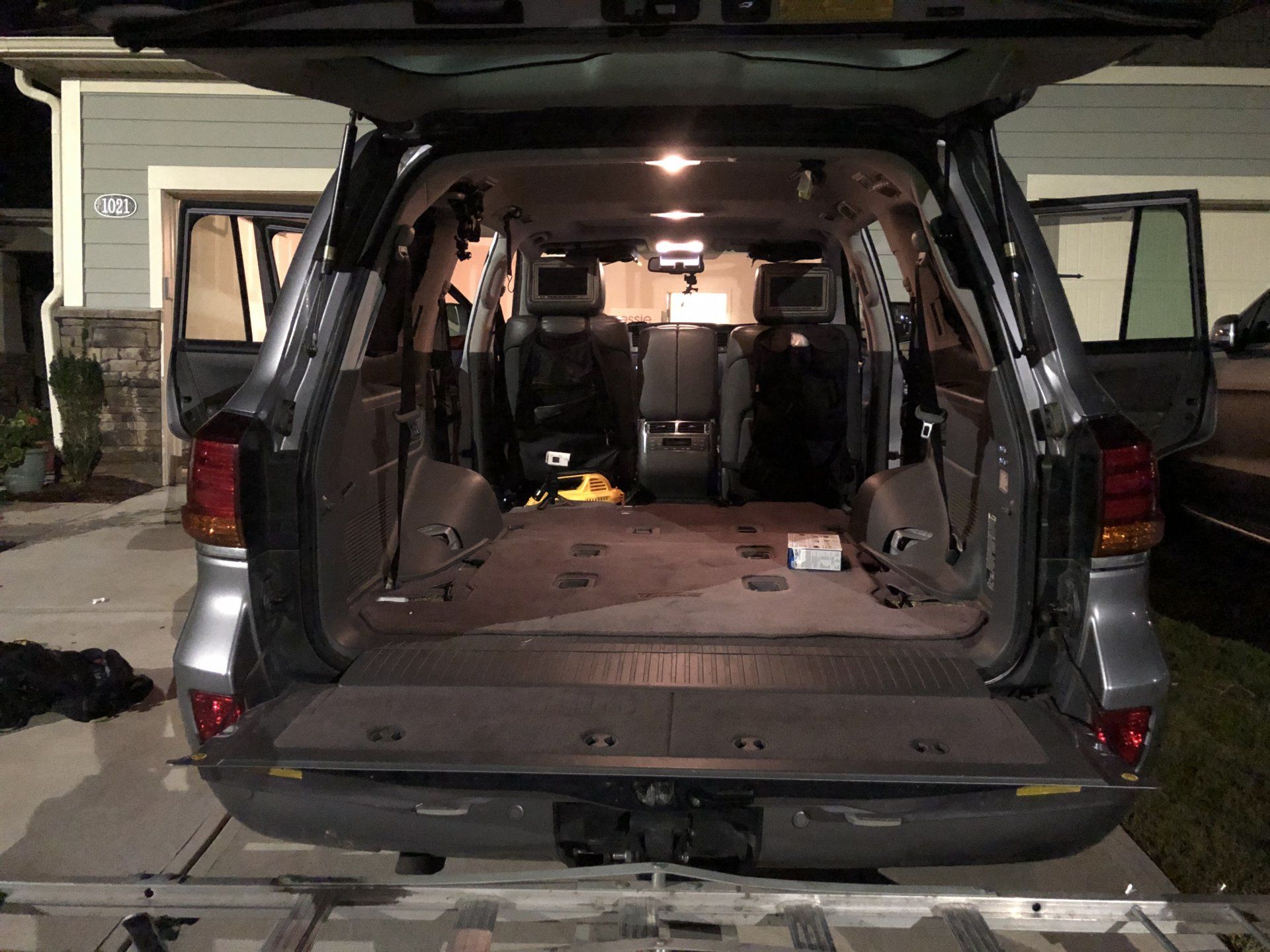

Twitch.tv/sharpecat
In case anyone is bored and wants to watch my car get flea bombed.

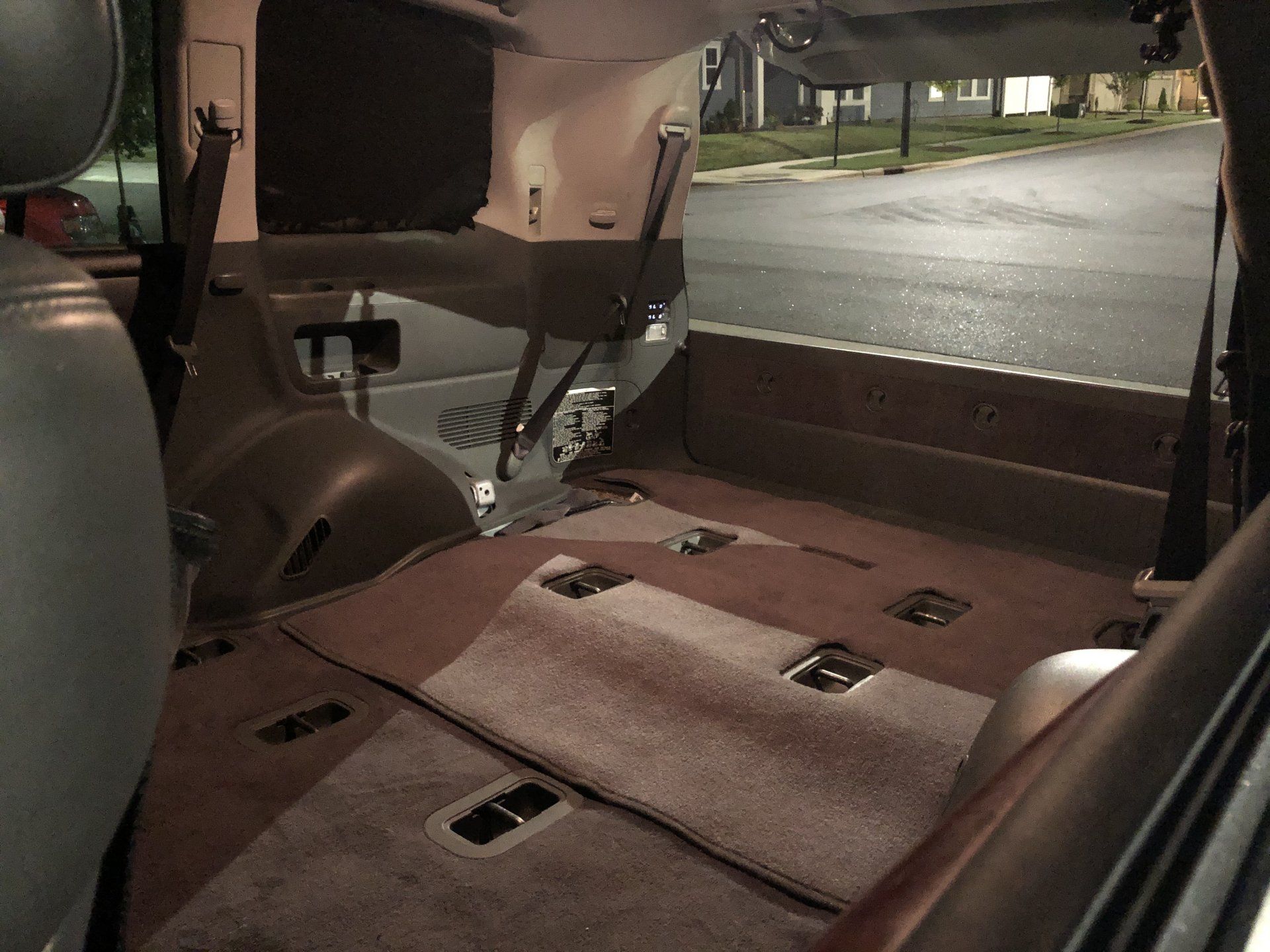

Seems much easier to flea bomb your house when It’s tiny and has a bunch of windows. I just roll down the windows and use the AC to air it out for a bit and I’m good. I did wait at least 1.5 hours before opening the door though.
Going to wipe and vacuum everything before I put it back in and we are off again! Going to be a nice sleep tonight with a clean bed and car! By the way I tried the cot for one night and dropped it off, exped on floor definitely better til drawers are done.
Tiger has not left this spot since I turned the car on, and he’s been crying to get in since before I set off the flea bomb. He loves getting on the road more than I do! He is also very smart and knows when it’s laundry day, and he loves a fresh bed. He’s on it within seconds of it being made on most days.

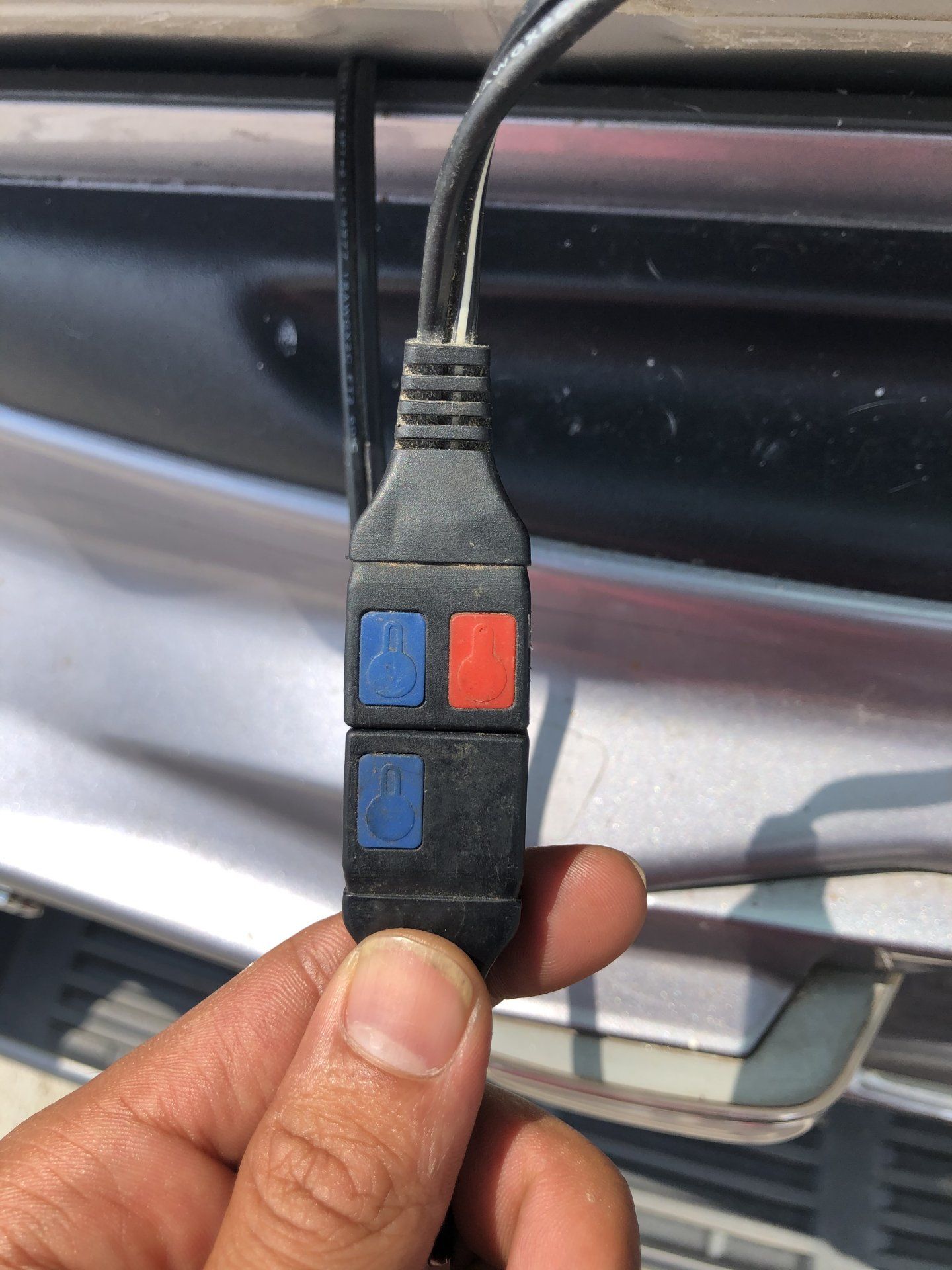

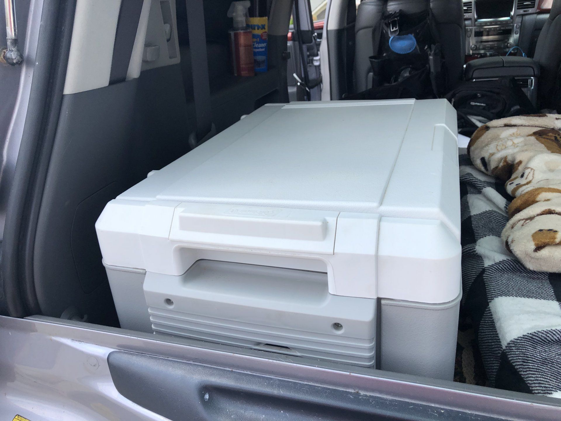

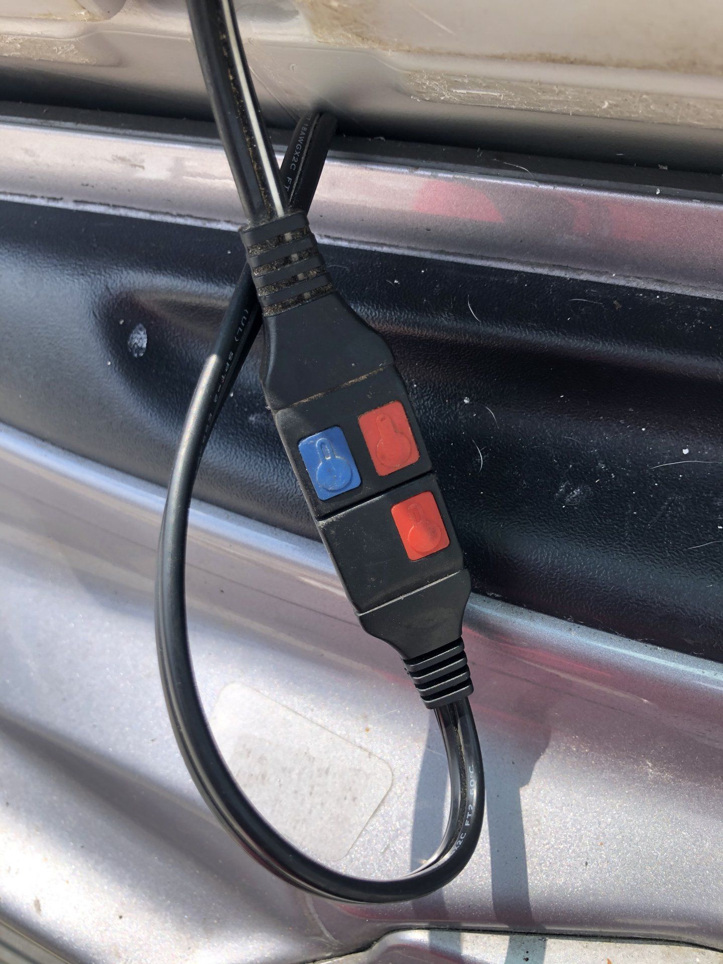

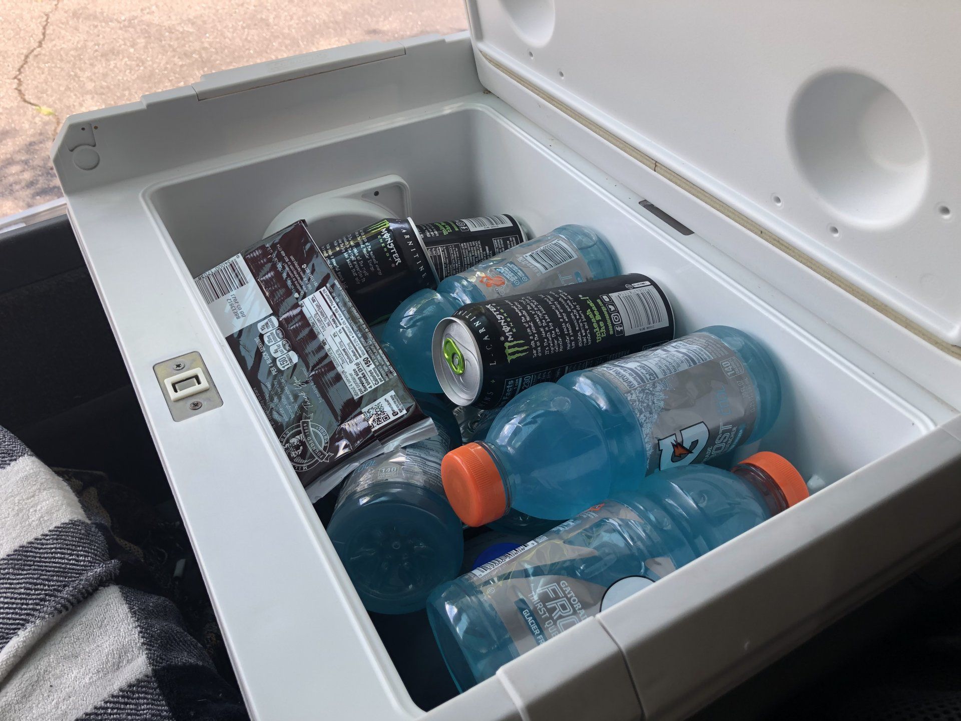

Plugged in my dads electric cooler for first time last night and it was blowing warm air even after an hour. Power consumption = 51 W (via 12V output).
Turns out this thing can heat or cool, and I plugged it in wrong. I only looked at one side of the plug and didn’t realize it was the heating side.
Now we officially in business. I stuck 2 warm Gatorade’s in there, and can’t wait to drink our first cold drinks without having to visit the store! Also, bedside cooler access! Good times ahead.

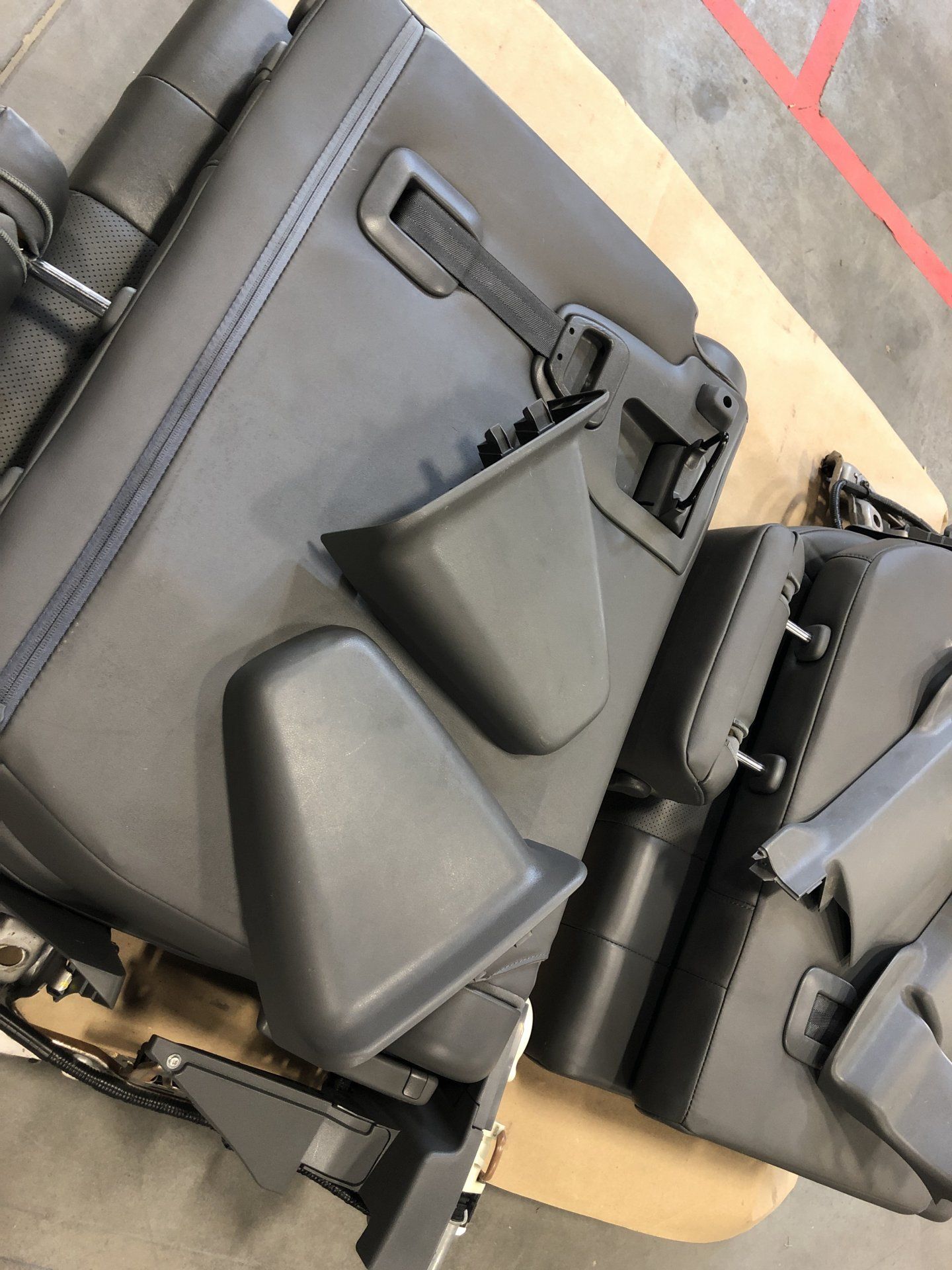

@Toyota4WD94 PM me your address or call/text me brother. I'm packing up the third row right now.
Twitch.tv/sharpecat for a live feed.
Are these the right trim pieces for third row?
yes, those are the trim pieces.
Cool, just need address and she’s good to go! Dog not included. I’ll have my co workers double check my strap and wrap (it’s their department), and will have it out the door tomorrow assuming I have address. Thanks again fellas, 1 less thing I have to worry about! Good looks.
