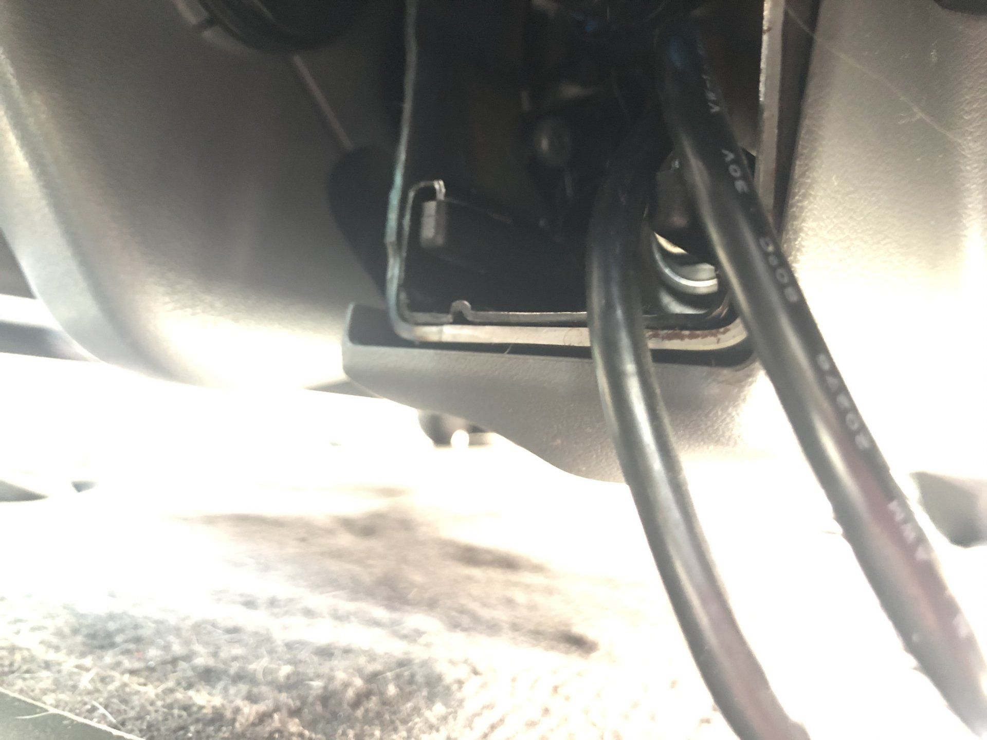

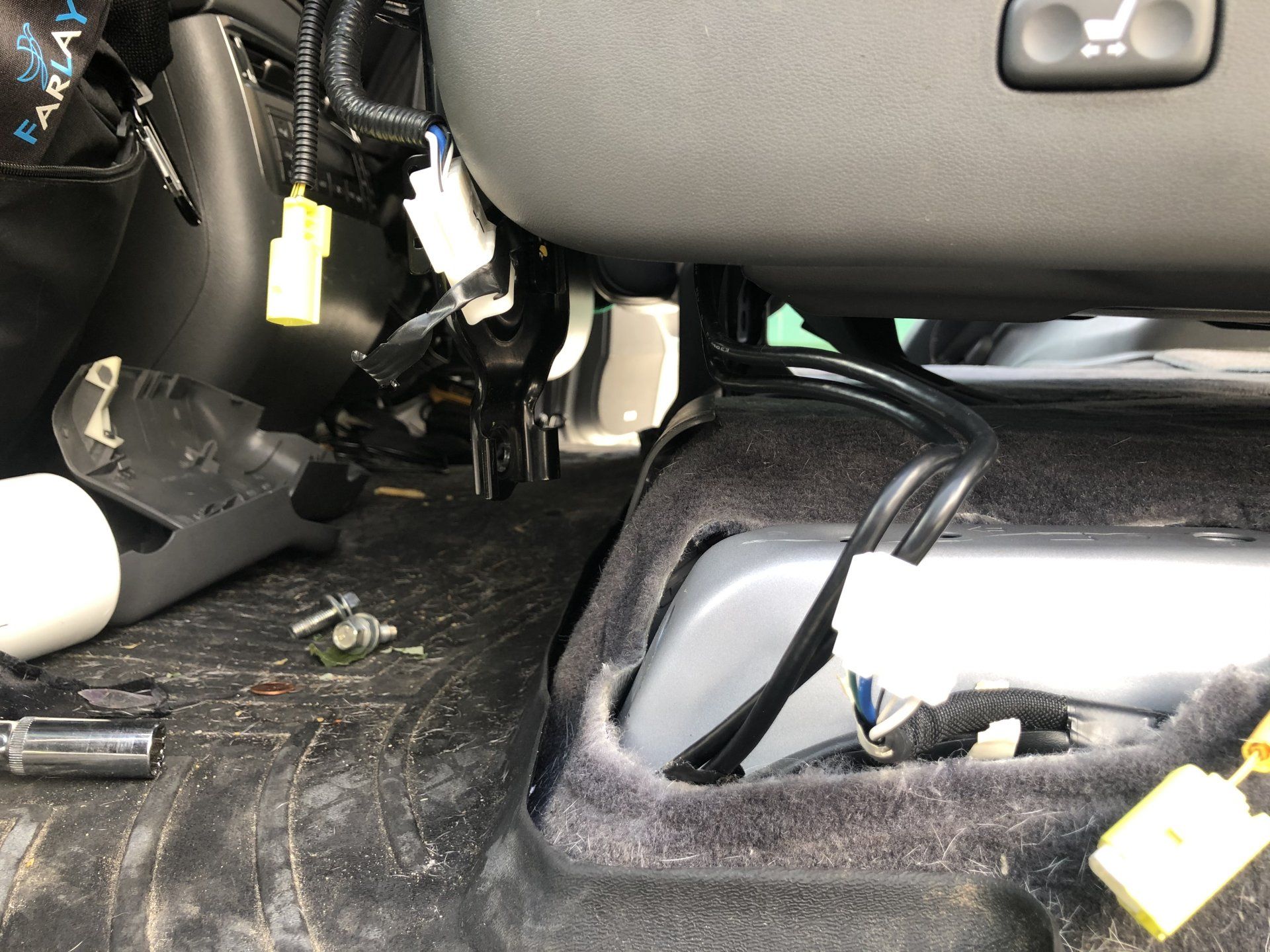

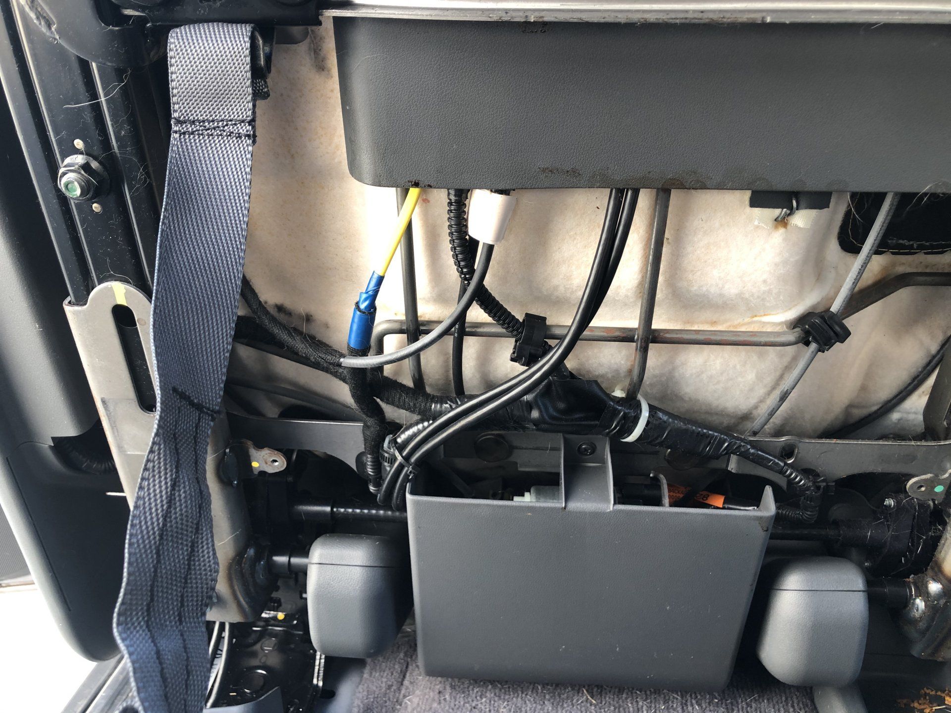

how do I get this cable detached from the seat!?? I’ll be keeping an eye on twitch chat and here for a response.
Traced it here, so maybe the connection is under the carpet?

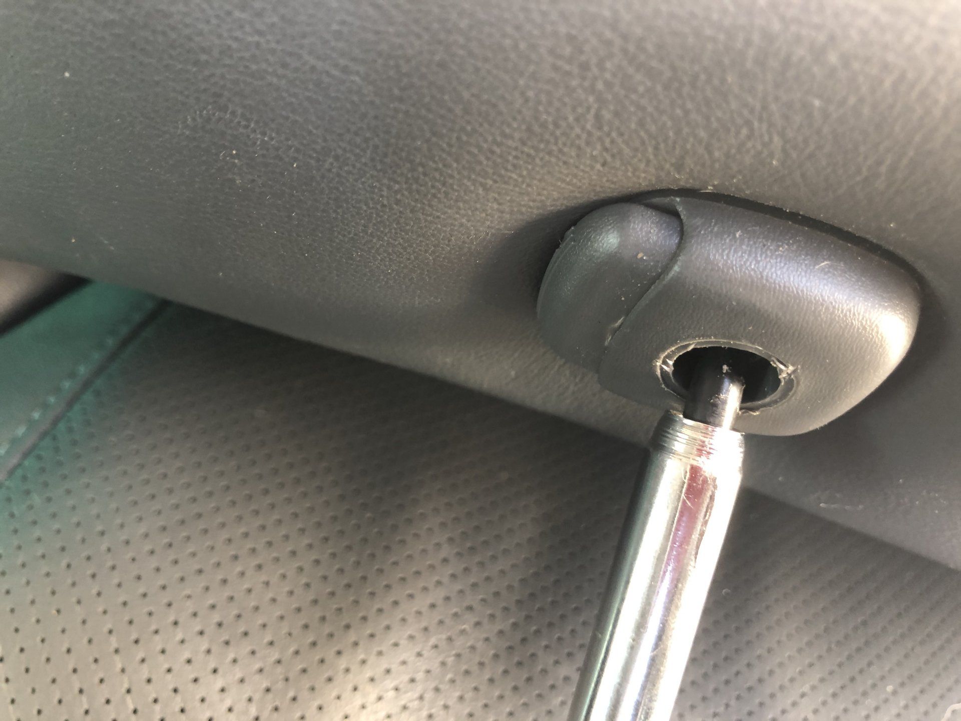

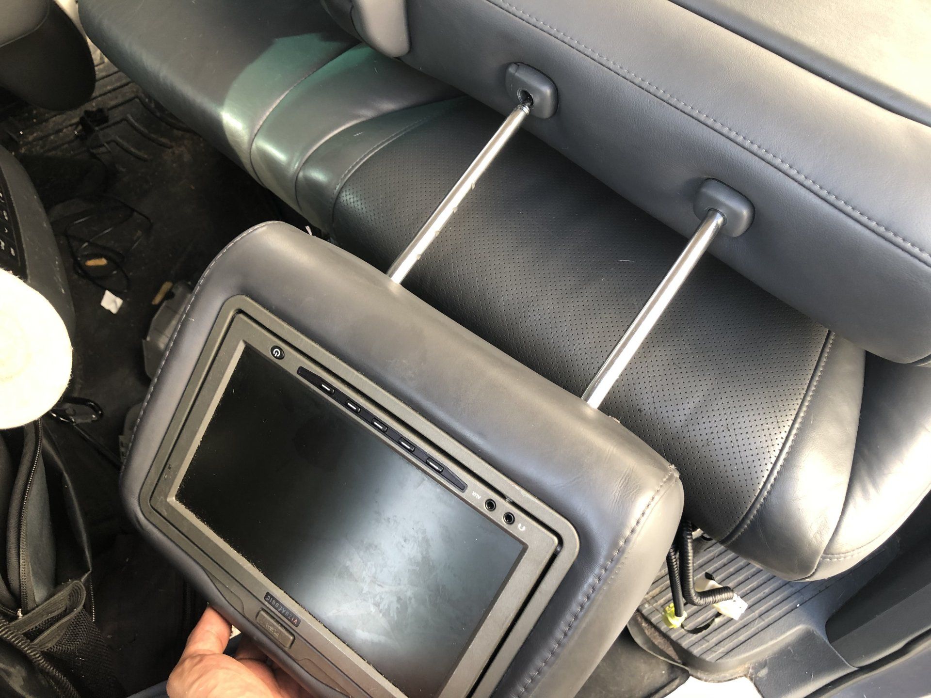

I think it’s the cables to the in headrest DVD player... how the heck do I get it out!!?
@grinchy remember when I was scratching my head about how the headrest was powered, and wondered if they ran a cable through the headrest poles??
answer is yes. Time to look for ways to remove it.
you'll probably have to pull the seat backs to get to the cable. If you don't plan on reusing just cut it as long as you can at the floor. DOesn't look like a toyota cable, they always have wrap on them, and are rarely that big gauge.
You may want to call around some Lexus dealers and shops that install these aftermarket sets. They may have a collection of take-offs they would give/sell for cheap. I’d say any YM 200 would probably do, but I may be wrong about that.
I’d try to remove any trace of it if you are going to disable them. It will be worth the effort (and really shouldn’t take much to begin with).
I ran the part number to the cable and found it here:
@grinchy me and my dad agrees that we should cut it. I also think it is aftermarket too after running the part number.
17 for a new cable assembly so I’m sure whoever I donate these to wouldn’t mind too much if I cut them. That will be my mini project for tomorrow and main project will be to continue hunt for a fridge and drawing up drawer dimensions.

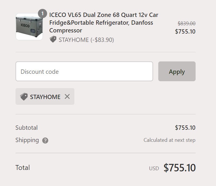

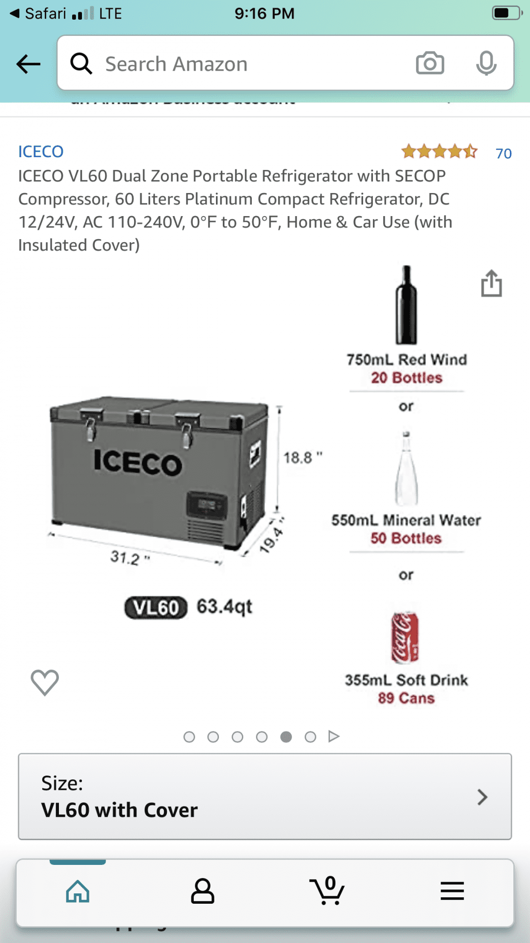

with size not being a big factor anymore, and a budget of ~700, is there one better than this? Is the Whynter better than this? This will be the start of my search tomorrow, is to see if i can find a better one for the price or to see if i can get the price of one down. Price shown is with their current 10% and does include shipping.
And the VL60 is a little cheaper and comes with a bag, so maybe a better deal.
Well you're out of the capacity and $ I was shopping and into the upper mid range. That looks like a nice fridge, but beyond a small internet wormhole I traveled looking at Engel Combis I haven't shopped this segment.

Just an update, my phone call with IceCo went very well. Soon there will be a very special Limited-time discount on their JP and VL lineups, specifically for mud members (via our very own coupon code for their site). I will post it in the group buy section when I have more information. I don’t want to spoil anything, but it is a price I’d gladly pay myself, otherwise I wouldn’t waste anyone here’s time.

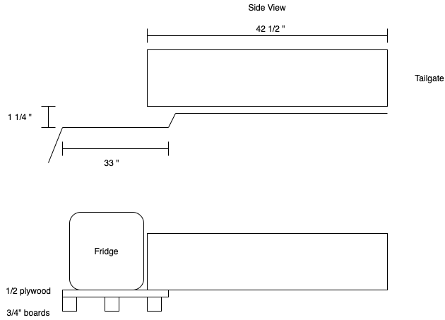

Here is a rough sketch of the side profile with measurements. They are approximate, but should be pretty close. This is based on my drawers. If you go with 42 1/2 length, there will be 6 inches where the back of the drawer unit overhangs the floor offset. For mine, I just attached a 1 1/4" x 2" shim the full width of the drawer unit. From the beginning of offset to the vertical drop down to the 2nd row floorboard is 33".
What you could do is to mount a 1/2" x n" sheet with 3/4" spacers underneath.

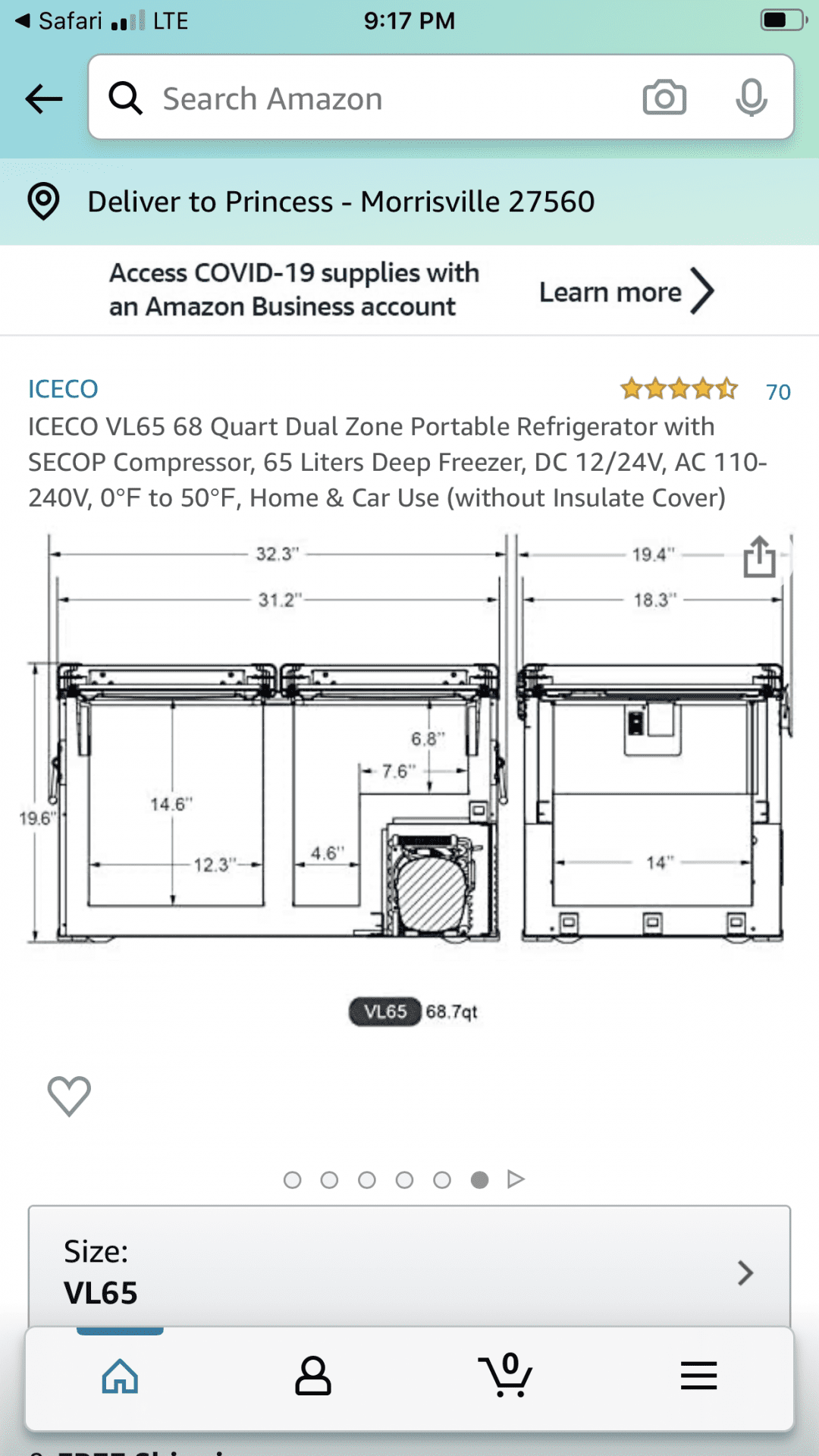

how high should the back drawers be if I want one of these? A full 20 inches almost since there is only a 1.25 inch difference between 2nd and 3rd row floor? Seems I might need to drop down to something smaller? This is their smallest dual zone, the VL60 at 18.8 inches tall without bag, and it does come with a bag so I would round to 19. Yours is 11 so I would need to add 8 inches, if I wanted to lay a 1/2 piece under and 3/4 bars under to support it? I may need to do some mock-ups to really see but that seems high.
Is it bad to just lay it on the floor without putting a piece of wood under it? At 19 inches the Top of the exped will barely go above the bottom of the window, and that’s a little higher than I’d like but can work.
Maybe I can ask them about a shorter dual zone tomorrow.
Almost all fridges of any decent size are going to be that tall. Are you trying to build your platform to match the top? Not going to leave much room.
As long as there are no vents on the bottom, it is fine to set directly on the floor. Just make sure it is a stable flat surface. If you have it hanging partially over a hump or edge, it could crack it if you hit a really hard bump or do a lot of off-roading.
Honestly, I’m not sure you’ll be able to go flush with the drawers no matter what. Mine are 11” to the top of the platform, which is as high as you could go and still use it as a sleeping platform with the remaining 2nd row seat.
On the other hand, if you wanted to do something split-level, you could do the fridge side at 17 3/8” and the sleeping side at 11”
Yeah, the 17 3/8 would be sitting on the floor.
19.6 is 19 19/32, but for practical purposes, it is 19 5/8 and - 1 1/4 which is the offset between the rear cargo and where the 2nd row seats are mounted. it is flat and as you saw with eatSleepWoofs setup, you can mount d-rings to the seat bolt holes for securing the fridge.
You will probably have a hard time getting it lined up perfectly with the top of the drawers. If you really want it to be perfectly flush, you would probably want to do the first idea and mount a sheet with spacers underneath. In this case, your fridge-side drawer unit would just be 19.6, same as the fridge.
Doing a split unit would require doing two drawers on the fridge side and will be a slightly more involved build, but wouldn’t be too difficult. It would give you a ton of storage.
I think you may run into other issues if you try to do the entire platform at 17 3/8. Are you removing both of the 2nd row seats?
