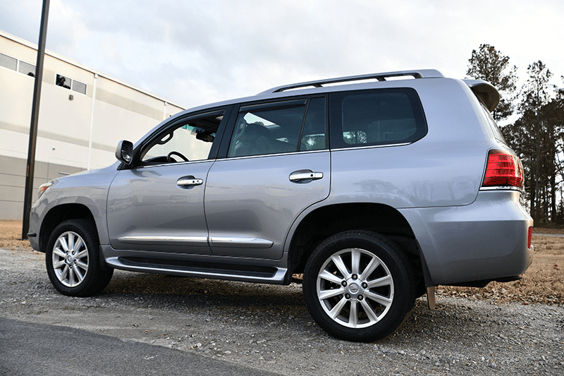

Bought her on Dec. 7th with 180k miles for $18k, and she now has about 182.5k. She has been serviced solely by two different Lexus Dealers her entire life, and has been taken in at ~5k intervals for the most part. No accidents, radiator replaced at 150k, AHC flushed recently, new tires and PPI came up clean.
I honestly don't even know where to begin, other than to say that i feel very lucky to be in this position where i get to write my own 200 Series Build Thread. With that said, i have not thought everything out and things may change around depending on new information. My goal here is to have a place to gather my thoughts and lay down my plans for her for this upcoming year, as well as have a place to seek advice. Thanks in advance to the many of you who will be helping me through this process, and Thank You to the many of you who have helped me get this far. I look forward to an exciting year with you all!
First picture in low, 2nd in high. More stock pictures on page 2. I will also make a google photo album and link it here after it is done uploading if you want to see more pictures and at higher resolutions, as well as be able to see everything in one place.

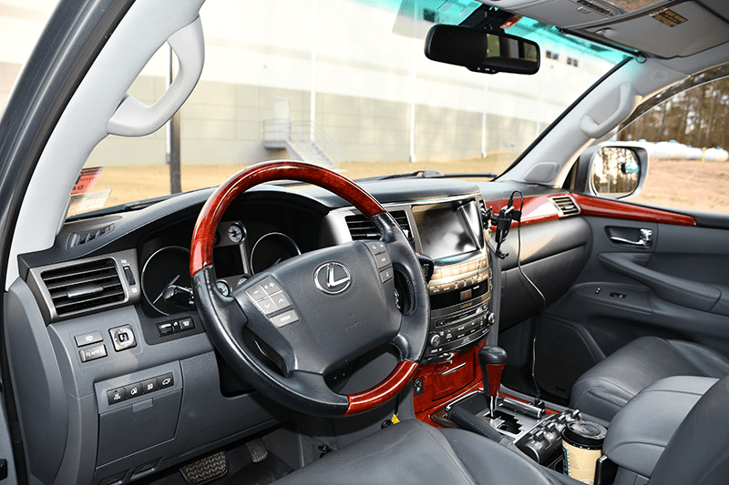

In addition, i am almost done setting up my mobile/IRL stream setup, so i can have a live feed/online backup of all the footage, for when i work on the car. This will make it easier for those who want to help to help, if they can see what i see. This will allow others, including you guys, to keep an eye on me as well (if youre bored!).
I have a body/helmet cam, and another on a stick for close ups. This will be the same live streaming/recording setup that i will use to give everyone on here a real close look at local LC/LXs in my area, and the same setup i will use to broadcast my POV of LCDC/other LC events. I'm gonna be that guy walking around giving everyone interviews about their cars at LC meets XD. Only thing left to do is figure out the bandwidth situation for when there is no wifi/in remote areas (likely bond a few cell signals).
Afterwards, i plan on taking all the live footage from working on the LX, and making it into DIY videos, and my hopes is that it will help others down the line. I would not be where i am if it was not for others who have done the same before me, so the least i can do is try to pay it forward. Anyways, my point is i have a lot of people watching over me and i will definitely play it safe on top, so you do not need to worry. Thanks again.
