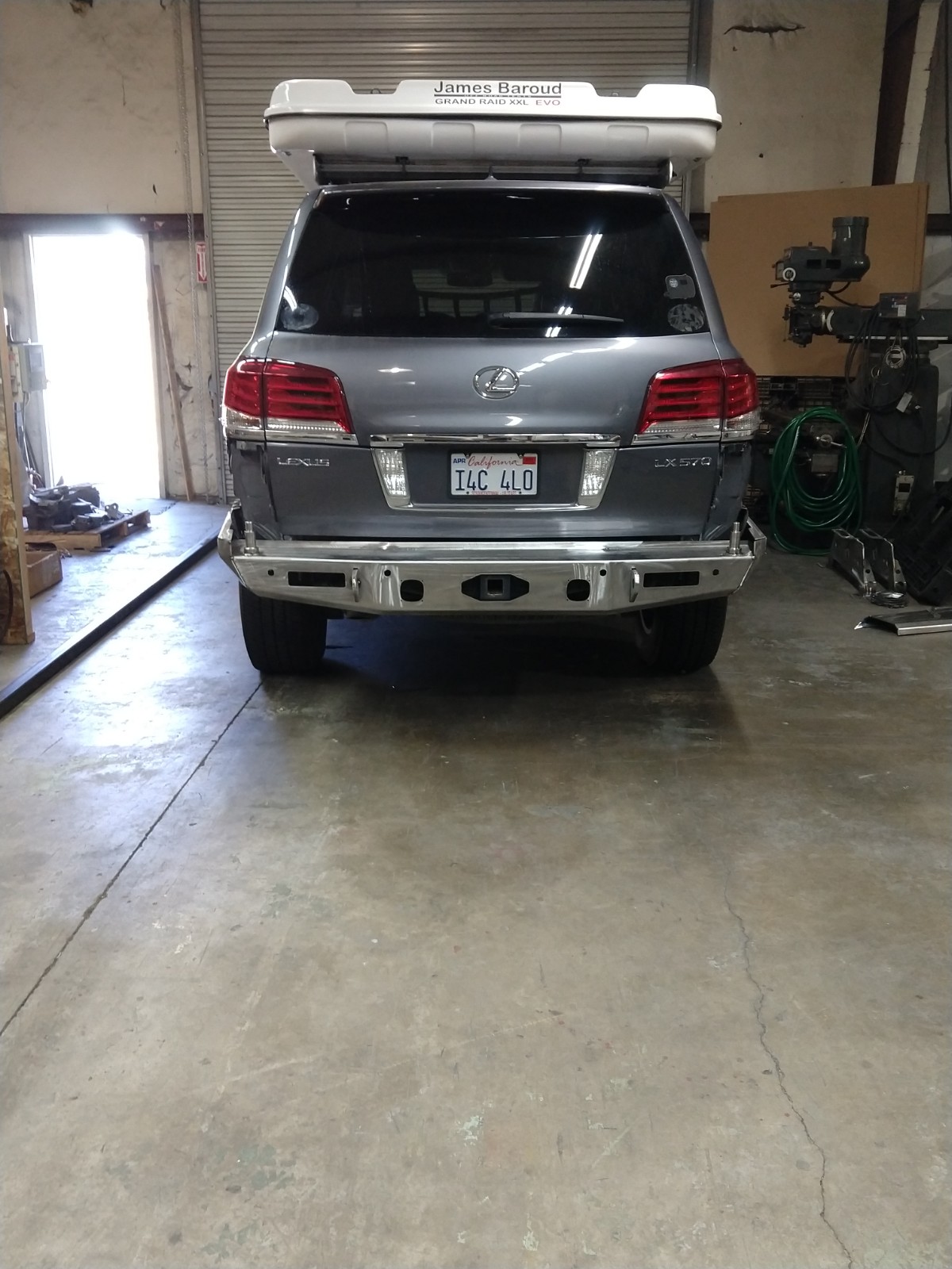

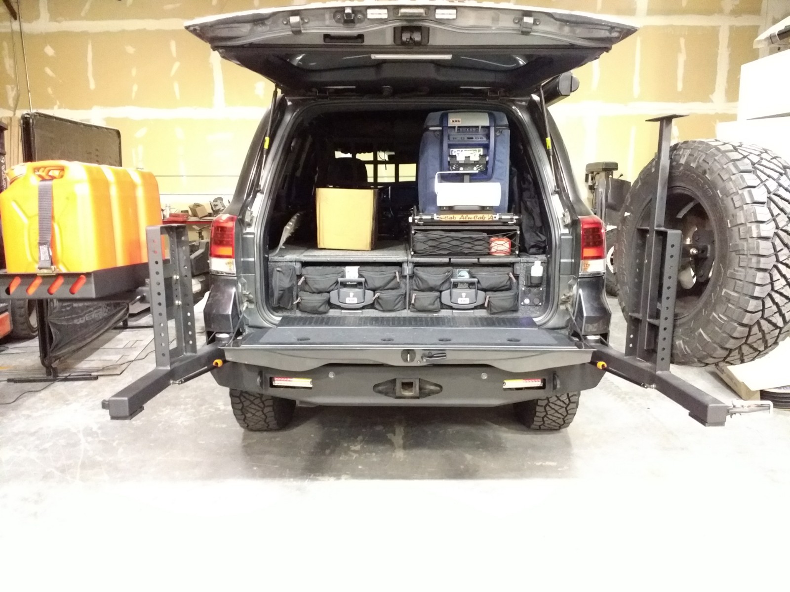

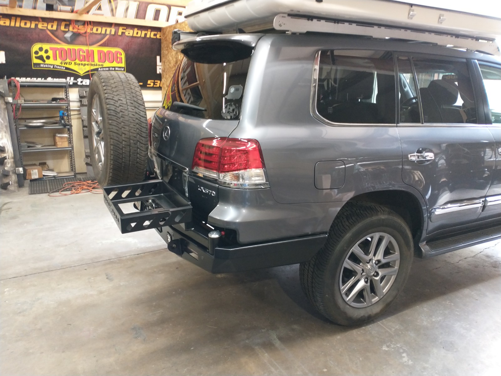

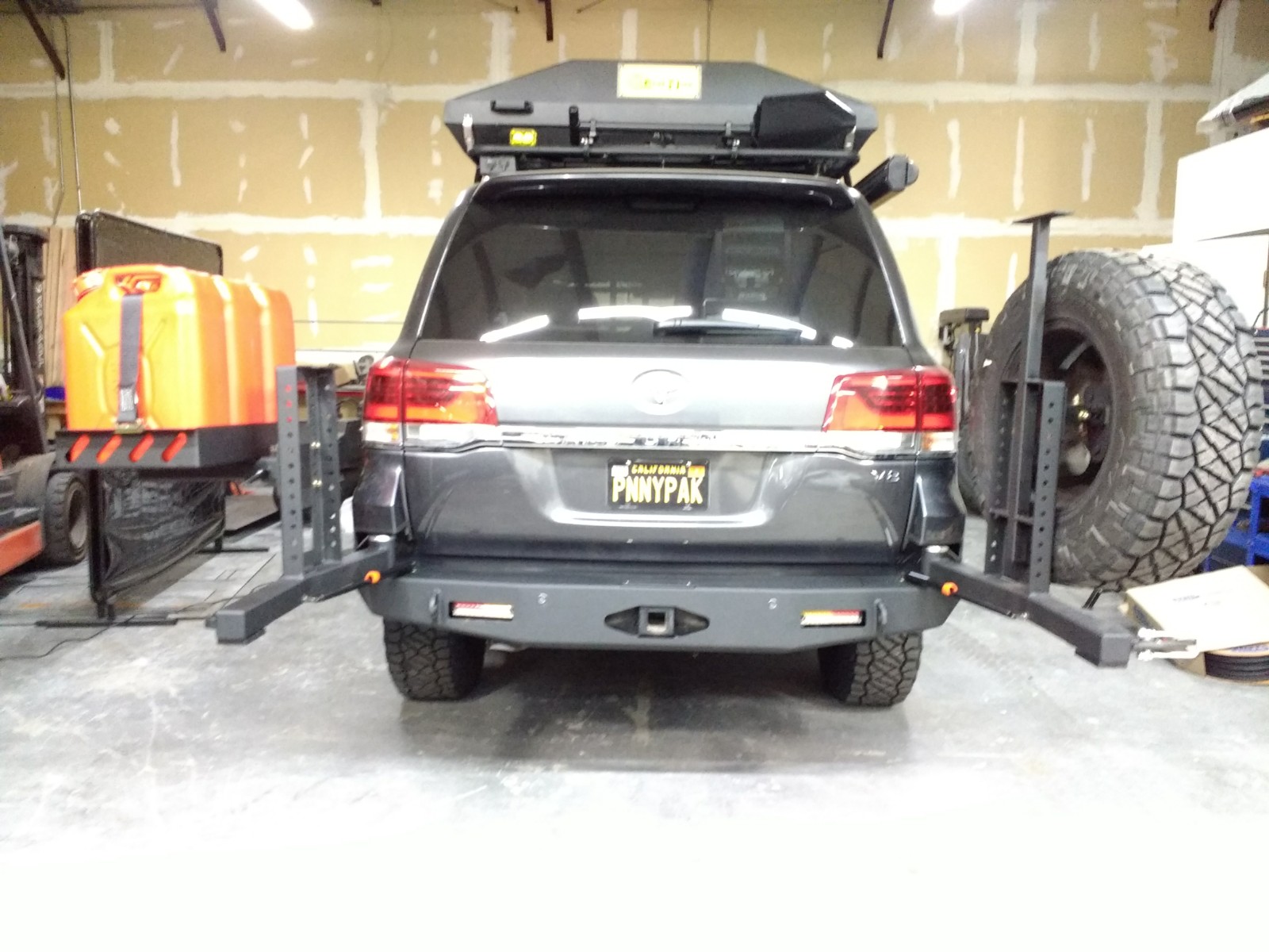

Can it swing out far enough to clear a path for an ATV Ramp built into the bottom hatch door? Do you have any pictures of it without anything on it, and fully swung open, or at least 90 degrees or more
Can it swing out far enough to clear a path for an ATV Ramp built into the bottom hatch door? Do you have any pictures of it without anything on it, and fully swung open, or at least 90 degrees or more?
Here is the LX and has the same swing as my 200 rear (last 2 pics)

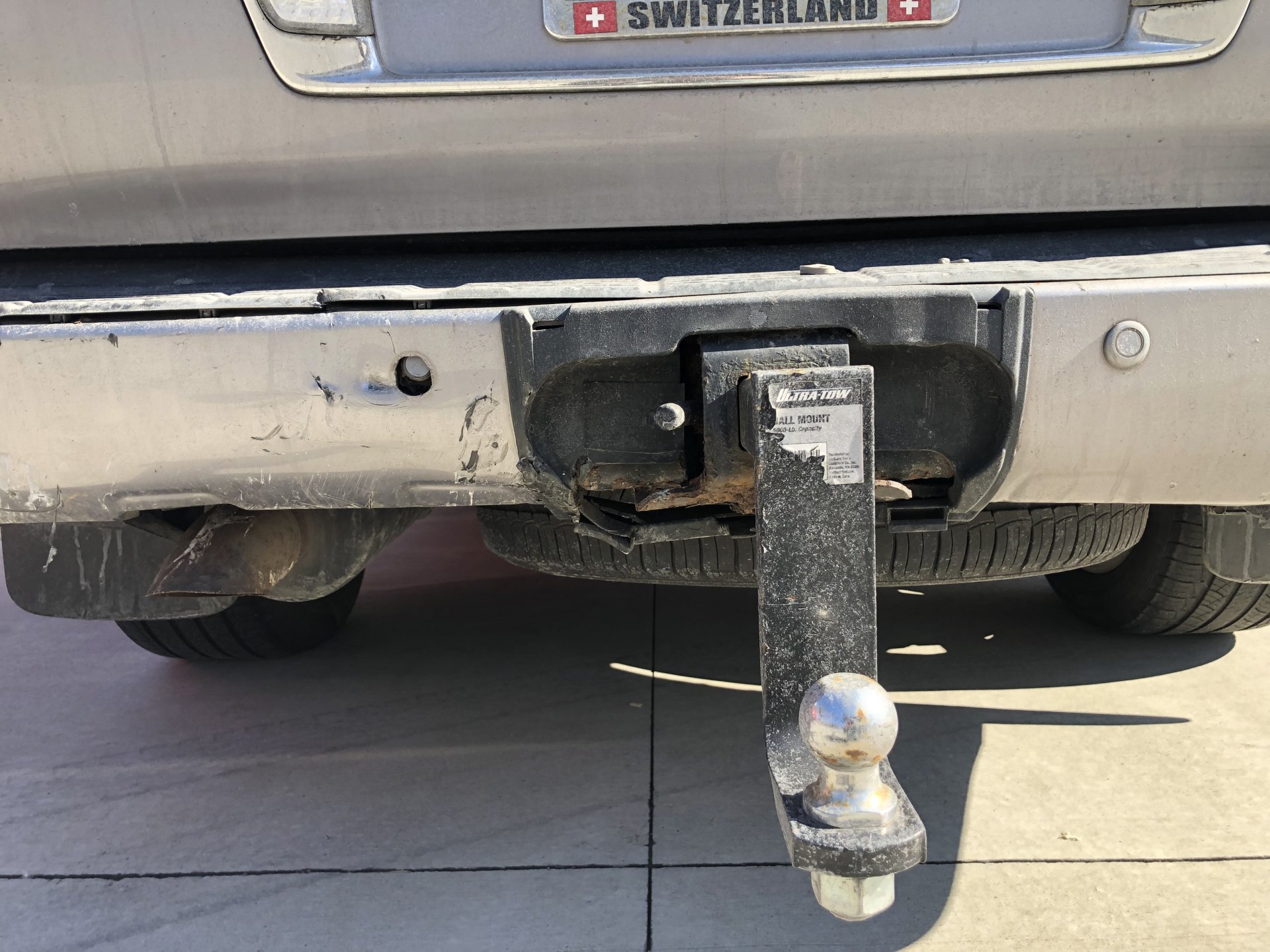

Still waiting on police report before I can call insurance for assessment.
If no frame damage, I will proceed with tires as well as some much needed rust treatment underneath, and go from there. Fingers crossed, as I’m not ready to let her go anytime soon. In fact I was just getting ready to get started on experimenting with her/preparing for the ground up restoration down the road.
I also decided that whatever money I get from insurance will not go towards an immediate bumper replacement, but instead I will put it towards the tools I will need to build my own.

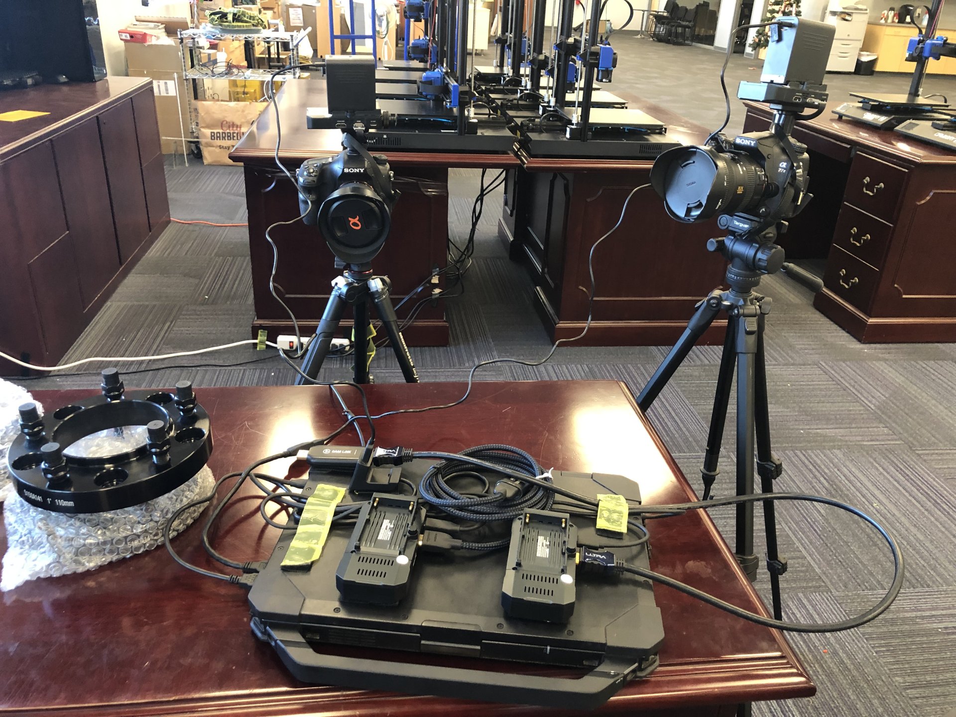

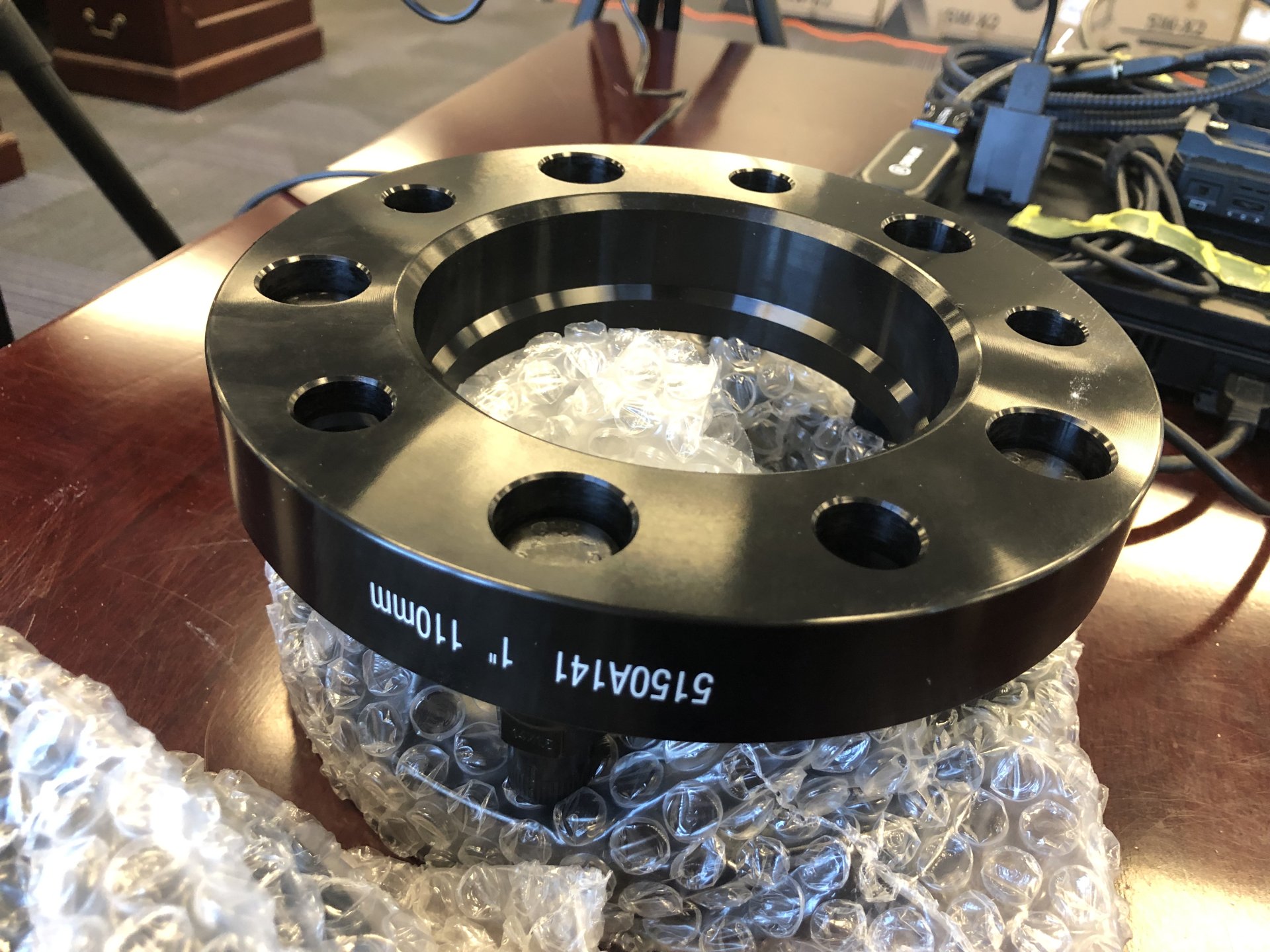

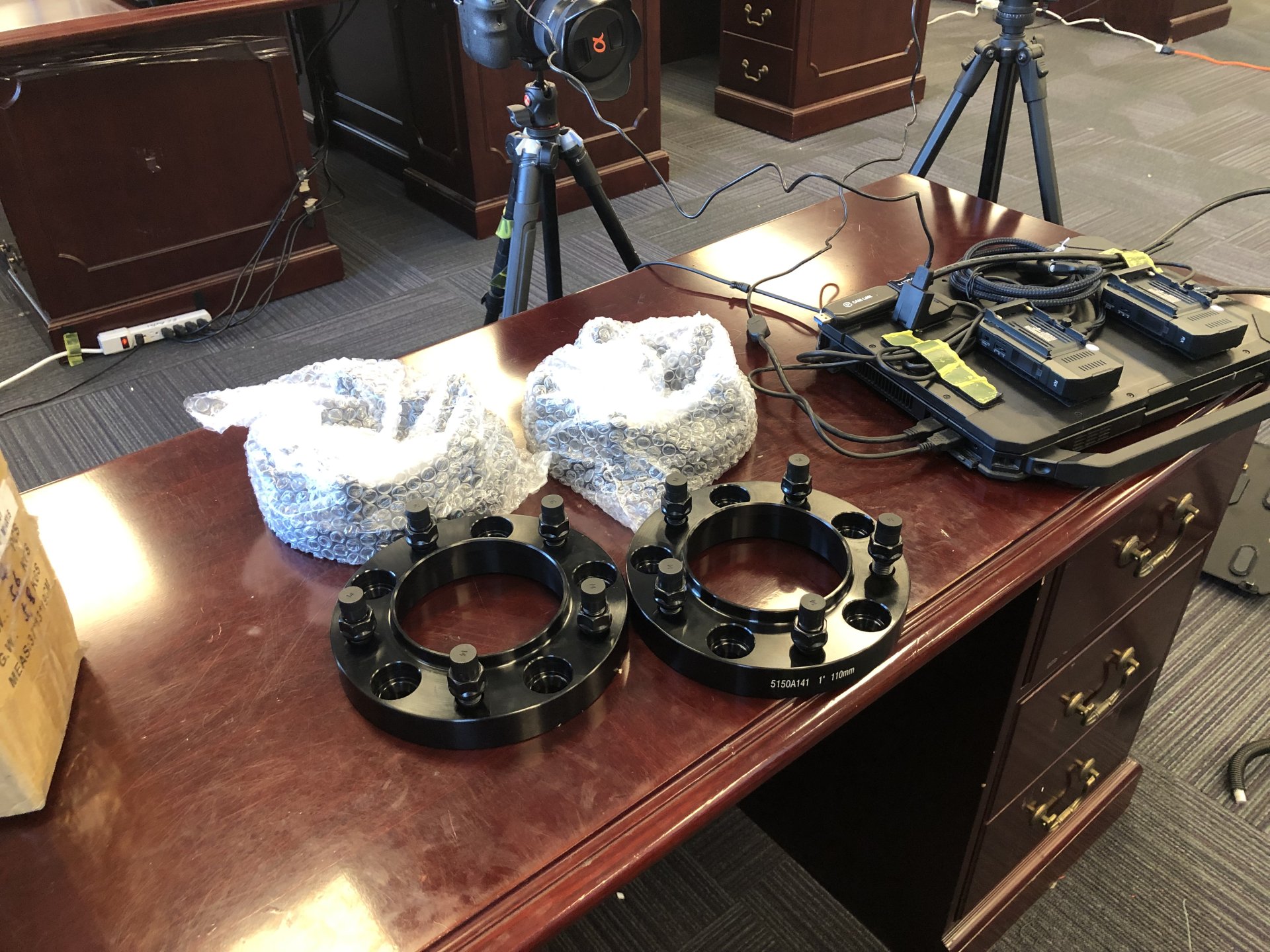

Spacers just got here a few mins ago! Here is live feed, i will throw them on soon & already got permission to film at Discount Tire! So i will do another livestream from there (hopefully if all goes well).
Not sure if you guys got an error for my youtube livestream link, but i'll try and share pictures along the way if livestream link does not work. Super stoked/AFK for rest of today while i slap these spacers and tires on!!

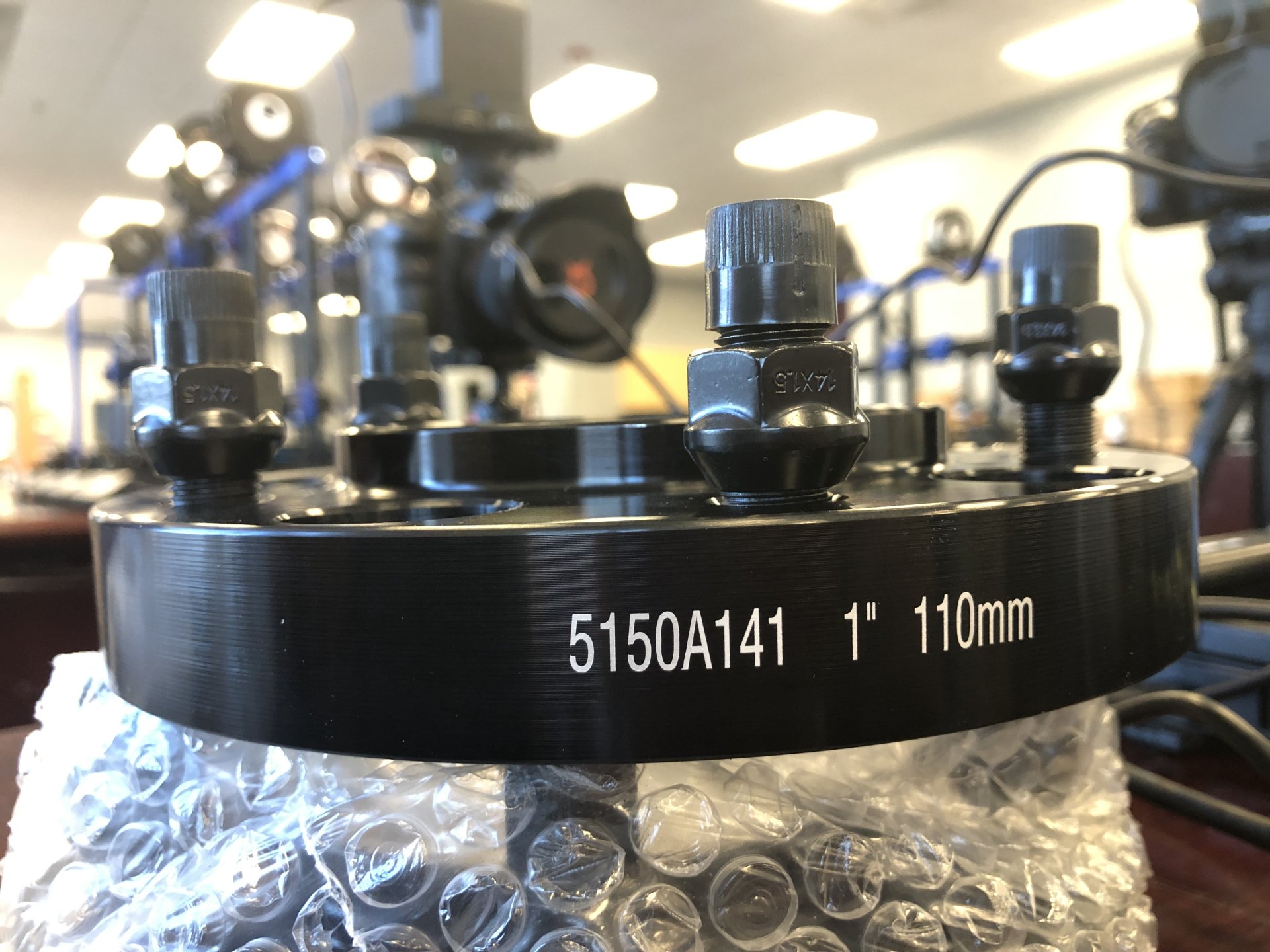

Went with generic spacers (BORA and Spidertrax long lead and more than twice the cost).
My batteries for my camera transmitter/receivers got here today as well! Going to test the new live setup on the spacers installation, after I remount the laptop to the LX.

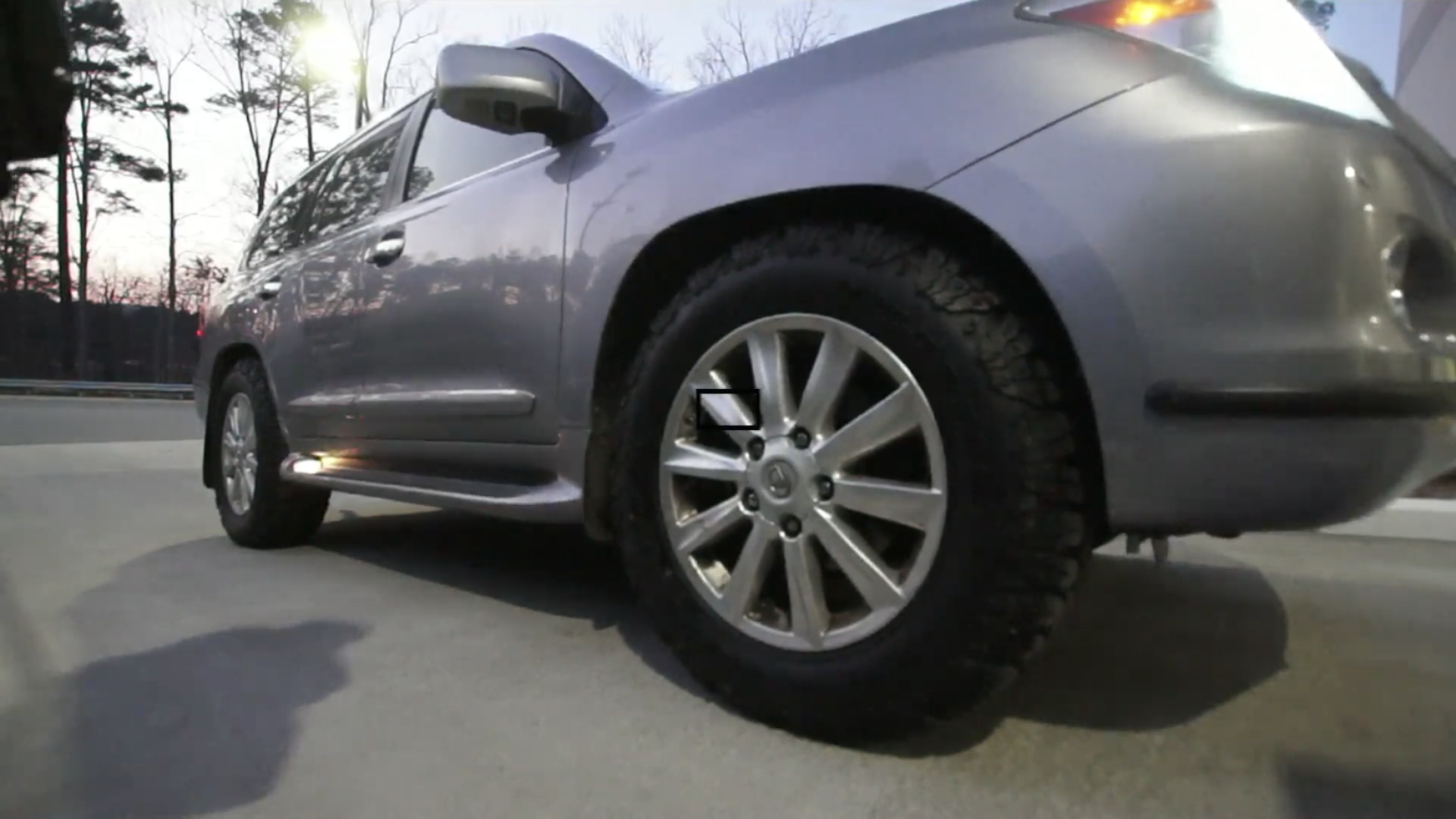

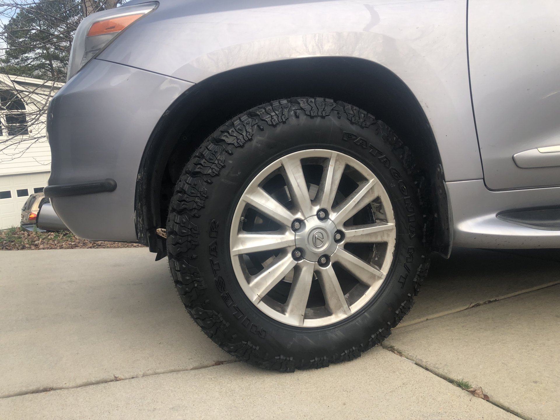

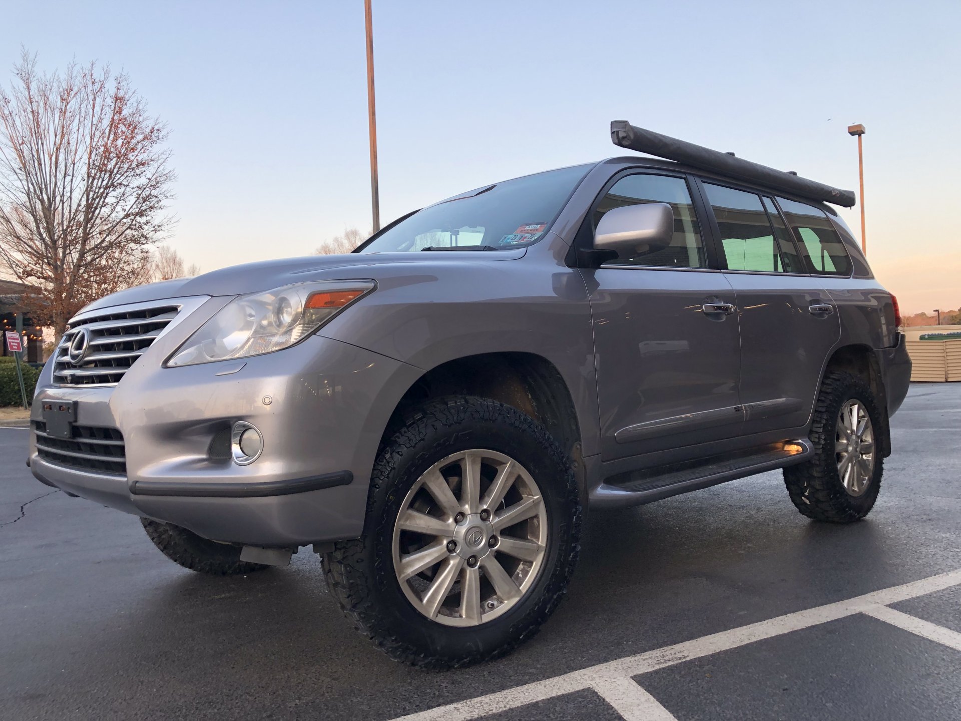

At 6 minute mark she goes from high to low with new tires on.
Was in a rush after discount tire, Will get a better look tomorrow when I have more daylight!

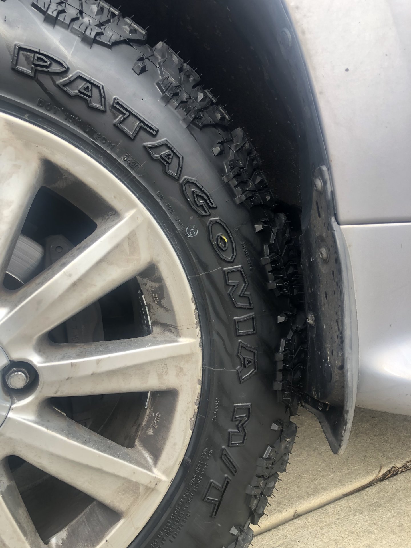

Will likely end up removing mud flaps, will get a close up of rub areas tomorrow for these tires; it’s very slight rub/noisy when it rubs the flaps.

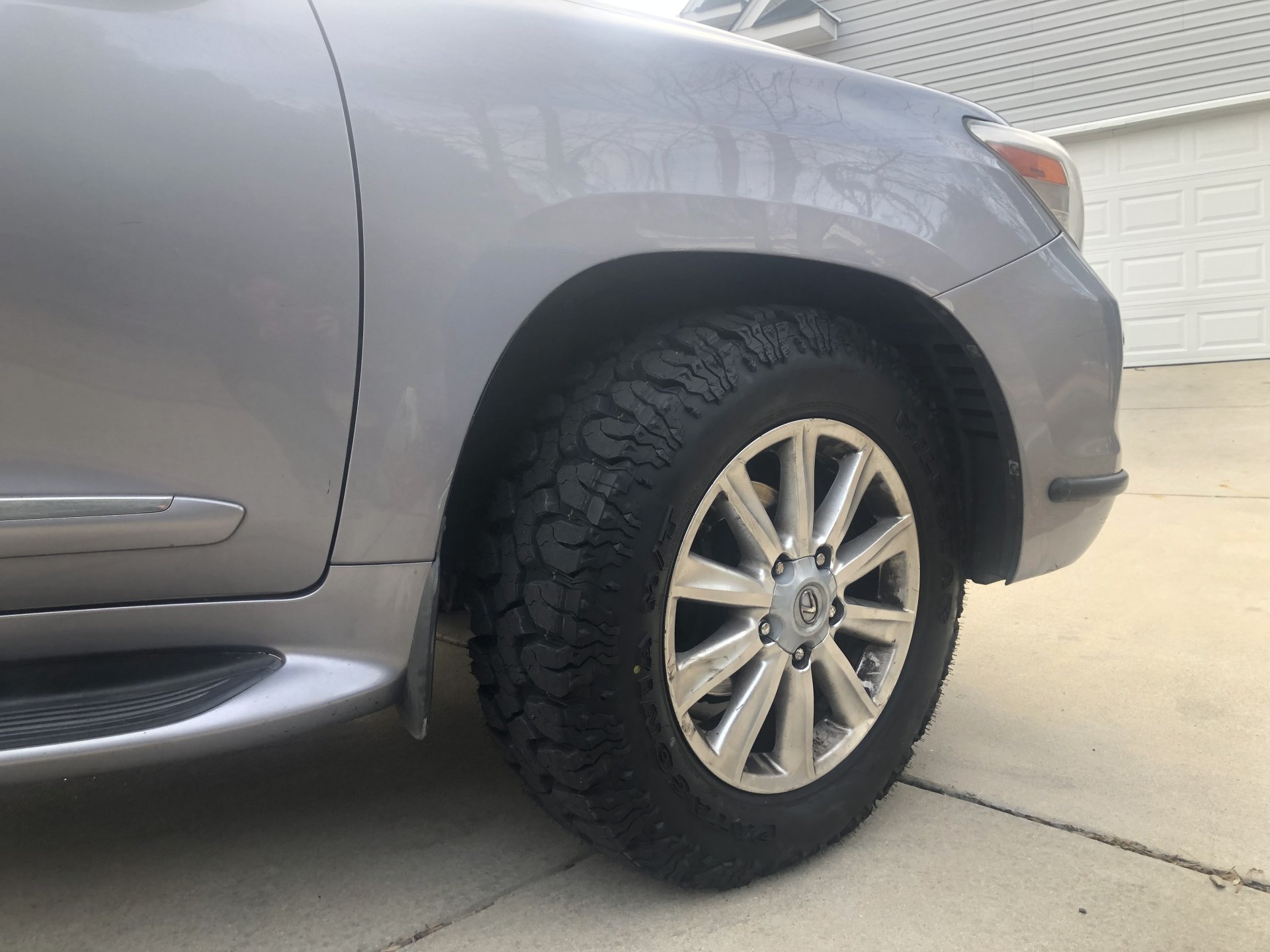

Last picture for reference (before picture from a few days back). I also have some pictures from the DSLR from when I was waiting for installation (will upload later).

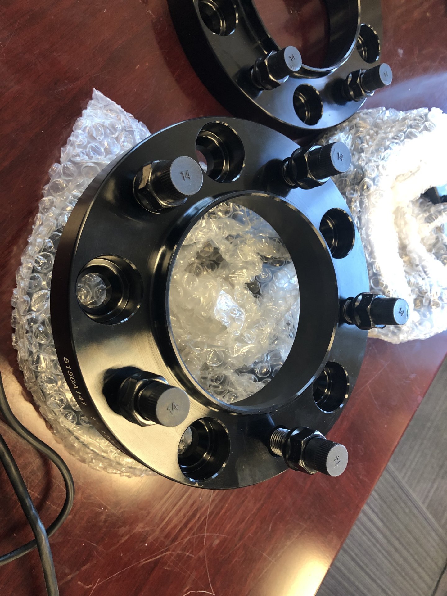

I cannot stress enough to utilize a permanent type loctite and to properly torque those spacers and to properly torque down your lug nuts. Then re-torque/check after a couple weeks of driving. Any high spots on your steel hubs/rotors/rims will wallow out the aluminum over time and your nuts will be loose. Loose nuts wallow out the aluminum spacer quickly. Nicely machined aluminum rims won't be as much of a issue as stamped steel rims.
Thanks for the reminder, much appreciated like always; I did not plan on using loctite tomorrow but I will now.
Edit: i am reconsidering loctite as I plan on replacing the rotor hub/assembly at some point in the future. Will likely be a while and I don’t mind checking torque every now and then.
@grinchy covered me on the 97lbs torque (to spacer and rim). I plan on tightening it again tomorrow after first 50 miles, and will periodically check.
Screen cap from video of her in low/will get some better shots tomorrow!

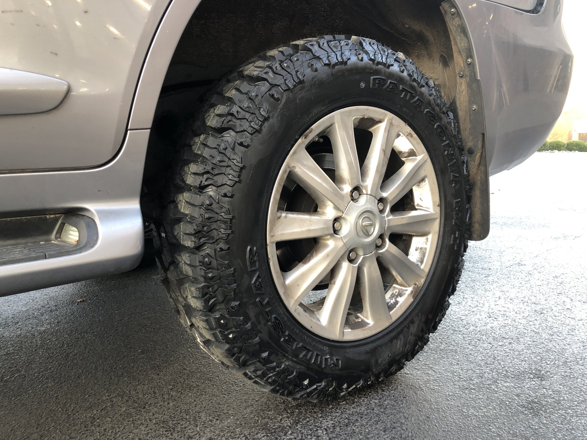

Good morning! About to go get inspection and registration done, then addressing the rub points and taking off her new sneakers for a re torque of spacer and lug nuts.

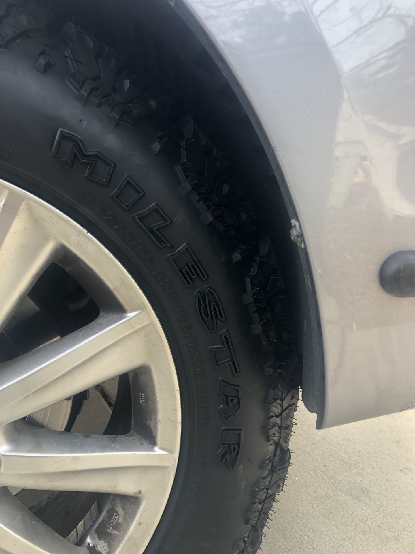

Better pictures of the 2 rub points, from neutral/normal driving height. I’ll get the dslr and macro lens out later when I get to warehouse. These are for front tires, I have not looked at rear as I am working on reducing loudest/closest noise to me first.
