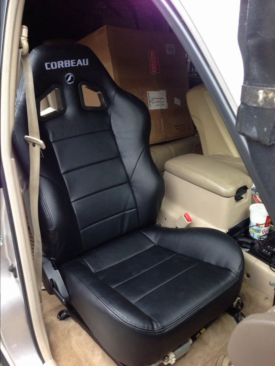

After a little bit of research, I have some Corbeau GTS II seats on the way. I plan on doing the driver side seat first. I am heading up to GSMTR next Wednesday, so I'll be hard at work fabricating a seat mount for it. I thought about doing leather or suede, however the S4 has suede Recaro seats in it and they do NOT breathe. I don't plan on going 5-Point harness for DD'ing, so the OEM belt will do for now. However I'm not ruling out a 5 point harness for wheeling.

I spent the better half of today swapping the passenger side seat out, since I wasn't sure the Baja XRS would fit. Corbuae didn't have the GTS II seats instock, and I got a killer deal on the XRS model. It's their memory foam Baja Jeep seat, which is totally fine with me since it's very supportive and comfortable. They are a little too "race car" for me, but at half the price of the GTS II and a less intrusive side bolster for getting jiggly with the wheel in MUD will be nice. The black/tan combo does look weird in pictures, but the contrast and color combo looks good in life. I was able to maintain the forward/backwards motors, however I lost height and recline on the electric side. I might have a passenger once a month in the 100, so pleasing them with electric seats didn't really matter to me.
Since I know what to do now, I'll be swapping my seat out tomorrow. I'll do a little review after GSMTR on them.

The seats are in. I'll have to give them a few days to soften up. First impressions are, much better support. No sliding around in the seat (I like to corner hard), and they look nice. I plan on having the enormous "CORBEAU" stitching blacked out.
I do have one bit of advice...pay somebody else to install them...
