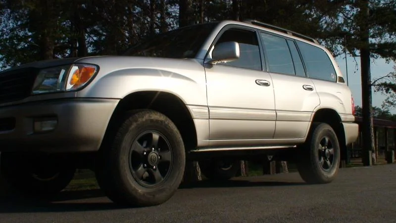

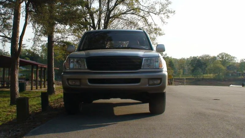

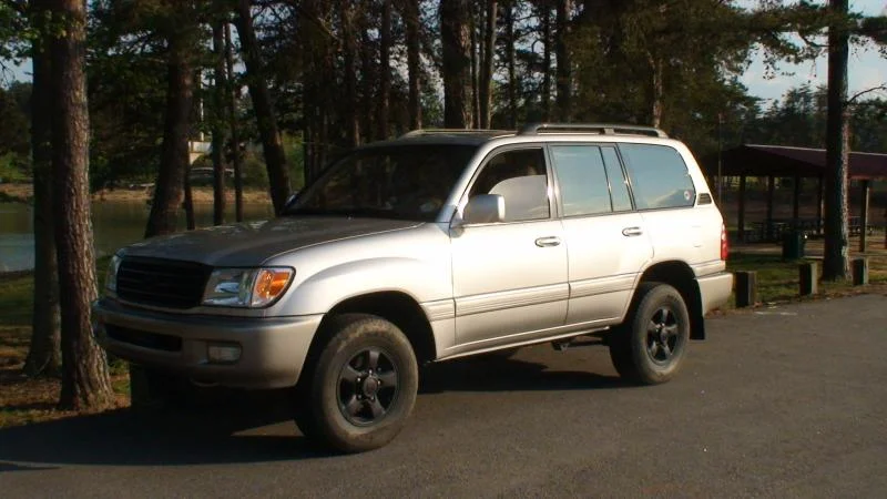

The next stage was to lift the 100 a little bit. I was planning on going 33's and wasn't sure at the time if they would rub or not. I had purchased some used OME 866 springs off a MUD member and got to work in a friends shop. I cranked the torsion bars, and the 866's and I was thrilled. Here are some pictures of how it sat:
attachment.php
attachment.php
attachment.php
Shortly after the "lift" the CV's were leaking badly. I took some hose clamps from Home Depot and installed them over the OEM clamps and no more leaking. I am still running the same exact setup 5 years later and 80,000 miles later. It's doing great :steer:
