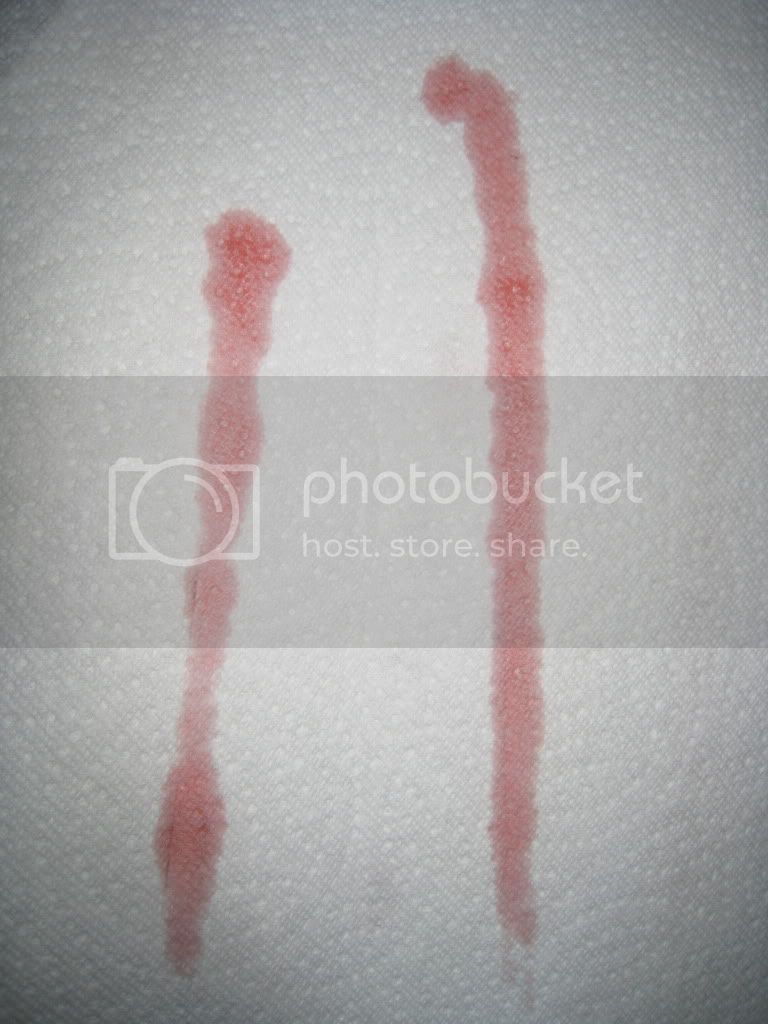

Didn't get a chance to drop the pan, but here is a transmission stick scrape.Note the bits o' metal.
Here's one from a fresh change as a comparison. Definitely something on your stick. How sure are you that it's not coming from dirt at the mouth of the tube? There's also a seam midway down where dirt could get in if the pan had been replaced incorrectly at one point.
That's a lot of fluid by the way. How'd you get so much out on the stick?

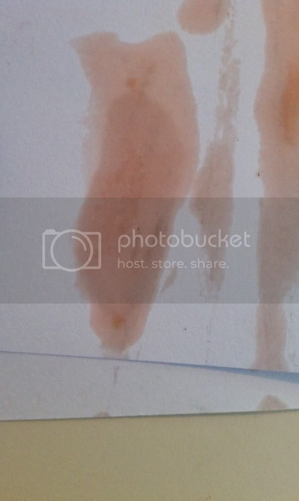

When I wiped it on paper towels it looked much the same as yours as far a quantity - but the paper towels we use have some black flecks in them as a byproduct of the recycling process and I thought I might be getting some false positives, so I wiped the next dip on some printer paper. Now that it's dry the flecks are shiny, not black. I can spot 7 - 2 like a grain of sand and 5 that are only visible as shiny dots if you turn the paper back and forth under a light. I forgot to get a transmission pan gasket this morning, so if I want to drop the pan tomorrow I will have to get one at Advance - and the only one they have in stock is part of a filter kit. IF I buy this, any thoughts on the filter? Or should I just use the gasket and go on? I drove it around today for a few errands - it drives like normal, but there is still that mild vibration/groan in OD around 65-75. I found it rises the harder I press the pedal, even if my tach and speedometer don't really move as a result. Just introducing more fuel to the engine feeds the roar, which made me wonder if it could be some sort of engine related noise. I'm hoping to drop the pan tomorrow, which will tell the tale, but I guess another question is, was I right to assume ANY metal in the transmission fluid is bad news? Or in an aging (120k) transmission is a little bit of metal normal?
