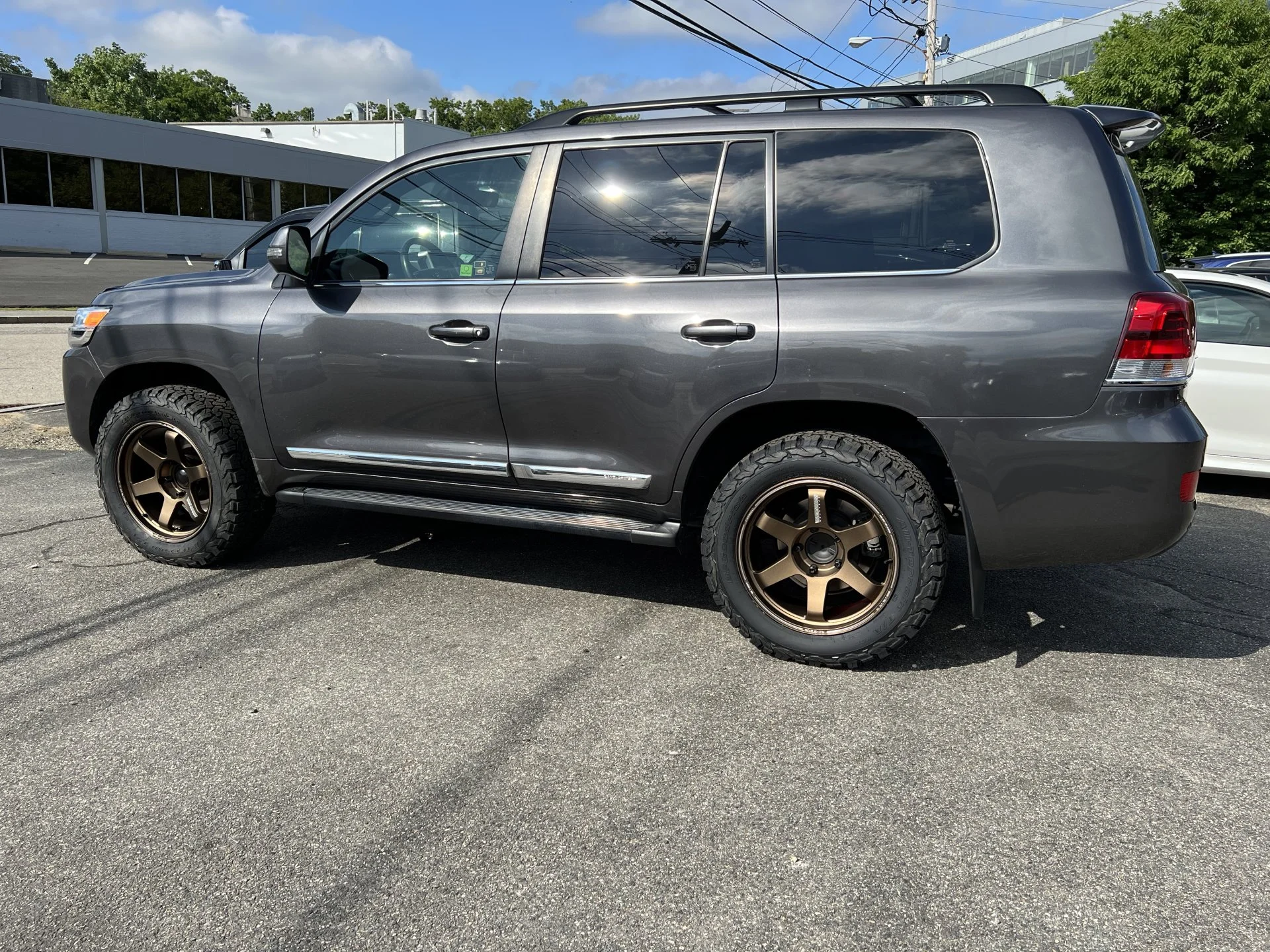

Hey all, I've looked all over the forums and scrolled for countless pages here trying to locate the answer to this question but I'm unable to find it, hoping to get some feedback on a setup for the 2019 LC I just picked up.
I ordered Evo Corse 17x8 wheels and I'm torn between an OME lift and stock stance, can anyone speak to the max USEABLE tire size with the factory set up vs a standard OME set up? I won't necessarily be rock crawling, but I'm in SLC and Moab is nearby/always tempting me to do something "fun", so I don't want any rubbing when I'm actually using the tire.

The first thing you have to deal with when going to sizes over 33" is your kdss and UCAs. Lift doesn't really matter much in that case. You need to check the offset of your Evo Corse wheels vs whatever tire size you want and what you have to do to not run into your kdss bar. You can fit 35s without touching the fenders, but you'll have other things to deal with before you get there. 285/75R17 is a popular size tire for the +25 to+50 offset crowd. I don't have kdss to deal with, so I'm not much help. About 7 million threads on the topic though. Here's one of many

285/70/17 will be plug-and-play. 285/75/17 is also very easy.

You are correct, I am lifted 2.5" or so with Kings.
You're not driving a Tacoma any longer. Welcome to the world of a hefty v8.
285/70r17 is an 'oem' recommended size, so you can run that without too much trepidation at +40.
Anything bigger than 34" I personally would recommend a gear ratio change, but many many are loving 34s without gears.

I'm running 285/75r18 (35") and I find the power and gearing acceptable. Can still pass traffic at 9k elevation without breaking a sweat. The handling, on the other hand, did change pretty drastically with that tall tire. Still dialing in a tire pressure that will produce a Lexus ride quality, and I'm finding it's low, which also exacerbates the handling equation. I have an LX570 (no KDSS), so clearance was not an issue.
I went with 35's because I have a small penis :flipoff2: , but I'm beginning to understand why people say 33-34 is the sweet spot for the 200.
I found a big difference between 129Load E and 121Load D 35" tires in this respect. The 129Load was very finicky on tire pressure, 36lb cold was where I ended up, 35lb would be too soft, and 37/38lb too hard. The 121Load has a lot more acceptable pressures - can go from 32 to 37 (I like 34) and it isn't much different, firmer, but not harsh. Just watch that freeway/hot temp as you go lower psi- you don't want more than a 10% increase in hot over cold pressure (3 or 4 PSI at these pressures).
