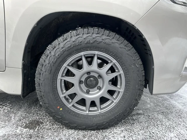

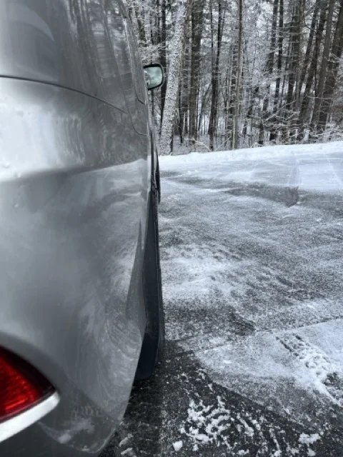

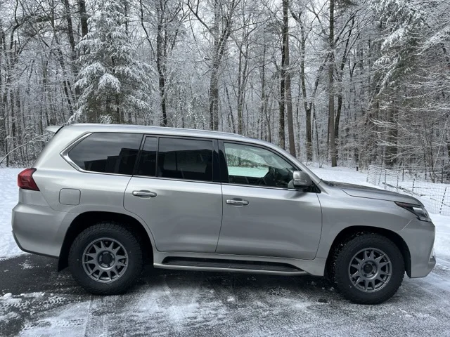

Another combo to add: Evo Corse 18” et45 with 275/65 R18 Falken AT4W’s SL. I wanted a softer and more rugged looking setup than the stock 21’s. Also needed better snow traction for commuting. No rubbing or need for plastic adjustments. The rake looks a bit aggressive but she’s parked on a bit of a downhill angle.
Pardon my ignorance, but what does et45 mean? I like your setup and I want to keep the wheels within the well like stock on my '19 LX, but I want more aggressive tires and 18s instead of the 21s.
et45 means an offset of 45mm
