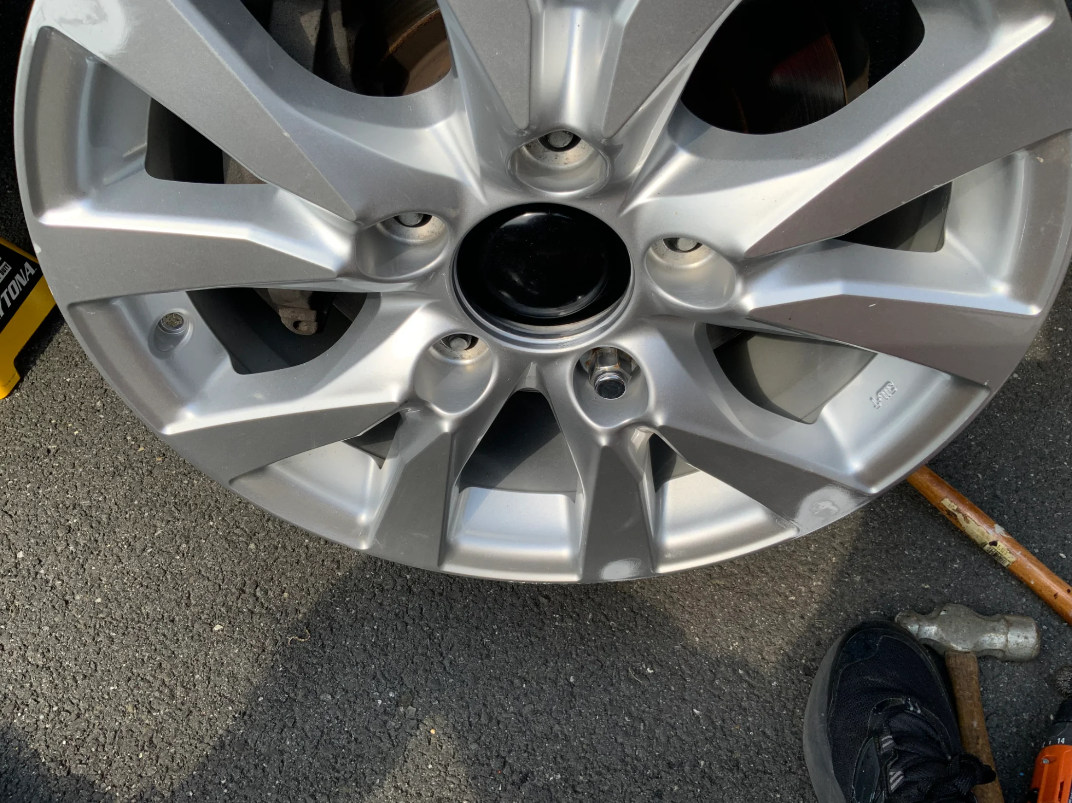

So my pair of caps arrived Saturday morning from Yiyanto ($21.89/pr Amazon Prime). Easy install and then tested with my spare off the 2019. Perfect fit for wheel and the center cap popped right on, no tab trimming required. This is a great fix for just pocket change. The new cap has a flat 3/4' rim all the way around and a lower. less pronounced dome in the center. Sort of a "top-hat" contour.

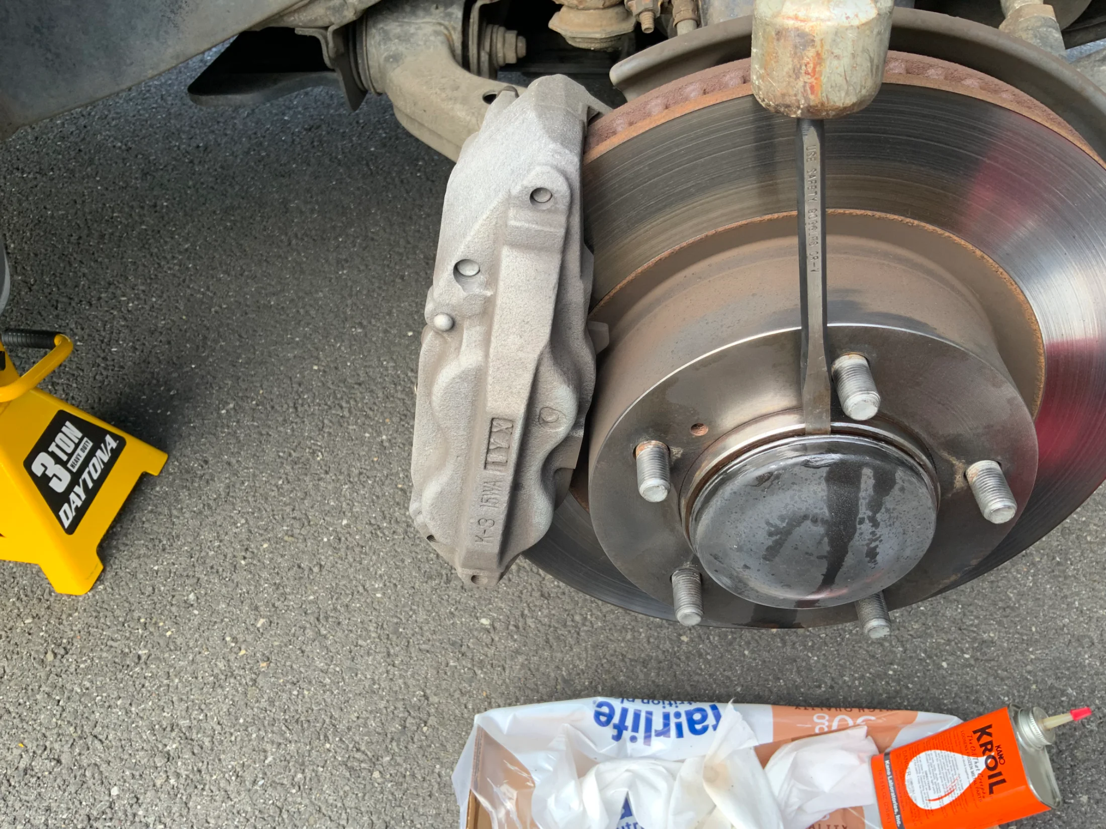

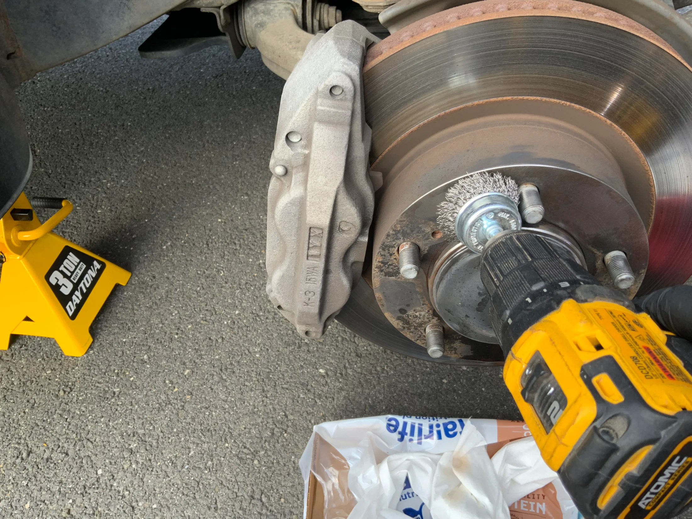

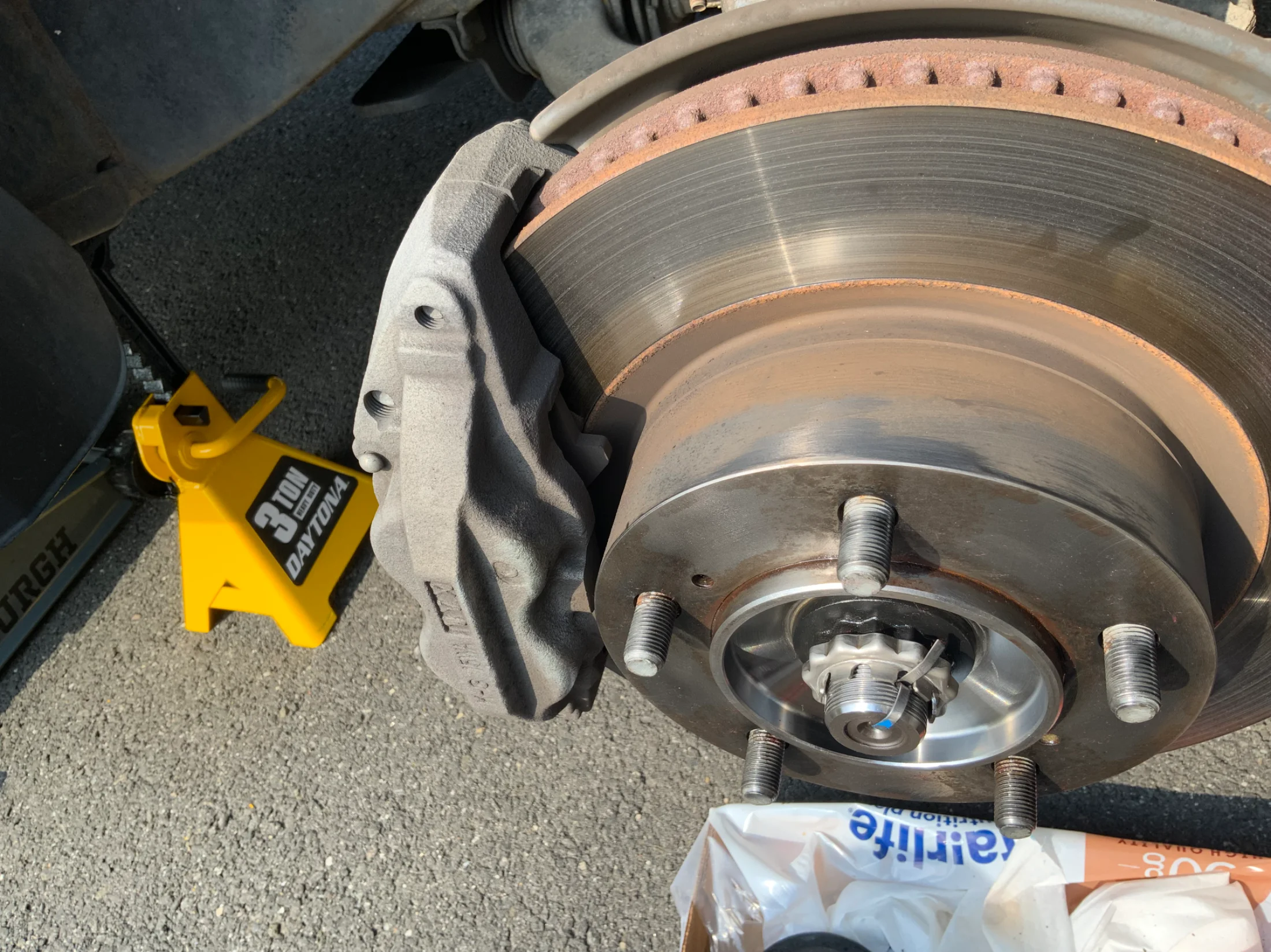

Put a few drops of penetrating oil like Kroil on top and let it run down the seam. Use a very thin chisel or old screwdriver to gently tap around the seam. Give it a minute or two. I’ve now down this on three cars the past few weekends and some pop right off and others take a few minutes. Go slow. Clean up the hub barrel with a wire brush while you are waiting for the penetrating fluid to work. For some reason the hub barrel on the passenger side of all three vehicles had the most corrosion. A small wire wheel cleans it right up and the new wheels seated just fine on the barrel. I coated and wiped the hub barrel with Fuel Film to prevent future corrosion.
We did another one this morning, a 2013 LC. Here’s some pics with a test fit of a 2019 rim.
New cap and test fit of a 2019 rim
Yes, the TOYO logo and TRD center caps fit without having to trim their tabs.
