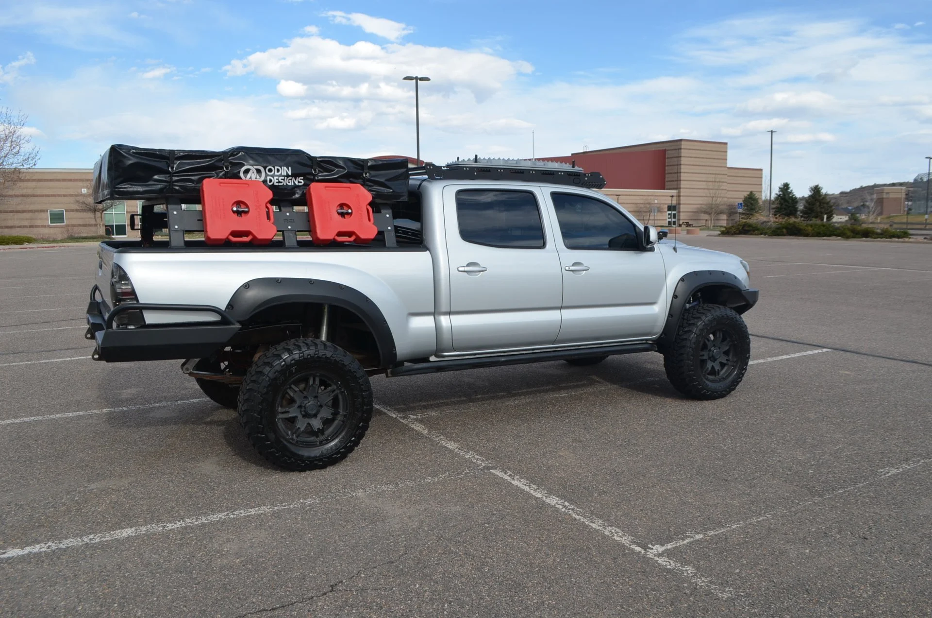

I too came from the Taco world last year and you can not compare the Taco V6 to the LC V8. Good grief not even close. So. Much. Power. And in your case you had a 3rd gen. Those rigs are notorious for being underpowered. If re-geared to 5.29's then they act right. Sad but true. On my LC I am running 285/75/17 with a lift and fully loaded going through the Colorado mountains the LC will go as fast as you want it to up the mountains. Gas mileage hurts but that is why I have a daily driver. FWIW with the lift, 285/75/17, and a Toytec alignment there is no rub on the KDSS for my LC.
Seriously though welcome to the LC club, it's a whole new world. Pic of my Taco during sale for reference.
I figured I'd find a few Tacoma converts hanging around here, yours was good looking! My truck was re-geared, so it wasn't the worst thing in the world, but it definitely wasn't enjoyable on the long mtb trips both in acceleration and overall comfort. I really just want the cruiser to work without much fuss, if I could clear a 285/70r17 on the EvoCorse wheels I ordered without much effort I'd be tempted to go that route. 285/75r17 with a small OME lift that would accommodate an ARB bumper may be an even better solution in the long run though... I just worry about rubbing on the KDSS and opening that can of worms. Really just hoping for a set it and forget it situation that will work on moderate trails/camping and handle the highway miles in comfort.

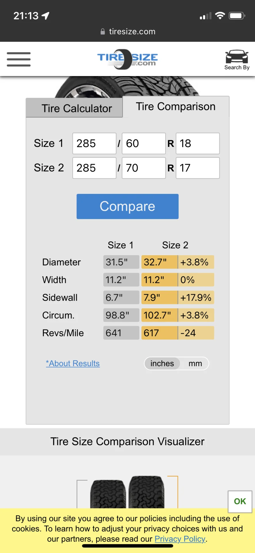

I don’t have a tlc and I’m sure a tlc owner will correct me if I’m wrong, but there is no reason a 285/70r17 on a +40 offset would require a lift.
Correct.
There are a ton of threads here, that size is set and forget.
Edit: Remove front flaps and heat gun front fender liners(worst case)
That is what I am seeing more and more, which is definitely tempting. The only real concern I'd have with the 285/75r17 and small lift route would be that it seems like some are rubbing on the KDSS (ET40 specifically), which I need to educate myself a bit more on potential solutions if it comes to that. An upgraded suspension and classic ARB bumper is extremely tempting though! First world problems.... Appreciate your insight
Correct.
Dual concurrence, I appreciate it. No issues with minor trimming etc... Just a bit nervous when we get into KDSS rubbing and I'm OCD enough that even "a little rubbing at full lock" wouldn't be acceptable to me.

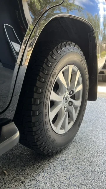

@gaijin kindly provide RCTIP for BFG Trail-Terrain 276/65 R18 on a 2018 LC. Been running at 35 and they seem right.
Been running these for about 3 months now, in several different conditions - long highway trips, stop-and-go, and a good bit of rocky wheeling in the TX hill country. Must say I’m very pleased. They are slightly quieter than stock (with 40k) at highway speeds and have a touch more aggressive look. A little more grip changing lanes at high speed - now I’m used to it. No difference in gas mileage. Also filled the wheel well a little on my stock-for-now rig.
