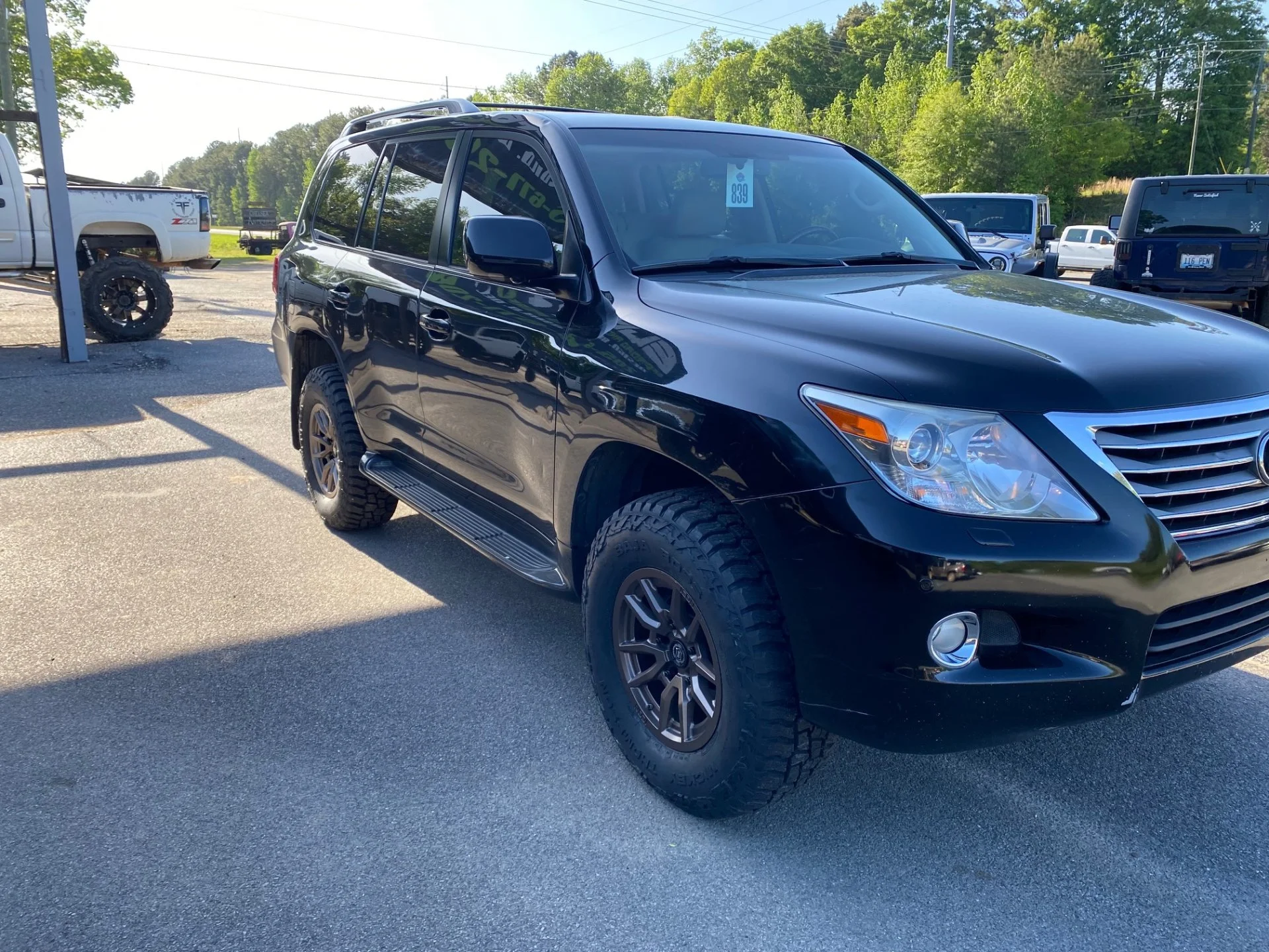

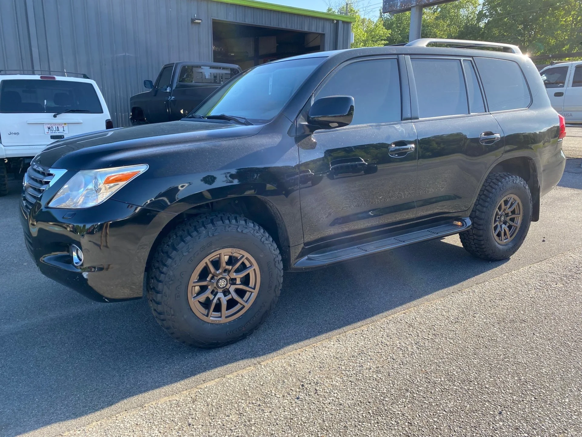

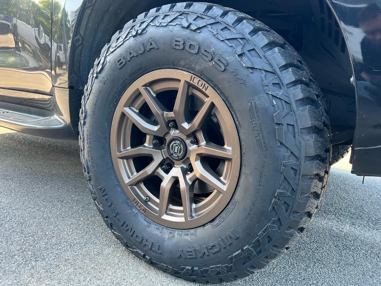

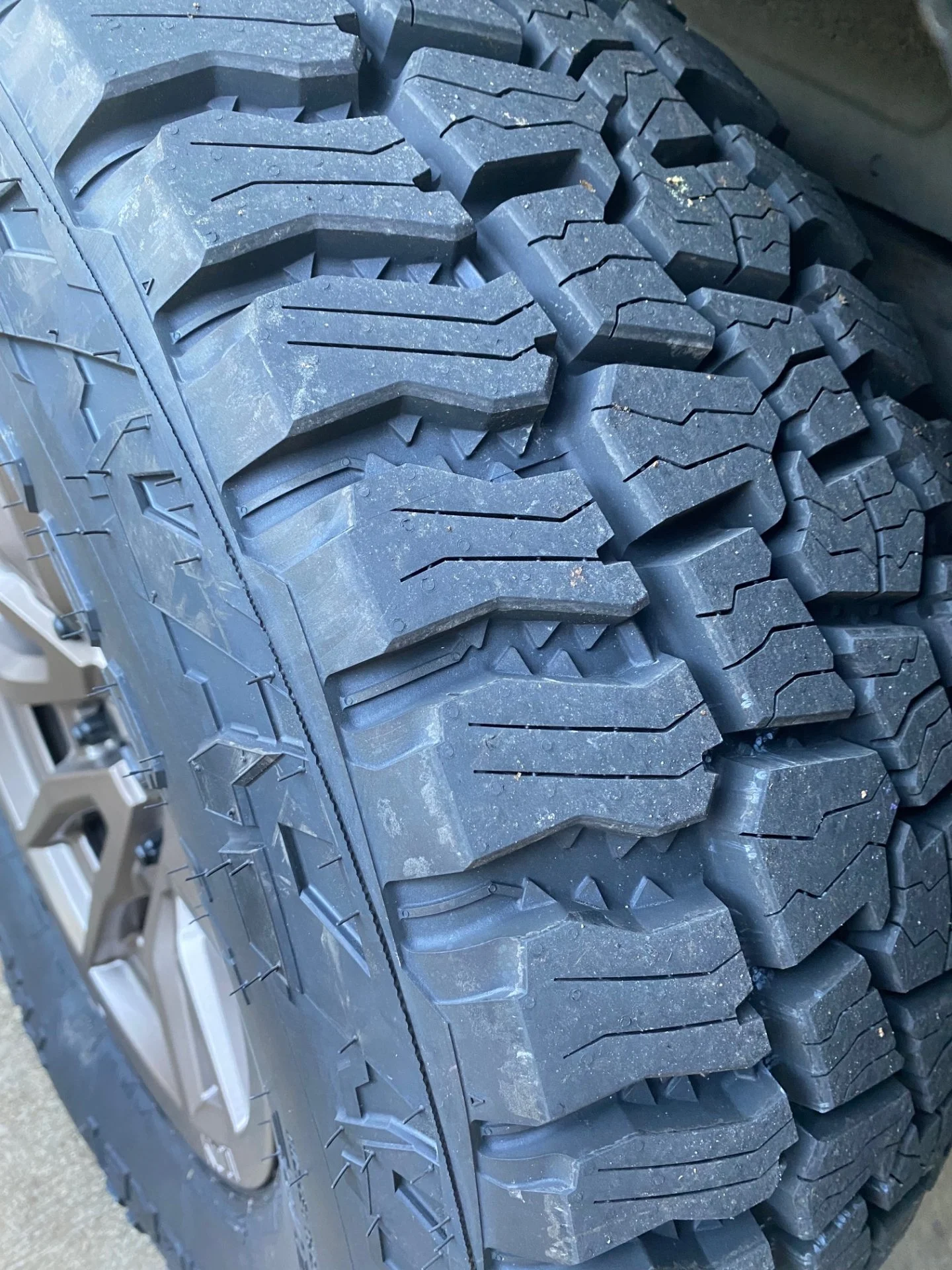

First impressions are good. They are smooth and relatively quiet. I would say they are quiet for as aggressive as they are. Slightly louder than KO2's I put on my 100 series. Nothing like the Patagonia MTs I had on my last truck - much quieter and smoother than those. Ride is good, can't comment on traction yet because I have only driven in town. I just adjusted them to the proper PSI last night so I will give an update, but the ride is smooth. More pics for your viewing pleasure.
Those look great. I might just go ahead and back order a set

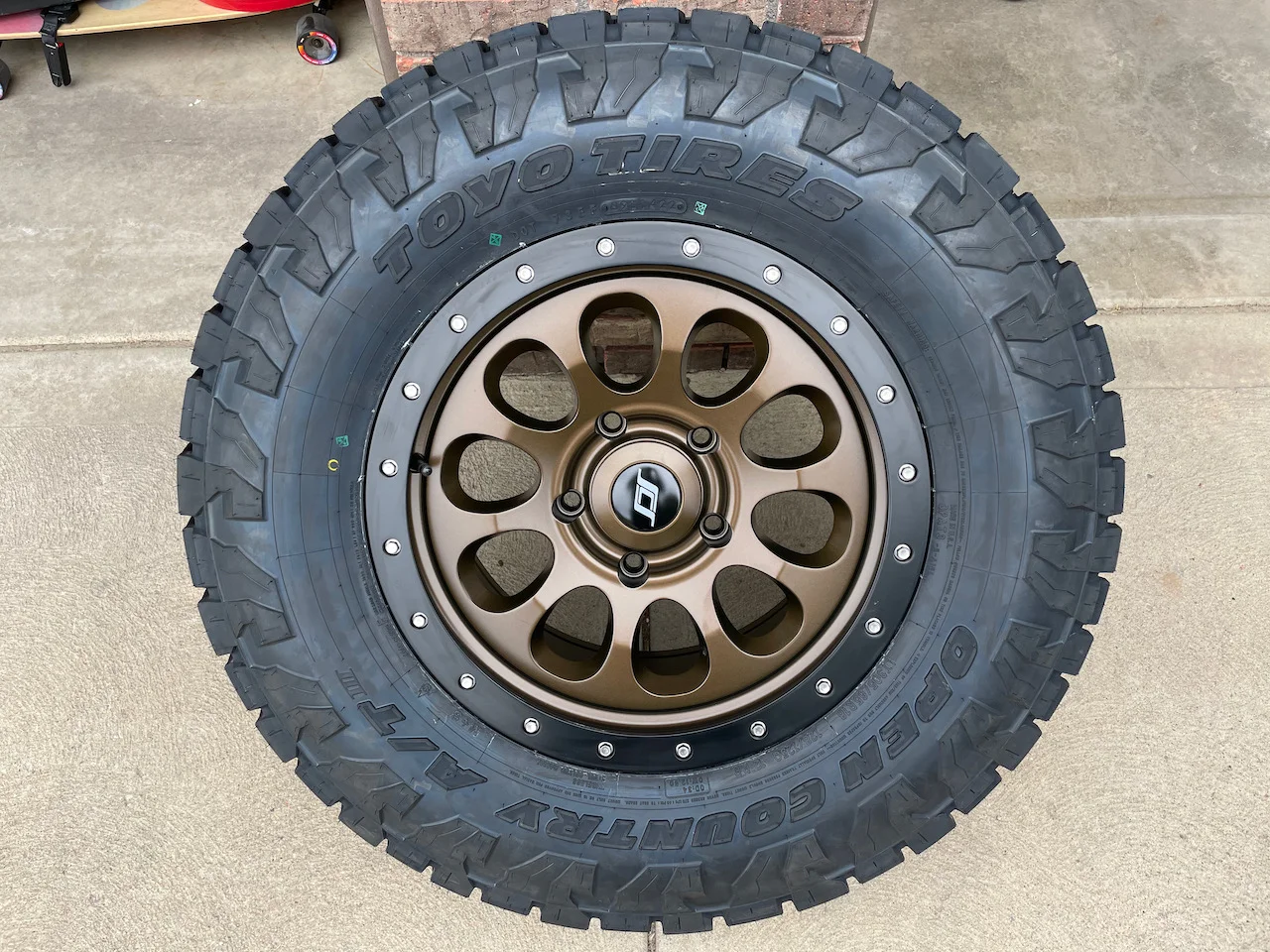

1st time LC owner and just picked this up about 2 weeks ago. 2017 Metallic grey with terra interior. Got the tires mounted today, just waiting on some free time to install a lift on it. Got the Stealth Custom Series Ray 10's in Matte Dark Bronze, 18x9 +25mm, wrapped in 305/65/18 Toyo Open Country A/T III's.
~1” per side from stock is pretty typical…..?
Pretty sure he’s making a joke about how the tires are rolled up in front of the wheel wells.. looks like he has 8” spacers..
