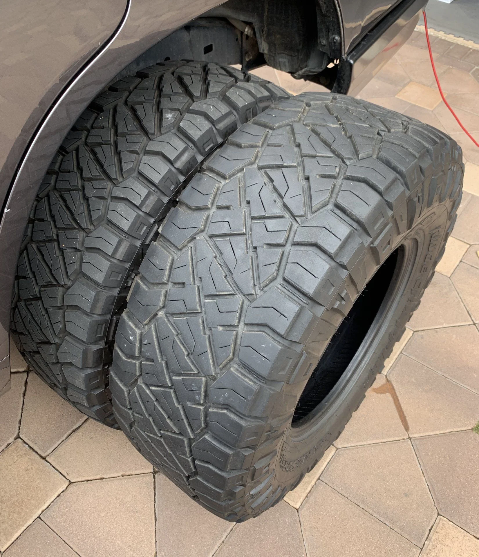

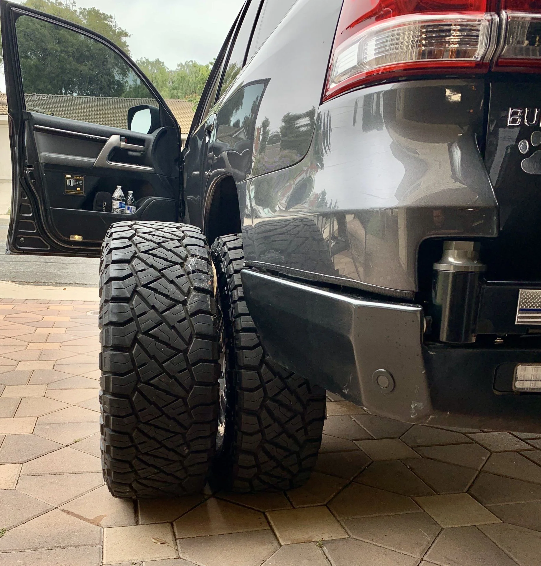

Funny... About an hour ago I rolled one of my 35's next to my mounted 34's (285/75/17) and snapped a photo.
This height comparison is a visually off since my mounted 34's are squatting a bit under the weight of my fat pig truck...but the WIDTH difference is striking.
2011932
One more...
2011939
Bottom line... Everything works better with 34's. Got rid of my KDSS relocation...replaced my very bent end-links/bushings.Truck is MUCH happier this way...even if it will never look quite as beautiful as it did on the fat 35's. ;)
One more...
