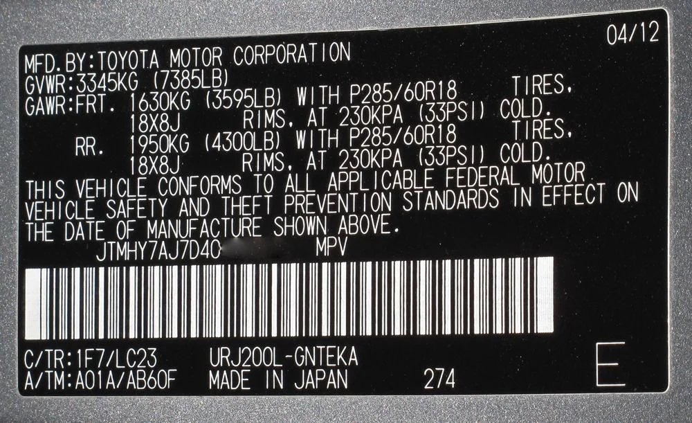

Hello
What is the correct pressure for Toyo Multiterrain MT 295-70 R17 tires for LC 200. Thanks
Do you mean the Toyo Open Country M/T LT295/70R17 (33X11.50R17) 128P Load Range E tire?
And is your LC200 a Land Cruiser with the 5.7L gasoline engine?
Yes that's the correct tire and Landcruiser 200 with 4.5 L Diesel engine,
Thanks
Thanks
OK. For your engine, I will need a picture of the TIP (Tire Information Placard) found on the driver's side door jamb - it will look similar to this:
Thanks.
