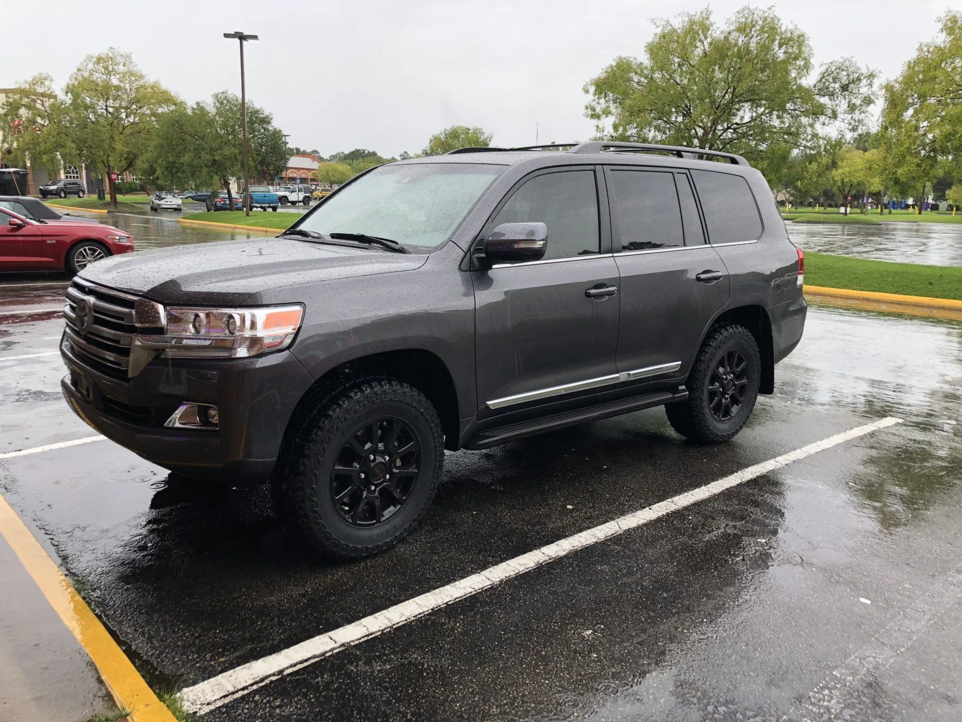

Did not mean the 17 TRD’s. I ended up going with BP51’s, SPC UCA’s, 18 inch TRD Pro’s and 275/70/18 Cooper ST MAXX tires. Great setup.
