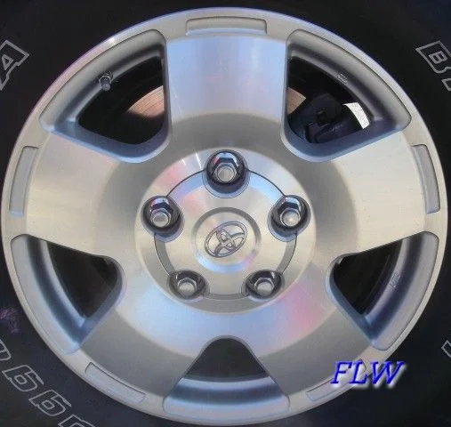

Anyone mounted older gen 18" Tundra Aluminum 5 spoke rims on there 200? I have posted a pic of rim I am looking to slap on my 09 LX... I have searched and have not found 1 pic with these specific rims on a 200 series....
......Pic Request......plz....
They aren’t super popular because of weight. They are heavy compared to other Tundra options.
They will fit they are 18x8 60 offset. Like @tbisaacs said they weigh the most of any of the 18s Toyota made for the tundra

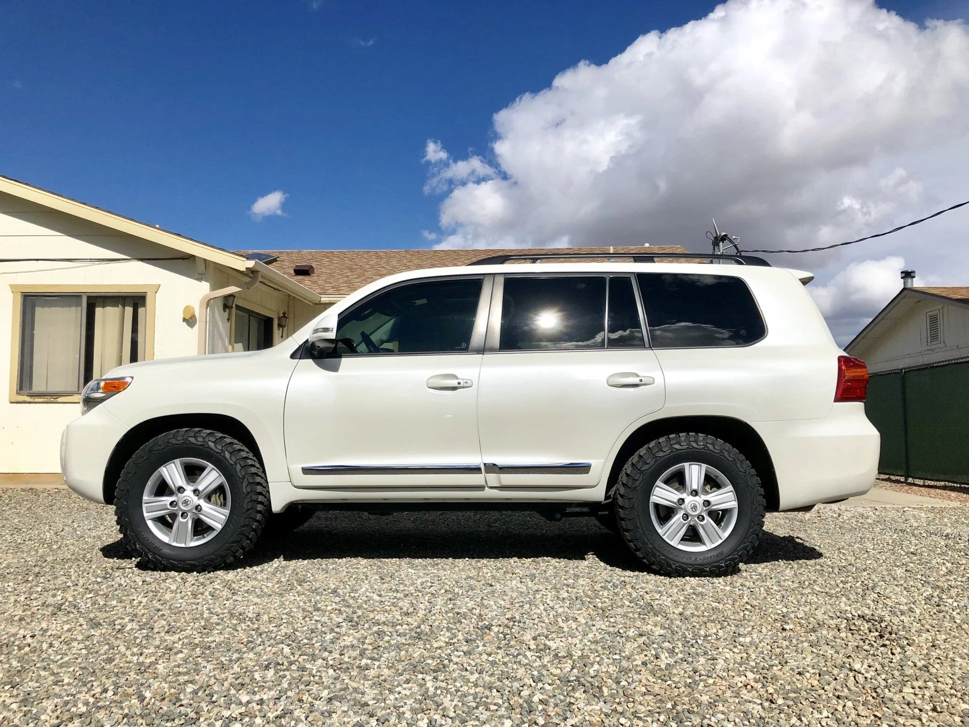

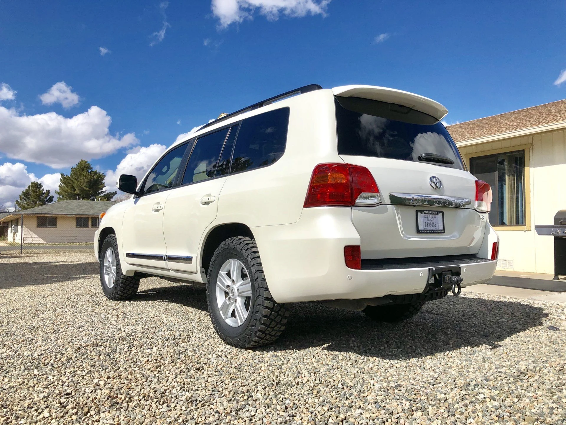

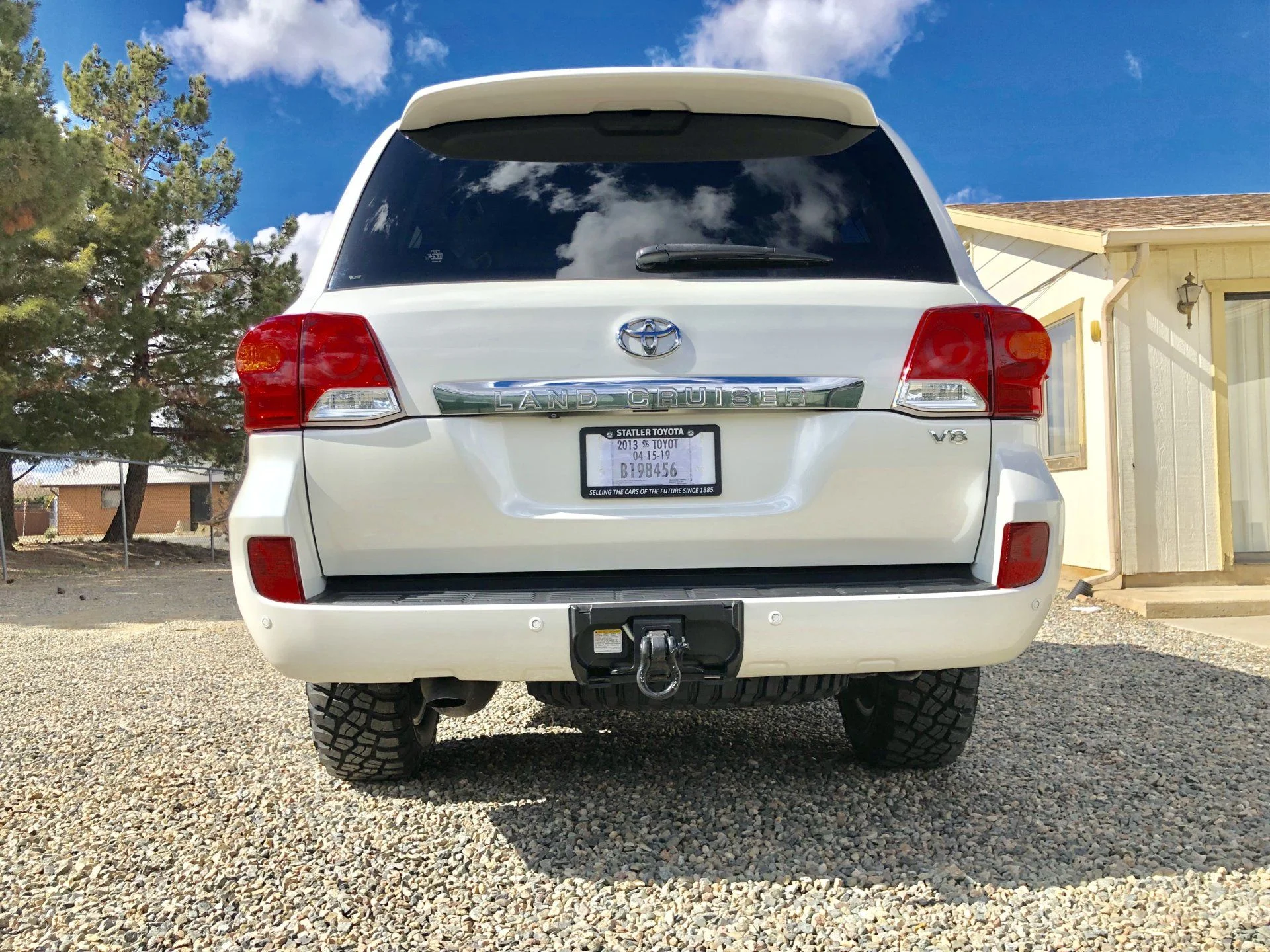

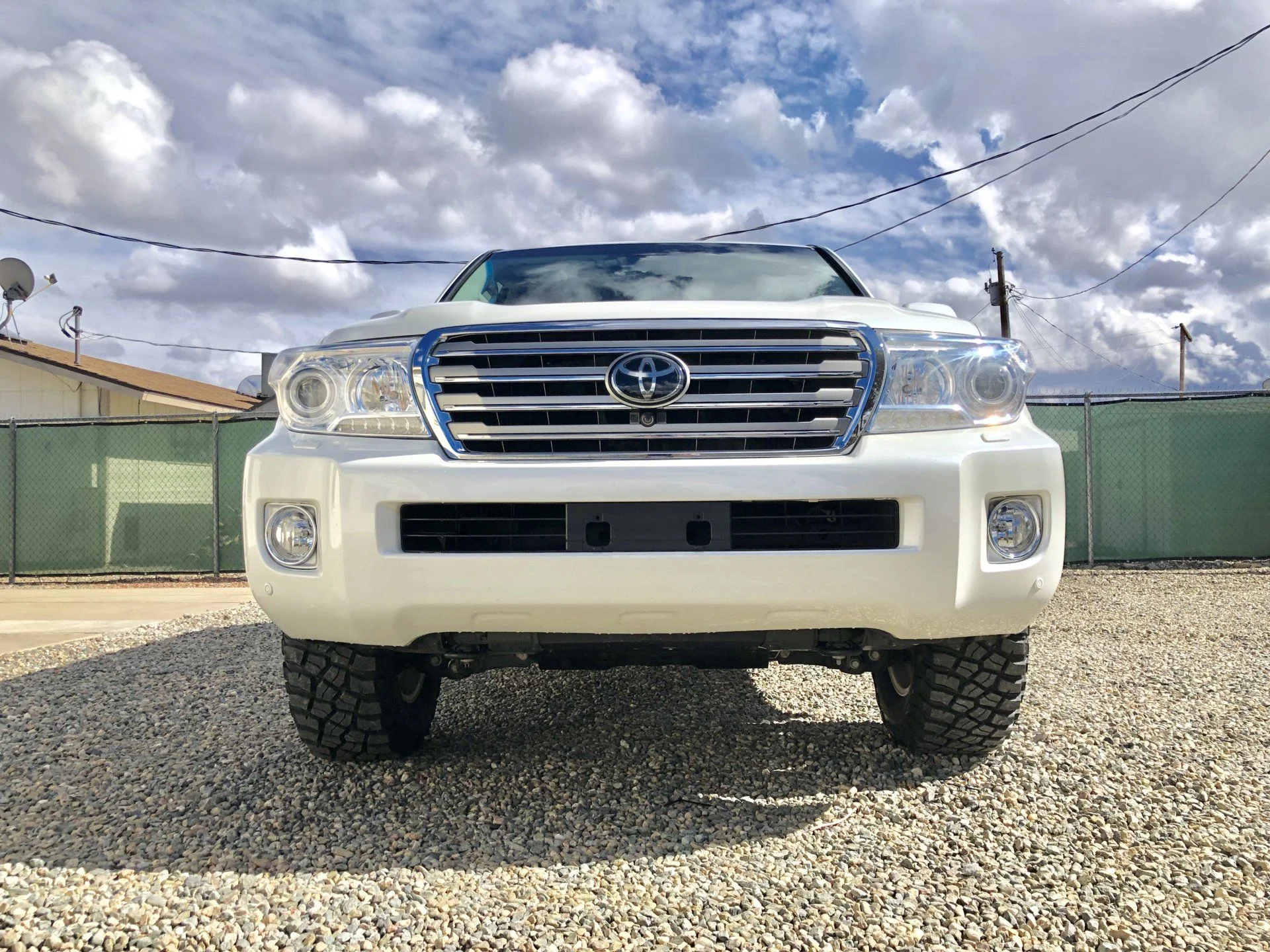

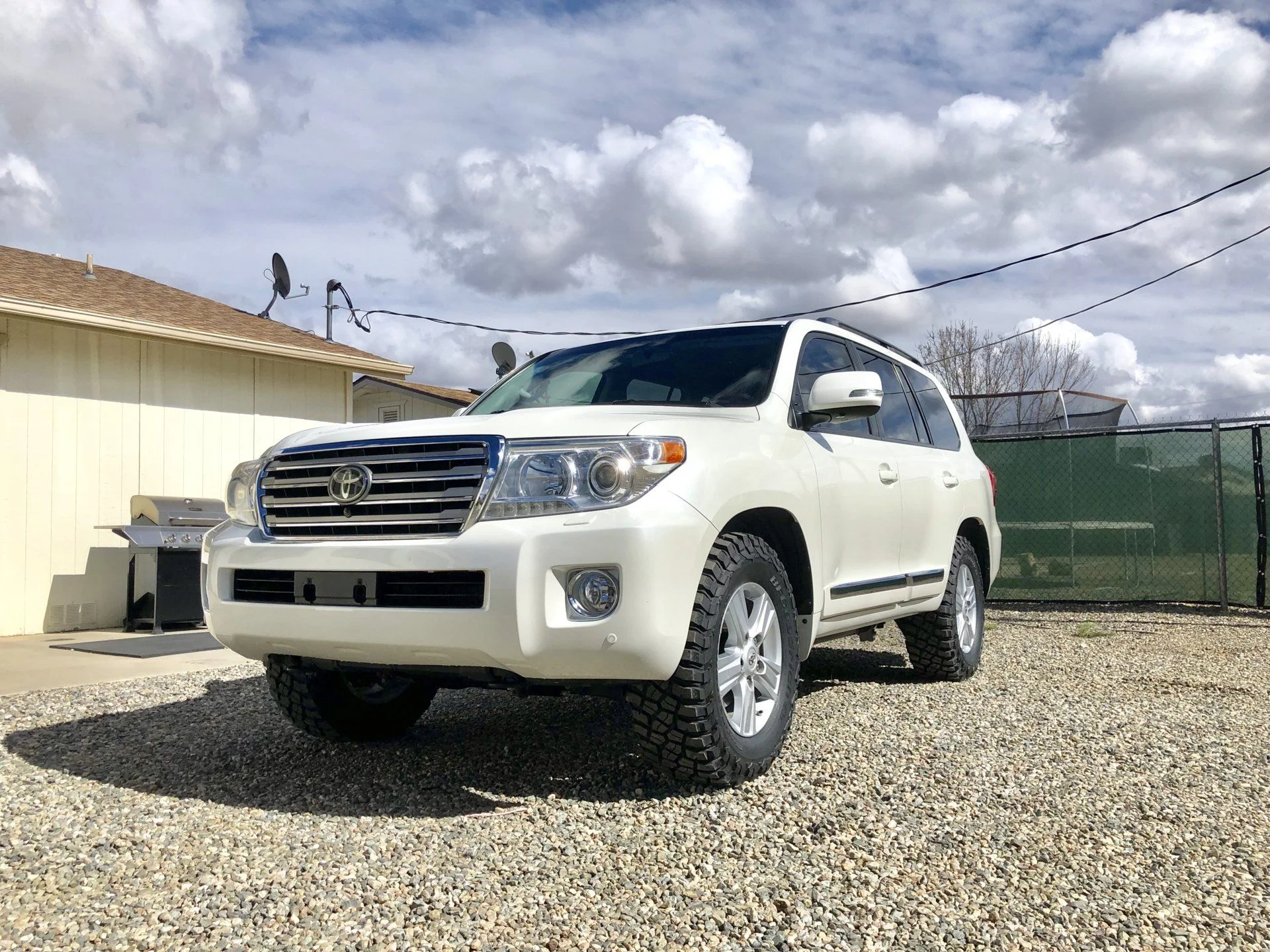

275/80r18 on 35mm offset (35 1/4 inflated, 34 3/4 on the rig)
Removed rear mud flaps
Removed front mud flaps
Pushed front liner forward about 1.5 inch
Removed inner rocker cover bracket/bolt (it’s behind the front mud flaps)
Some minor heat gunning to the front rear liner
This is on an lx570.
