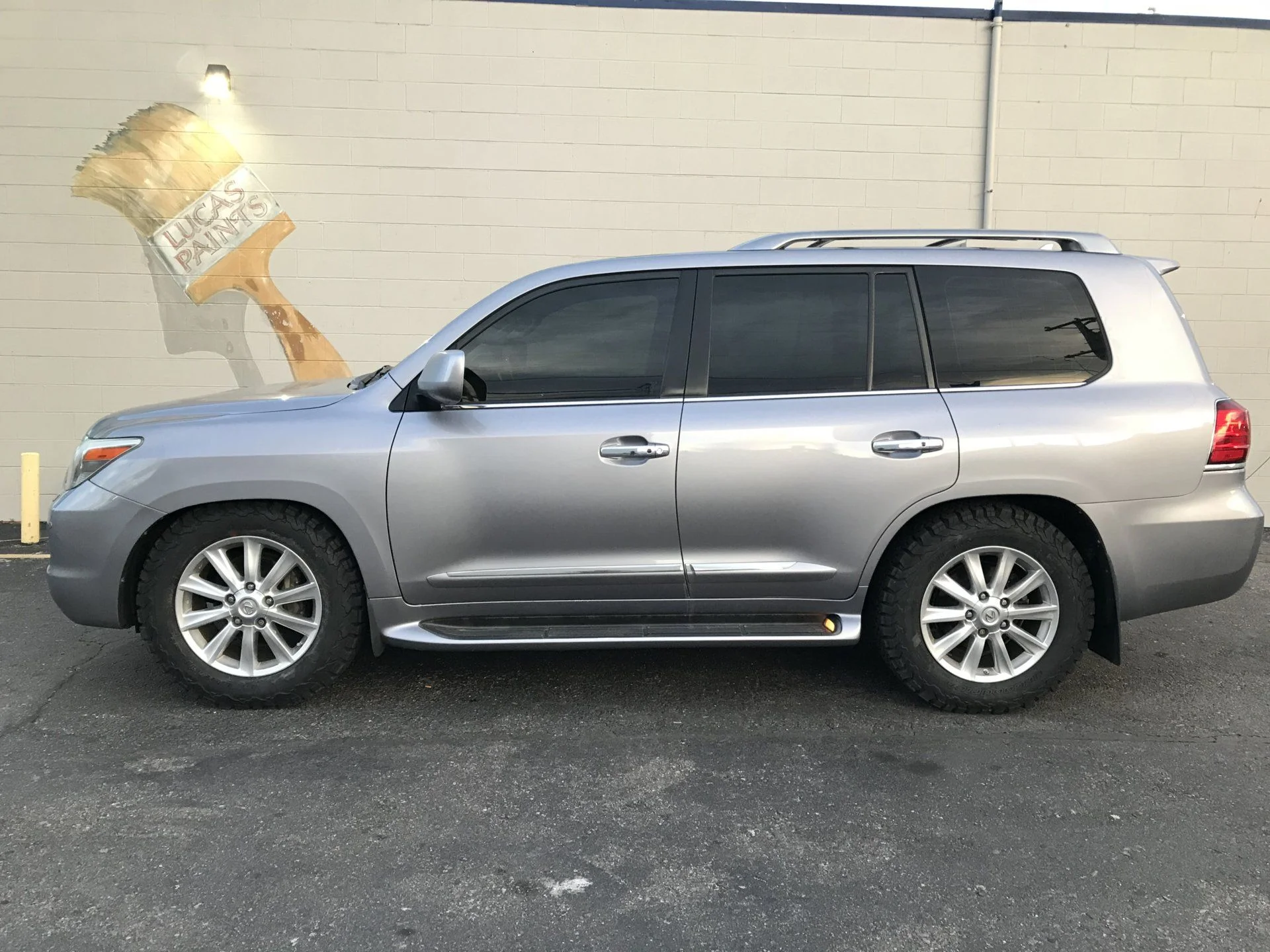

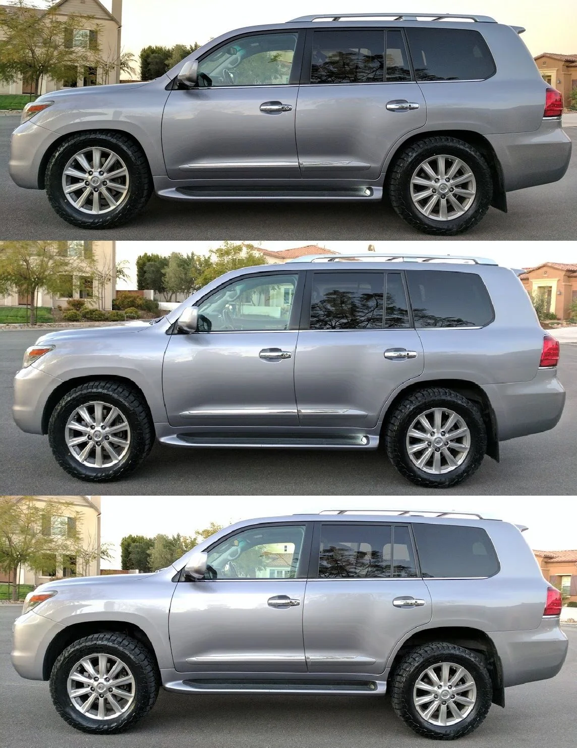

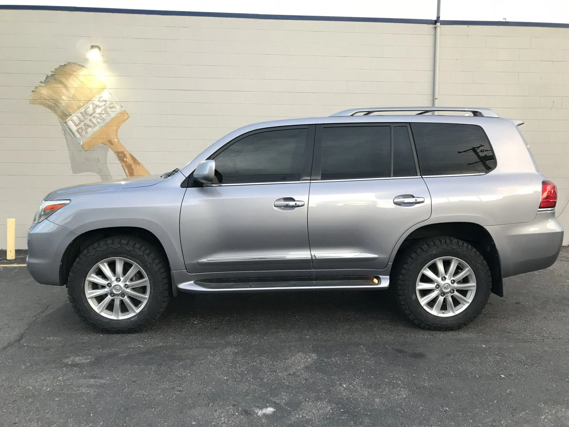

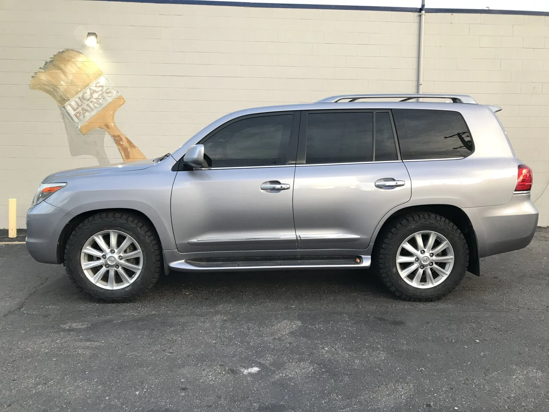

Teckis already answered well, but I’ll add that I put 275/65/20 KO2s on my stock LX570. Removed the mud flaps on the front wheels and was good to go. Keep in mind a KO2 runs a little smaller than many tires in that size, so YMMV.
Neutral/high/low:

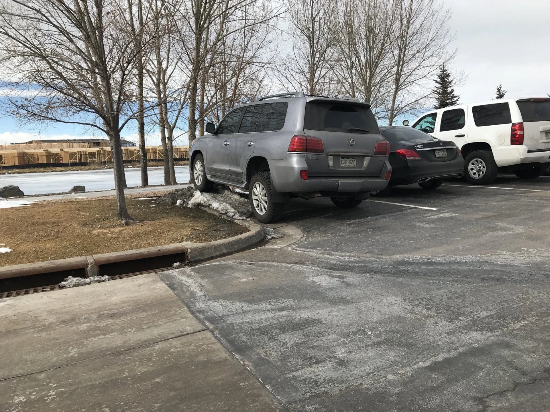

@mcgaskins Love the 2nd pic. Stuffing tire. Must get odd looks parked when it's dumped.
Neutral/high/low:
View attachment 1656923 View attachment 1656924 View attachment 1656925

Yep it’s easy. Flexes nice with the size too and doesn’t rub anywhere.
