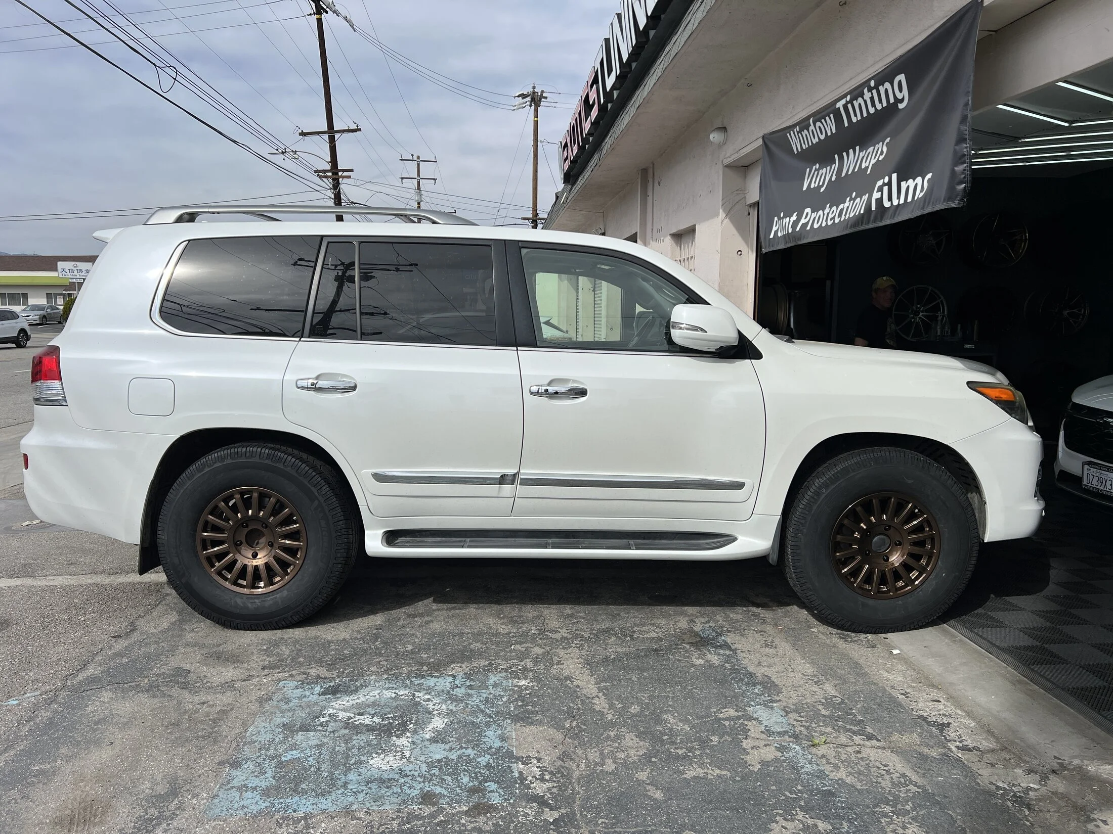

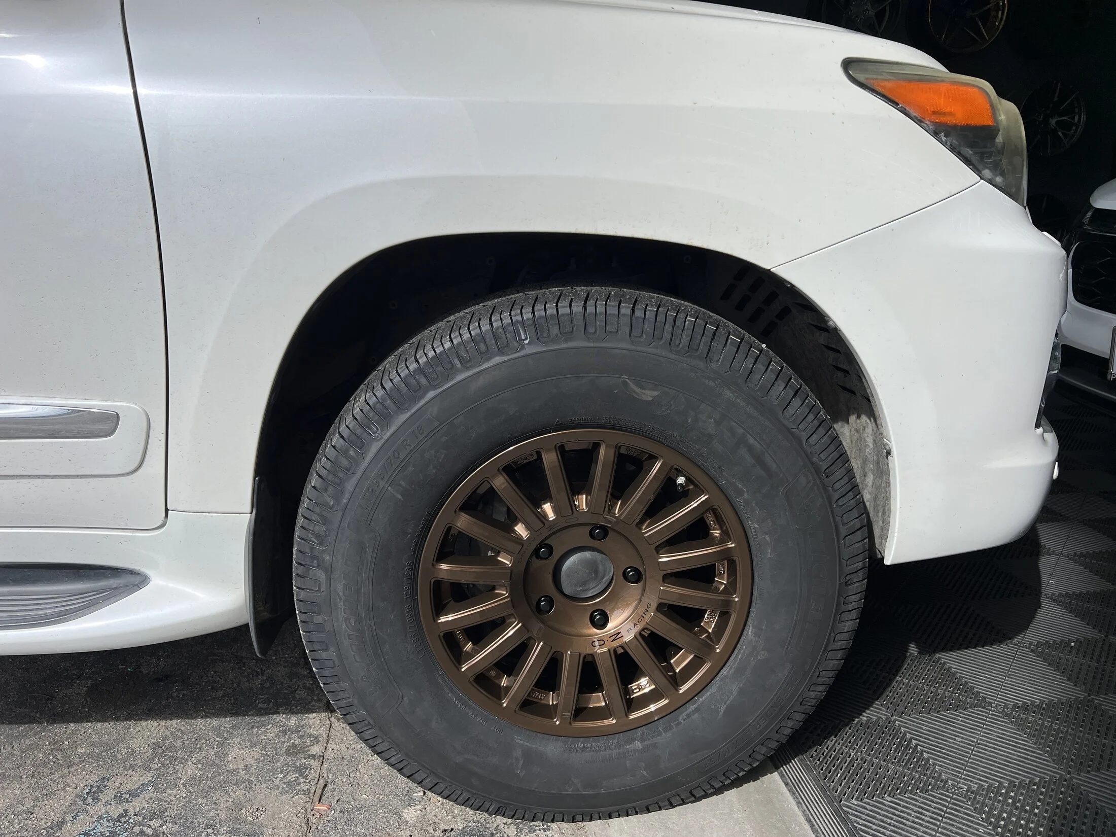

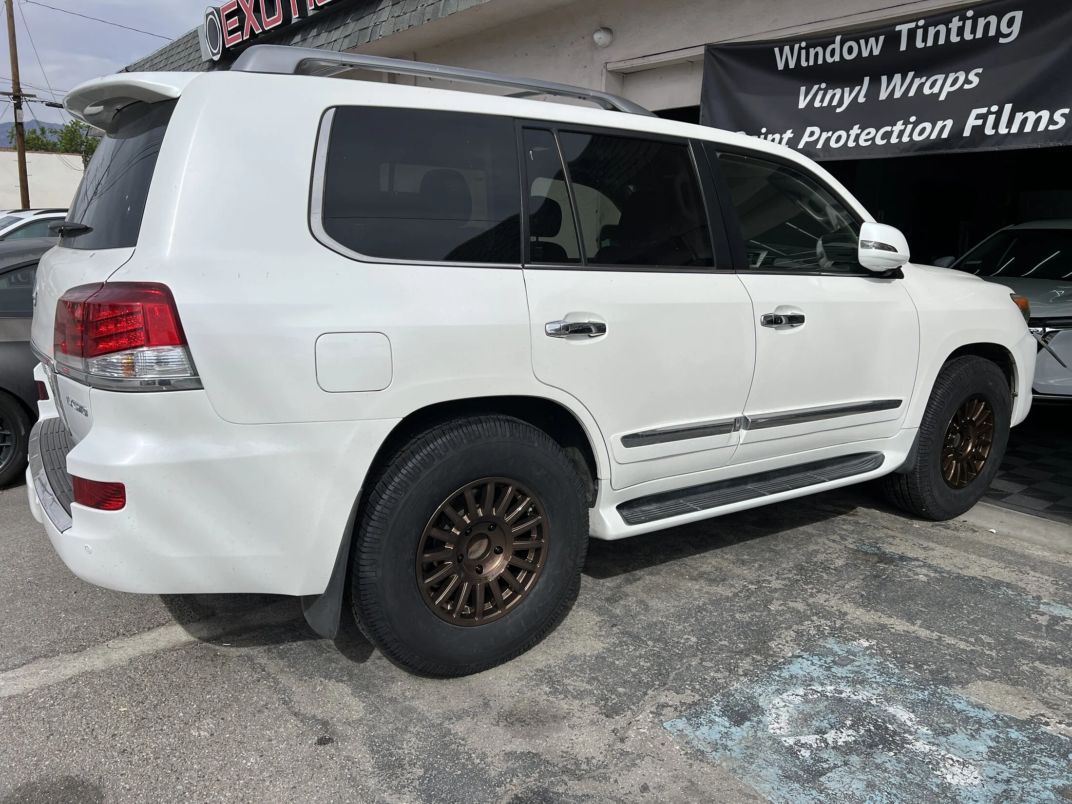

I want to make sure I’m reading this correctly as I’m switching up my wheels and looking to up tire size slightly.
2011 lx 570 (stock height/ no sensor lift)
Currently running 285/55/20 with stock +60mm Lexus wheels
I have a set of TRD RWs +50mm offset that I’m looking to add rubber to. I know the 285/70/17 will fit with no modifications needed. Is it safe to assume a 285/75/17 would fit with no issues? TIA

I run LT285/75R17 on RWs and have no issues with metal contact, but did have to move a lot of plastic.

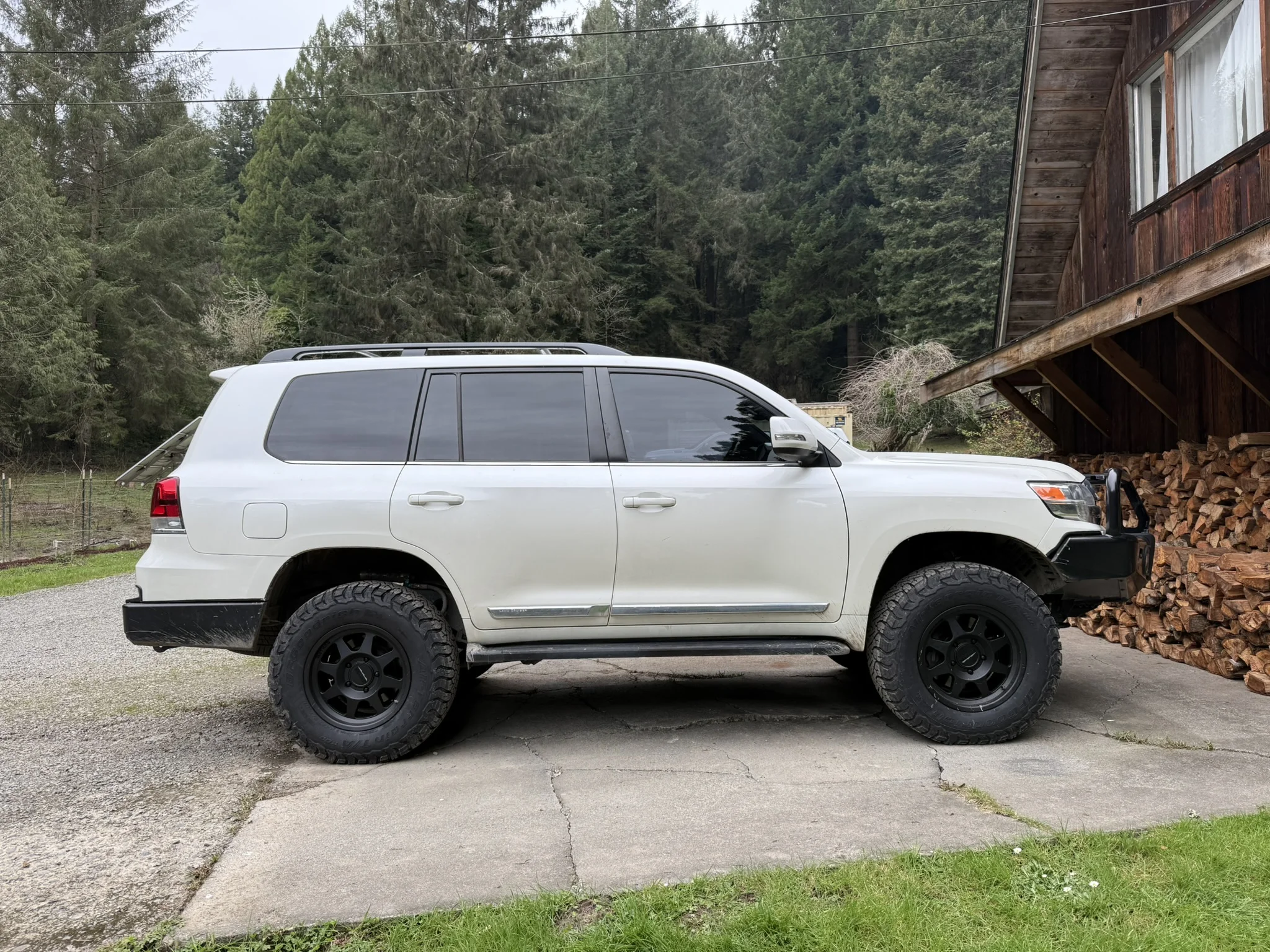

Method 701 18x9 +25 offset BFG KO3 285/70R18. 3" King / OME 2723 lift. No rubbing.
