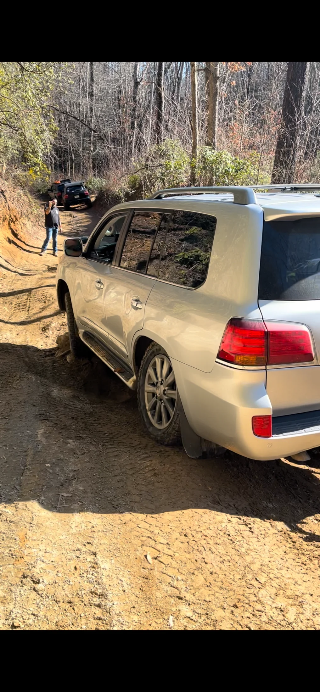

Quite happy with results. Immediate impressions very comfy. No noticeable noise increase.
Tire shop put them at 35psi but I believe they call for 40.
Is gaijin around for Rcitp? Don’t know how to tag anyone.
So good looking! I’m going to look at a set of RWs this weekend hoping they check out. They come with same size trie you just mounted. I’m currently running 285/55/20 with no issues. Should I expect any rubbing issues going to the 285/70/17? Thanks
No rubbing issues on LX nor LC200 with these on 285.70.17 with the particular RW wheel offset (40mm or -40mm I believe). No sensor lift needed. No spacers. Many articles about this being “the largest stock-ish” tire combo with no trimming.

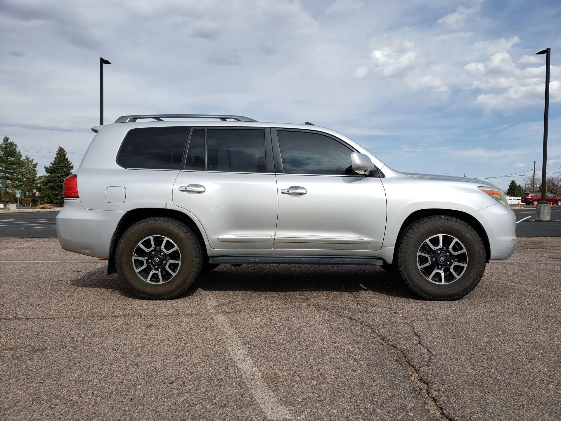

Yup. They're common second gen Tundra wheels: 5x150 lug pattern 18x8 +60, equivalent to the stock LC wheel spec. I don't much like the contrasting machined finish but I think they look great in solid colors.

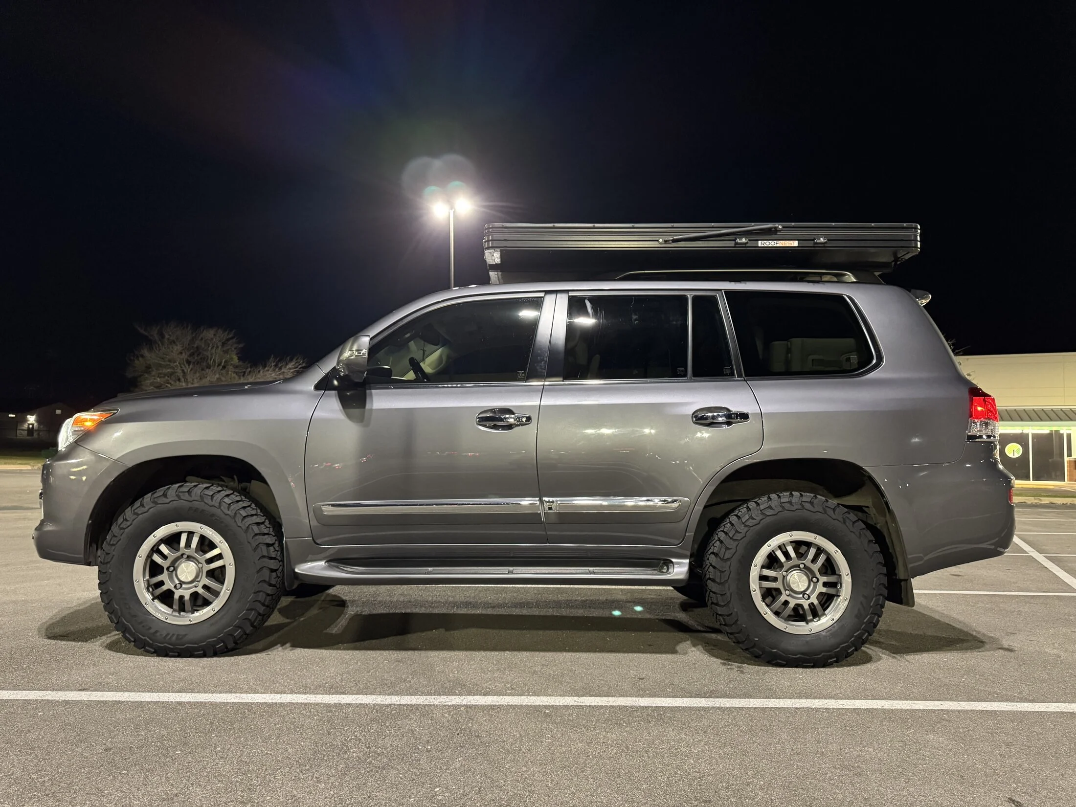

:D Great wheels if 18" is your jam. Here's 35x11 with 1" spacers (spacers not required for more conventional tire size)

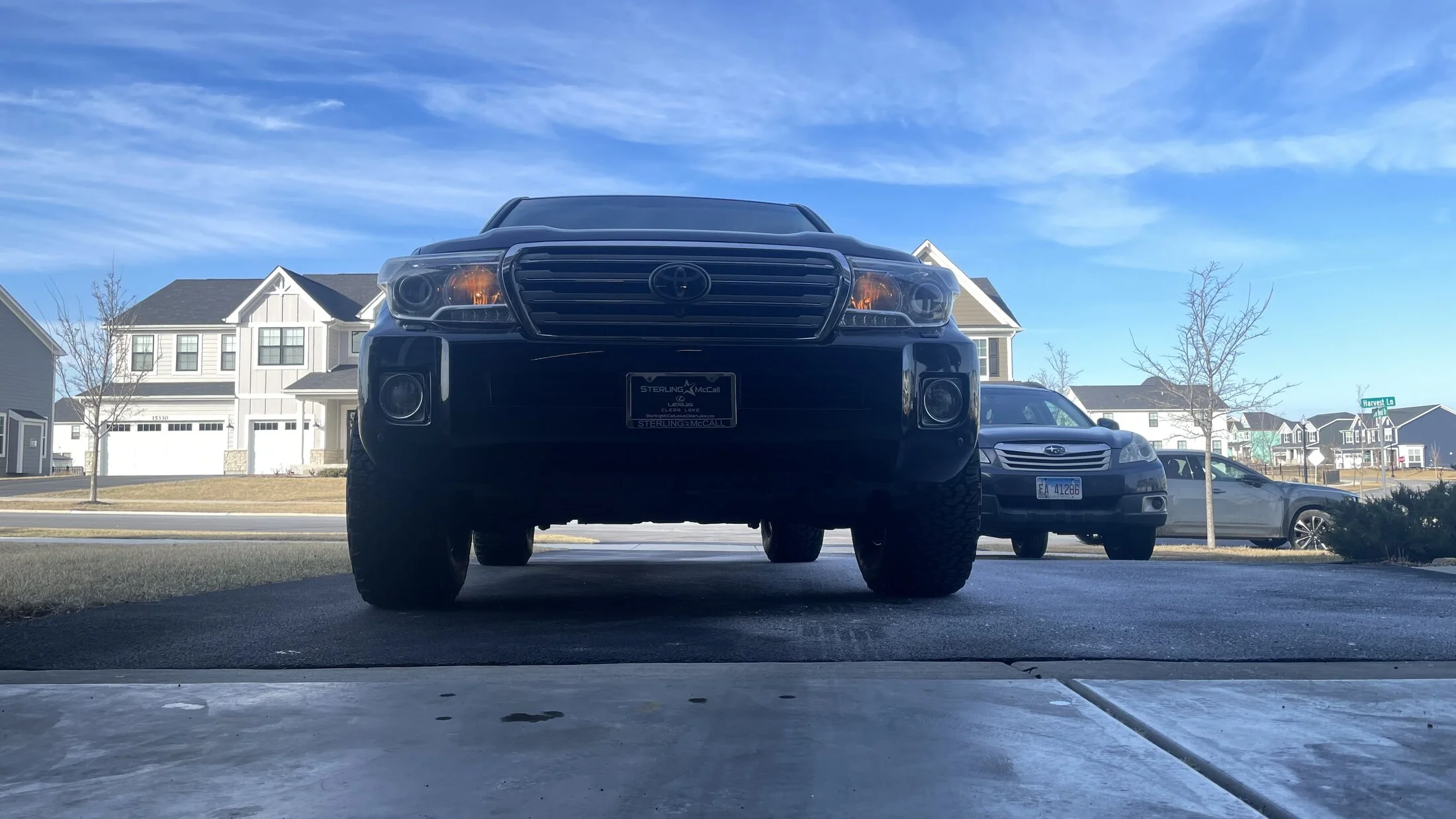

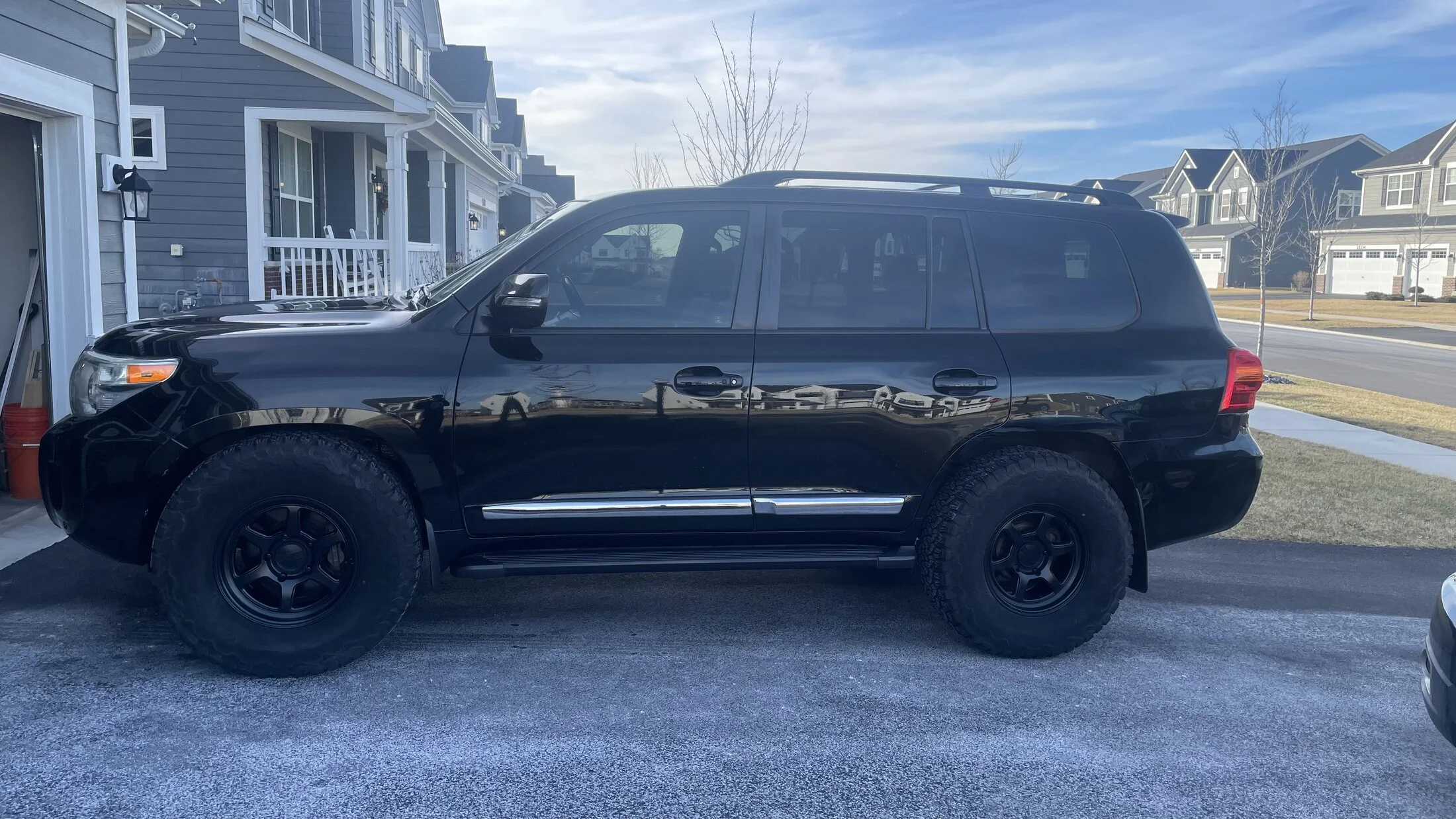

In case anyone is wondering what 315/70r17 on a +0 offset wheel looks like on completely stock suspension. Looks great as long as there are no turns or bumps in your future. I need to rethink my approach here. Might be some +25 wheels in my future.

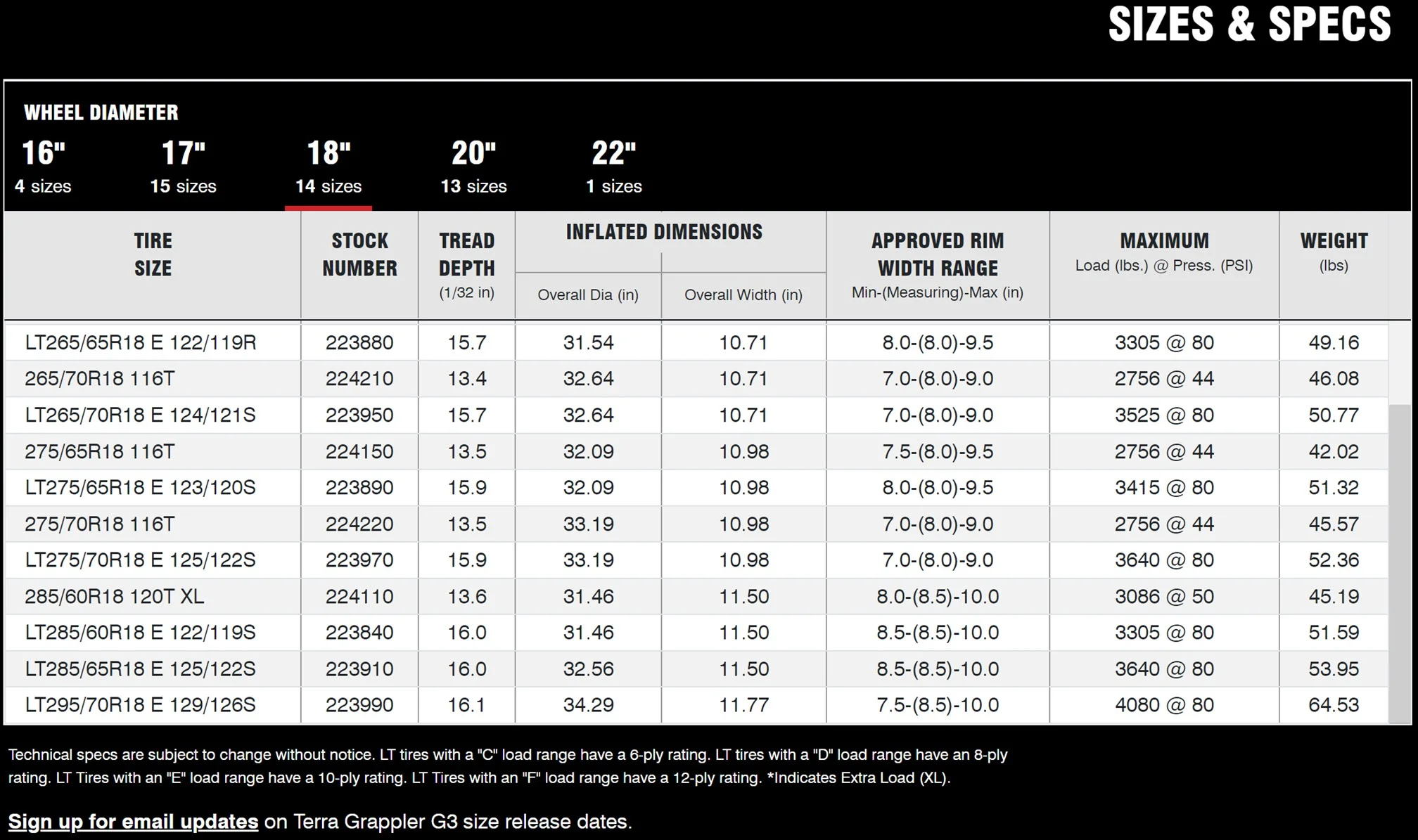

@gaijin could I please get the RCTIP for the Nitto Terra Grappler G3 in size 275/70r18 for my HE LC? Thanks in advance!
I need more info.
Nitto has two very different "275/70R18" tires, one ISO-Metric, the other LT-Metric. Which one do you have?
HTH
I have the 116T ones, which I believe are a SL load rating. Thank you @gaijin
Thanks for the additional info!
The RCTIP (Recommended Cold* Tire Inflation Pressure) for those 275/70R18 116T SL tires on your LC200 is 33psi F/R.
