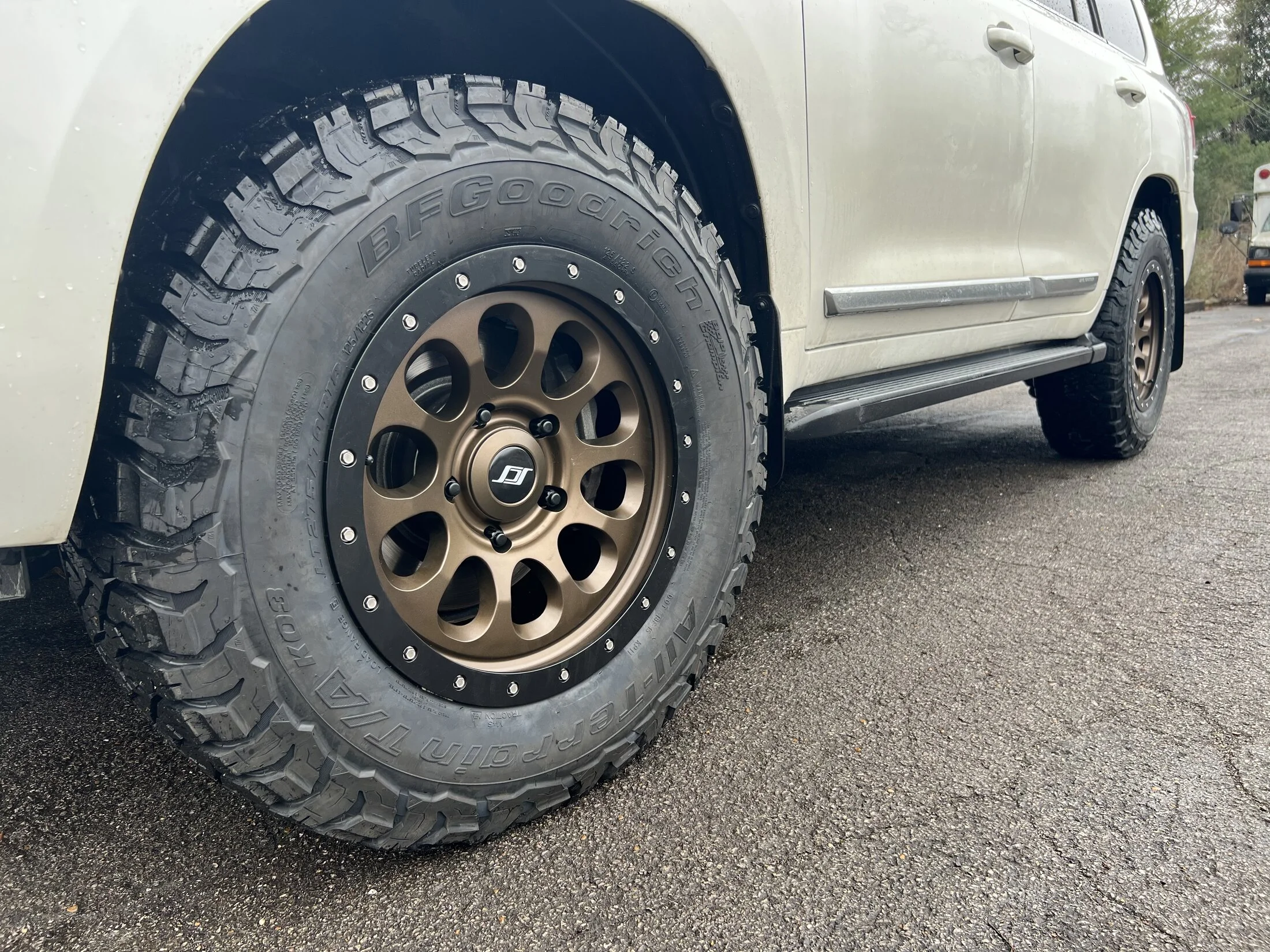

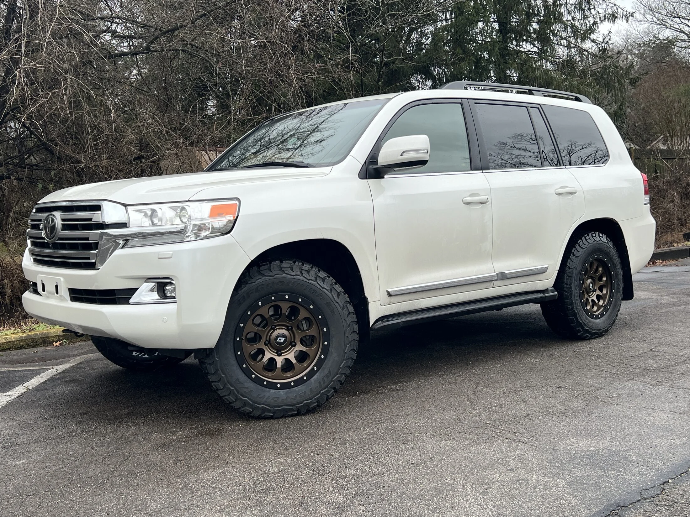

275/70/18 BFG K03s installed today
Decent amount of rubbing but hope a heat gun will fix that
How’s the acceleration? Notice any power loss or extra sway on the highway?
Have only driven home from discount tire so far… it’s noticeable that there are all terrain tires but it doesn’t bother me one bit. Will post more feedback in the next few days
