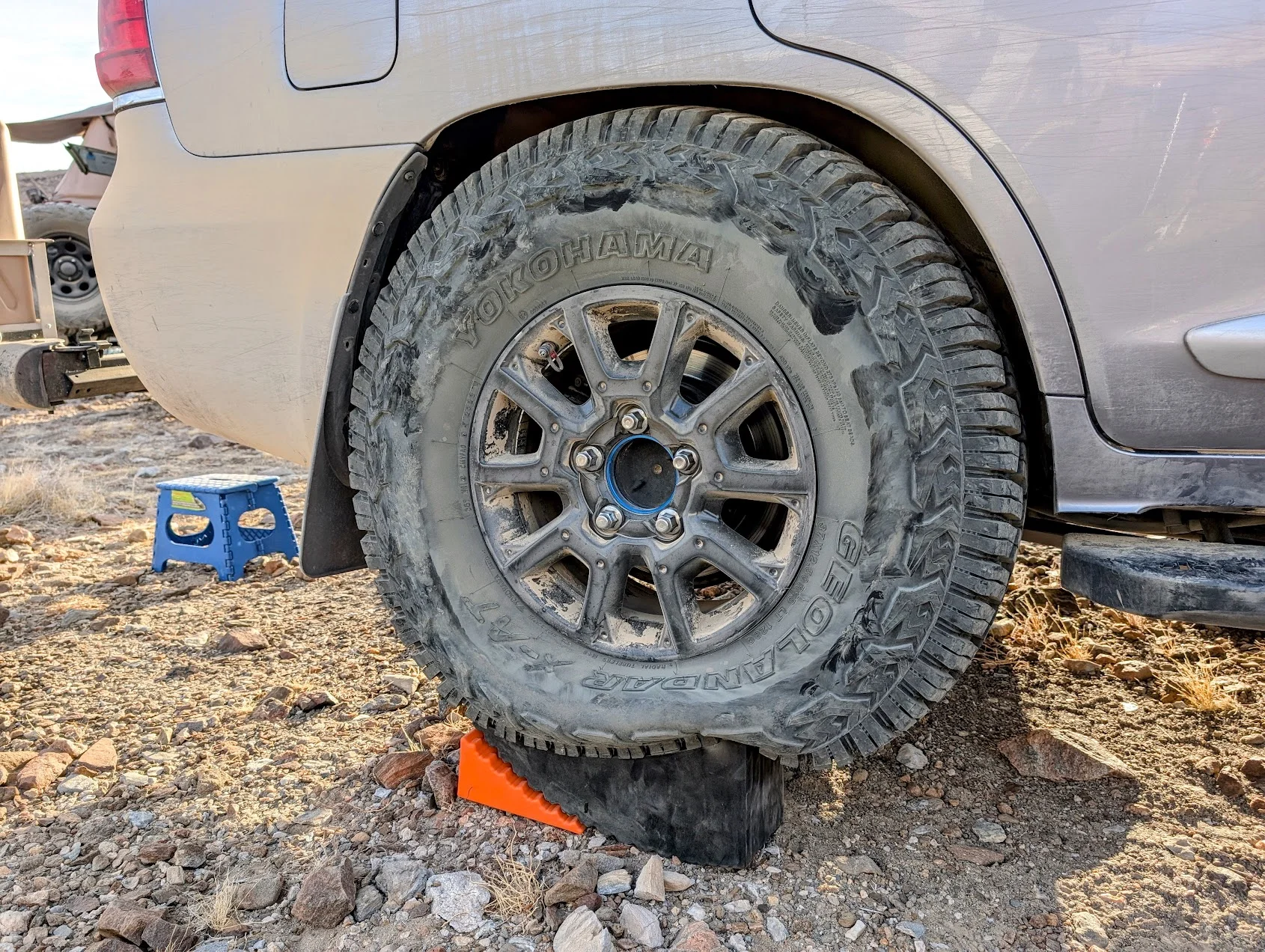

Yoko Geolandar G056

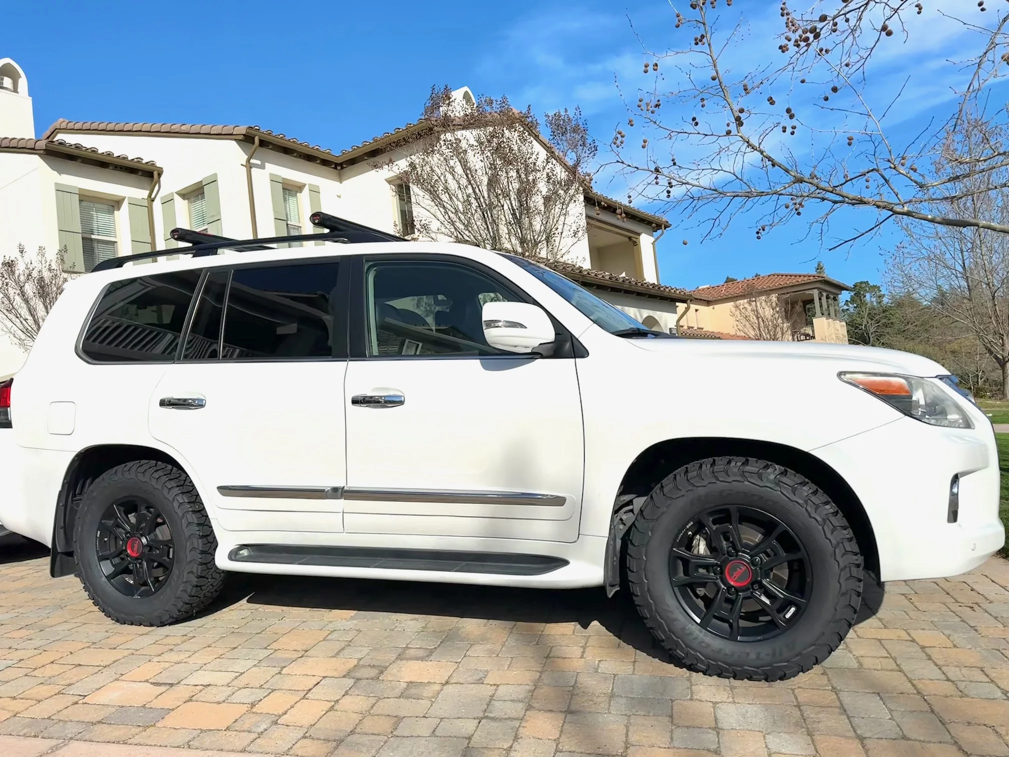

Yup. They're common second gen Tundra wheels: 5x150 lug pattern 18x8 +60, equivalent to the stock LC wheel spec. I don't much like the contrasting machined finish but I think they look great in solid colors.
I like this look. so it's the same spec as a stock 2016 Land Cruiser 18" wheel?

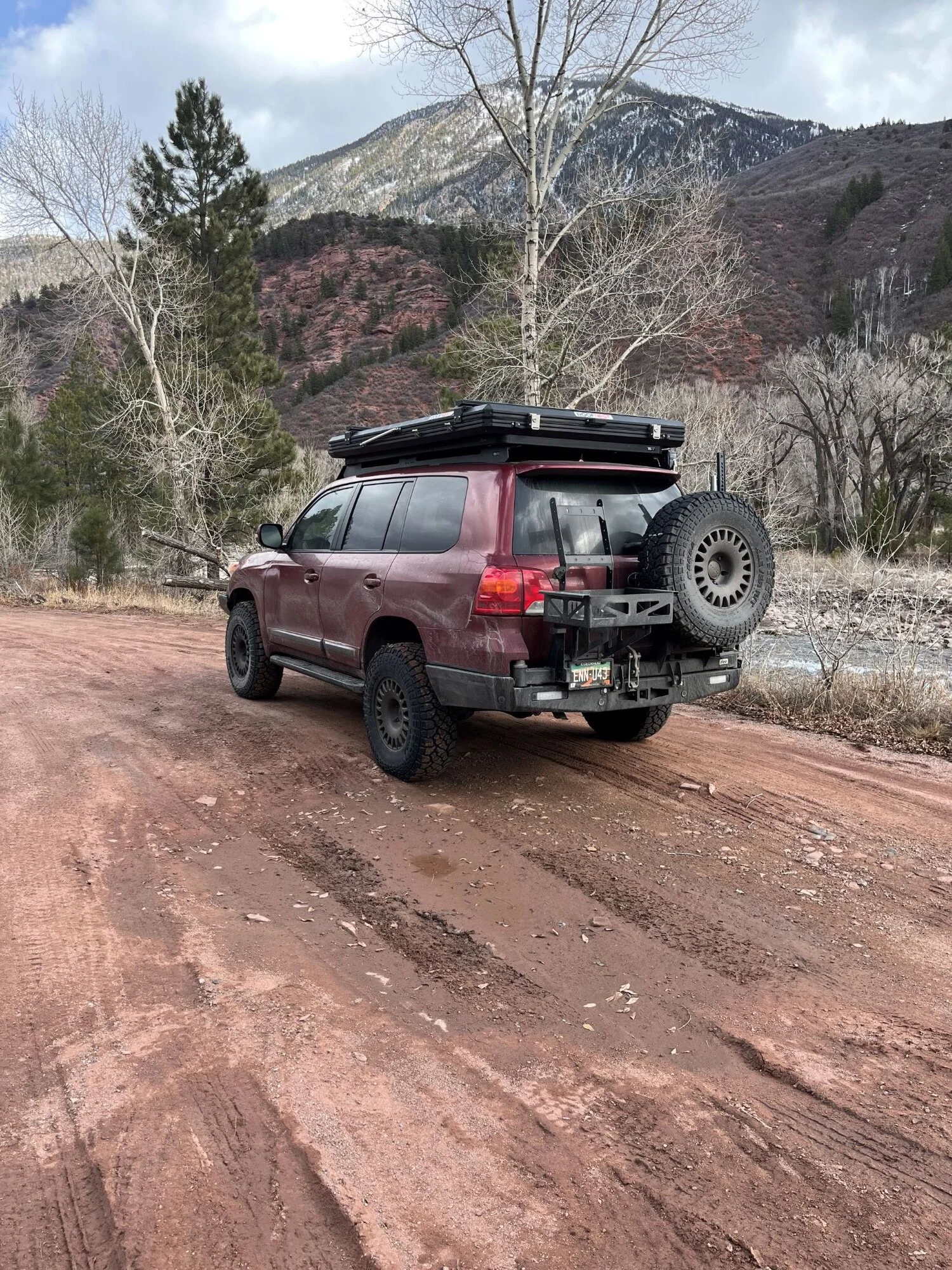

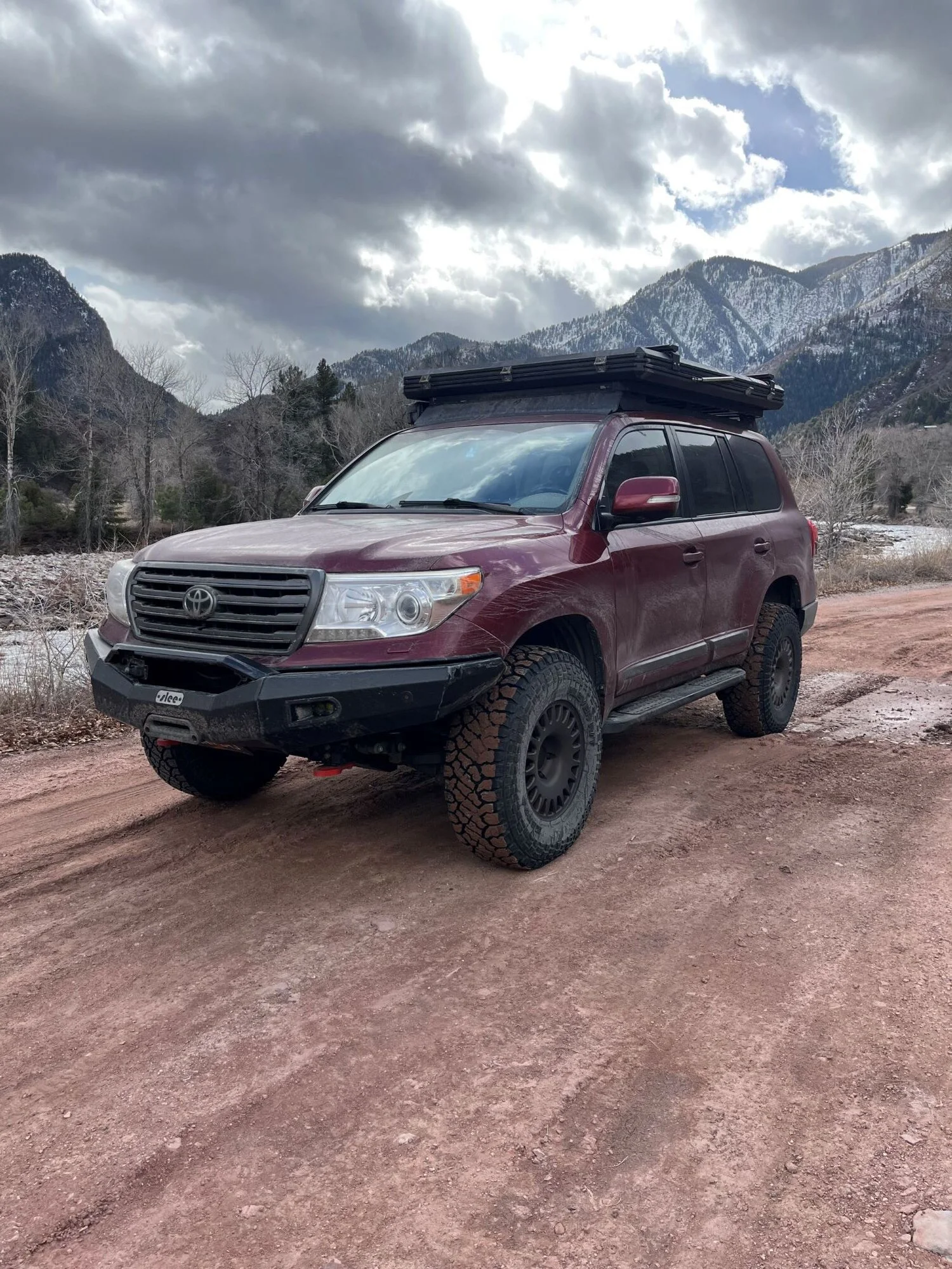

I now have them on my 2018 LC200 in a 275/80/18 and they are still great everywhere, just like I remember in the 4Runner. (They seem a little louder then in the 4Runner, but could be because the LC is quieter or because the lug spacing is a little more).
I bought my 275/70/18 Kenda Klever RT last Spring and paid $1080 for 5QTY.
*Some people who bought off my recommendation choose the AT, RT, and MT but they all say the same thing, these are lowkey better than most any other tire on the market.
