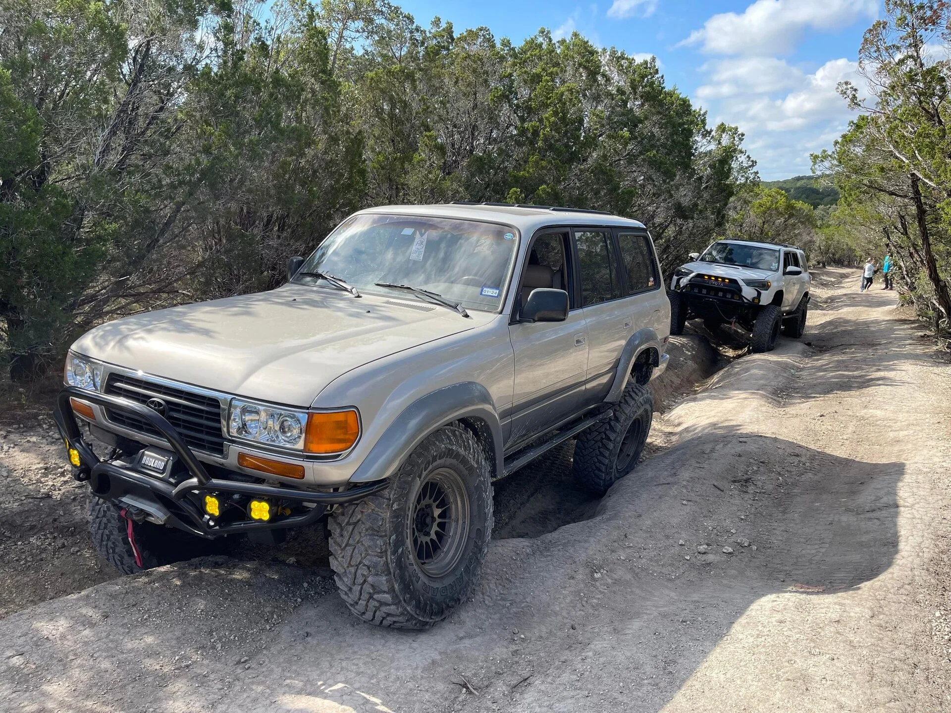

Most current pic:
Hey y'all!
Figured I'd make a post to document my progress and keep a list of baseline items I need to accomplish.

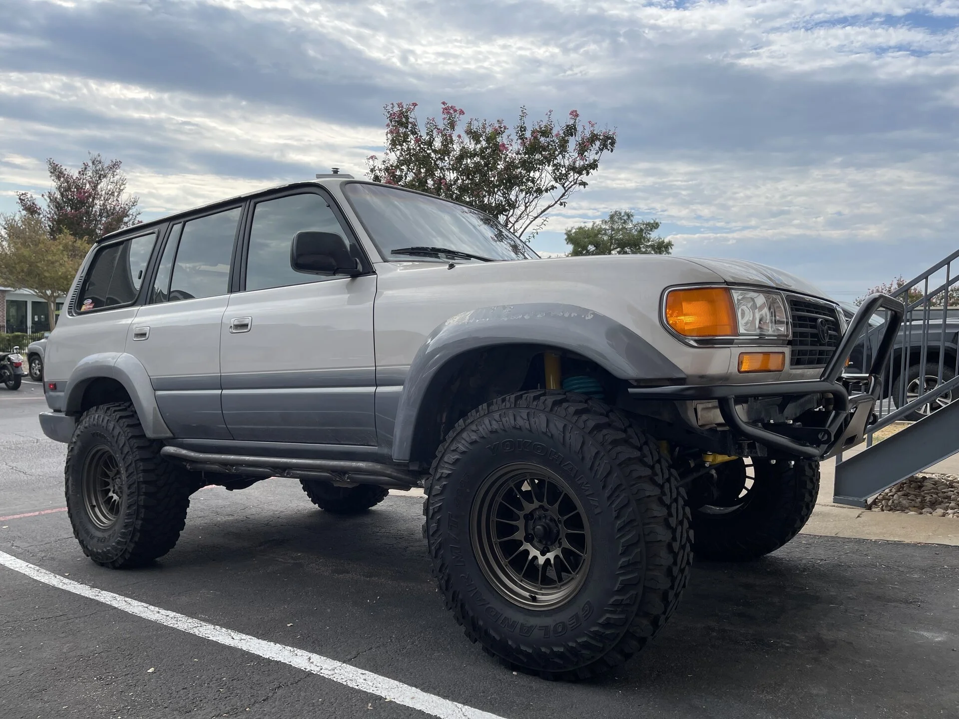

I recently "upgraded" to a '97 "40th Anniversary" tripled locked w/252k miles after I had an unfortunate mishap with my '06 4Runner Sport Edition V8 4WD (rolled). "40th Edition" in quotes because I don't think it is? Paint code doesn't seem right but it has the two-tone seats/interior and mats. 🤷‍♂️ Anyway, it seemed like a decent price considering the market/condition...and oh yeah, this is my first 80! :cool:
The 4Runner was built pretty nicely and took me to CO, UT, and AZ - I had her for 8 years. I'll miss her dearly.
Anyway, pics of how the new girl's condition and how she sits right now:
PO did some maintenance/mods. I got the receipts for rear main seal, hubs and bearings, random hoses replaced, brand new AC compressor/lines, valve cover job, and brand new OEM EGR stuff (lol). The only leak they had was a small power steering one, so I'll be investigating that. For mods, sort variant of OME lift, some sort of ARB (or ARB style) bumper that is in REAL bad shape and bent from somehow winching like an idiot, black Procomp wheels with 35s, and an ARB roof rack. The rear carpet and third row seats are gone as they were planning do a drawer build back there as well. Pretty decent shape - a dent from a boat trailer mishap that dented and smashed the rear marker light, couple dents. Frame rails have a little bit of surface rust, rear axle has some decent surface rust (I picked it up by the Texas coast).
