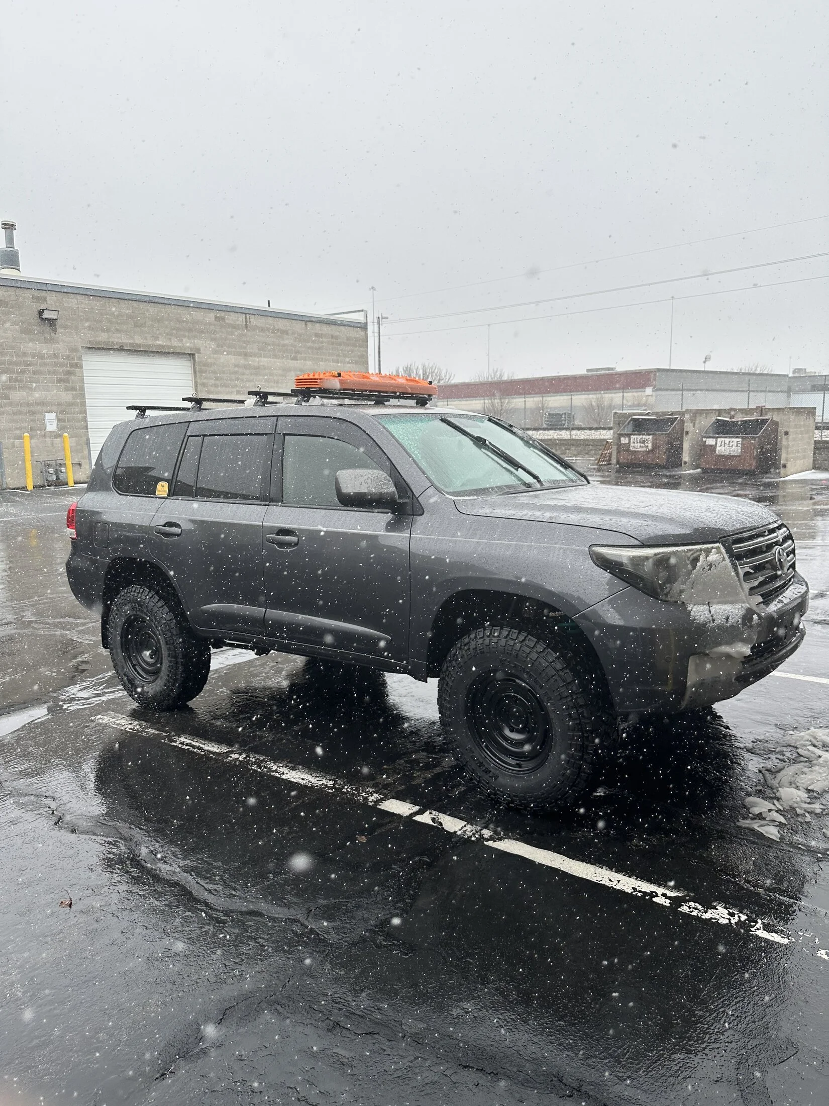

Another option for the 0 offsetters. Nomad 504. They used my ratty high mileage 200 for a photo shoot. I’m not a black wheel guy to be honest.

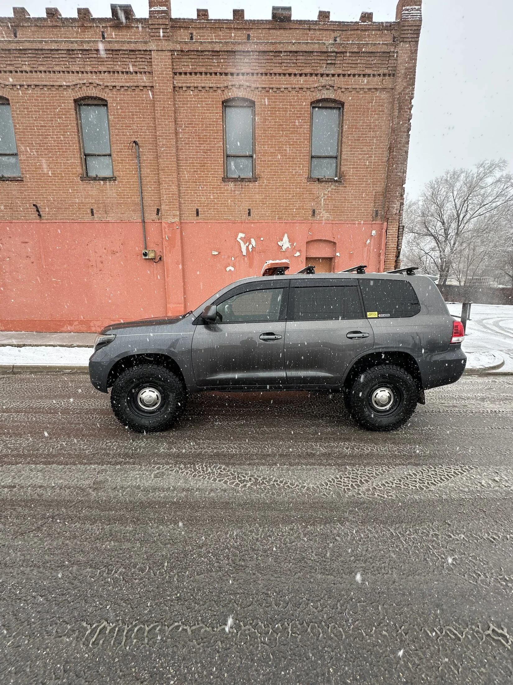

Let’s go even further. The same wheels allow and old school hub cap to be run. Honestly, it wasn’t my favorite…but it’s growing on me. Enough so that I haven’t taken them off due to being lazy in the winter. It gives a flex dream vibe. Or a kzj95 vibe. Idk. Again 0 offset, tires kenda 35x10.5r17
Do you have a side profile shot to show the poke with 35x10.50 on either of those 0 offset setups?
I don't but they do not exceed the fender.

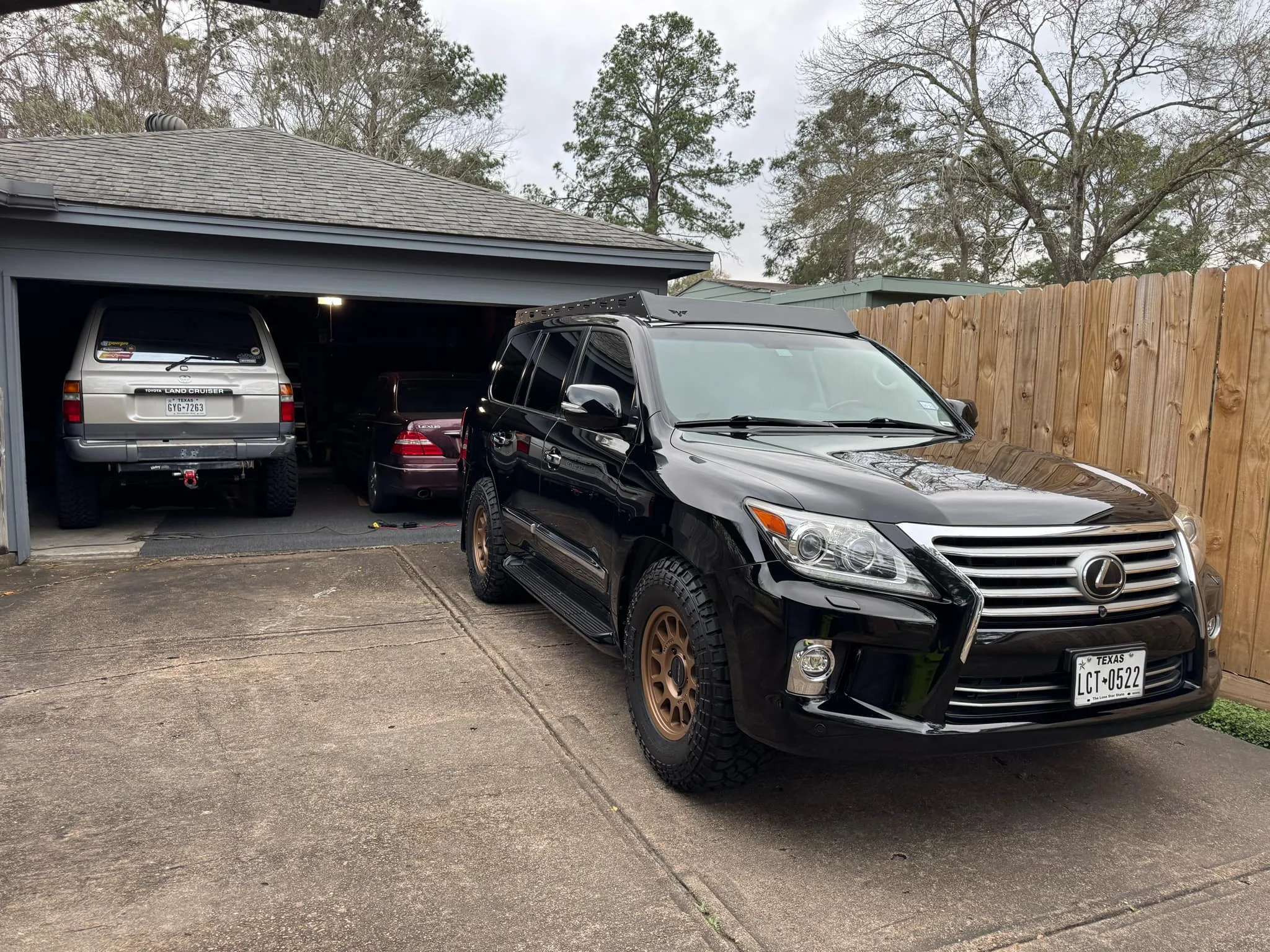

Another combo to add: Evo Corse 18” et45 with 275/65 R18 Falken AT4W’s SL. I wanted a softer and more rugged looking setup than the stock 21’s. Also needed better snow traction for commuting. No rubbing or need for plastic adjustments. The rake looks a bit aggressive but she’s parked on a bit of a downhill angle.
These would probably look good in white or silver if someone was going for the base model look
