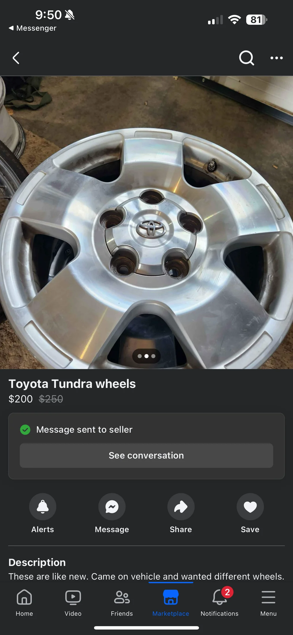

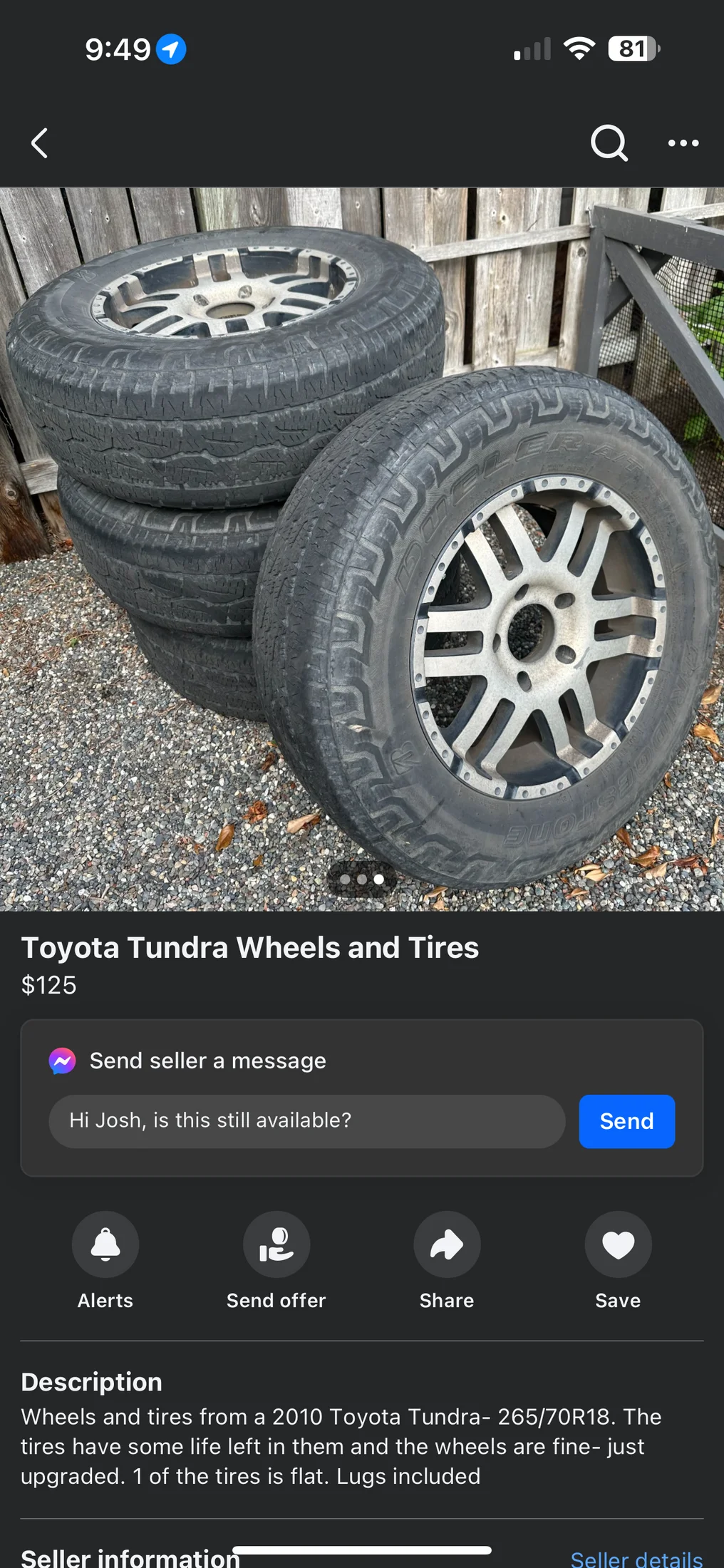

Looking at going to 18s on my 13 LX. Eyeing FB for tundra takeoffs and came across a couple that don’t seem to be the more common styles. I assume these would work fine? Any major differences between the two, both aluminum?
the second ones are aftermarket, off brand as far as I can tell. The first ones are OEM Tundra wheels, probably better quality.
Thanks, I figured that was the case regarding the second one after I couldn’t find it anywhere online.

The first ones that are off early TRD off road tundras are very heavy (like 10 lbs / wheel heavier than other OEM tundra option) even though they are aluminum. Might not matter, but just something to think about.

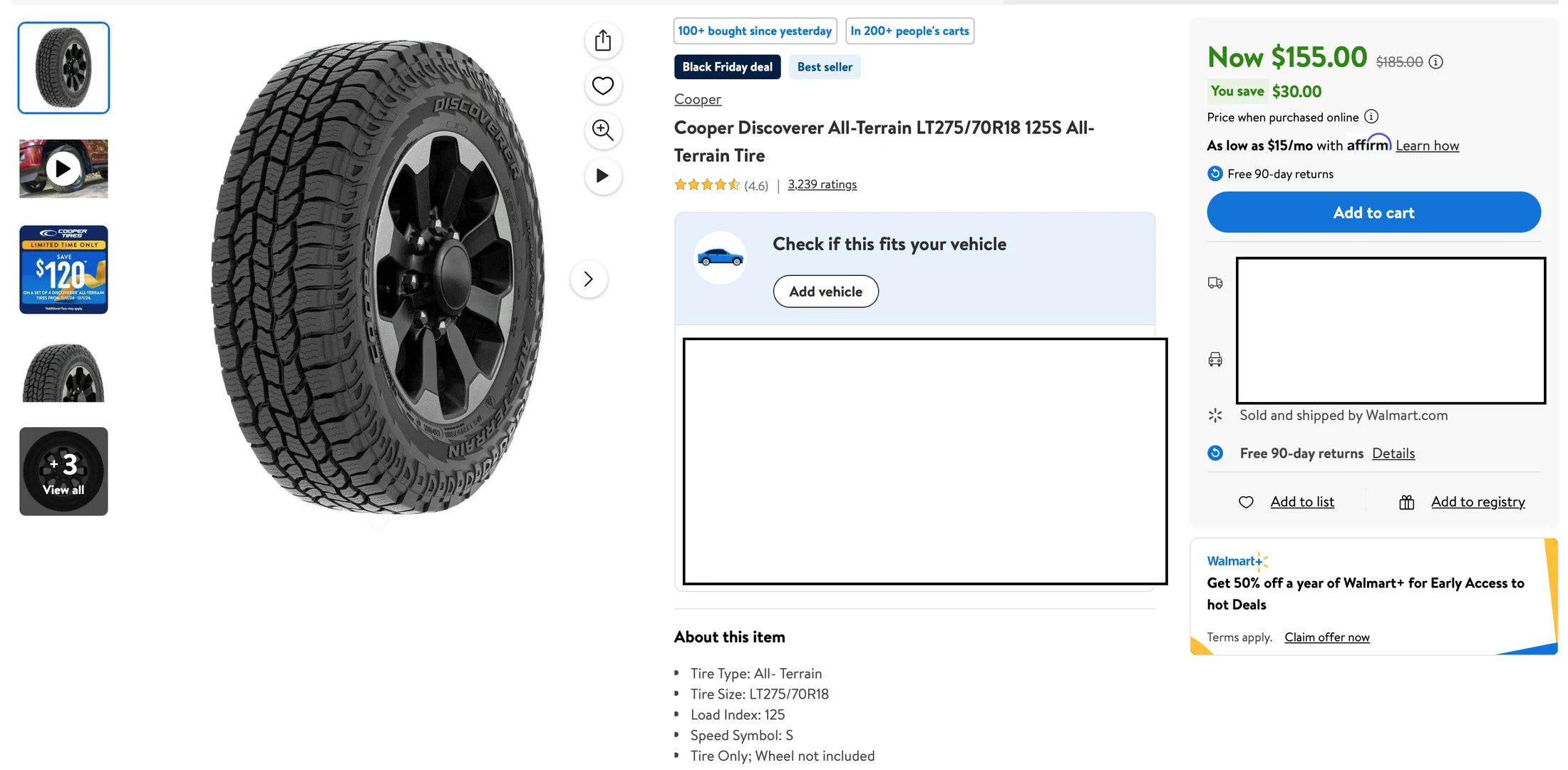

if anyone is looking for a deal, these just popped up on my slickdeals feed. i couldn't find much info on them given cooper has like eleventy billion permutations of the discoverer line. however they are LT and appear to be three peak rated.

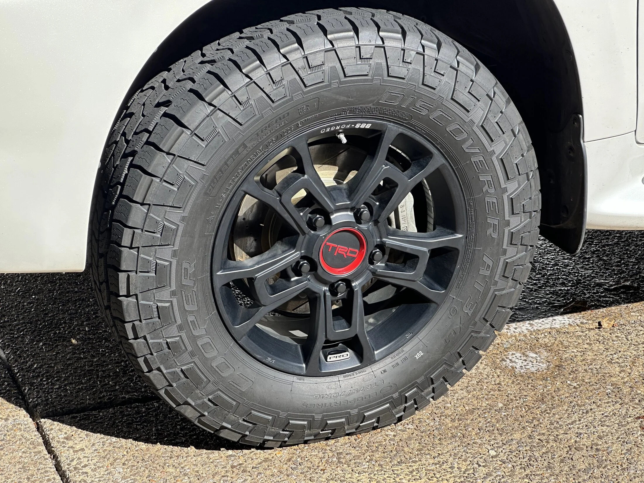

Thanks for everyone’s feedback on tires. I switched from LT275/70/18 KO2 after I saw just how bad they were in wet conditions. (Hurricane Helene)
Switched to LT275/70/18 Cooper AT3 XLT. Much quieter on the road and has actual rain channels in the tire tread. Also saves 4lbs per corner in rotating mass.
There also seems to be some confusion if the Cooper AT3 XLT is 3-peak rated or not. Widths 275 and smaller are 3-peak rated with the stamp on the sidewall.

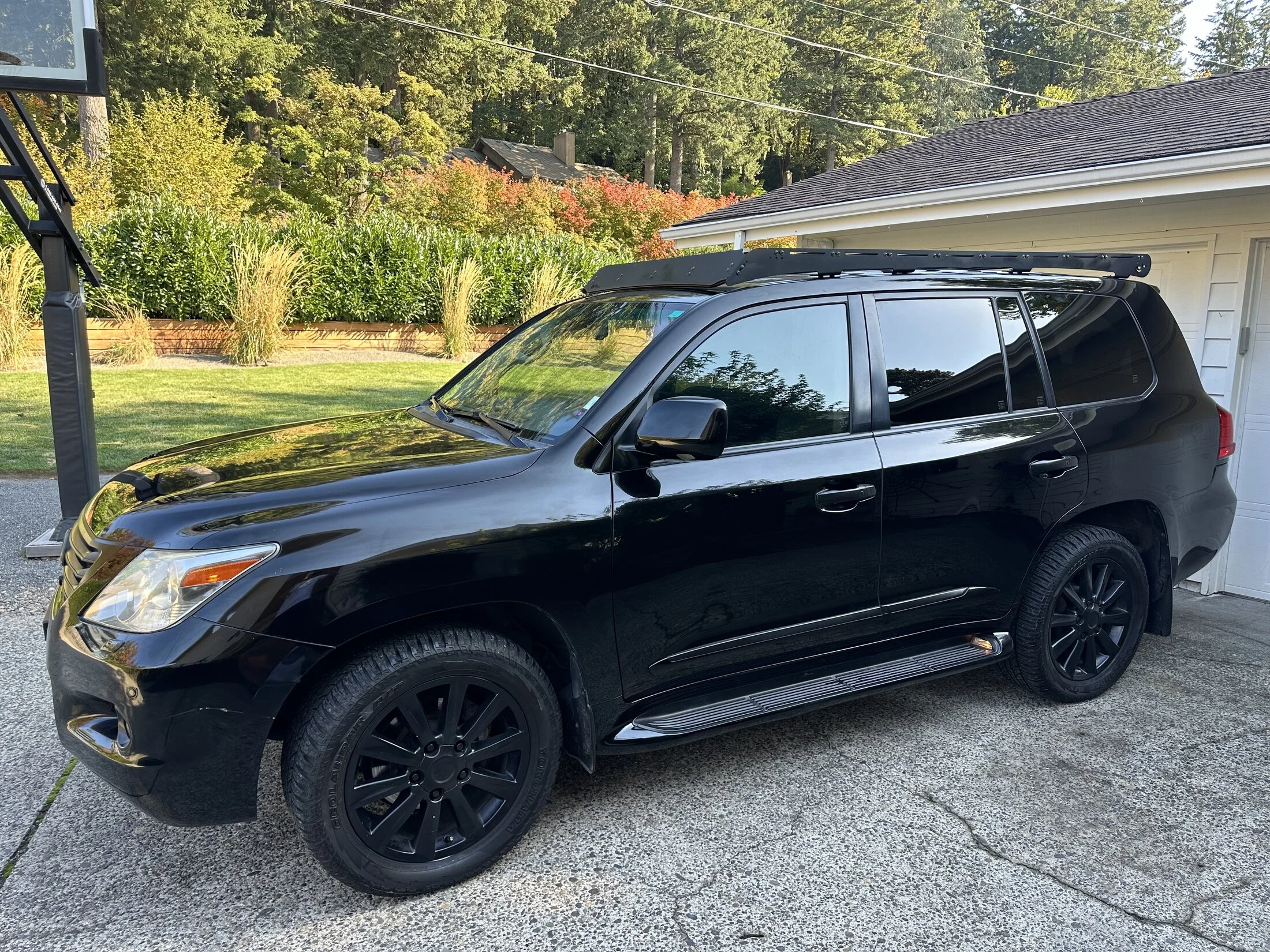

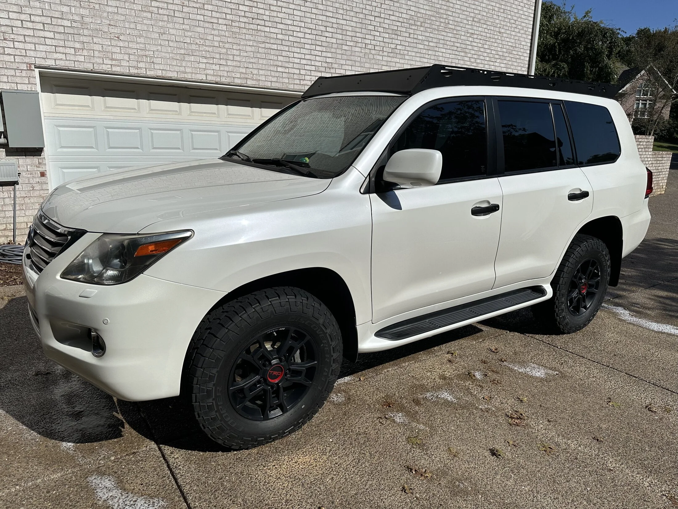

No rubbing on 2008 LX570. 33.2” tire
These look great. I just put the same tires on method 318’s. Are you not rubbing on mud flaps at full lock (I’m +40 offset). Also, did you get psi rec yet?

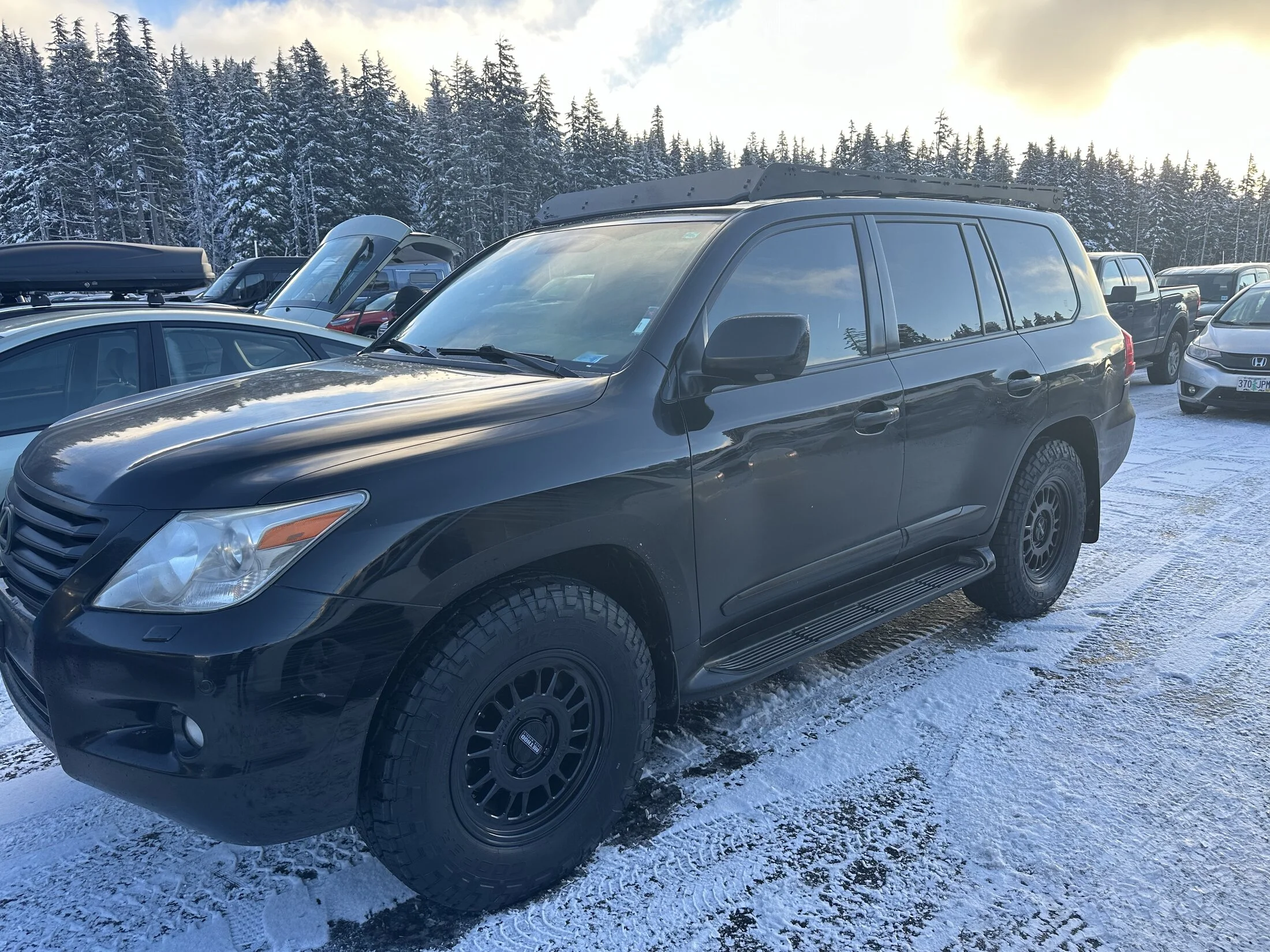

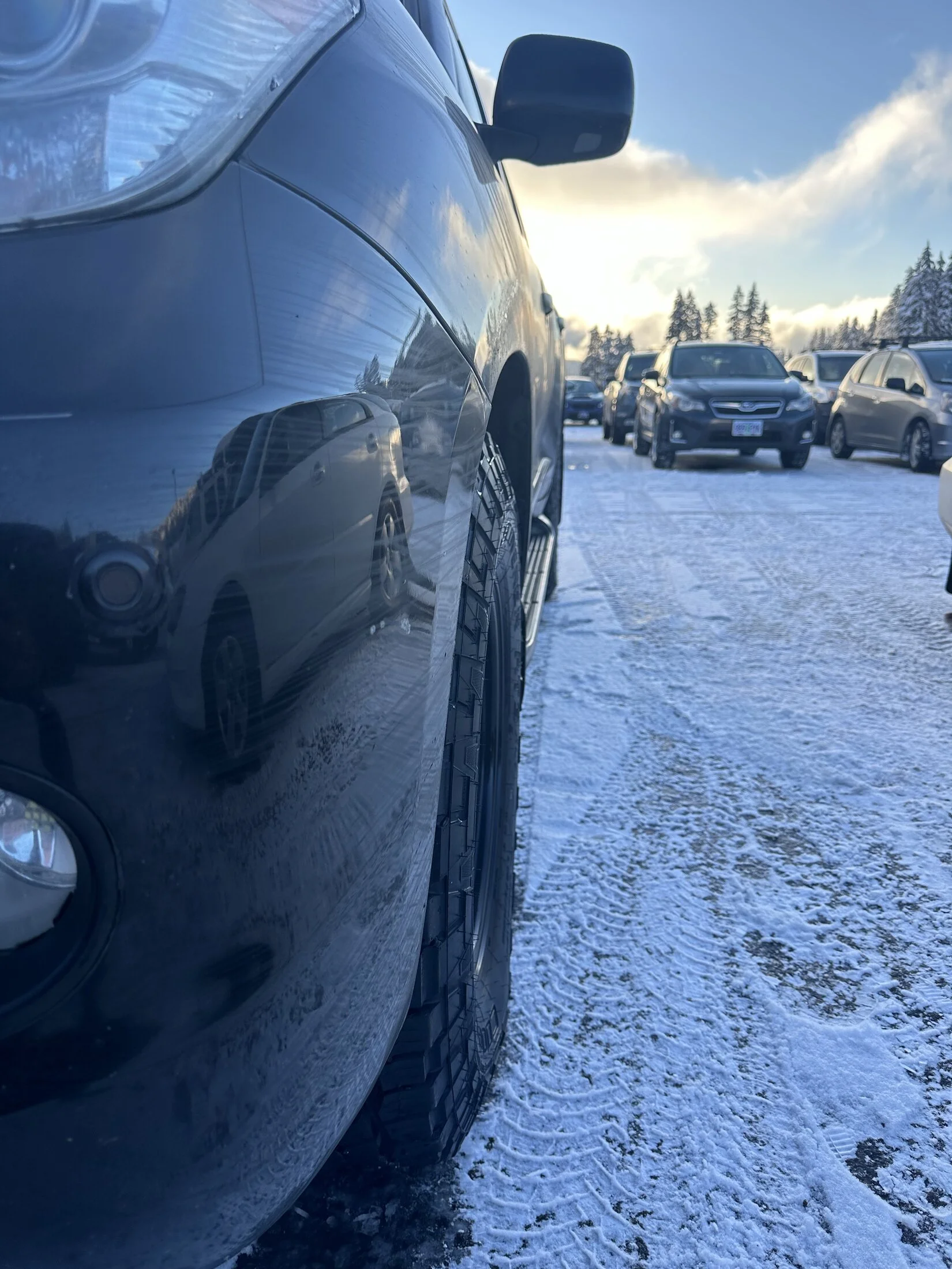

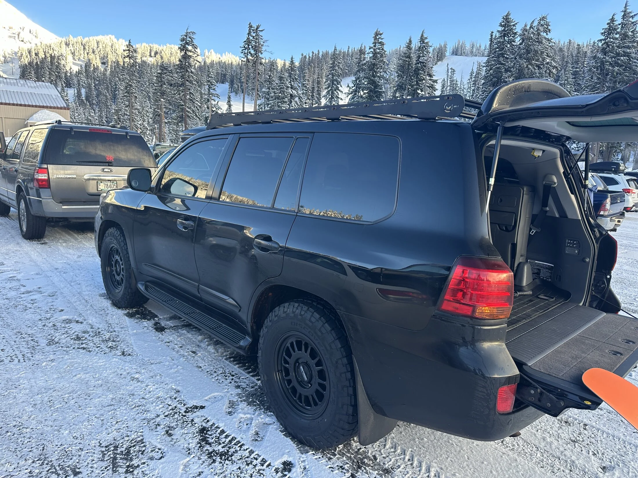

275/70/18 Cooper at3 XLT on Method 318 - ‘09 LX. Slightest rubbing on mudflap in reverse full lock. Expected rougher ride on E load but actually better and sportier than geolanders on stock 20’s. Before / after.
I am running the TRD Pro wheels, which have a different offset. No rubbing at full lock.
I did not get a PSI recommendation, but I'm running 40 or 41 psi. Works great!
