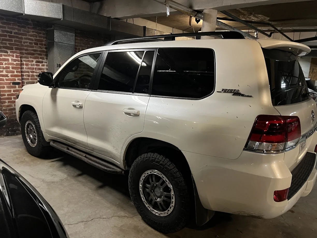

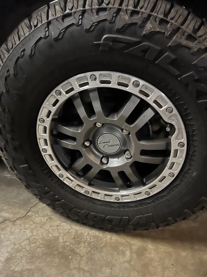

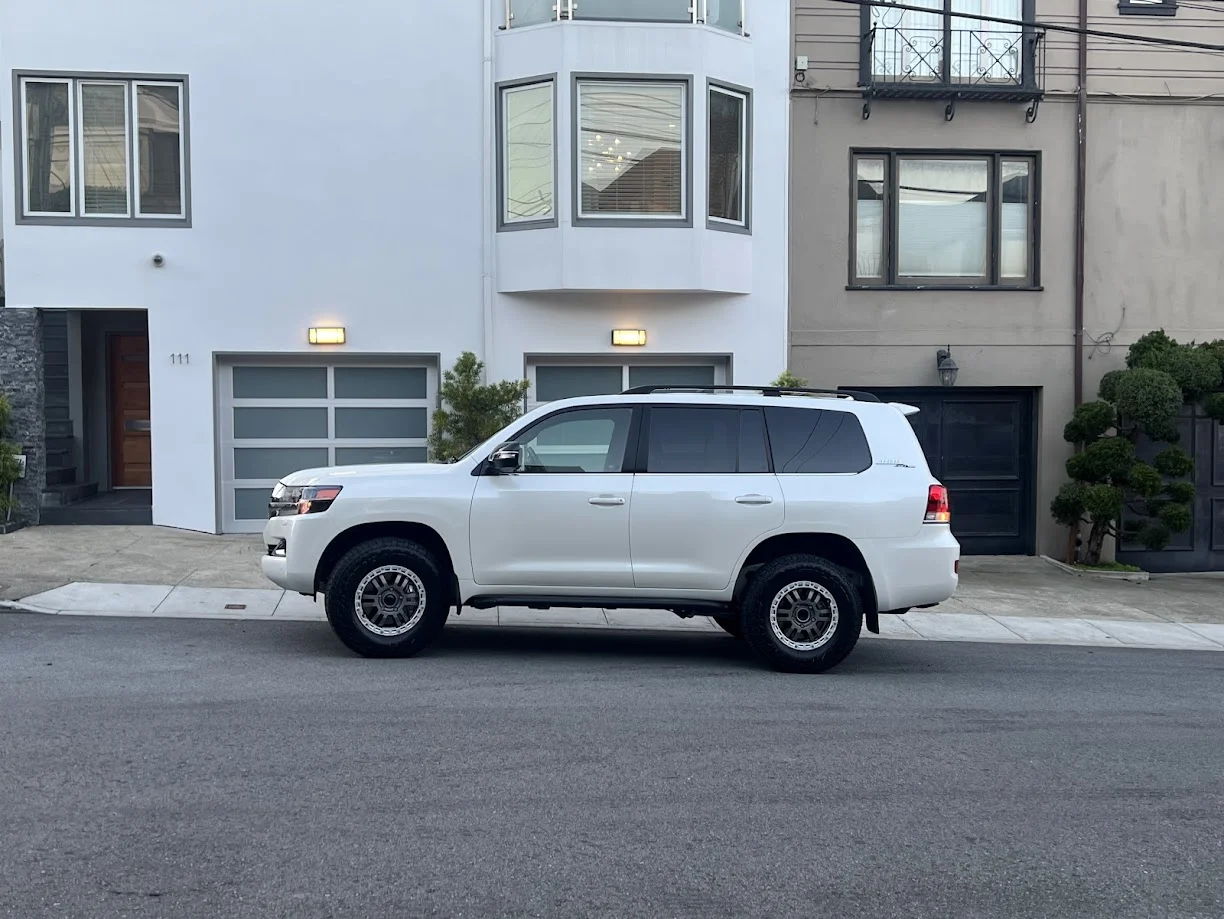

I ended up finding a set of rock warriors that I'm gonna for offroading and then put defenders on the BBS for highway/everyday
Cool. You doing 285/65R18 defenders?
I found some 17" Rock Warrior wheels and plan on putting Wildpeak At4w 285/70R17 tires on them. I have a 2017 LX that is otherwise stock (not the LC in my profile pic) and pretty much going to stay that way, at least for now, maybe adding Slee sliders in the future. They come in C1, E1 or SL load ratings. Any reason for me to get a higher than standard load rating and @gaijin could you let me know the RCTIP, please?

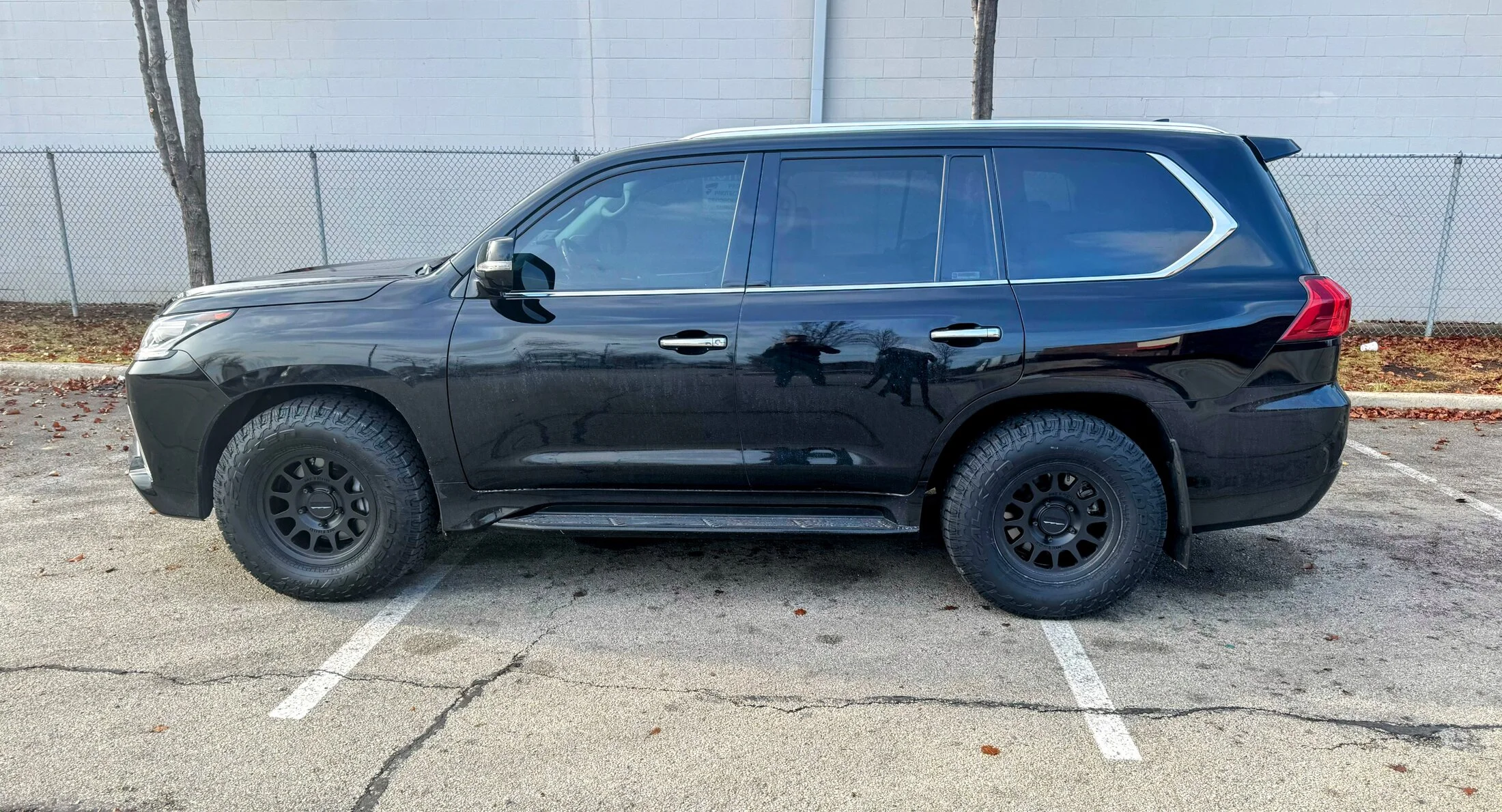

I just put these exact tires on my wife's 2017 LX570. I have them mounted on Method MR703 wheels. I went with the SL tires.
Any photos by chance?
I'm not who you asked but these are RWs with at4ws in 285/70 (edit: realized you were asking to see the methods. It's late and I'm more of an idiot than normal)

Thanks for that. Below I charted the pertinent points on the chart of Falken AT4W 285/70R17, other data points be essentially similar. The C rated LT tires have 1/8" more tread depth but the SL have a slightly longer tread rating at 65,000 vs 60,000 (negligible, really). When I (over)built my LC, I used the AT3W E rated tires for the extra load and sidewall protection. For my LX, I'm leaning toward the SL as this one is built more for on road and snow travel.
