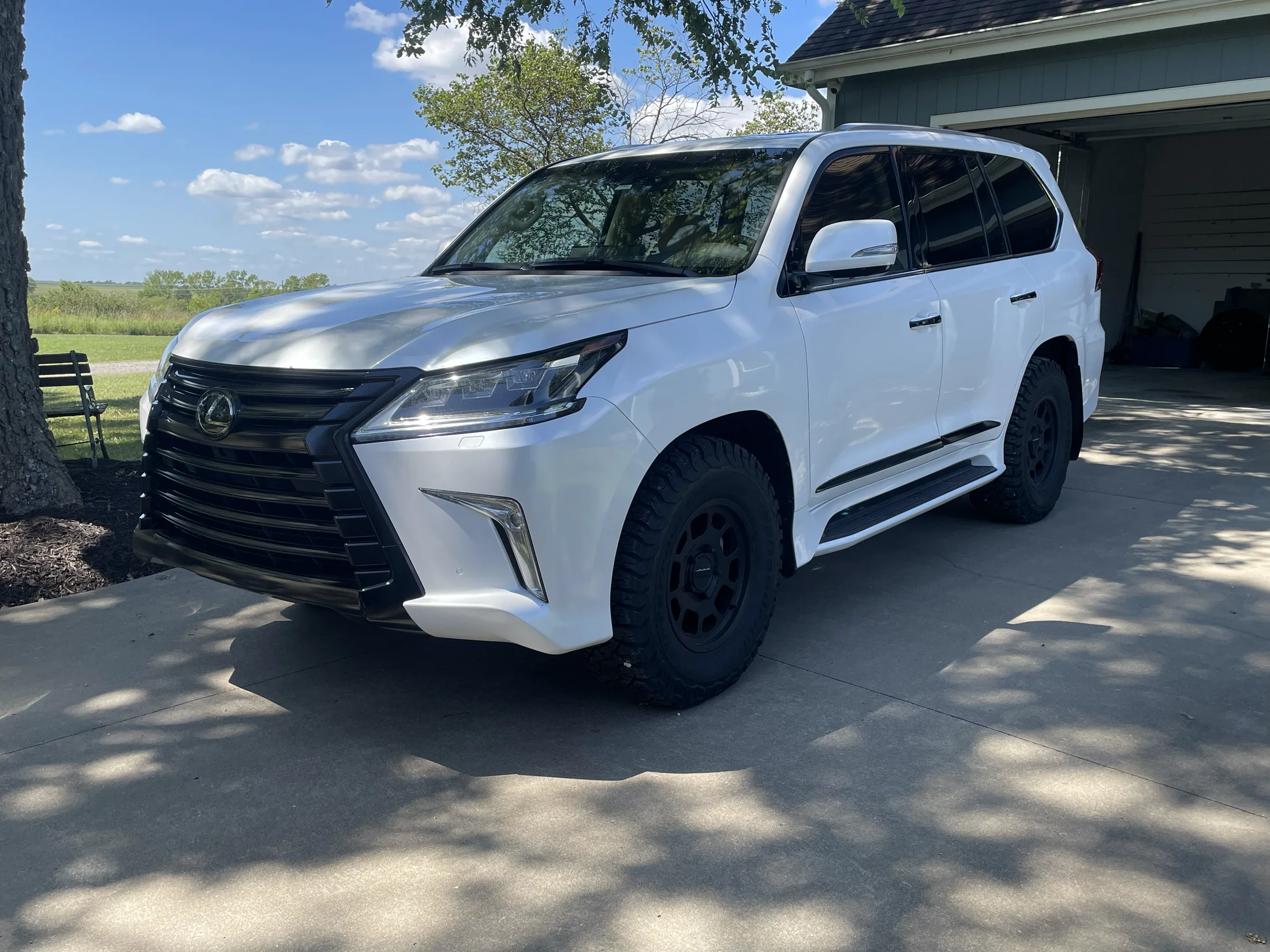

I just put on Method 705 17x8.5 35 offset with BFG KO3s in 285/70/17. No trimming yet. Going to massage some plastic at some point and took off the little flaps. Fits great Bruiser. I might do a sensor lift, but I am leaning towards leaving it as a stock wagon. (For once in my life...)
KShorthairs, that looks slick. Is any trimming/ massaging required to prevent rubbing, or are you planning to do that for another reason?
Thanks Heckraiser for the feedback.
Considering these are two of the most highly rated and recommended Toyota/ Lexus overland shops in Atlanta, I expected tire fitment knowledge to be table stakes. Of course, they could also expect their customers to at least be able to pick out compatible tire sizes while they focus on the more complex upgrades. Either way, good opportunity for me to learn more.
To add to @Heckraiser points. The 17” TRD Forged wheel (aka Rock Warrior) is a ET50 wheel and comes stock with a 285/70R17. So Toyota bolted that on to LCs as a factory option on no lift. Anything that fits an LC generally fits an LX better.
  • Like
Reactions: D19
I did have to take off the little flaps that are held on by 2 10s. Other than that, full lock has some minor rub. I am just going to do the usual heat gun massage to fix that and be done.

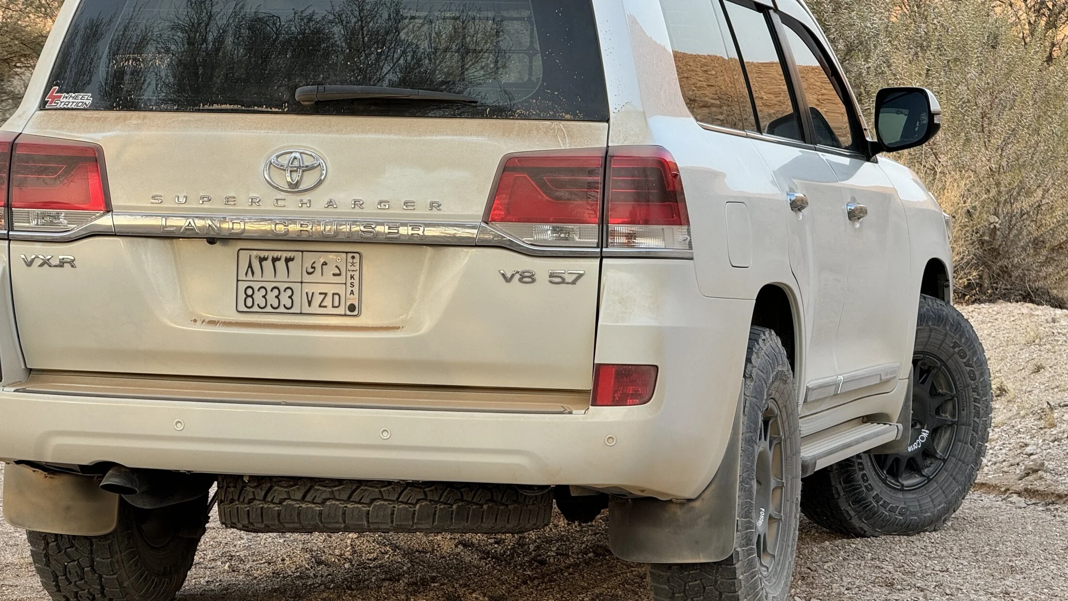

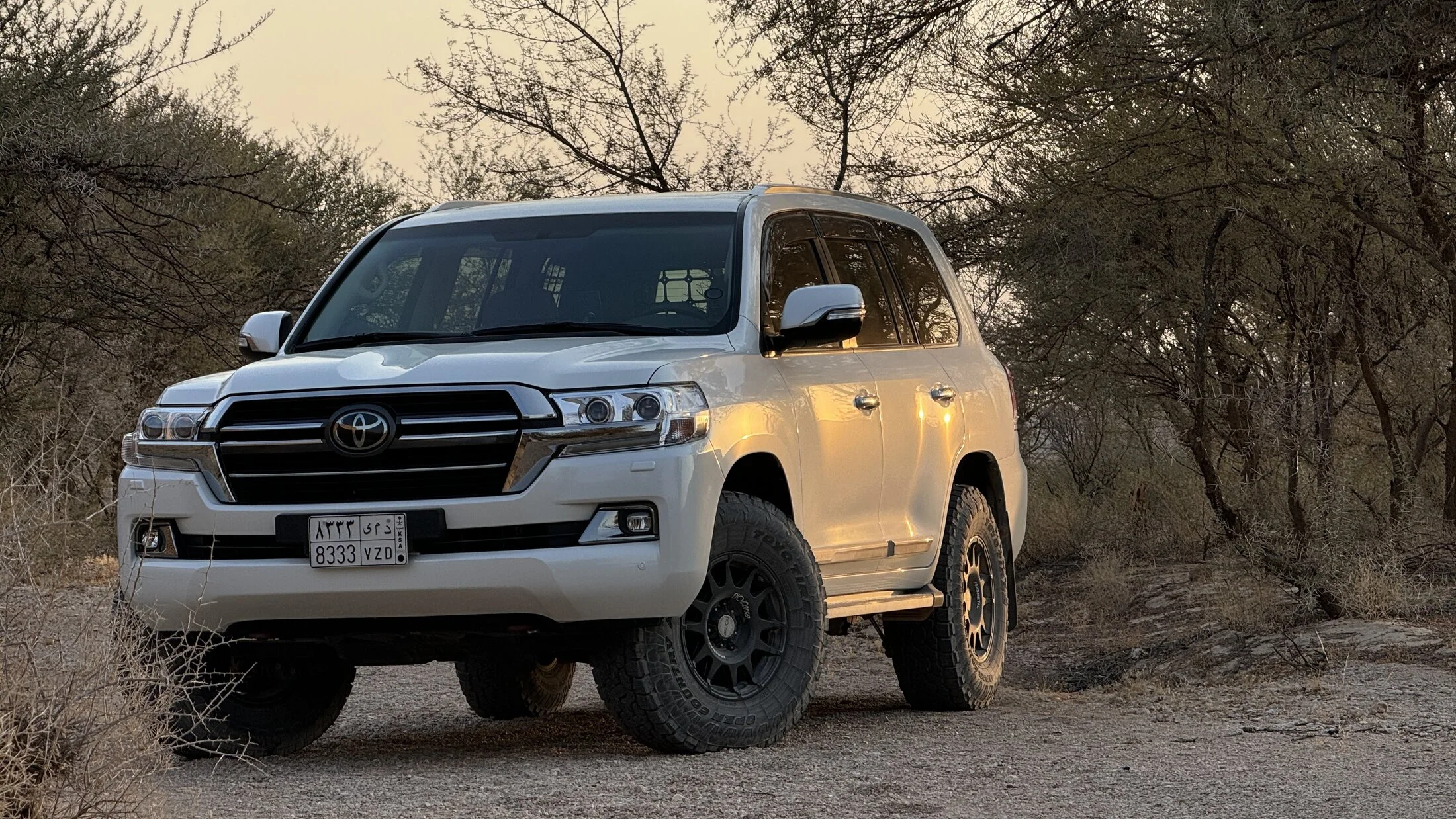

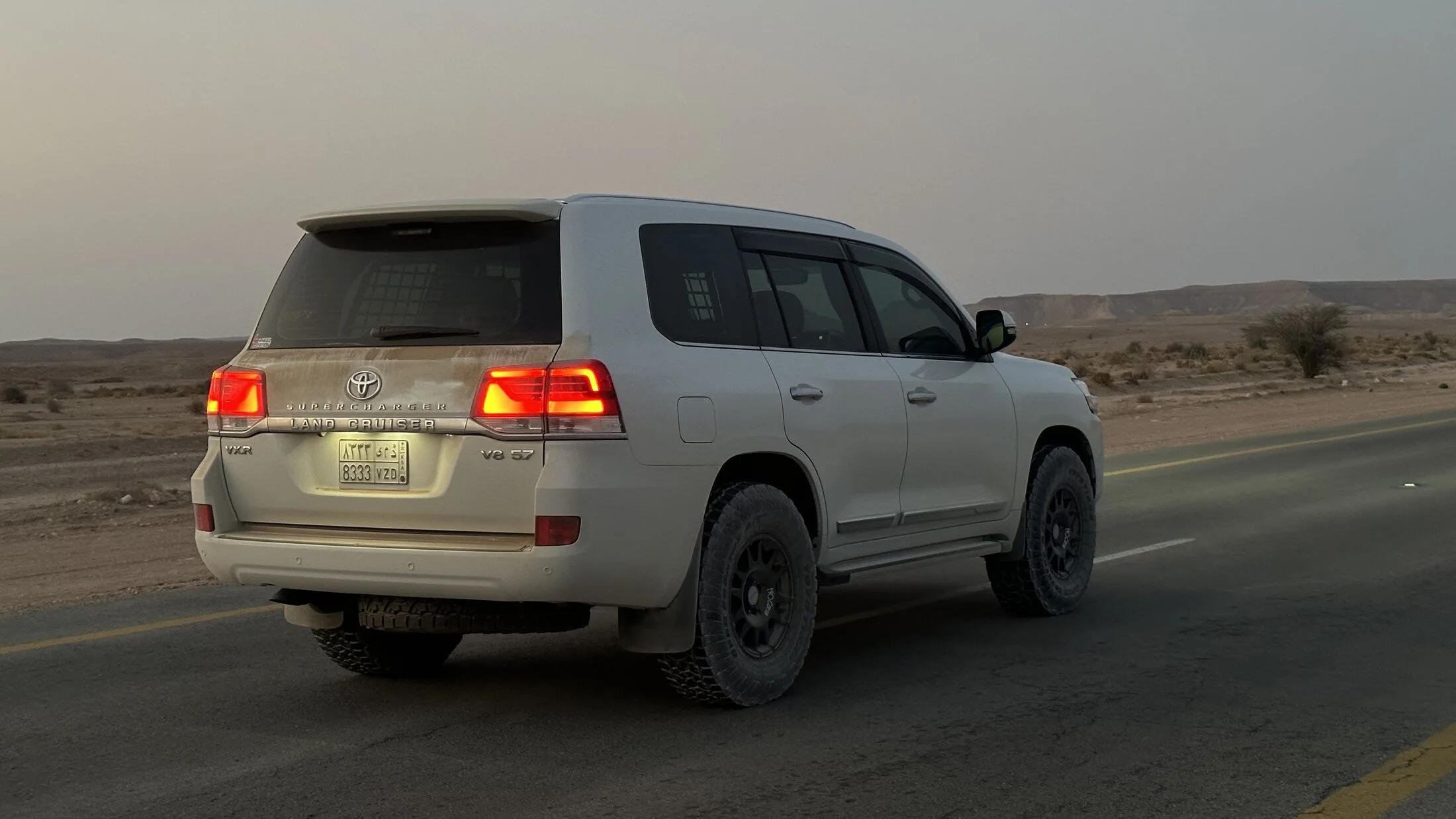

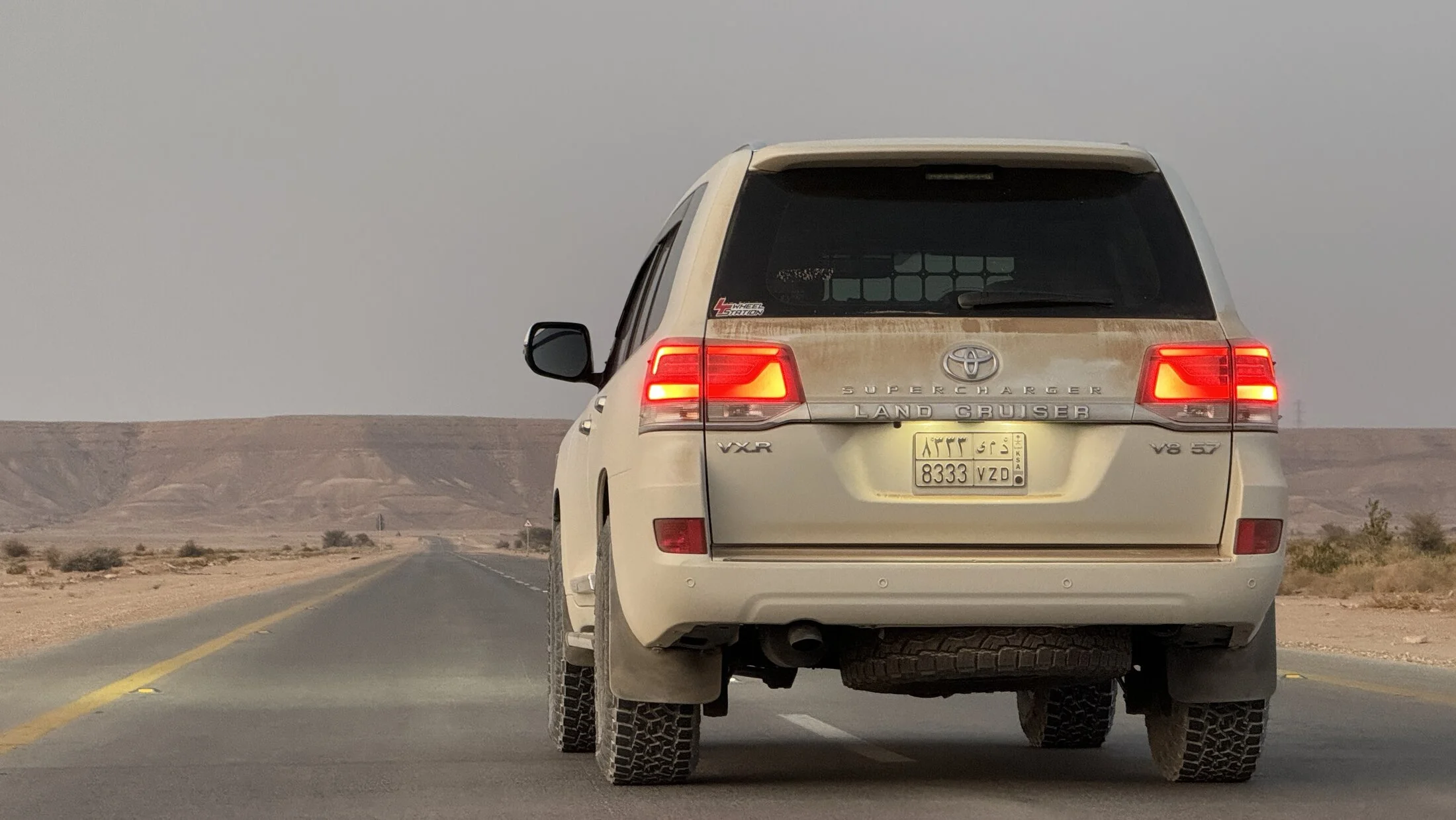

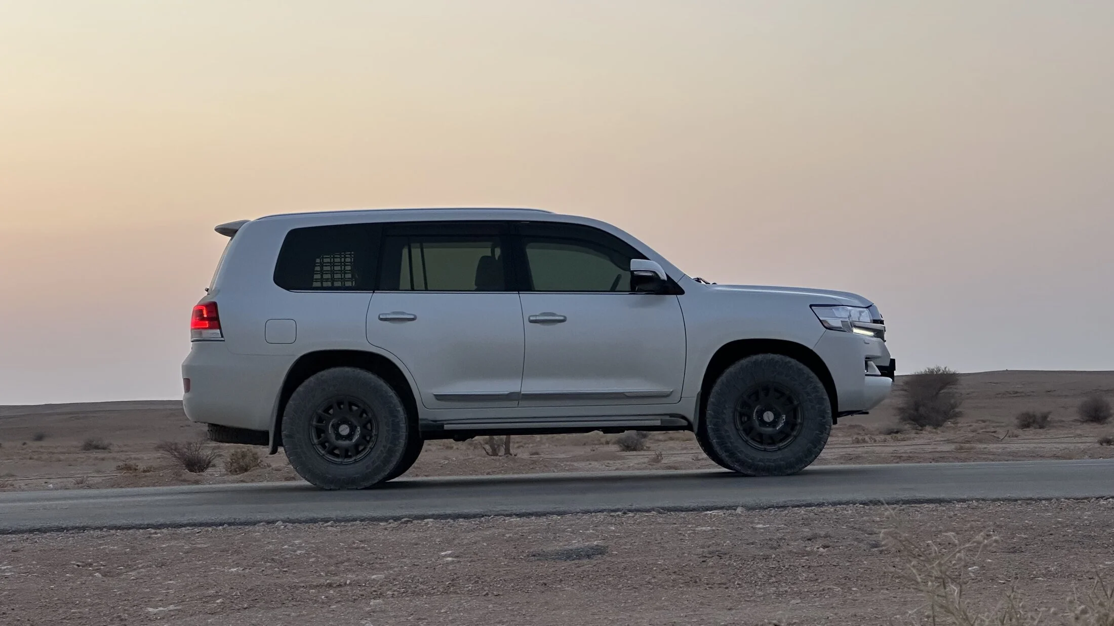

I just installed a new set of the K03 285/70 r18 without spacers and they fit with no rubbing. tight but no rubbing, even the KDSS. Have a small 1.5 lift.
Do you have pictures? Driving impressions? no rubbing on full lock? I'm currently running 295/65R18 Duratracs, and after 30K miles the noise is getting to be too much.. I have a 2" BP-51 lift with OME UCAs and 1" Bora spacers. I think the KO3 285/70R18s which spec in at 33.7" should fit fine as my Duratracs were 33.3" and had no rubbing. Would appreciate any additional details/observations you have running this size of the KO3.. Thanks.
I will try to get some pics this weekend with full lock. I am not running any spacers. No KDSS kissing or rubbing on full lock that i have noticed. Slight rubbing on the passenger mud flap. Previously running Michelin 275/70r18 AT-2s . Driving impression is pretty good on the BFGs, but no where close to as good as the AT2s. Honestly, if Michelin offered that tire in either a 285 or 295 / 70 variant, would buy over the BFGs for my purposes.
Thanks for the response @SCoutdoors. Appreciate if you could take a snap shot of the KO3s. Regarding the Michelin AT2s, they are great. I have them in my ‘03 tundra and I love them.
