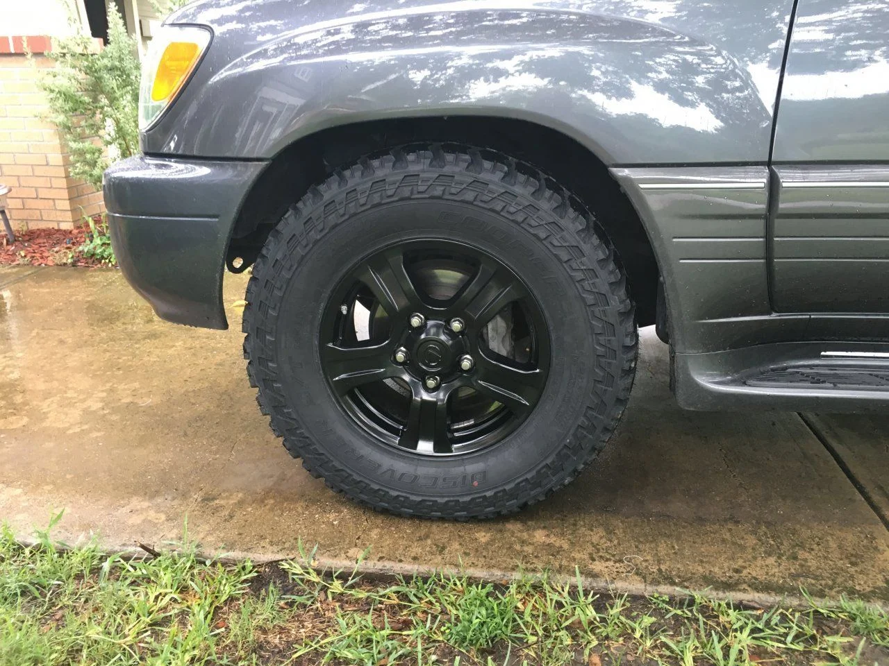

Rears fit without spacers but fronts do not. The bore of the wheel tappers slightly smaller so the last few mm wouldn't go over the hub. To be able to use the TRD flat center cap at least a 1" spacer is necessary. A 10mm slip on works but alternate cap is needed or roll with none.
Checked..
With caliper at hand I took one of my front wheels (Even if the gap was visible by eye, I just want to make sure) and I have 2.7mm diameter diferencial..
Hub cover will not fit is the only problem.
My Tundra BBS would not clear the front hub without spacers.

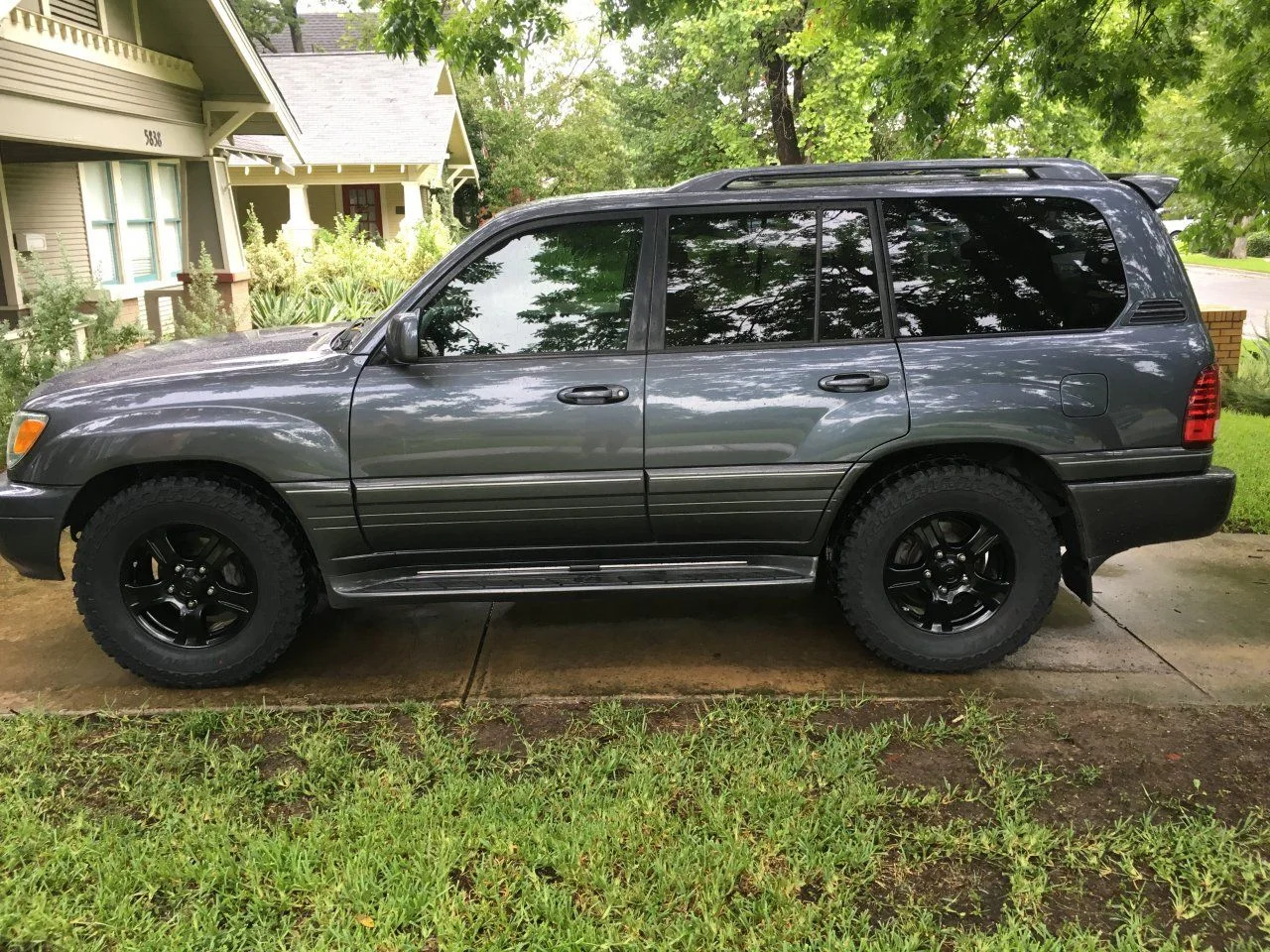

As the photos show, the standard 18" Tundra aluminum wheels fit and seat with no spacer, without the center caps.

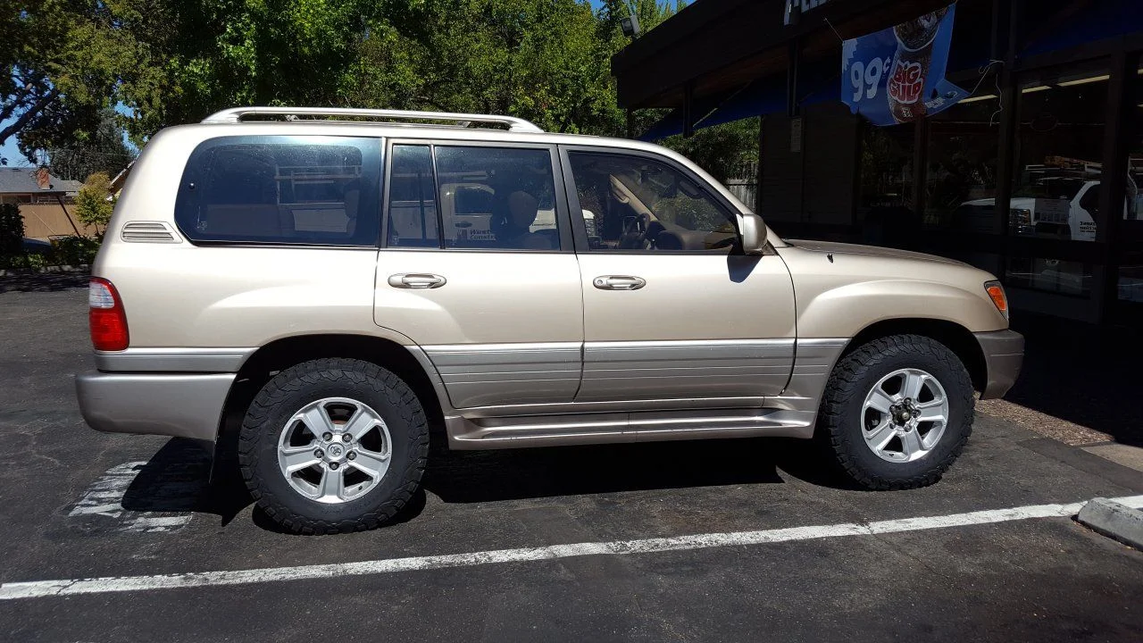

Here are the 18" Tundra wheels I settled on. I like these best of all but still need to do something about the front center caps. First is with the stock Tundra 275/65/18s and then my new 275/70/18 BFG KO2s. Both pictures are in N mode for the AHC. The LX470 isn't lifted... yet. I think I'd like to do a 1-1.5" lift.
