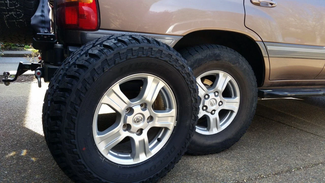

For anyone that's been following this thread my 10mm spacers came in last week from Motorsport Tech. I had a few minutes of free time over the weekend to put them on with the Rock Warriors.
As expected the flat TRD caps don't work with these in the front so I will need to go to the cone style caps posted by another member a few pages back.
Tires are 315/70r17 BFG KO2

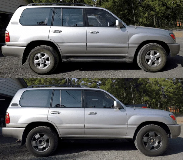

For my 98 LC (Champagne pearl) I bought 2007 Tundra 18s with Wild Country XTX tires (265/70/18s - 32.5") for $250 locally (very good deal IMHO), plasti-dipped them 4 coats, finishing with anthracite grey - stock suspension, cranked in front to level out - love it;)
