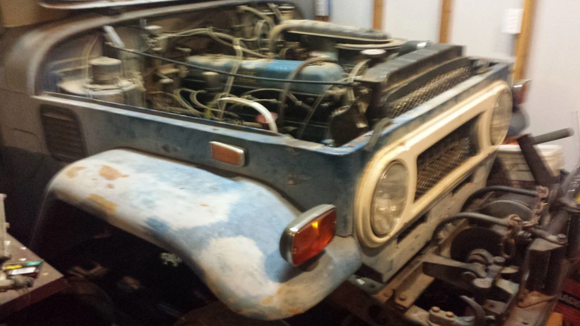

Drivers mirror is aftermarket... Mirror arm is original
Mirror on pass side is Toyota
Valve cover somebody removed and painted blue... And painted red oil filler cap
Po installed a header
Radiator cap is aftermarket ... Oem works better IMO

Johnny C, how can tell the valve cover was painted?

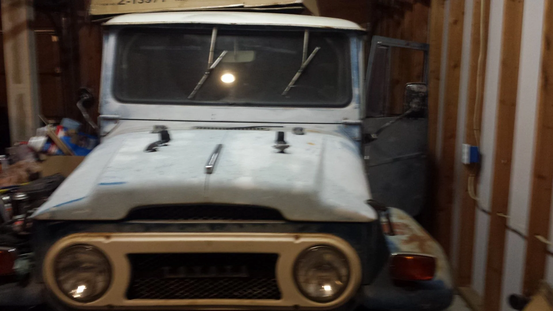

missing lug nut :doh:
windshield supports on the hood don't quite look right for the year, either
