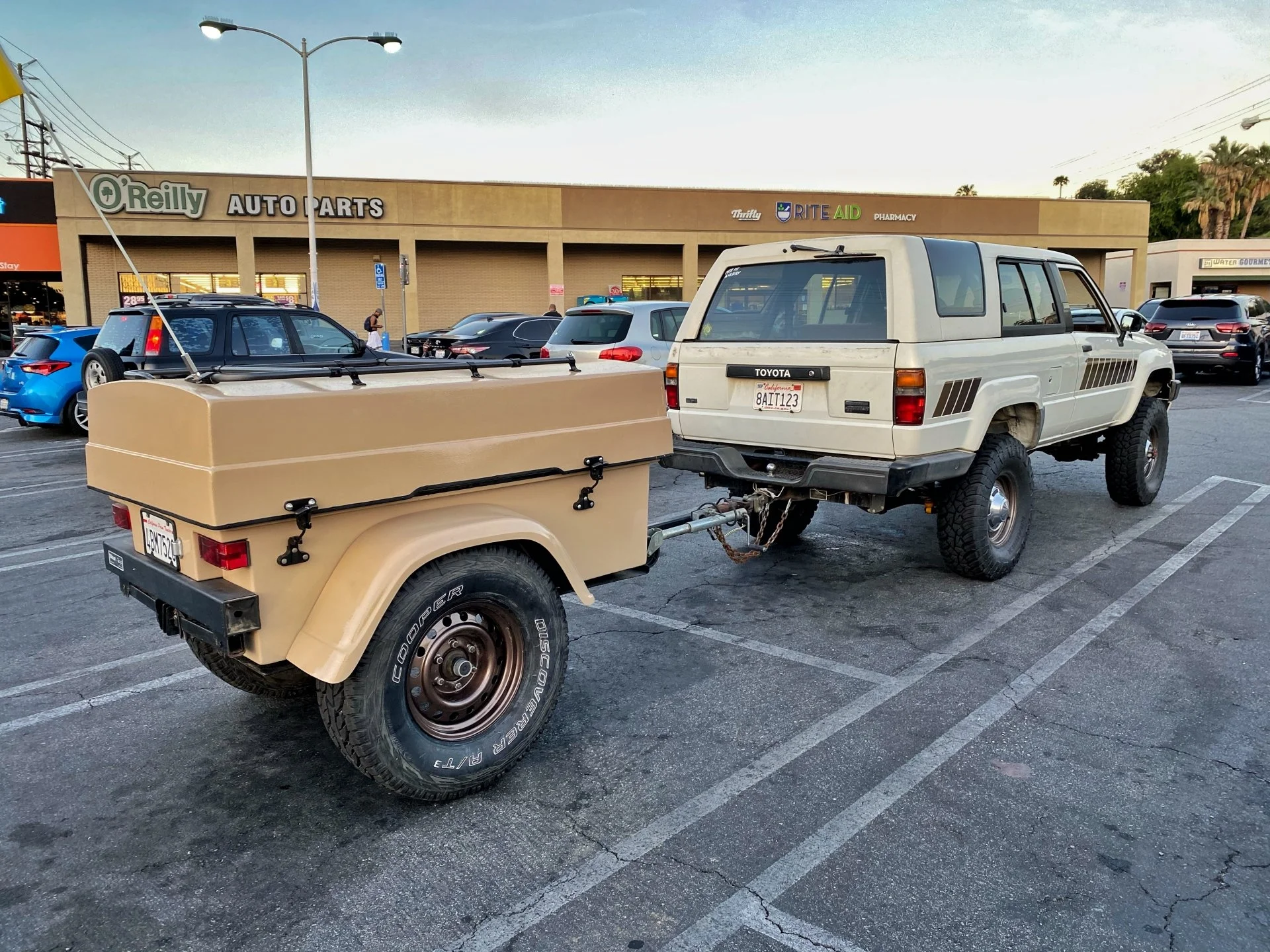

My 1st gen 4runner came with a flat four plug for towing but the brake lights on my trailer dont light up when depressed.
Thought maybe it was the trailer because I recently refurbished it, but thats not the case. Checked out fine with our 4th gen.
I'd like to clean up the PO's wiring. Anyone have a recommendation on a plug and play harness?
