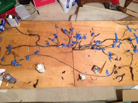

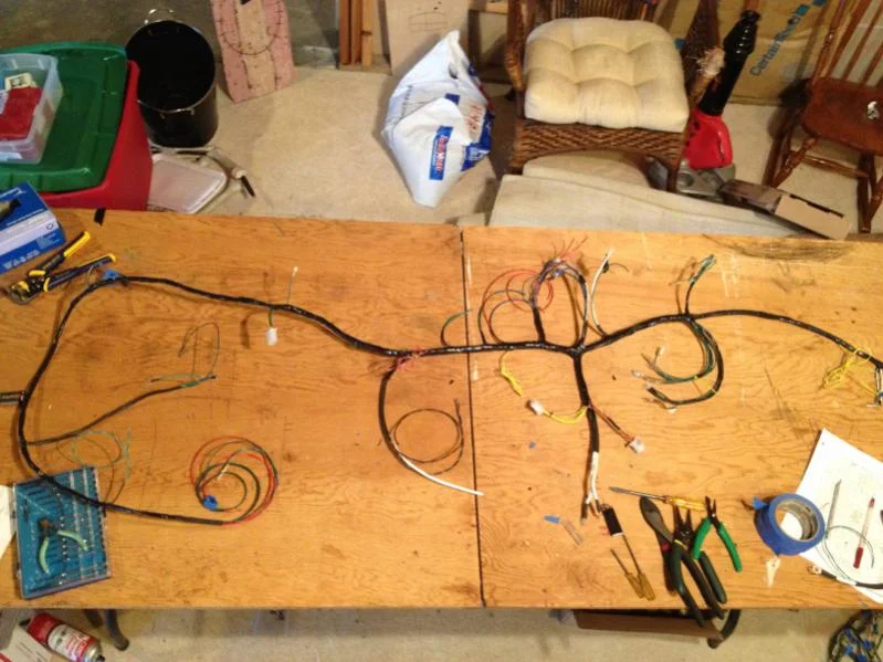

Here's the main harness laid out and labelled. It's not that difficult to do, just takes a little patience and perseverance.

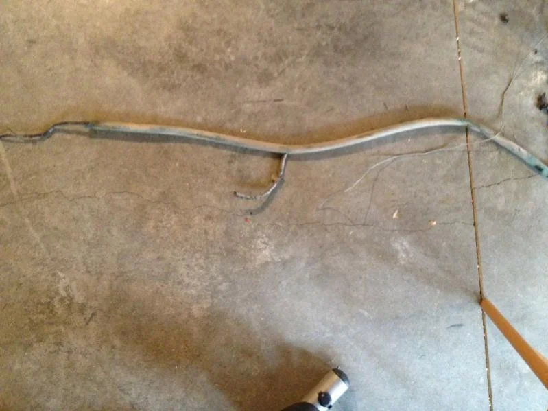

Looking at the chassis (rear) harness, the last section runs through a green tube that I thought had been added by a PO. I spied a similar looking thing in Destin's 64 FJ build thread. Is this thing original?
Lots of progress this weekend! Got the main harness made with wire, supplies and advice from Coolerman. I'm leaving some of the terminals off until I get it installed.
Also made the little bib harness today. I'm leaving the headlight wires long so I can wire in some relays.
Tomorrow I'll build the rear harness and hopefully get everything installed in a couple days! Really looking forward to seeing the lights and signals working.

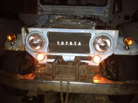

I spent all day installing the new cowl and bib harnesses today, complete with relays for the headlights. Also installed new OEM turn signals and parking lights. Put in a new battery tray, hold-down kit and positive terminal. Upgraded the ammeter lead with a fusible link from Coolerman.

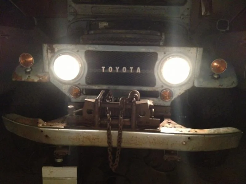

Victory! I decided I must have screwed up the headlight relay connections so I took them out of the circuit. Now my parking lights, and high/low beams all work right.

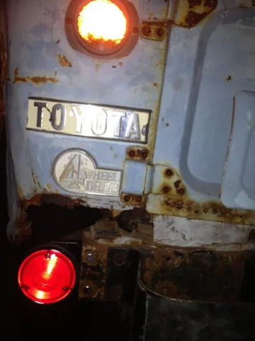

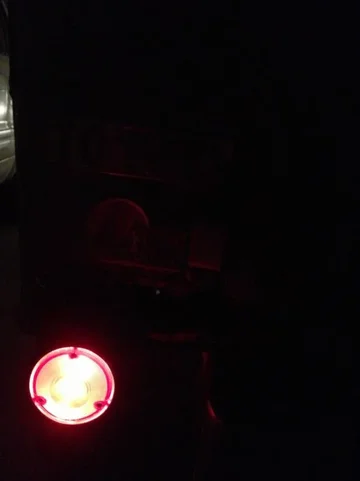

My confidence restored, I built the rear harness complete with new plugs and connectors front to back. Now I have tail lights, too!

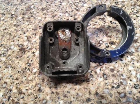

2. The turn signal switch has been broken before and repaired with a big sloppy weld. When I take the switch out of the housing, it now works flawlessly! The lever arm inside the switch goes crooked a little bit in the left position.
Can somebody post a picture of a turn signal switch like this one so I can see the connection between the arm and the actuating lever? Thanks in advance!

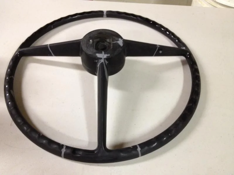

In the meanwhile, I decided to try to fix the steering wheel while it's off and I'm waiting for parts. It has several huge cracks and looks pretty bad. I Dremeled them out a little bit an have started filling them with JB Weld. Here's a picture of the wheel when I started:

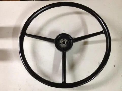

Got the steering wheel painted and ready to put back on. It looks pretty good in satin black, but I'll probably wet sand it and respray with gloss at a later date.

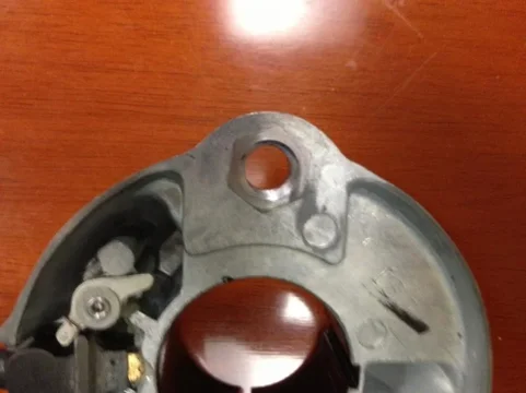

Now I have another problem. I can't figure out how the turn signal switch goes on in relation to the 3 speed column shifter. The new switch has a threaded hole that lines up with the threaded end of the shifter shaft, but the old switch didn't have any threads in that hole.
The hole in the old switch was slightly larger and allowed the shifter shaft to move back and forth. There is a bolt that was inserted from inside the switch that held it together. The fact that this bolt has a very thin head and is off center make me think it is another hack job done by a previous owner.
Can somebody tell me the right way to put this back together? I have searched the forums and looked at the FSM but can't figure it out.
Okay, I decided that the threaded piece on the shifter HAD to fit the base of the turn signal switch. But how to thread it in there?
I had already figured out that the shifter handle was held in by two sprung detents, but it took me a while to try pushing them in while rotating the lever. Voila!
Now I realize the little piece won't thread into the switch base. The threads are totally stripped! I don't yet have a metric tap and die set, so I took out some tiny jeweler's files and chased the threads (a lot!) until they looked like they might work. I then took a stainless nut with the correct threads and threaded it on and off a few times. It worked! I was able to thread it into the switch base.
