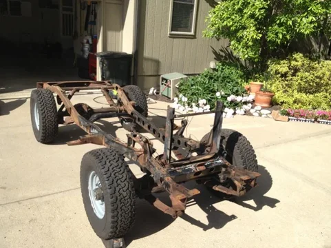

Here's the end result. All the mounts on the very back were rusted solid and had to be cut. I used an engine hoist to pick the tub off the frame and rolled the chassis out from under it. More work tomorrow!

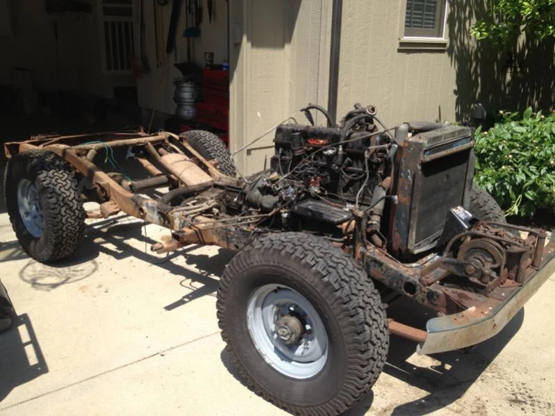

Now that the body is off, I'm stripping the engine in preparation for pulling it. I want to clean everything up and paint it while its out.

Now if I can just get the winch off the front. Do I need to pull out the shear pin to get it off? The PO replaced the shear pin with some kind of bolt, but the head is either rounded off or has been welded on, I can't tell.
Finally got the shear pin pounded out of the winch and got the whole winch assembly removed!

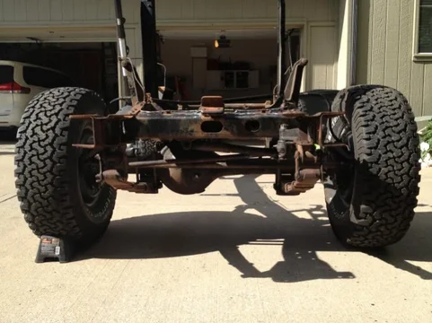

My rolling chassis is completely bare, just waiting to go to the blaster. Unfortunately, I have no way to get it there for now. My buddy has a trailer I can borrow, but my DD won't pull it. His tow vehicle just sold and he is shopping for a new one.

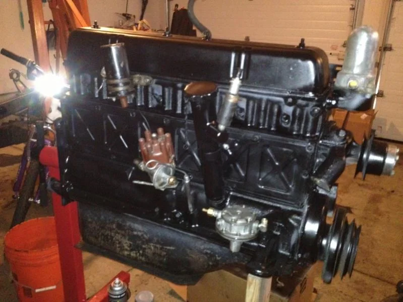

I've spent the last couple days cleaning the engine with degreaser, carb cleaner and brake cleaner. I finished that today and then primed and painted the engine.
