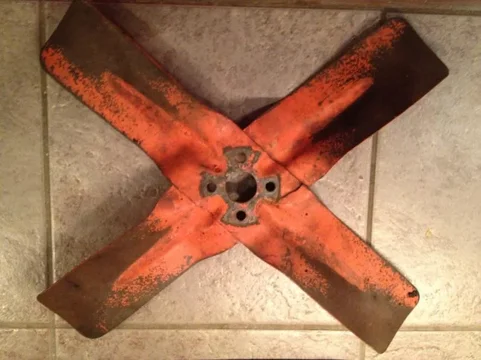

I'm hoping to get the frame hauled to the blaster in the next week or two, but I'm determined to finish the engine ancillaries first. I planned to repaint and use my 4-blade metal fan, even though everybody says they'll eventually fail and go off like a grenade. I just really want to keep the vintage feel of the early cruisers. Unfortunately, when I started inspecting it prior to painting, I found this:
A big freaking crack! Looks like I caught this just in time. I'll pick up a plastic fan and the proper spacer and do it the safe way.

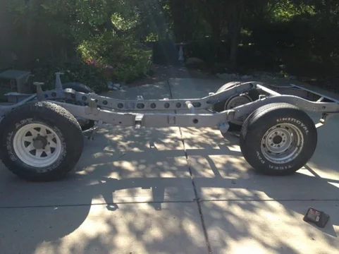

I'm one step closer to getting the chassis to the sand blaster. Traded my wimpy daily driver for something that can pull a trailer:

Roller looks good cleaned up. Can't wait to be at that point.
No, it doesn't.
Especially when you put all the weight forward of the trailer's axles like a dummy! I did a much better job for the ride home.

Did they blast as its shown or remove tires?
I had planned to pull everything from frame and take in pieces, but that looks a lot easier.

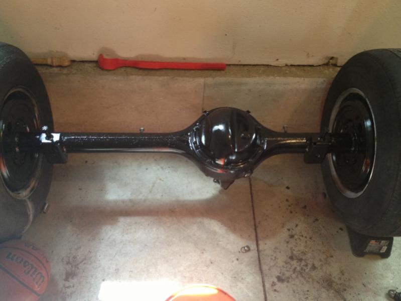

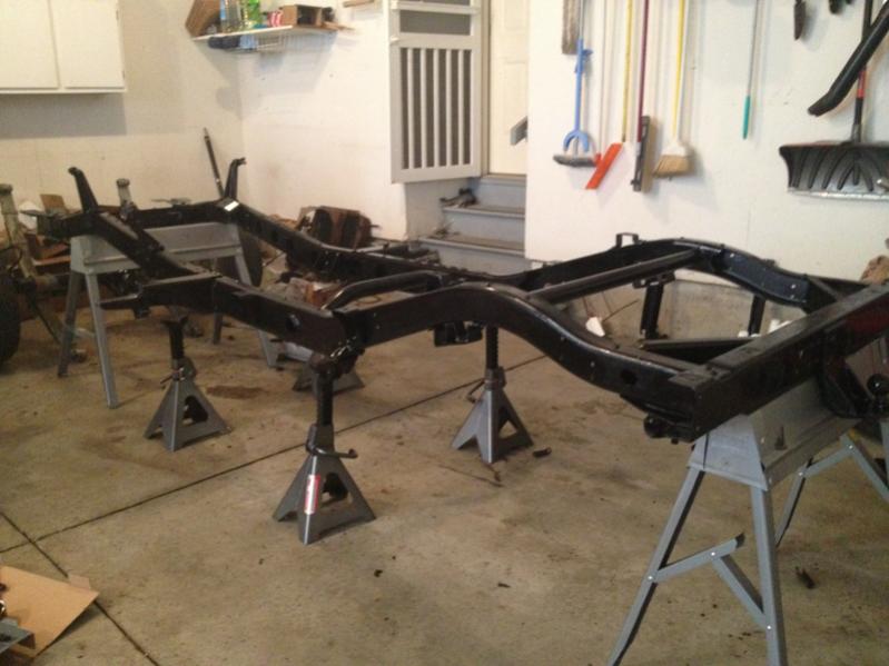

I got my frame back from the blaster! Stripped it down, degreased, etched and coated it with 2 coats of POR-15. Also coated the axles and started installation of an OME suspension kit. Would have been really nice if MAF had included instructions for the lift kit!
All new tie rod ends swapped in and I pounded out the old diff drain plugs and put in new magnetic plugs.
Just need to install the shackles and the rest of the steering, then I'll finish painting the front axle and steering rods.
That is looking great. You are moving fast on it!
