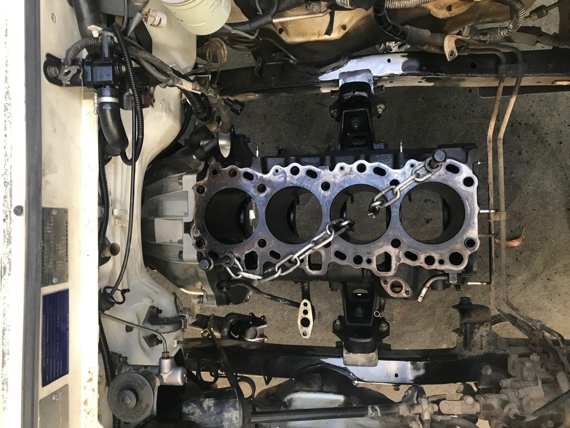

Sourced a whole KZN185 and sold off the bits for triple what I paid for it and that's with me keeping the engine. Have to do an engine leg and sump / oil pick up swap to suit solid axle but as I'm already running an R151F transmission its simple to swap the KZ bellhousing on the the R box. Keeping it legal, had an engineer approve the mods to the frame as the engine mounts had to be moved back about 50mm using a dummy block as a jig, so I had a qualified welder friend TIG on a pair I cut from a wreck. Really hard to remove them and keep both the frame and the mount intact so I sacrificed the frame of the donor and carefully unstitched them on the bench, then just cut and carefully ground my existing ones off. Slow progress but this is where its at the moment. Must say tho the KZN185 1KZ manual pulls like a train so cant wait to fire it up in the LN106. Lots of pics for such slow going :)

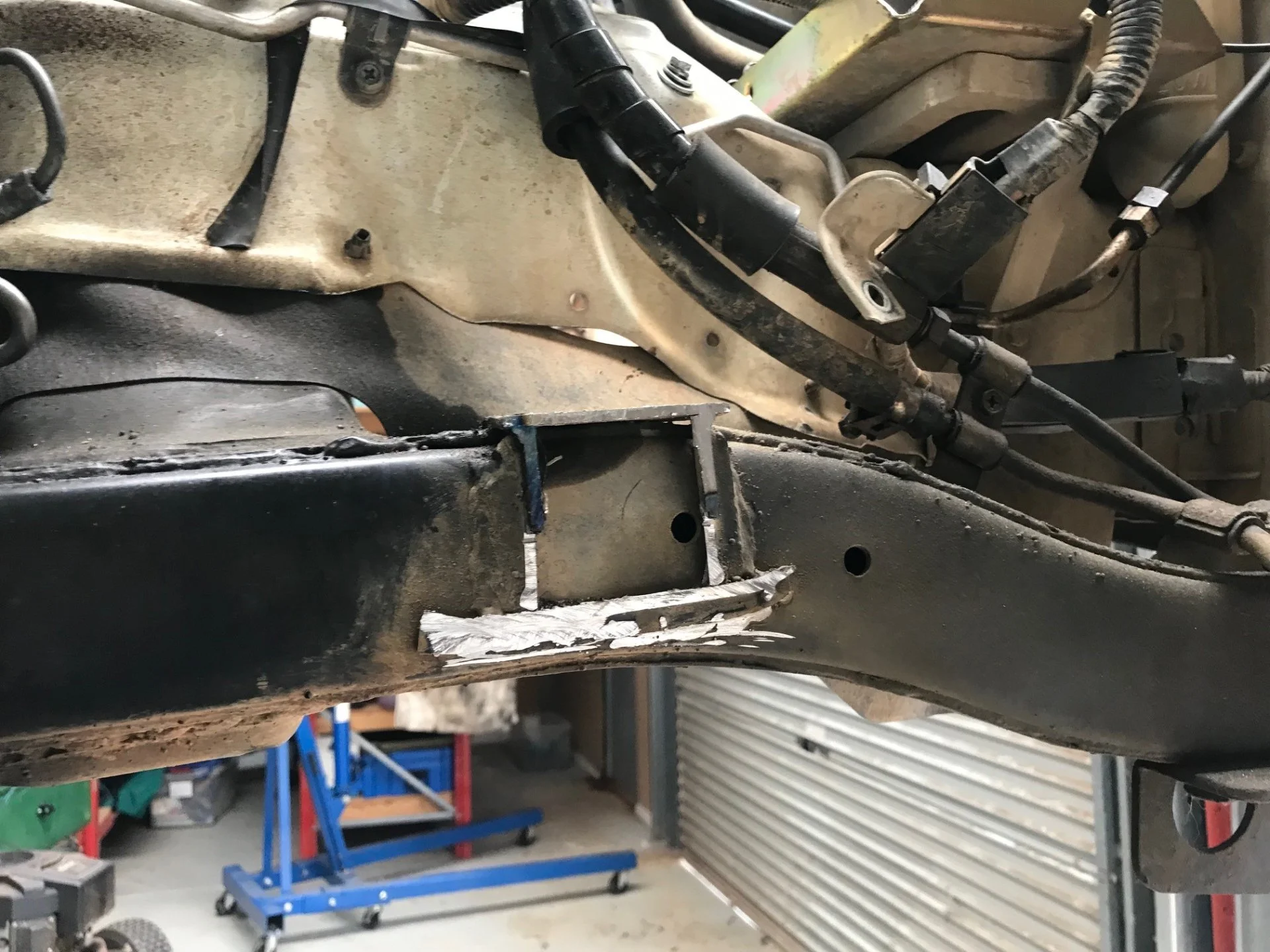

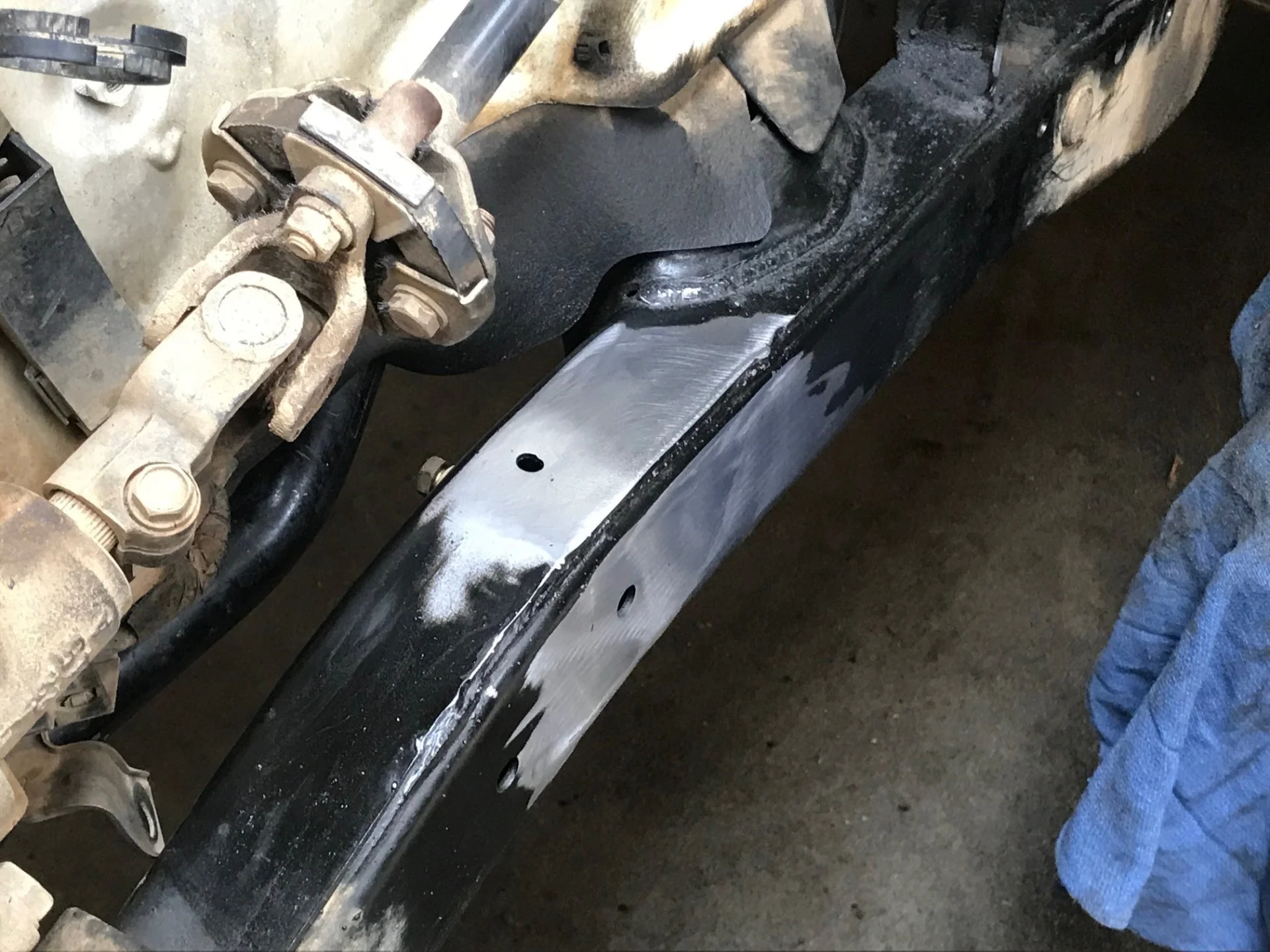

Cutting off the old:
Back to bare metal with no nicks or gouges to the frame.

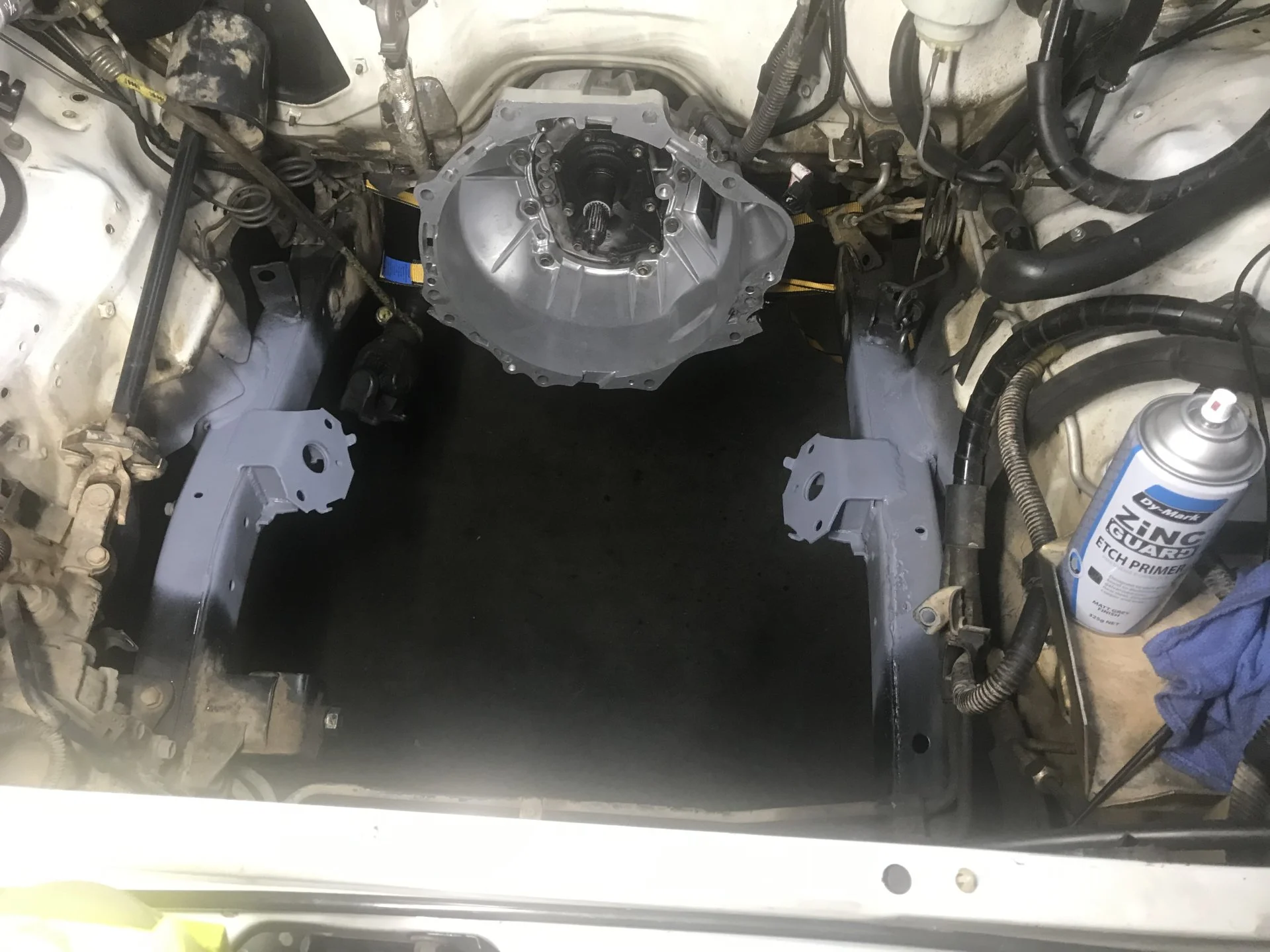

Test fit the dummy for engine mount positioning on the frame:

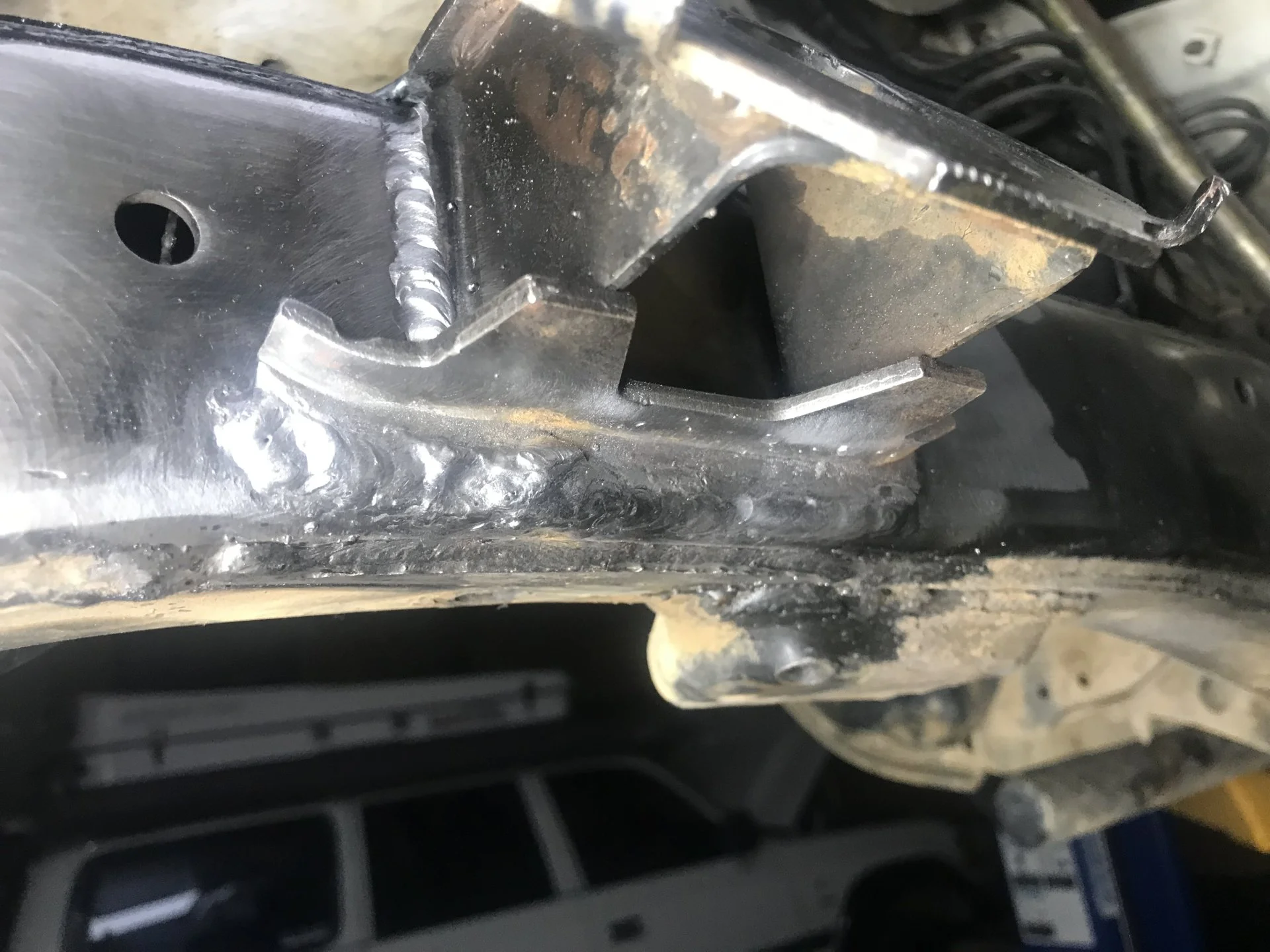

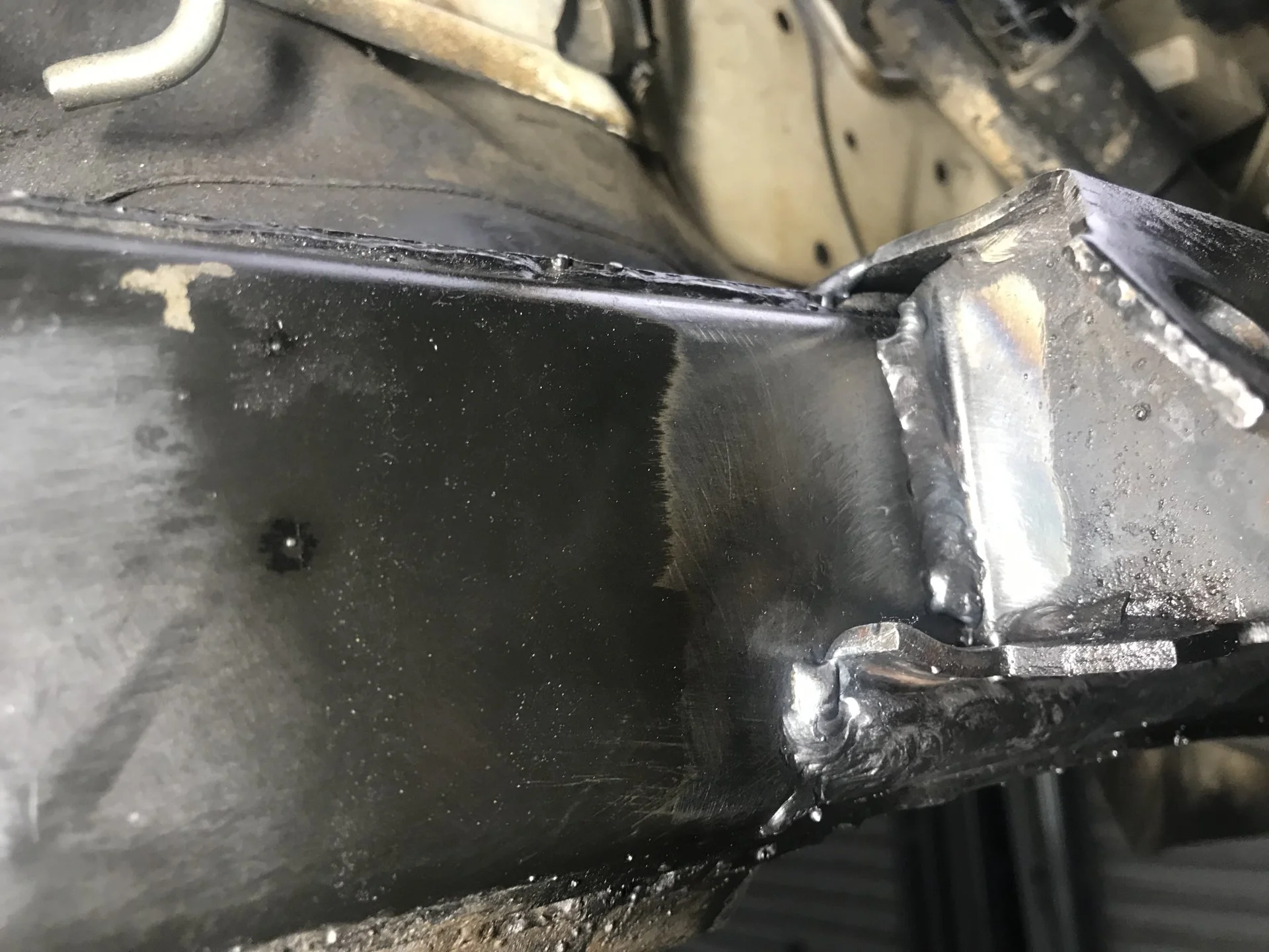

Welds going on

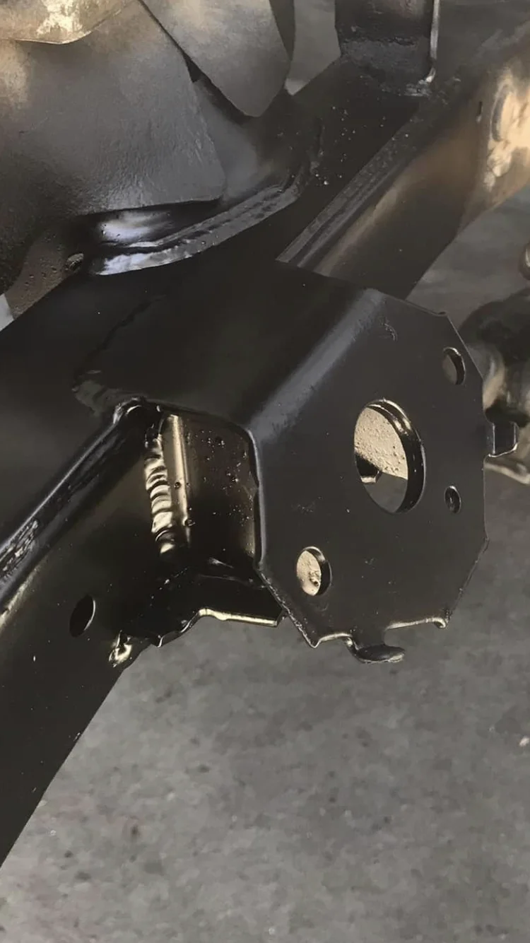

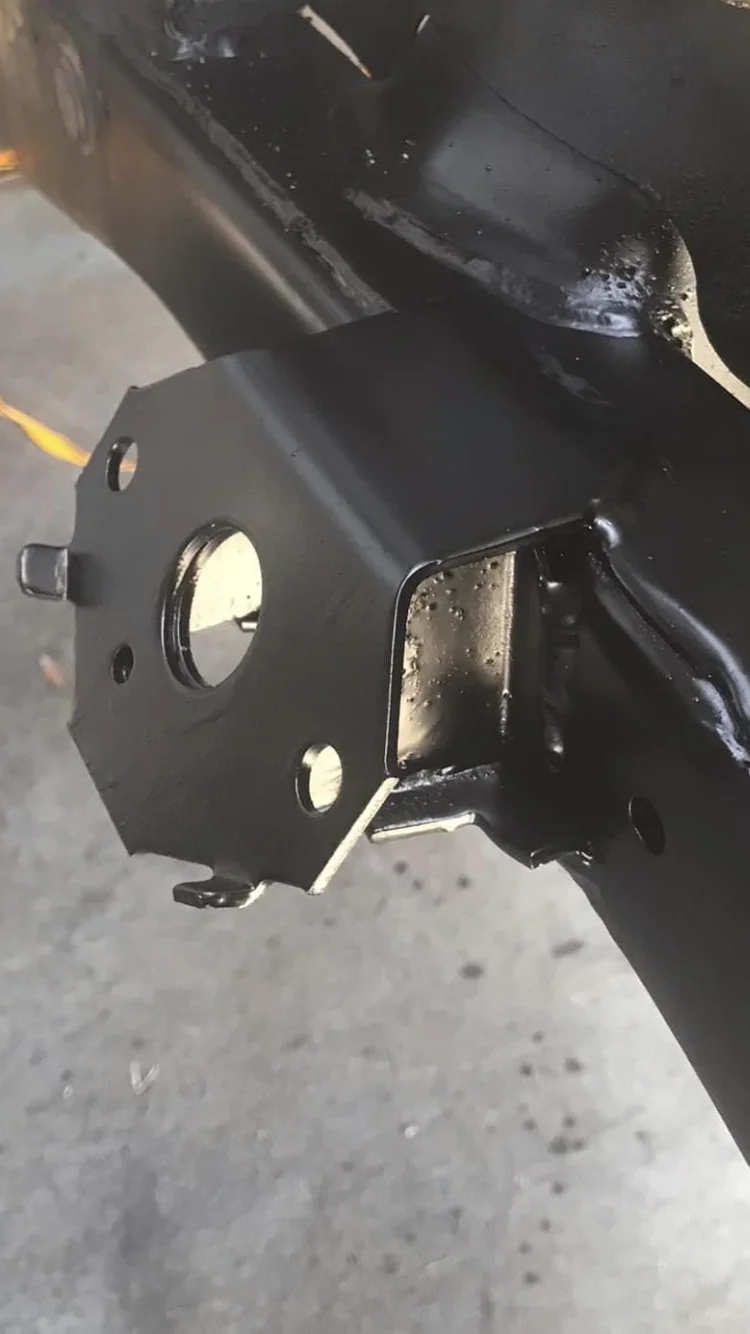

welded and painted
Good as new and passed by the engineer :-)

Hi there @ALX4X4 , new to this forum but I stumbled across your post looking for details on moving engine mounts. I am doing the same engine & gearbox conversion on a LN106 single cab. I see most people are moving mounts 40 to 50 mm but with the GB bolted down on the KZ crossmember it looks like I need to move 65 to 70 mm depending on where the bolts are in the slots. This makes it very tight on the firewall. Did you have this issue and move the gearbox mount too? Cheers, H.
I have dual cases as well and compared to the standard location I had to move the transmission back 20mm as well compared to stock. The 1kz bellhousing is deeper than the R to L engine bellhousing and I ran out of room for the fan. Anyway first start 2 days ago 👌

Did you use the LN106 crossmember? Going back 65mm might buy some fan space up front then. I guess a modest cab lift will help at the firewall.
@ALX4X4 I found the difference between the LN and KZN crossmember. About 20mm. Explains why my engine mounts need to move so far.
Would you see any down side to moving so close to the firewall or would you go back to the LN crossmember?

Definitely as far back as you can the fan and fan hub chew up a lot of room. Ig the KZ x menber moves your tranfer case back 20mm over current, I'd use that and drop your engine in and weld mounts to suit. I found it MUCH easer to chop the whole frame rail mount from a wreck and grind the welds off on the bench- trying to remove and re-use your original frame mounts will be a chore as access is so poor in-situ. Much easire to cut them off without a care in the eorld then drop in your carefully prepped ones from a wreck :)
Wont fit if you use the LN x member, ask me how I know.....AFTER we'd welded the mounts....

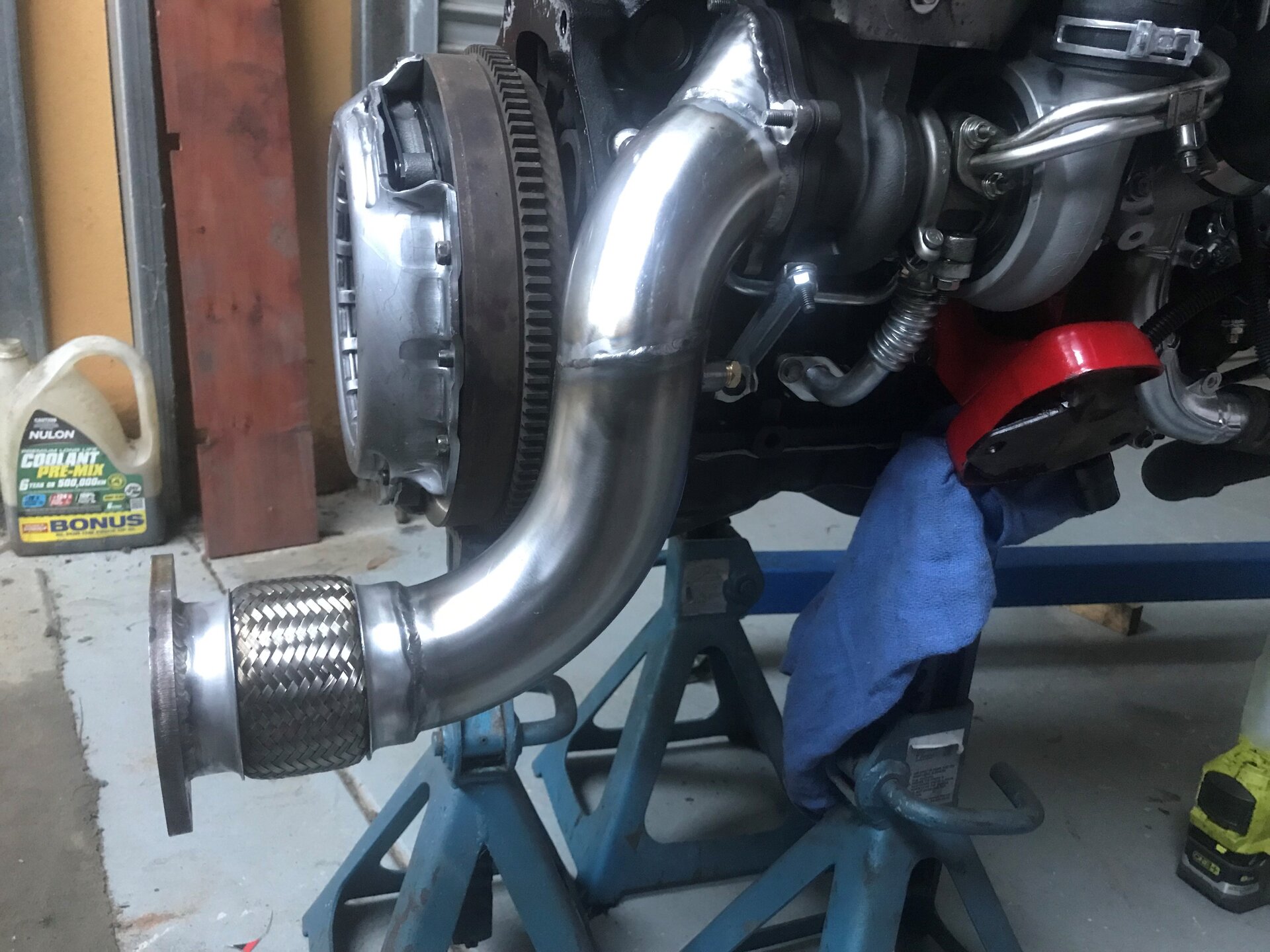

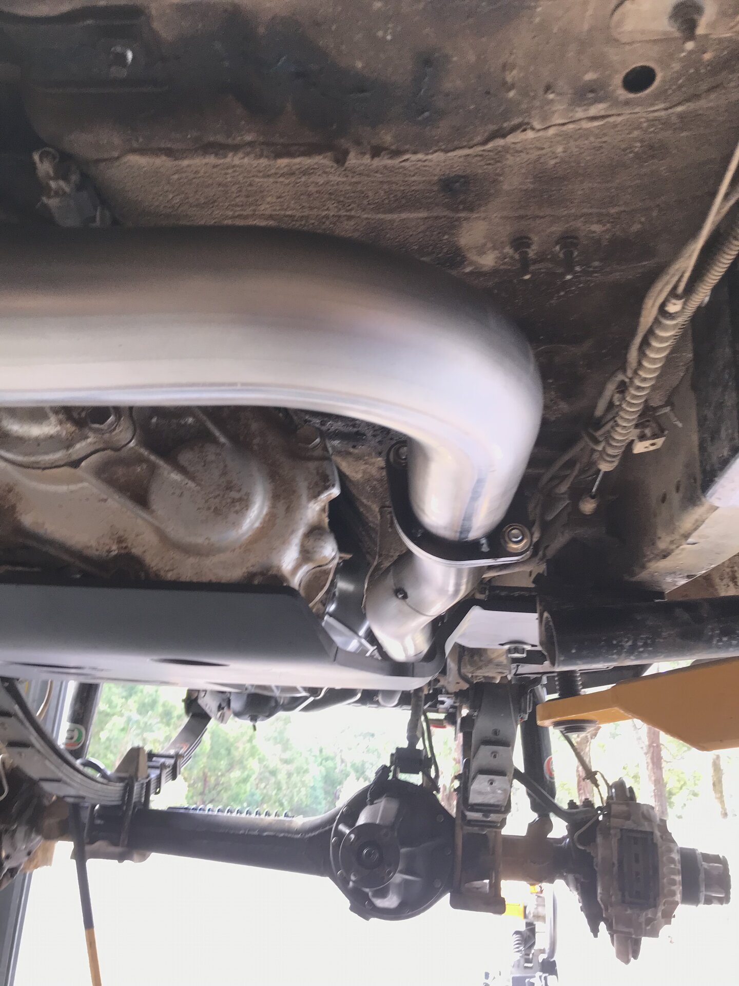

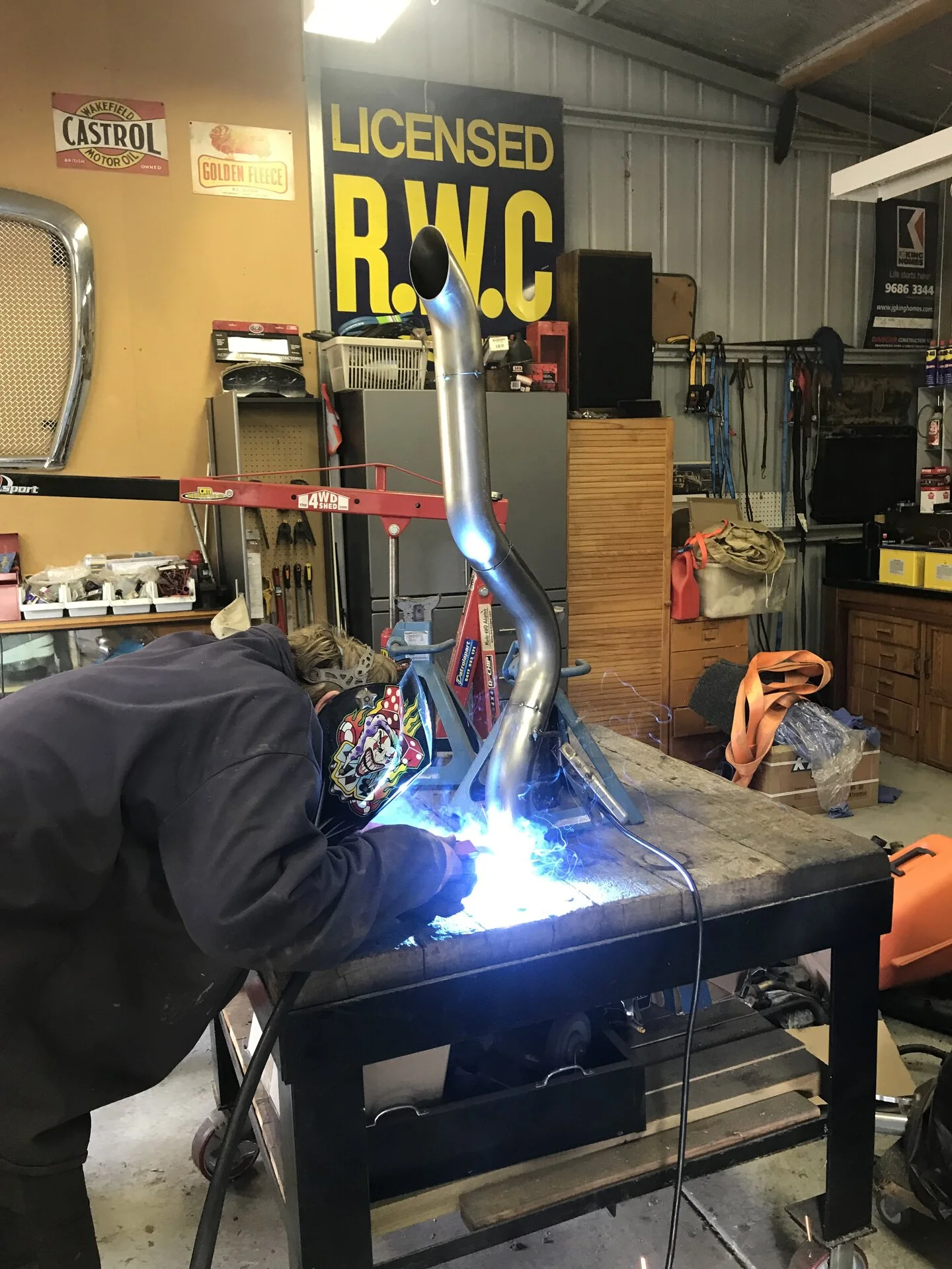

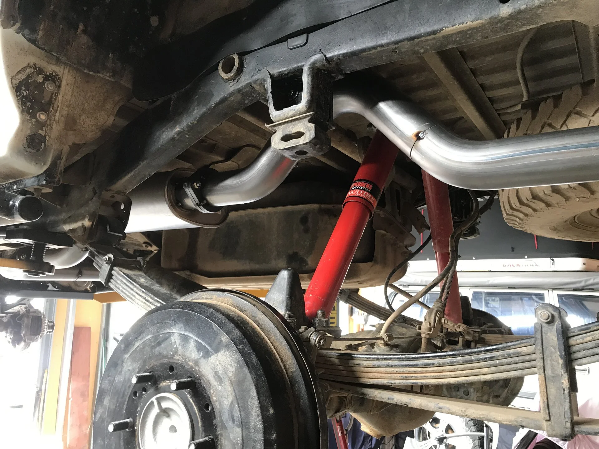

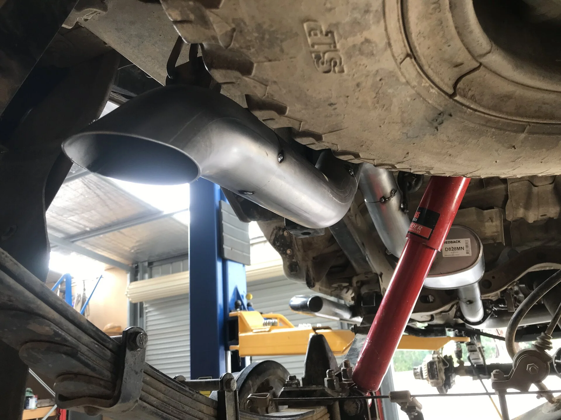

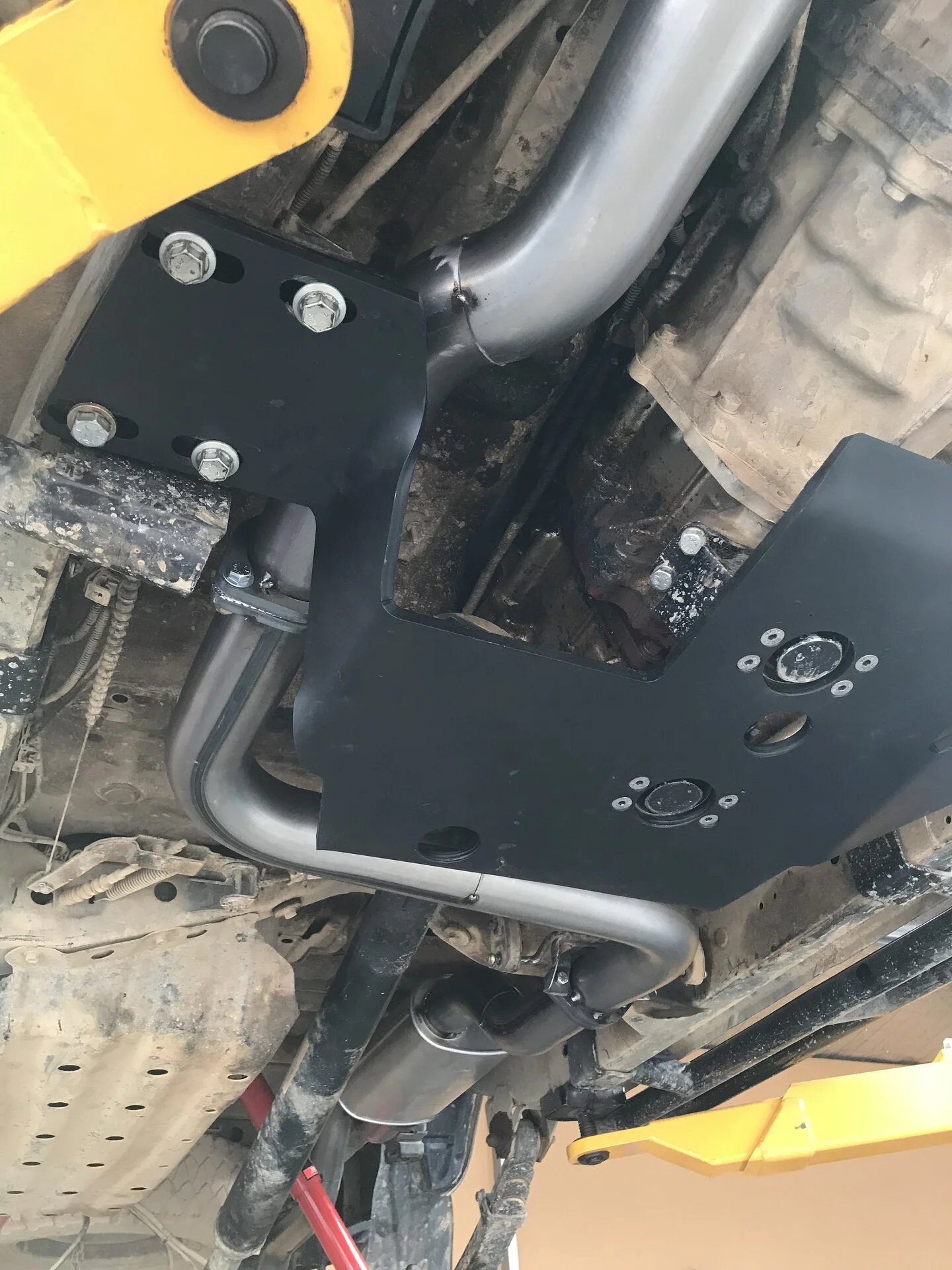

3" full mandrel bend zorst going in I had a LOT of help from a mate on this one namely he can weld with style....
Fabbed the dump in stainless rest is in mild. All tacked then removed for full weld. I 've just got to hi-temp paint the welds now.
A couple more...
A bit of turbo whistle out of the dump before the rest of the zorst goes on..... My eldest tweaking the throttle.

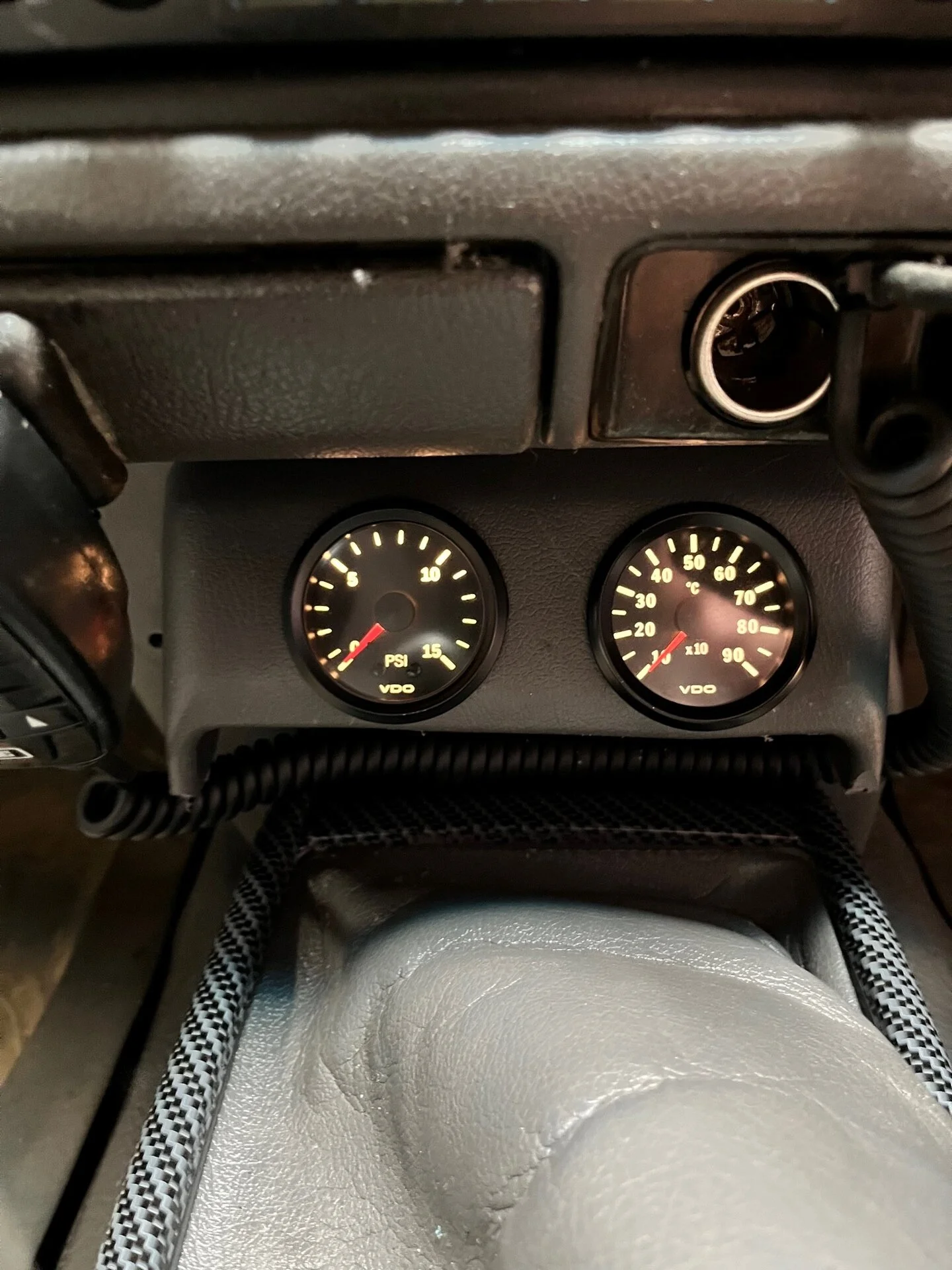

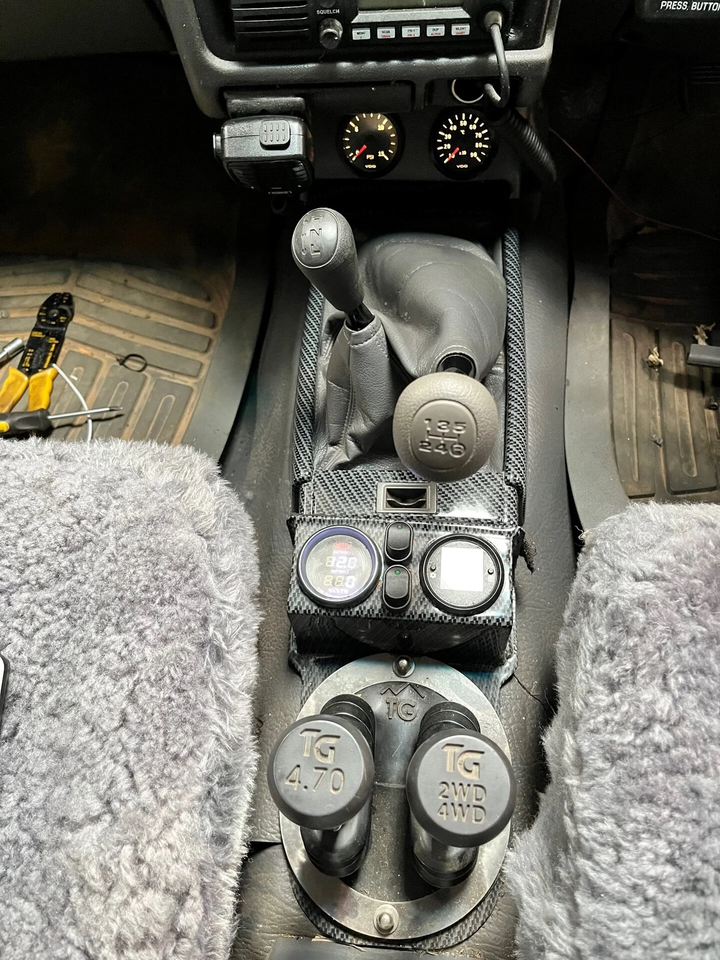

Added a couple of gauges - flipped the little coin tray thingummy upside down and hole sawed it out.
All connected just got to go for a test drive.

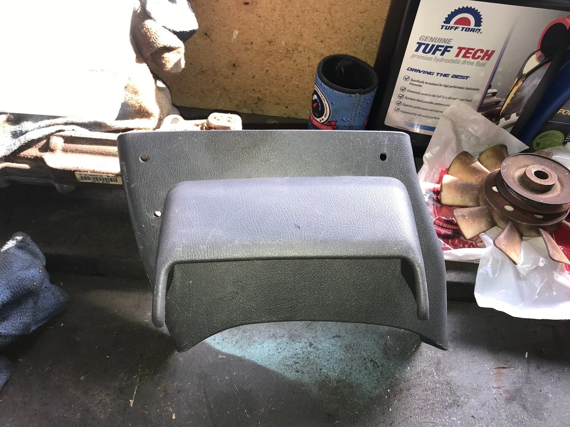

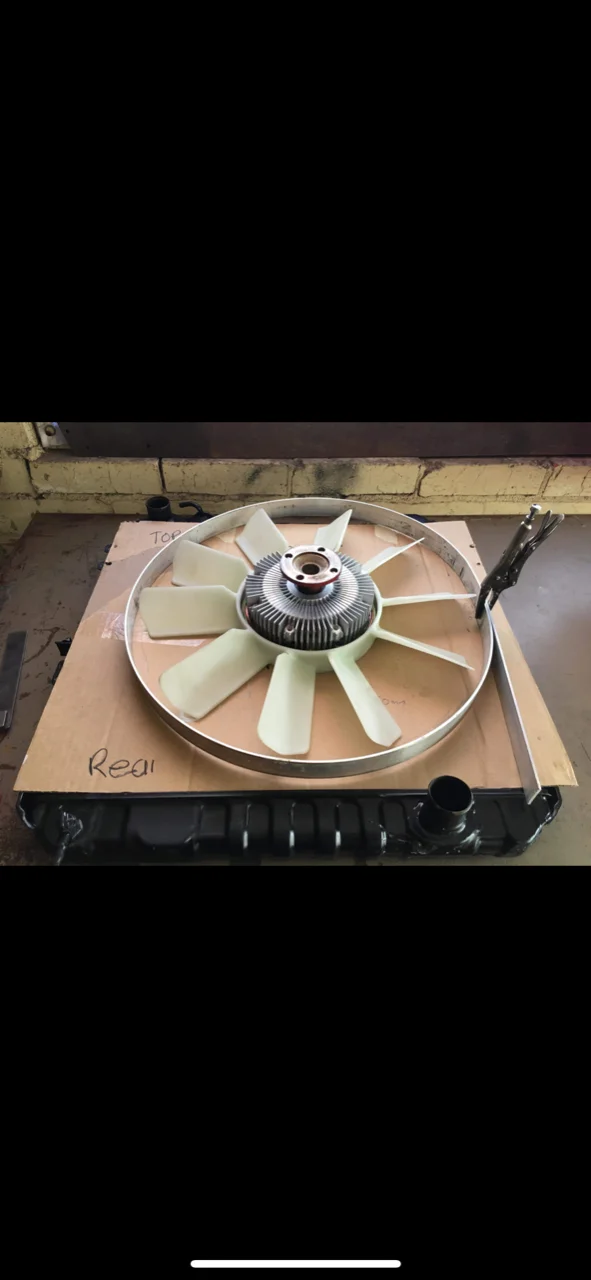

Fan shroud fabrication has begun too....

Anyway good luck and keep plugging away if I can help let me know. More fans shroud pics its coming along then just need to re gas the AC have a tune done and voila, its done. There's a youtube video of a couple of guys here in Aus doing a KZ conversion in a weekend, some aspects of that made me shudder for sure but hey, I'm a year into mine and it's still not finished lol.
