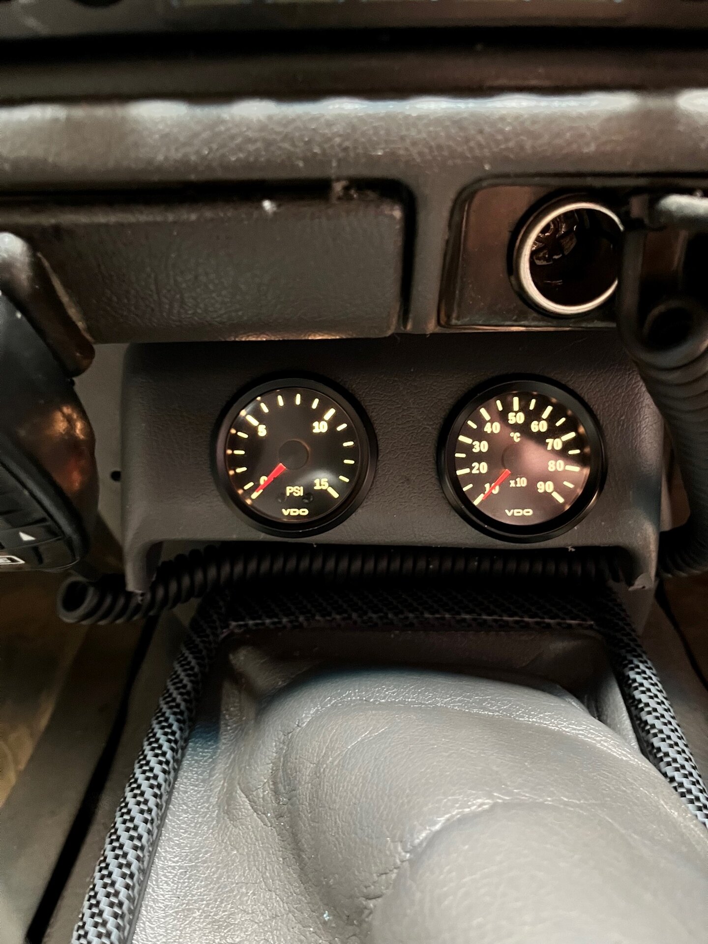

We have boost and EGT's.
I've got a boost controller plumbed in so I'll sneak it up to 14 PSI

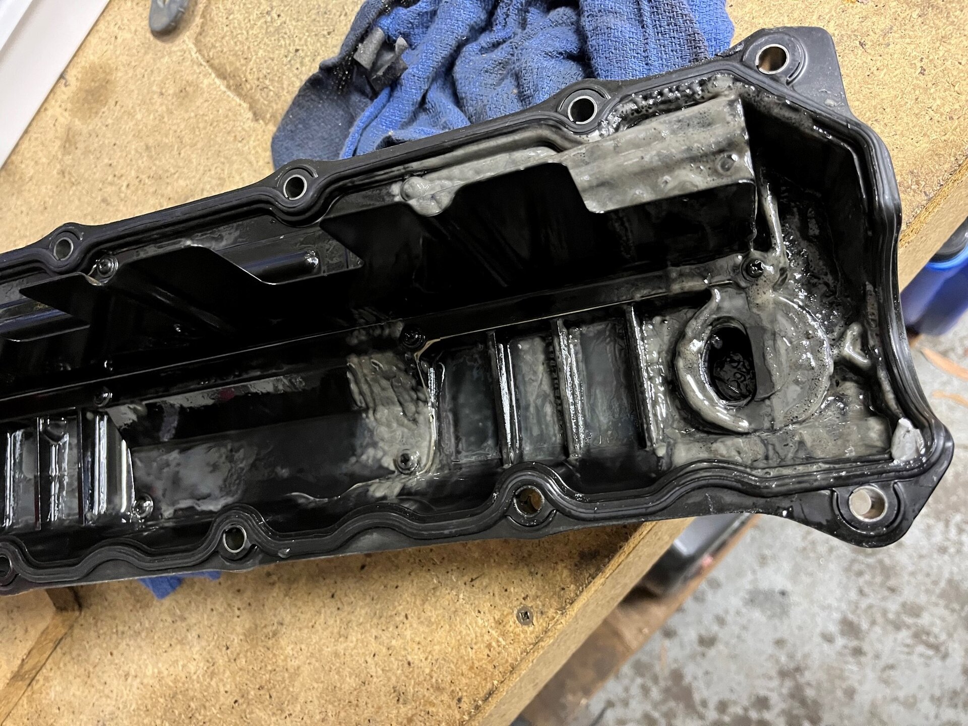

One step forward, 2 steps back.... Started losing coolant out of the overflow bottle as in it just disappears.... and system not coming up to pressure.... Would hold 16PSI on testing but getting milkshake under the oil filler cap so off with the head and the investigation begins... albeit slowly. No water in the sump oil thats black as usual and the level isn't going up.
Off to have the head crack tested now :-) There's a few trace marks out of the pre comp chambers but cant 'feel; anything with the thumbnail a crack test will prove one way or the other sigh.

Not feeling too bad... Yes the head is going to the great recycling centre in the sky but the crack test shows it had previously been repaired by PO's unknown. Pic of the sludge in the rocker cover after about 100klms.... So a new head will be pipelining soon and we'll move on :)

Yep, going AMC but buying a bare head and having the seats precision cut with new valves as opposed to a complete head. I'm going with the engine shops recommendation doing this way over a mass assembled head. Fingers crossed.
Found the head had been welded before but here's the culprit:
