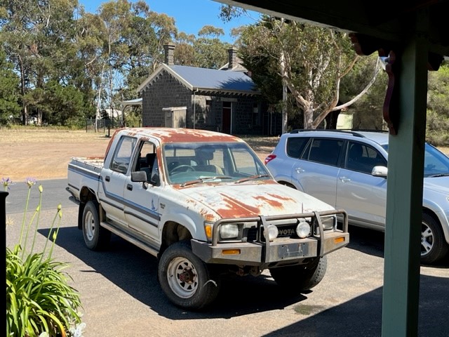

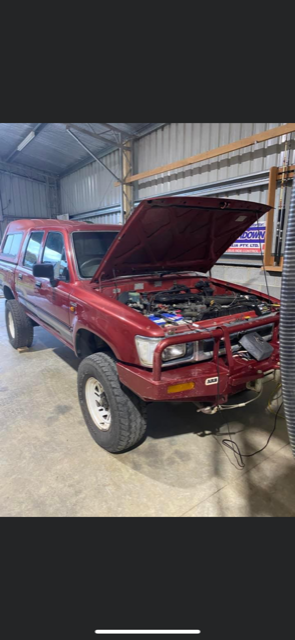

Picked up 2 more Hiluxes this week, wasn't planning to but when the deal is i n front of you... White diesel and red petty.
Scratches head not sure what to do with 'em yet :-)
What were the prices on those two in Oz? There is one for sale here (B.C.) that is very similar to the white one.
Rather not say in public as at least one of them is going to be onsold now I have more than I bargained for ! One was mates rates too as I know / knew the seller and he offered it to me.
Geez at 10 to 20k I should start filling containers (!) typically in Aus anywhere 2-12k AUD what that, 1.3 to 9k USD ?
