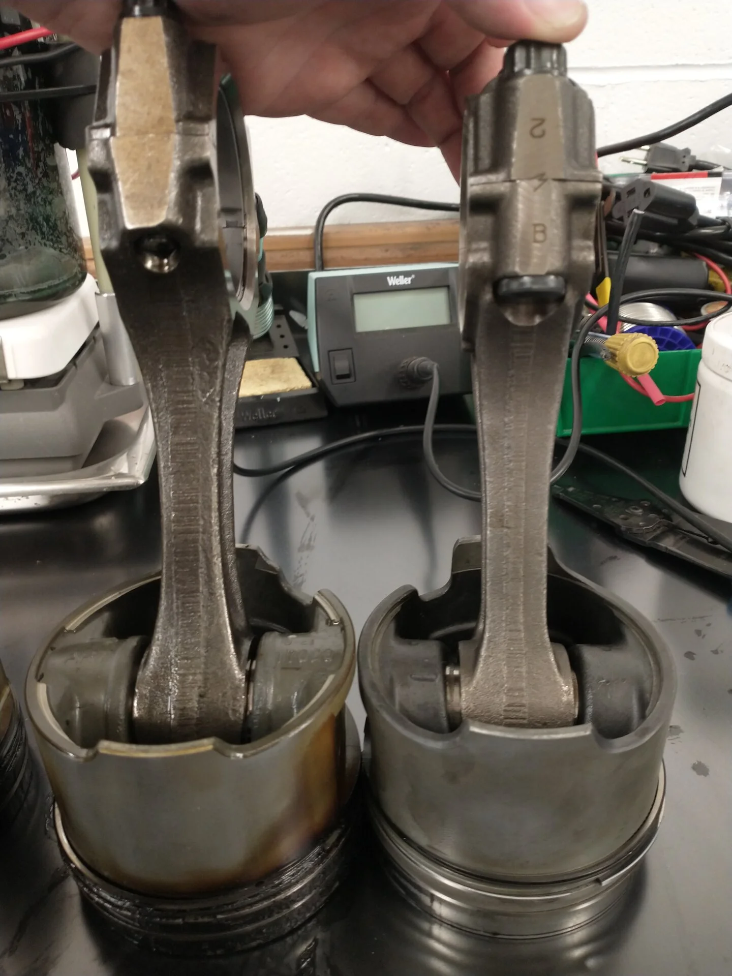

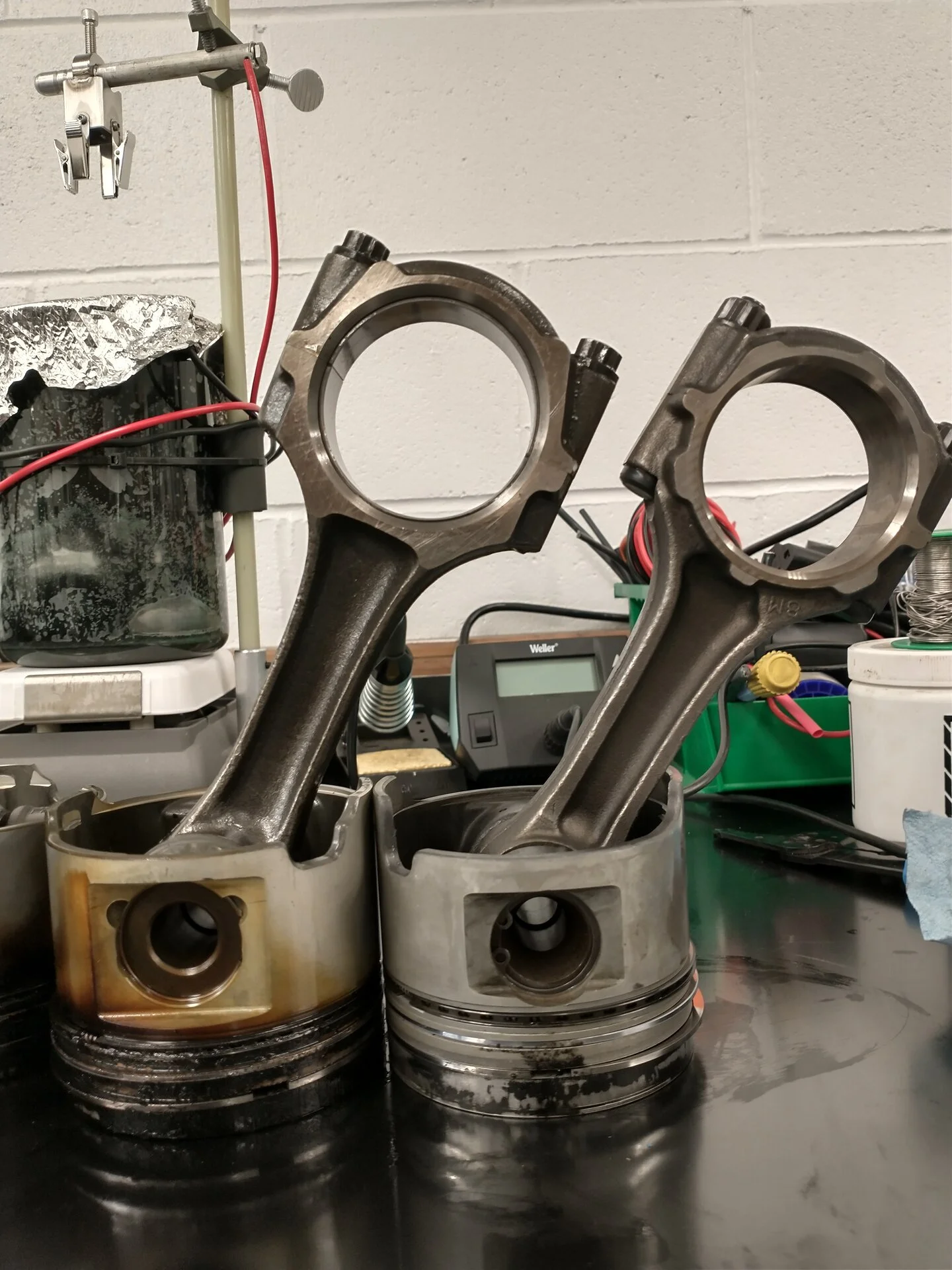

A friend is rebuilding his 1HDT. I put a 2LTE piston rod beside his. Thought it was sort of neat. They both look super beefy.
1HDT left (dirty one), 2LTE right:
Wow! that's interesting because the 2lTE is a 4cylender - and you would think the 1HDT is way more heavy duty. Impressive.

The cylinder volumes are similar. 0.7l for 1hdt and 0.6l for 2lte. Both are turbo, so got beefy bottom ends I guess.
To me the 2lte rods look more refined, but it is a higher revving motor I guess. Oil squirter on the 2lte actually sprays into a cavity in the top of the piston to cool it. Neat.

Toyotas build great engines.

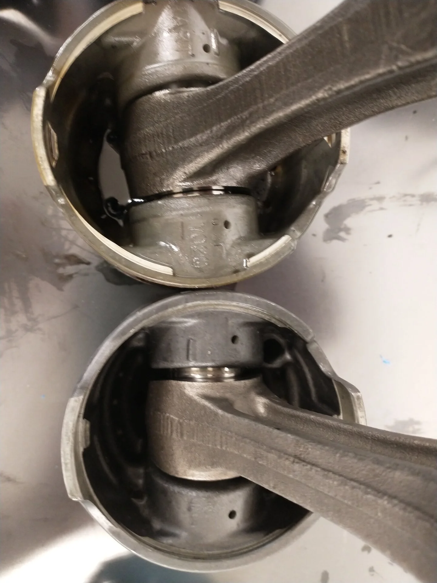

Check out the size difference in wrist pins.
I think the 1hd-t wins the beefcake award :lol:
Looks like the 2Lt pin tapers to about the same diameter as the 1HD-T. interesting

I noticed the piston pin differences too. The hole in the 2lte one is smaller than the 1hdt one, but outter diameter also smaller, and there is the taper. Looks to me like they were trying to reduce rotating mass of the 2lte combo? Also, IDI tech would put less shock on the piston than TDI tech? So a bit smaller is ok. When I compared weight difference, the 2lte combo was 4.6lb and 1hdt 4.8lb.
