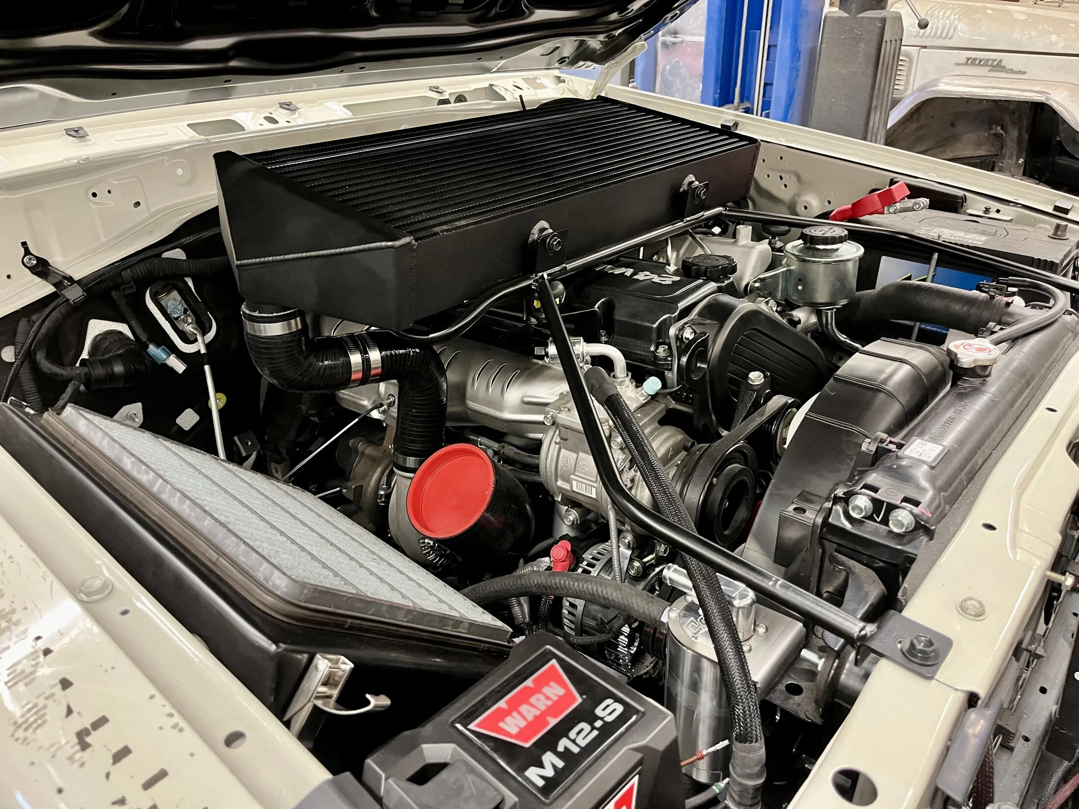

Is this a custom cooler or one off the shelf?
Half off the shelf and half custom fitted. Wide nose 79-series on an 80-series chassis with an FTE and a v8 DPF hood was never made by Toyota. So there is no off the shelf product, more or less.
Cheers

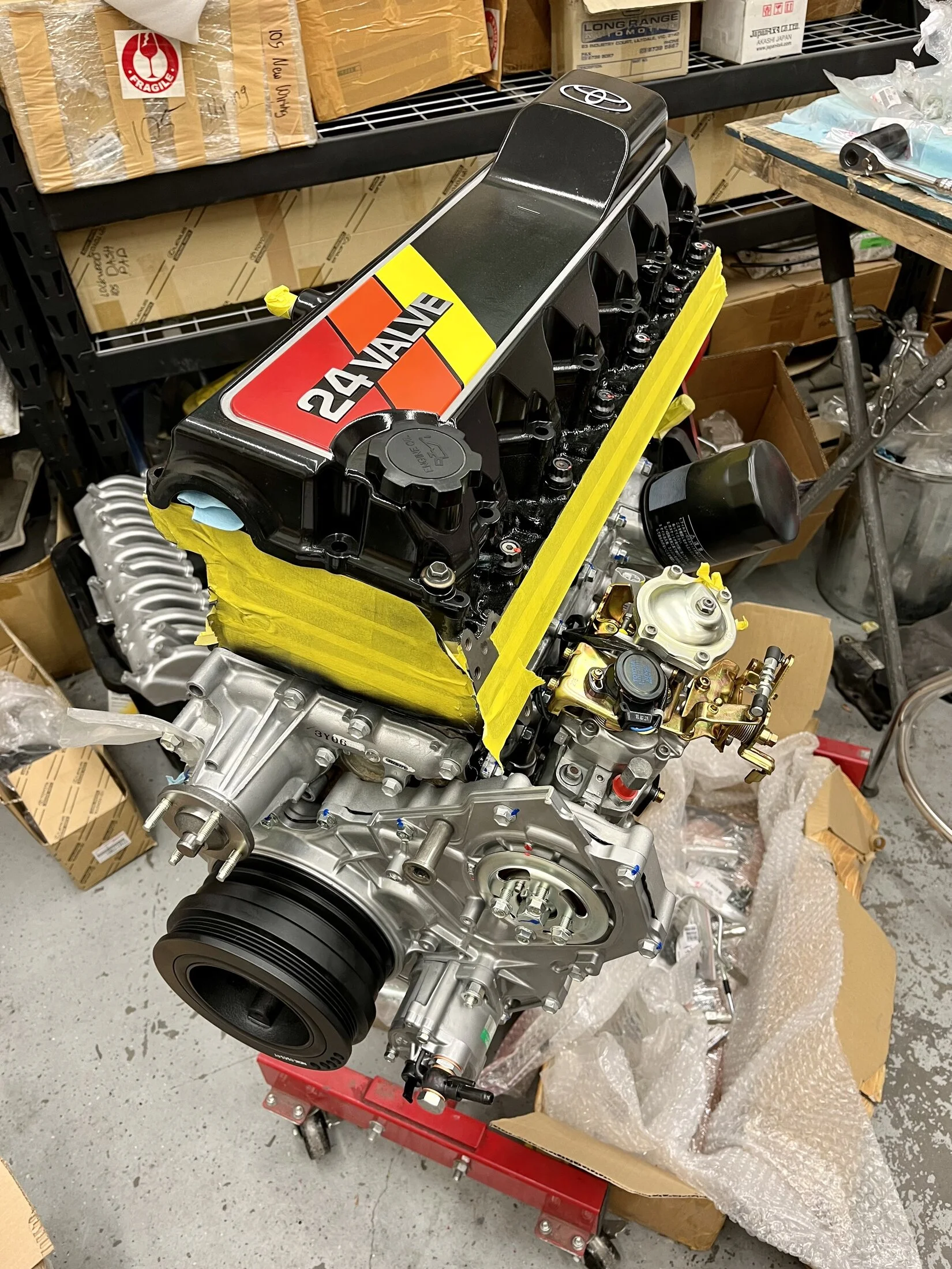

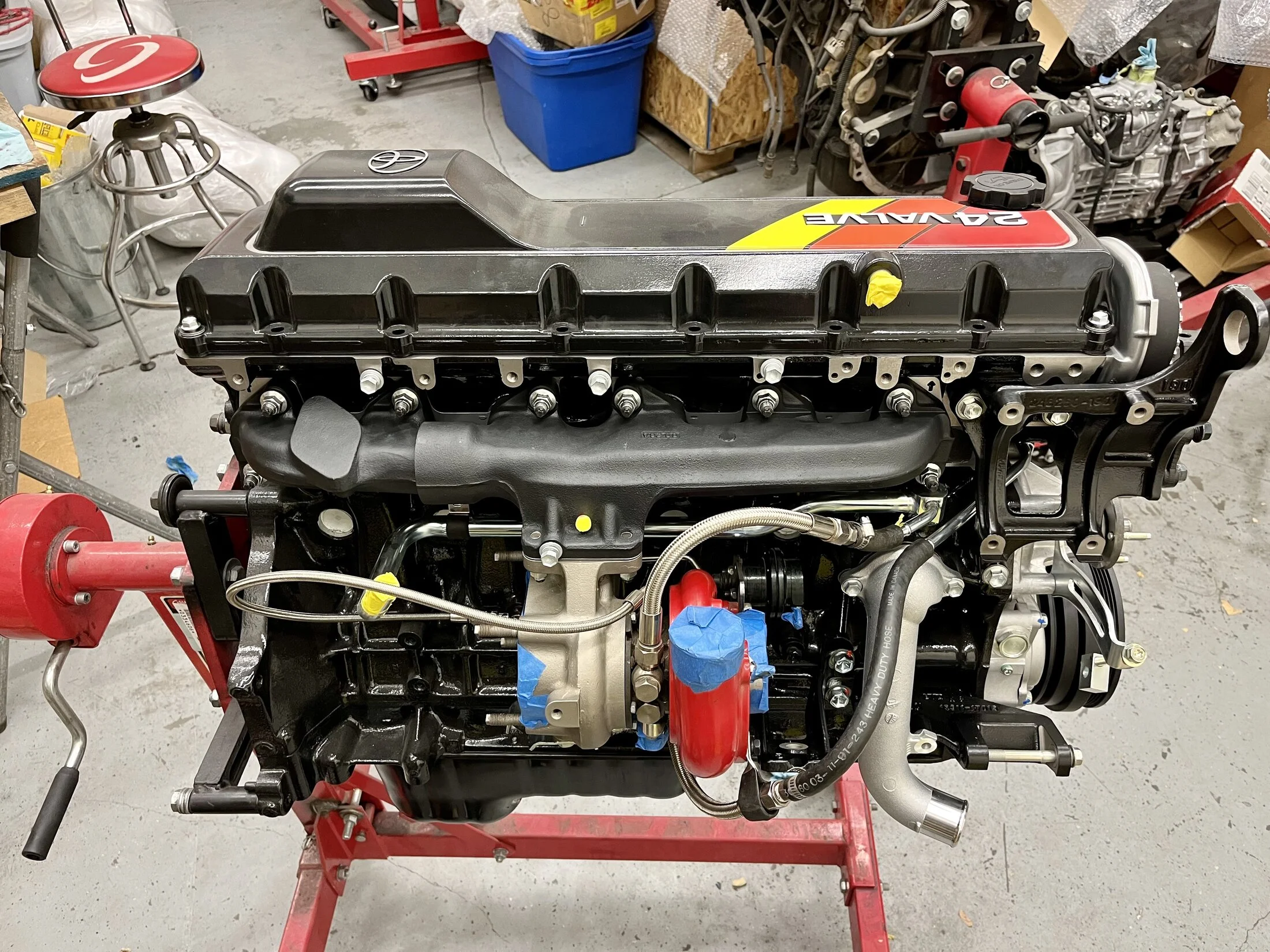

My FT I am building for my HDJ80 shop truck UTE.
Cheers

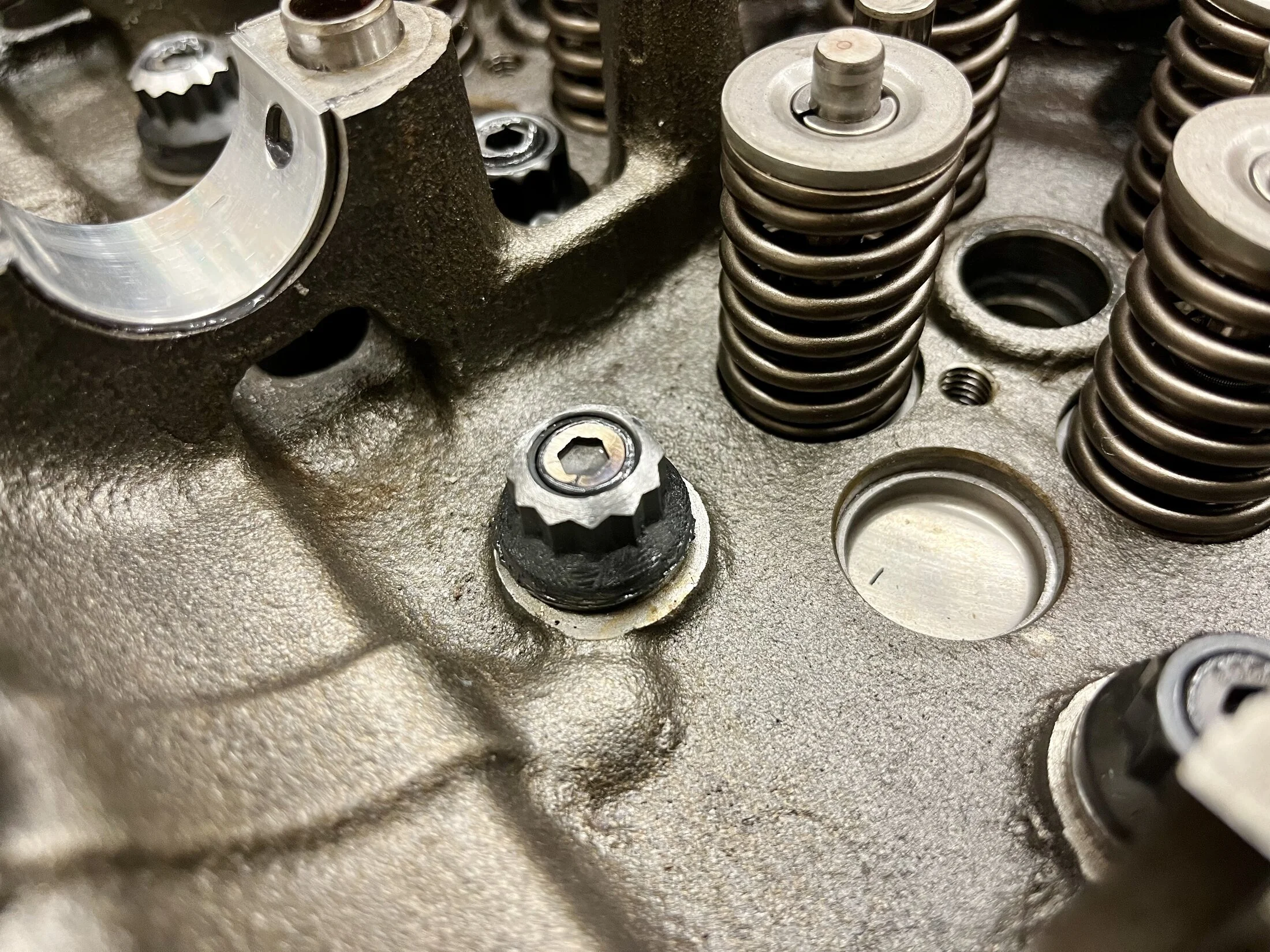

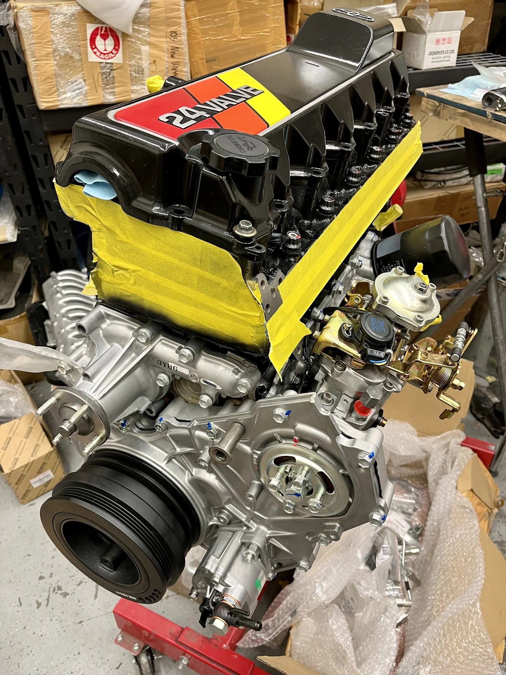

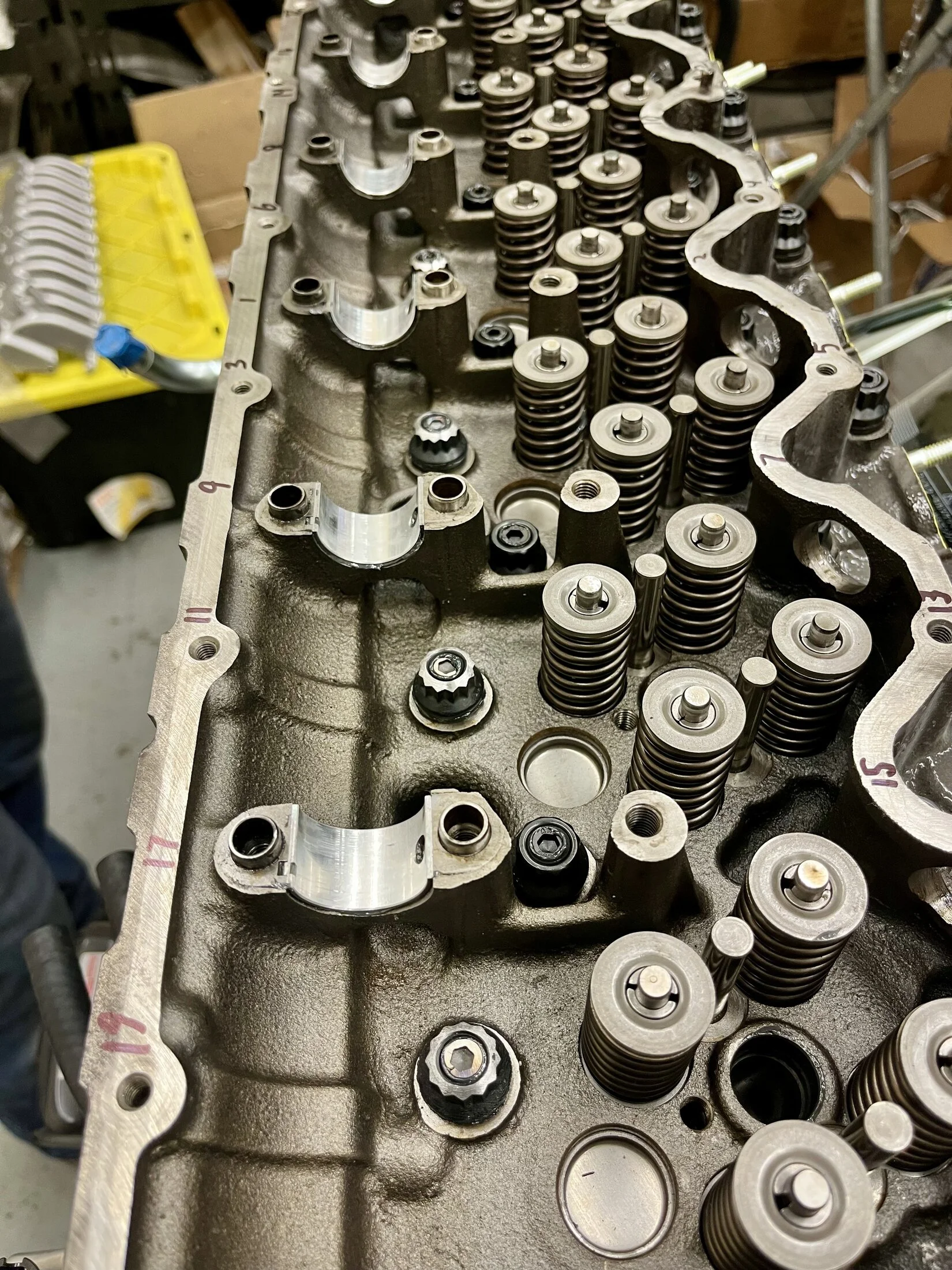

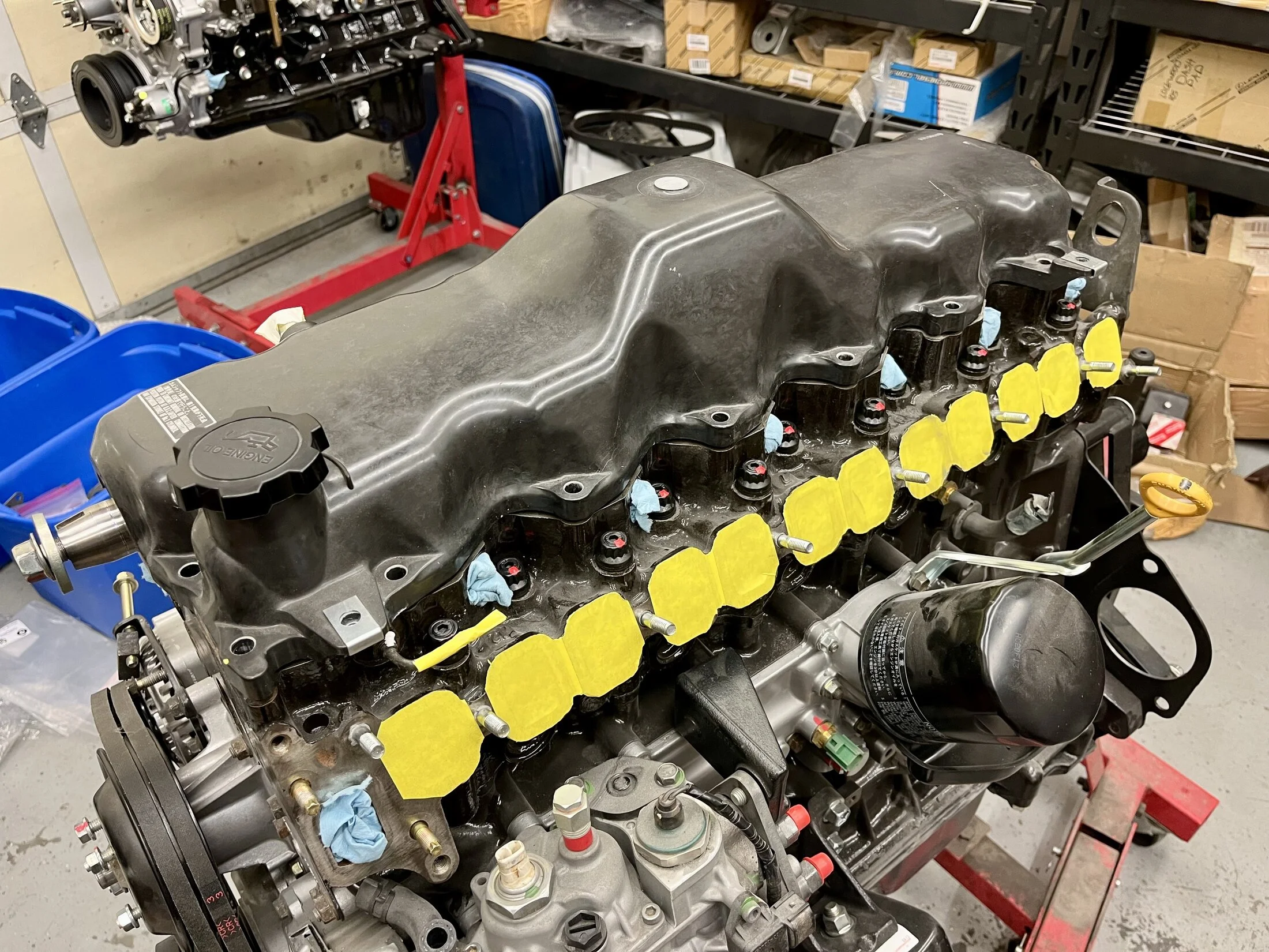

ARP head stud install on this FTE.
Cheers
Last one of the the FTE above.

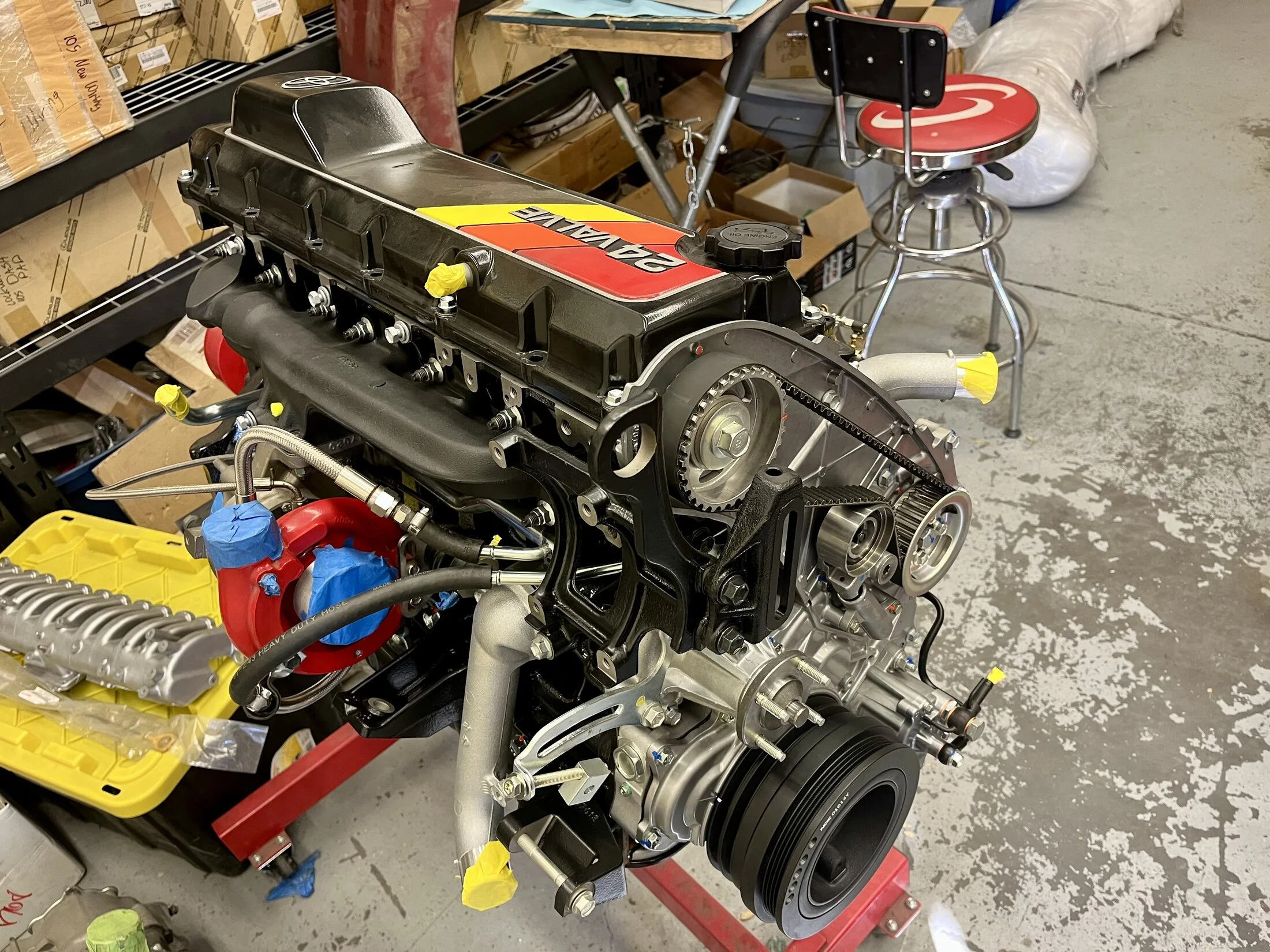

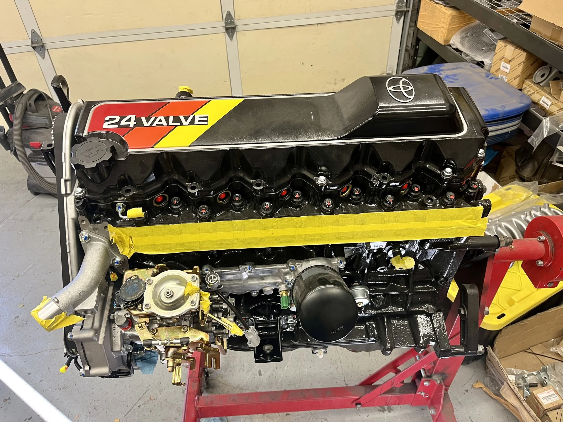

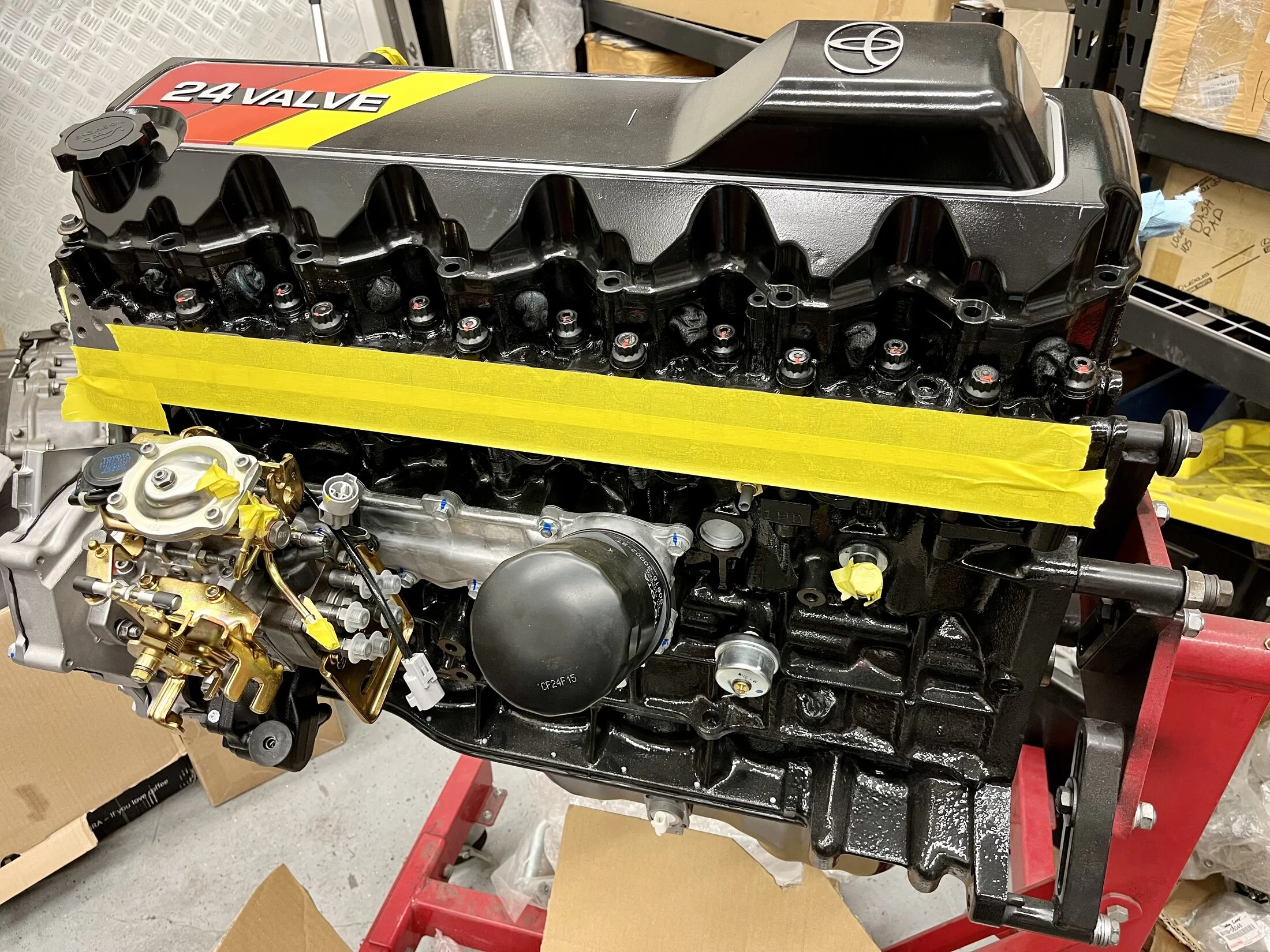

My FT nearly done.

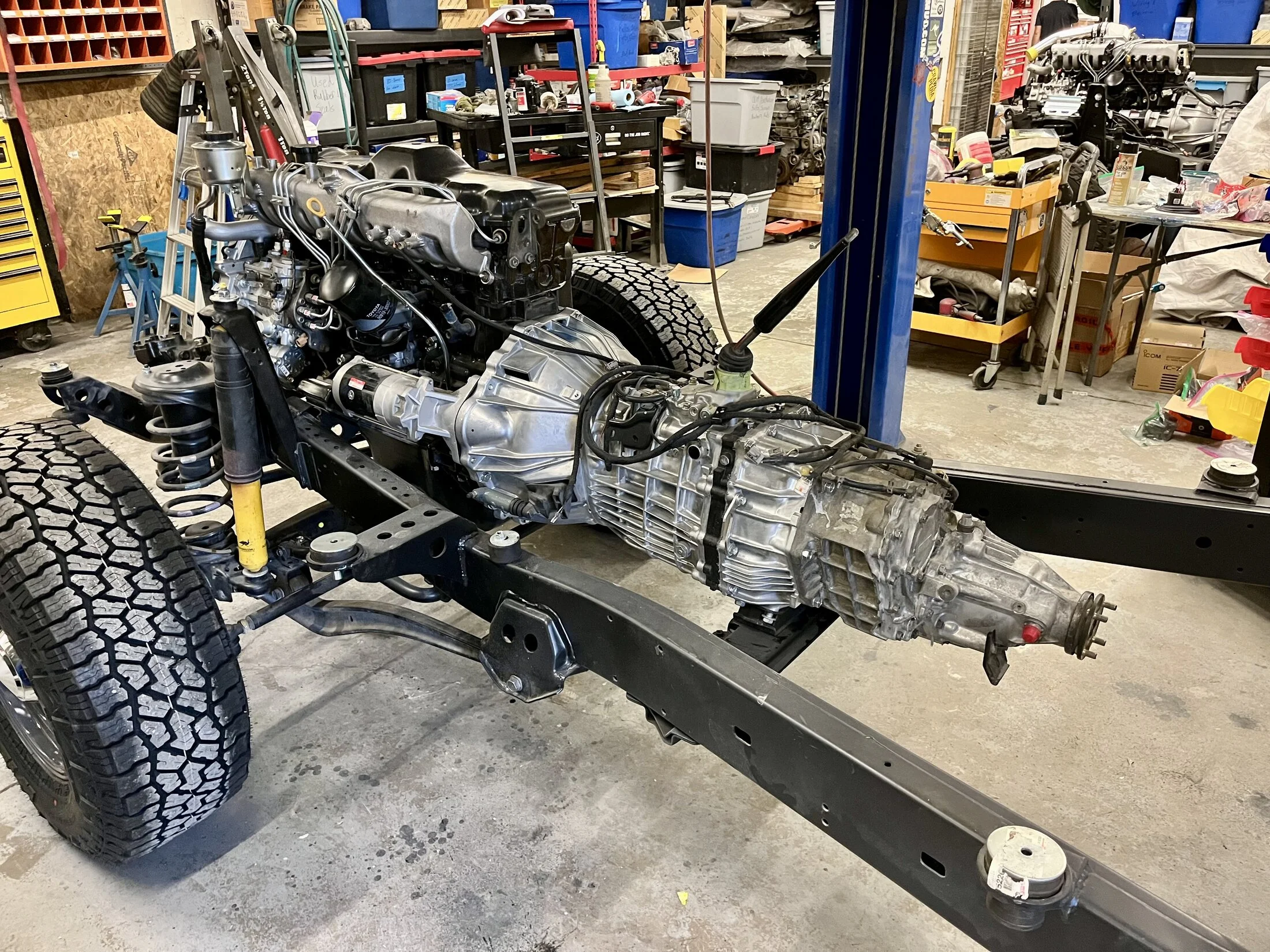

FTE we just did the ARP head studs for sitting in this modified 80-series chassis. Getting ready to drop the Troopy body down on this 80/78-series mash up build.
H152 5spd and full time HF2A tcase behind it.

Beautiful stuff @SNLC: Builds like these are no expense spared, best of the best. I see you are using stock exhaust manifolds does that mean the aftermarket manifolds like these are not worth it?
@SNLC What paint do you like to use for the block and head on these diesels? It looks great in the photos!
I have been using VHT engine enamel.
The main thing is getting them clean and rust free first. Prep is everything to get good lasting results.
Cheers
